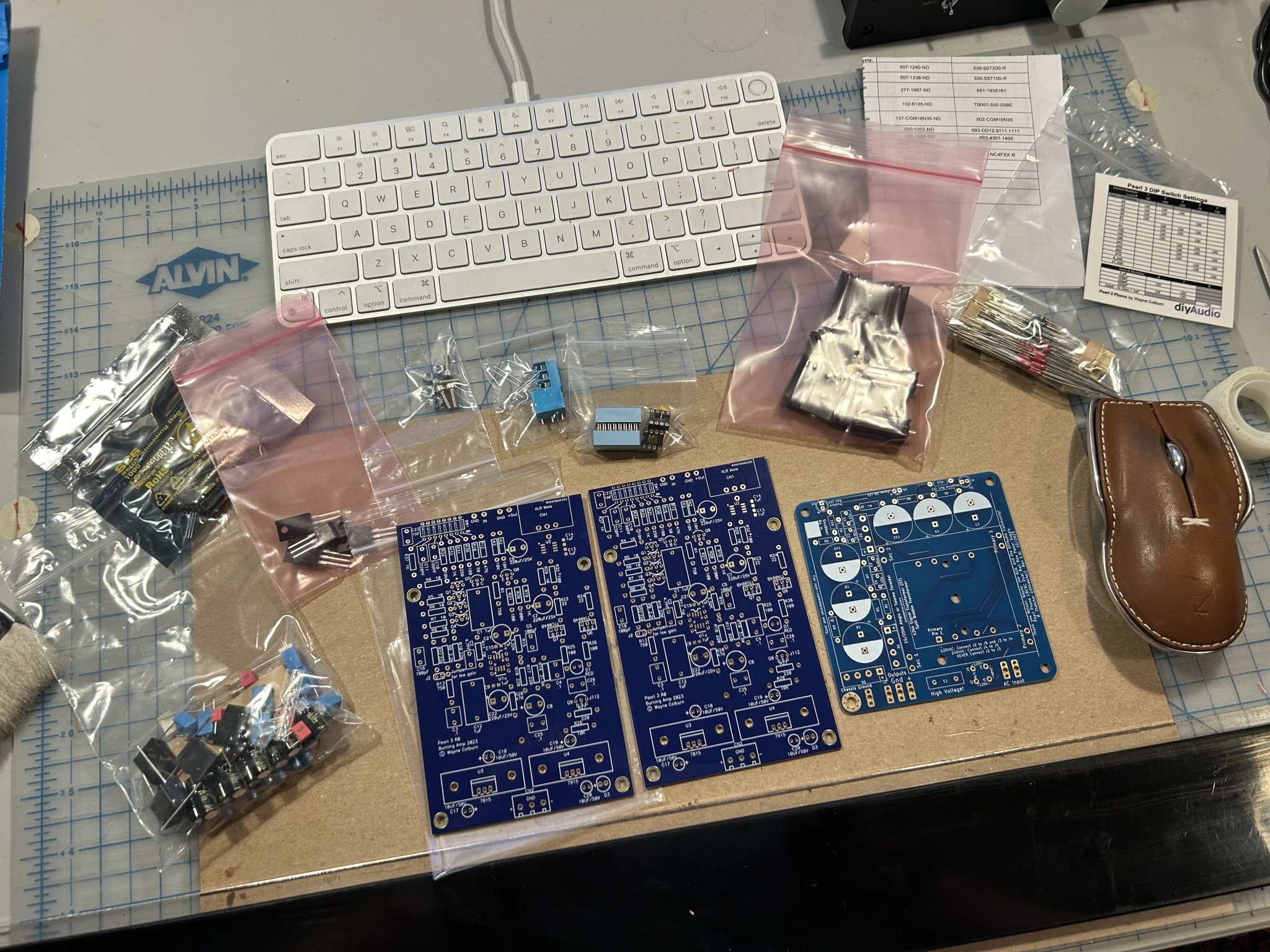

That mouse is awesome. It's from a company called Lunar Artifacts out of Great Britain, and there's a matching wireless charging station too. The underside is polished aluminum, and looks and feels like some of the later Star Wars thingies. As an architect, I'm a sucker for a beautiful object...
And in case anyone is curious, my wife thinks I'm an idiot. And she doesn't understand my love of making cool **** for listening to music either.
