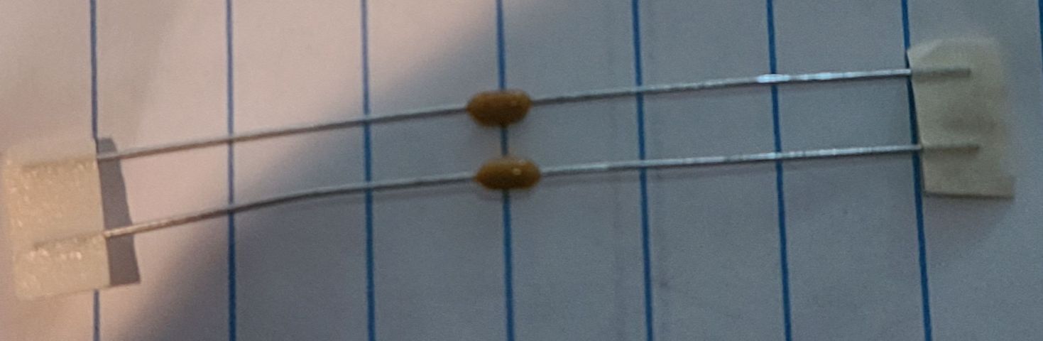

Two of the red ones are 220pF. Four are 100pF.
D'Oh! Attached is a pic of the 2 I am still wrestling w/.

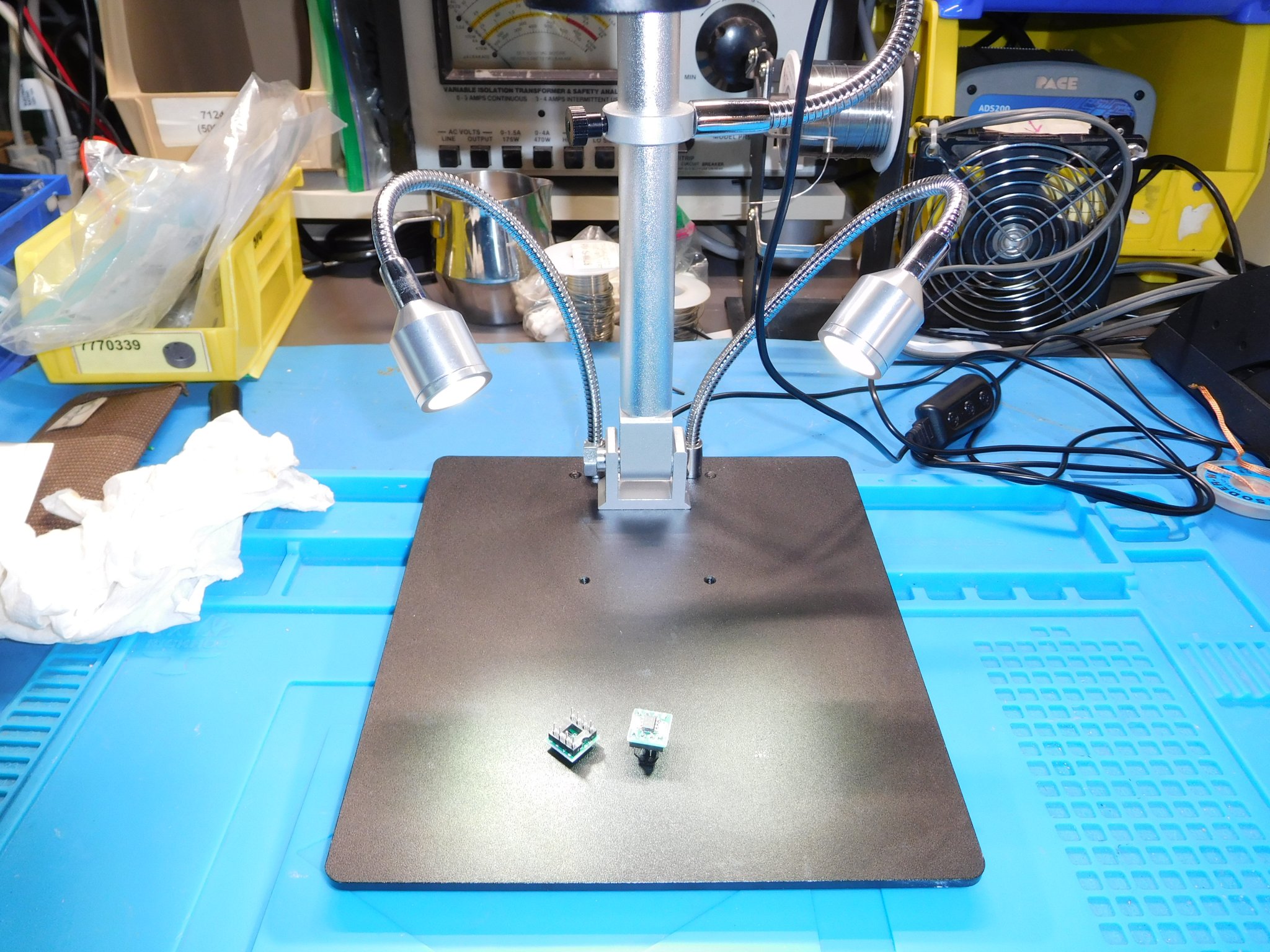

Had a couple of new OPA1656, so mounted them to DIP adapters and will likely try them tomorrow.
@ktf7 - SMD takes some practice, but if you use a good iron, good quality solder, water-soluble flux paste, and good visors or magnifier, it will come quickly to you. I've used mostly a visor but recently bought a nice USB microscope that helps with really small stuff.
