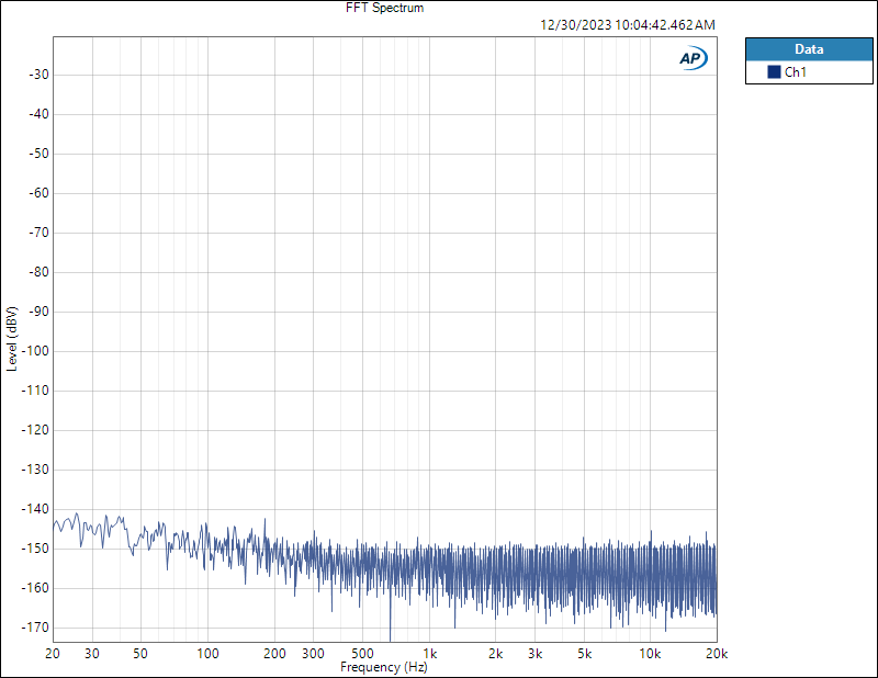

This morning I was messing around with my Hammond 16 Ga steel “cookie tin” and once again measured the noise performance of the P3 Capacitance multiplier (ZTX 457) and cascode (new batch of ZTX851) with a 1000uf capacitor at the Capacitance multiplier position.
See the FFT plot below:
The power line harmonics are all but gone. This is a success, time to move on.

If there is one thing that bothers me about vinyl playback is power supply ripple in my ear. Make the power line harmonics go away, as in can’t see them on the FFT and can’t hear them in my ear I have a smile on my face. Hiss is a somewhat lesser crime.

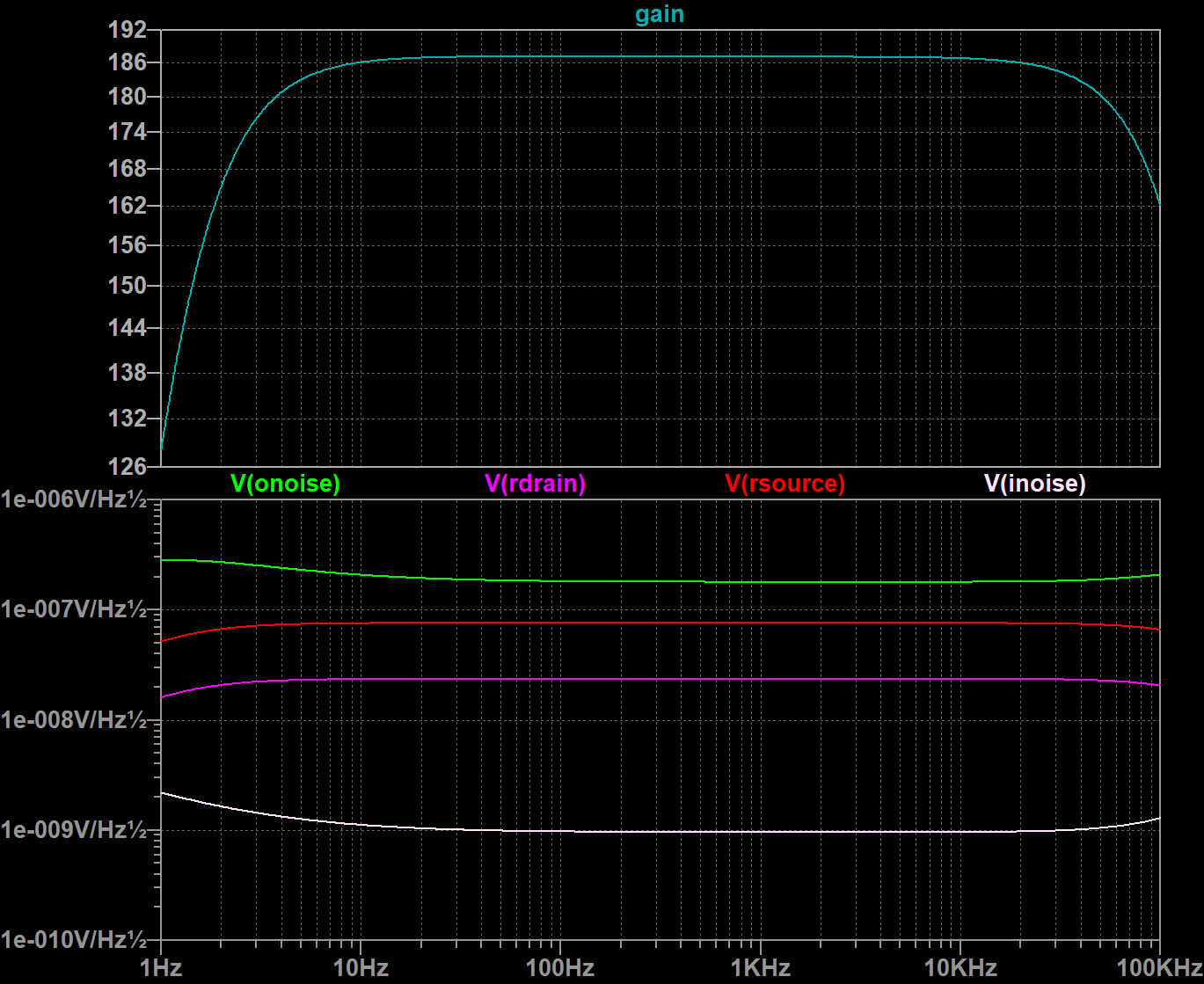

If anything is problematic it isn't the drain resistor, it's the source resistance which is, effectively, in series with the input.Good Morning All,

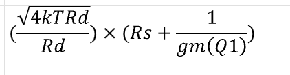

Sam Groner had several informative paragraphs on the noise contribution of gate, drain and source resistors in his Linear Audio article "A Low Noise Laboratory-Grade Amplifier". Essentially, the contribution to total noise of Rd is its thermal noise divided by resistance, the contribution to total noise of Rs is its thermal noise.

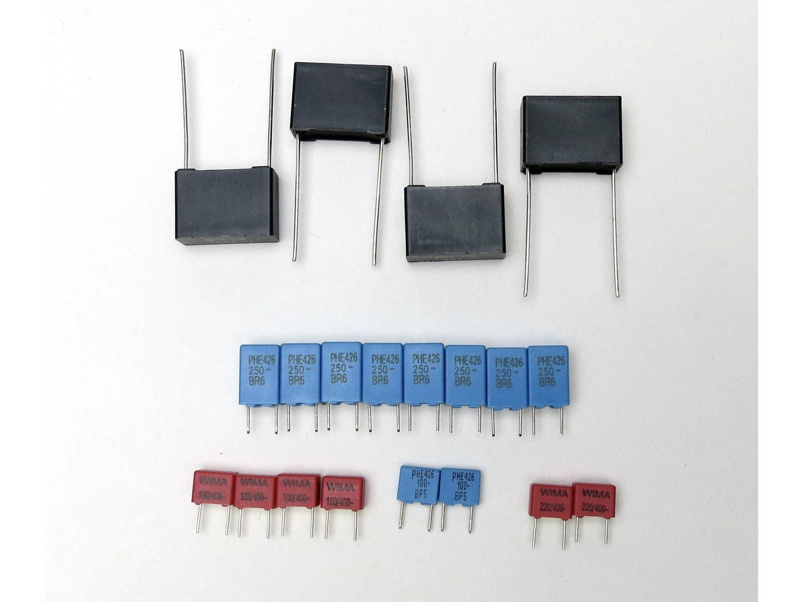

Having a hard time inventorying/measuring some of the caps, numerical count seems right but...There are 6 Wima 100/400, 5 0n flip side, I don't see any qty 6 in the BOM. There are also 2 small non-descript that my meter doesn't seem to be able to measure too well.

The 47k input resistor is shunted by a low impedance -- the cartridge.The Device Under Test is not only the Regulator. The regulator is not the only offender. The raw DC power supply looks to be a worse offender. The jfets and 47K input resistor contribute additional noise.
