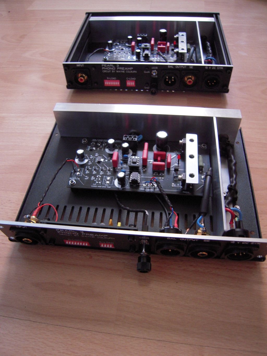

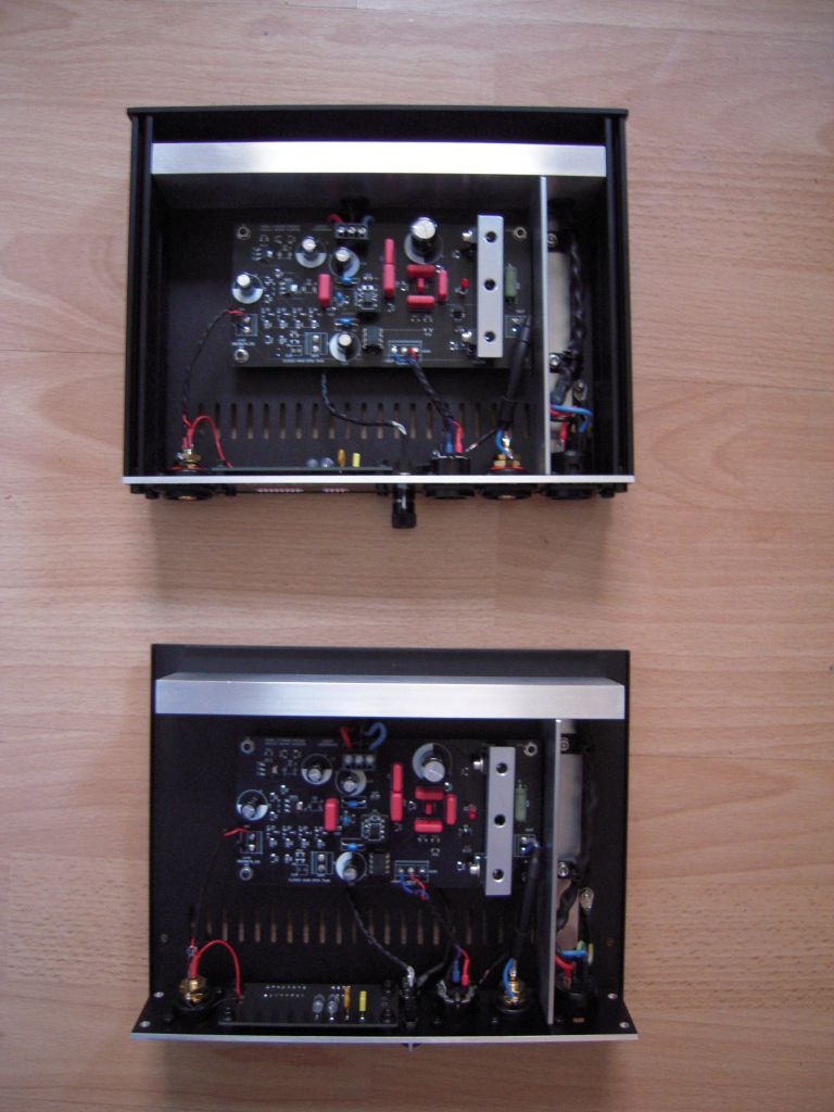

Hello PEARL 3-builders,
I made a few steps forward today. Most of the two PEARL 3 - channels in their seperated cases.
Looking for some good contact between the panels - shielding.
Checked all contacts from RCA-sockets, through the RC-selector to the pcb. As well all contacts
from the pcb to the outputs.
DC - wires also in good contact. No cold solder joints please! I don't want to disassemble anything.
The story of the PEARL 3 - project continues...
Still thinking about my PSU arrangement. All in one - case or crazy dual mono? 🤔
I wish you all a lot of fun with your cases from MODUSHOP / Gianluca. Great stuff!

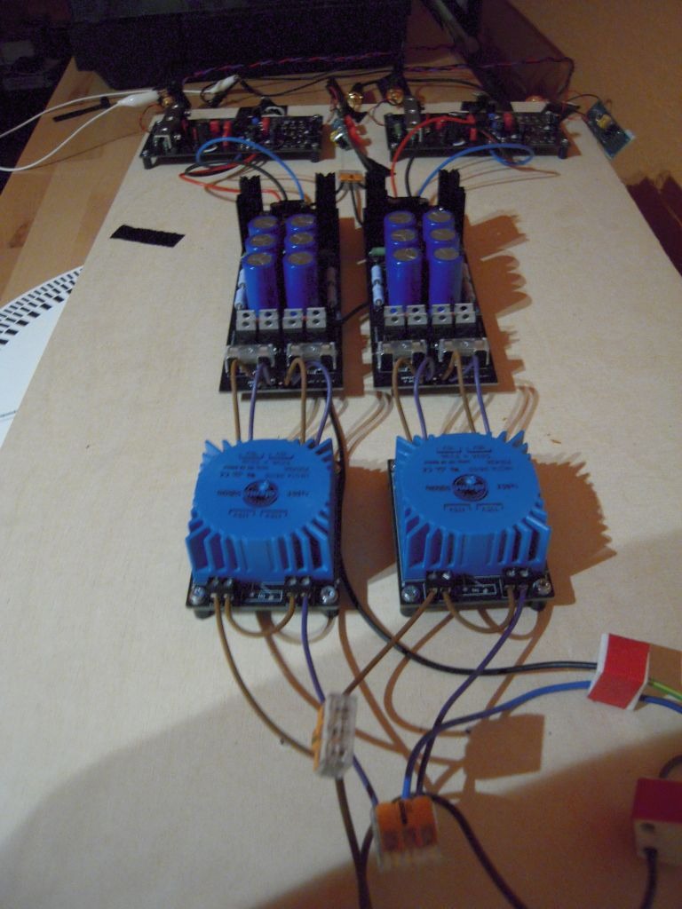

Go crazy. Dual mono.
You could put two PSUs in one case with one AC connection (and signal ground converging on the bridge isolator) but two outputs, one for each channel.
Permutations...
Permutations...
@cubicincher
We're on the same page.
Do you have a schematic for your PSUs? Voltage in Voltage out...

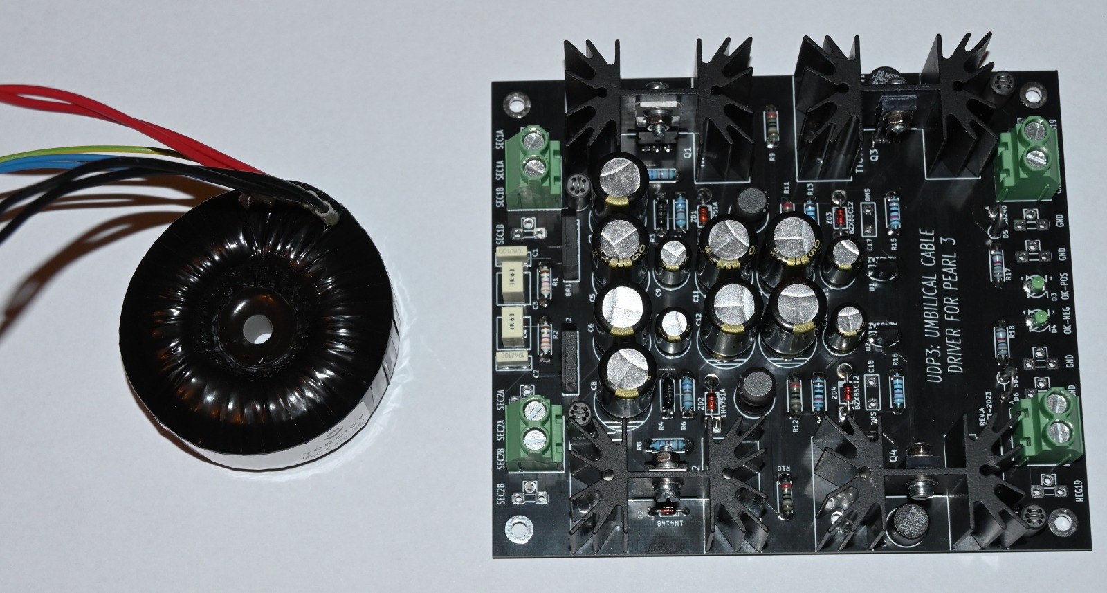

I wonder if some building the UDP3 to be used with kit P3 boards (which have onboard regulators) will build is a dual mono (using 2 x UDP3). Personally I see no advantage doing this as the UDP3 is very "over-dimensioned". And with onboard regulators the change that a signal in one channel can "shoot back" into the other channel is "non-existent" <-- my own conclusion without any evidence. But I would like to see someone that can measure it and show it to me.
Using "only" one UDP3 will ensure both channels regulators get the exact same input (100% symmetry). If I built another UDP3 there would be a slight difference in voltage between. E.g. like 19.3V / 19.5V ? .....and this is measurable 🙂

Just got the 20VA 2 x 22 VAC Toroidy transformer today.
Normally I get large and heavy stuff from Toroidy. But this one I "dig" into the box and a very tiny disappointing little "thing" showed up.
They call it a transformer. OK.....with both magnetic and static screens not much noise will emit from this tiny "thing" I assume. That is at least an advantage. Maybe I can even stack the two P3 chassis without any hum / noise issues. Also it is low profile so can fit into the PSU chassis from Gianluca.

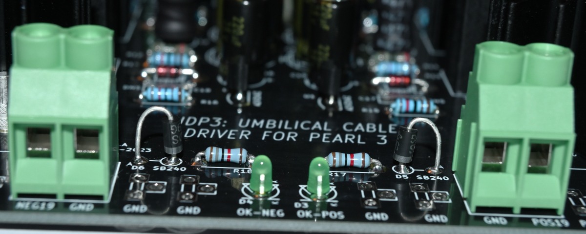

Regarding symmetry I tried to bend the legs on the standing protection diodes the exact same way to have perfect symmetry. I did not quite succeed. Think the left diode in the picture looks a little bit better than the other. I considered to redo it but then I thought......no human is 100% perfect so I "let it be" as is.
But I like symmetry.
