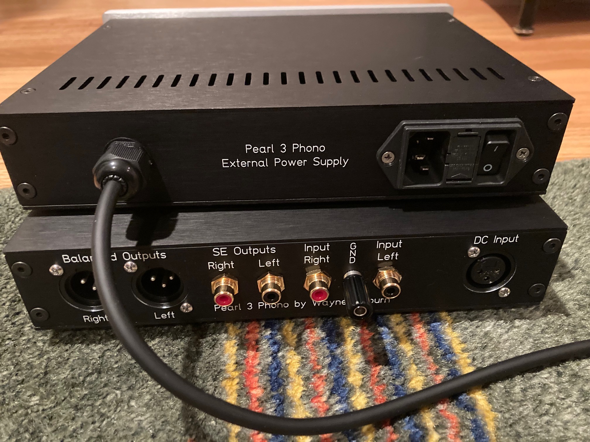

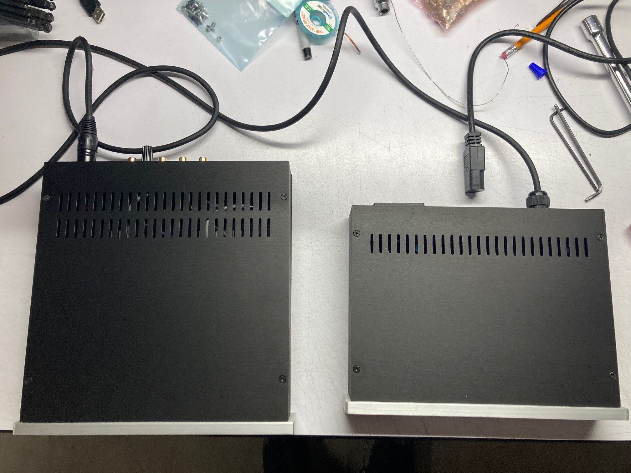

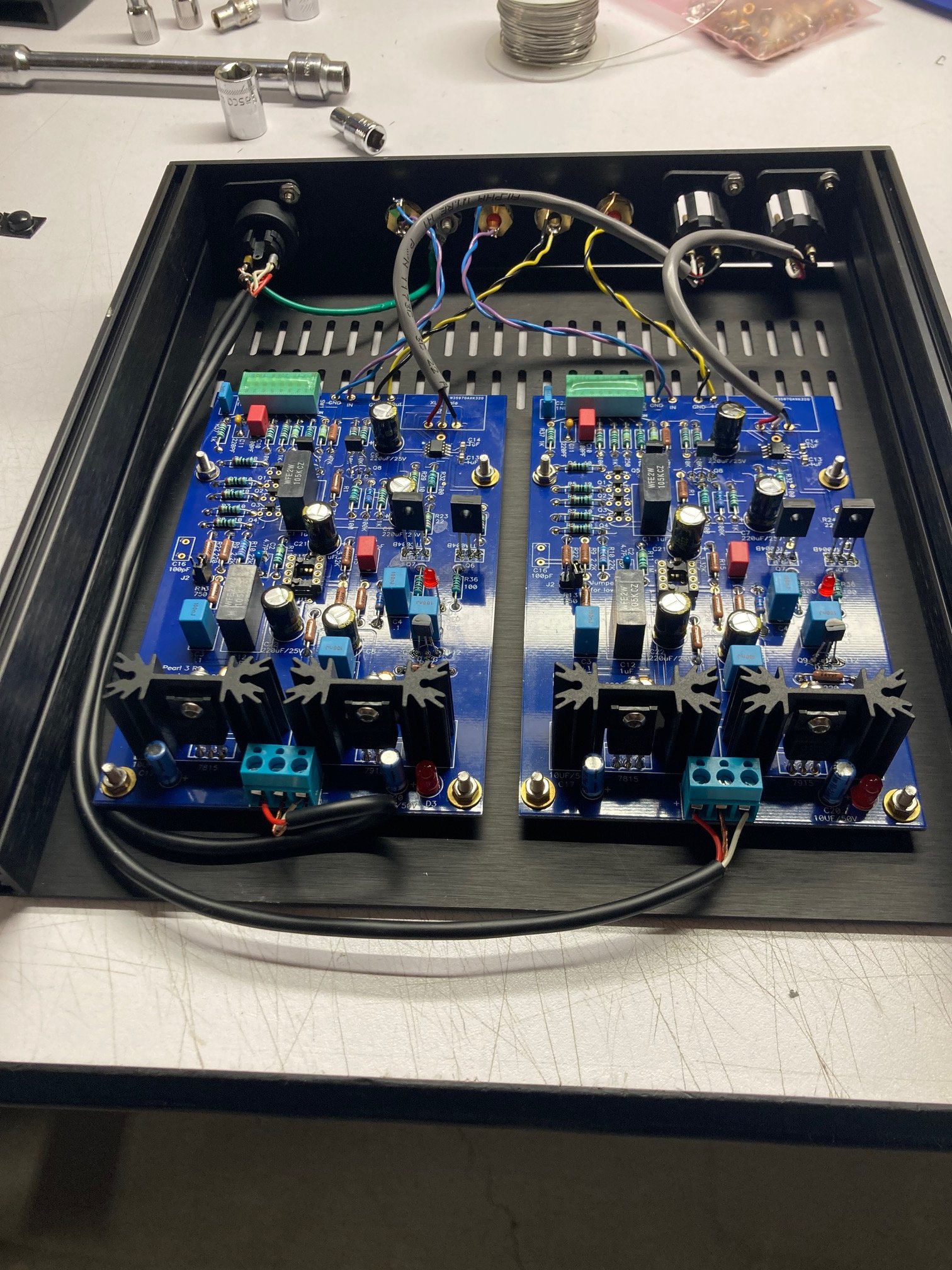

Pearl 3 first impressions, briefly
It took a long time to finish this, but it was a rainy Sunday here in Nor Cal & work & life abided for an afternoon, so. Spent the money a while back to get Gianluca and Randy's fine rear panels to complement a pair of chassis I had on hand, as drilling and milling isn't something I have the tools for these days.

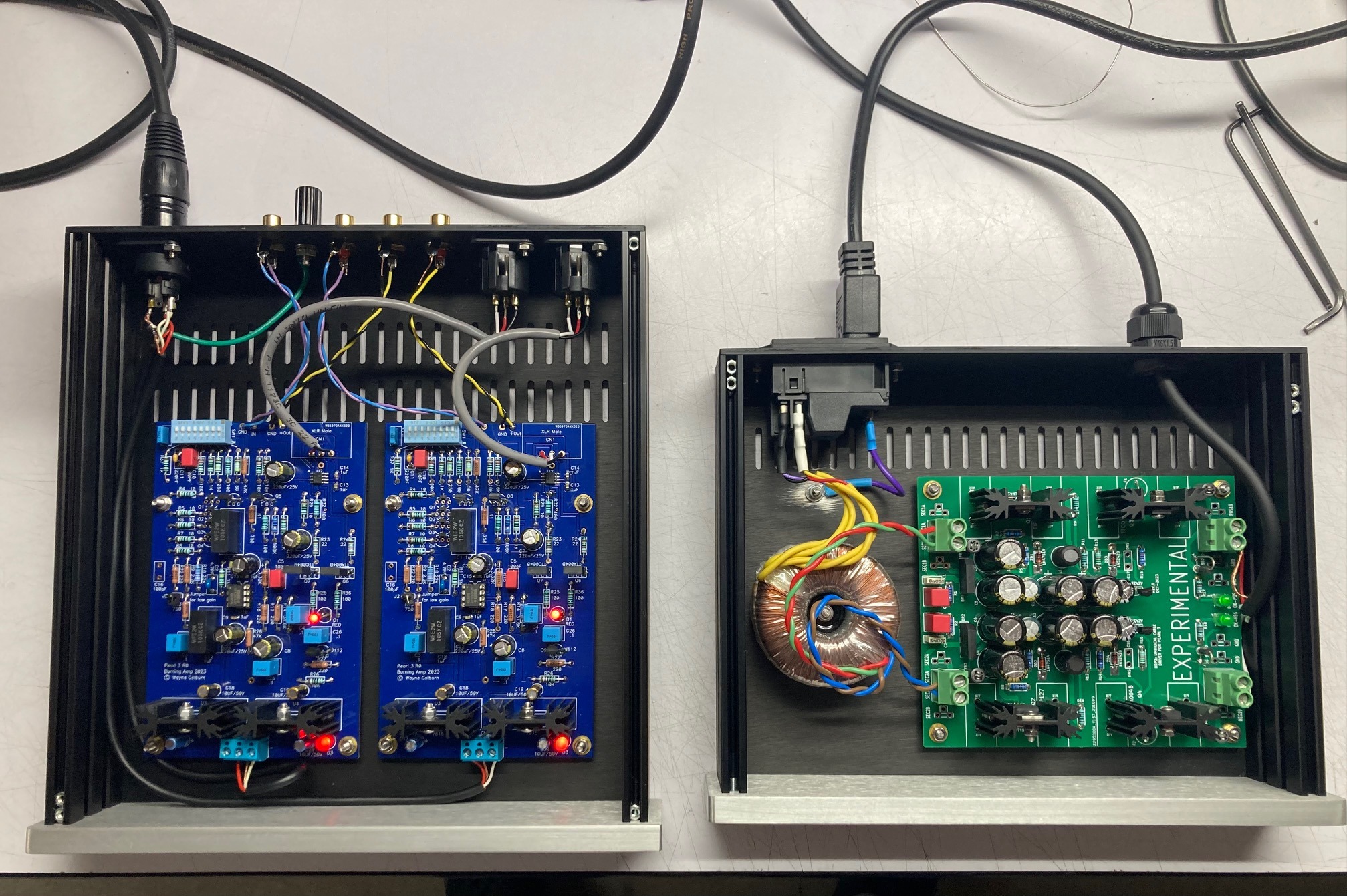

This build uses Mark Johnson's UDP3 in a separate chassis for power, fed to the Pearl using an 3-pin XLR cable, & un-rail fused. Probably illegal.
For first power in the Pearl3 I used a pair of OPA2604 op-amps pulled from a CD player. The bias LEDs did a cute little flicker-on, flicker-off, then steady-on so I called it good & put the lids on. The op-amps stayed.

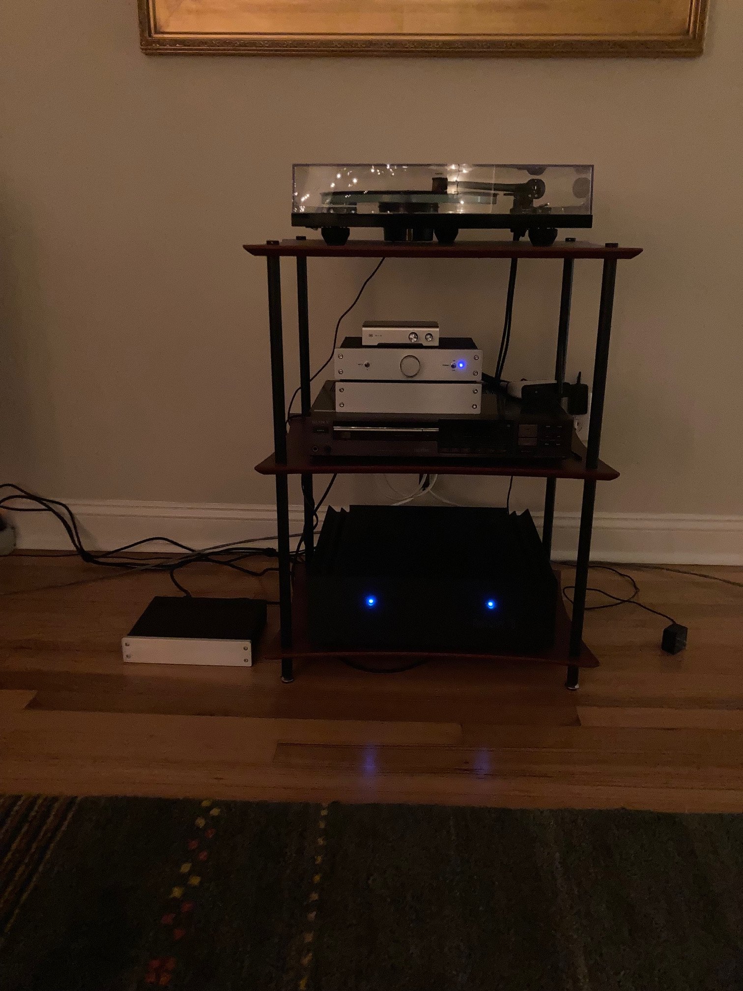

System is a Rega P3 with an Ortofon 2M Bronze cartridge, then the phono stage feeding a B1 buffer, and that feeding a prototype Firstwatt F6, and out to Seas A26 2-ways with series crossovers.
The phono stage I'm used to uses two single op-amps in series & has a calculated gain of 39dB for MM with the resistors I have in place. With that phono stage, the volume knob on the B1 gets routinely turned past 12 O'clock, often up to 3 O'clock. The Pearl3, with J2 closed, has a gain of 49dB if I at all understand the schematic, and any reasonable listening volume is down around 9 O'clock. Big gain difference. I can hear a lot of hum at high volume positions too so the grounding likely needs work.
First sound impressions were of detail, clarity, resolution, soundstage, you name it. No harshness at all. On some tracks the speakers disappeared, or I could hear the recording studio. Amazing stuff.
Unfortunately I only got through Willie Dixon's "Willie's Blues" (an excellent, excellent pressing) and into Jimi Hendrix' post-mortem Both Sides of The Sky before some weird skipping problem developed with my turntable, so I'm done for now until I can figure that out.
But in the mean time, this phono stage is an absolute winner. Thank you so much @wayne and @6L6 for the implementation and concept, and @Mark Johnson for the power supply, and @rhthatcher and @Gianluca for the chassis treatments. Way cool.
