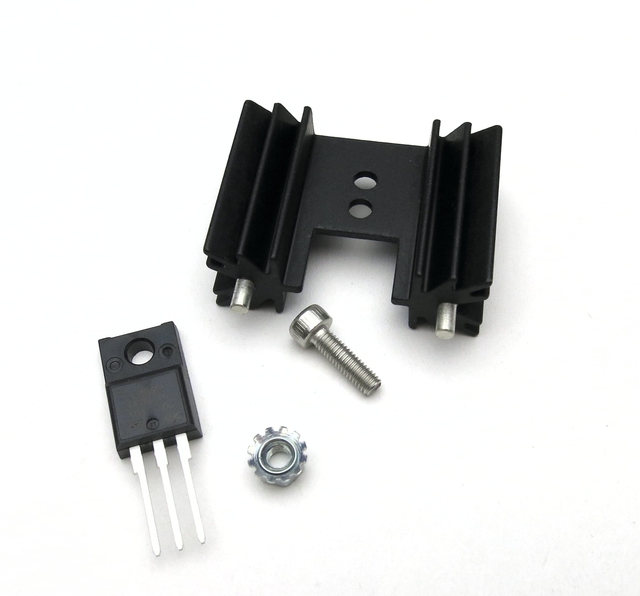

If you will, tell us the thinking about the selection of the plastic coated regulators 7815, 7915, the heatsinks with large notches and two mounting screw holes?

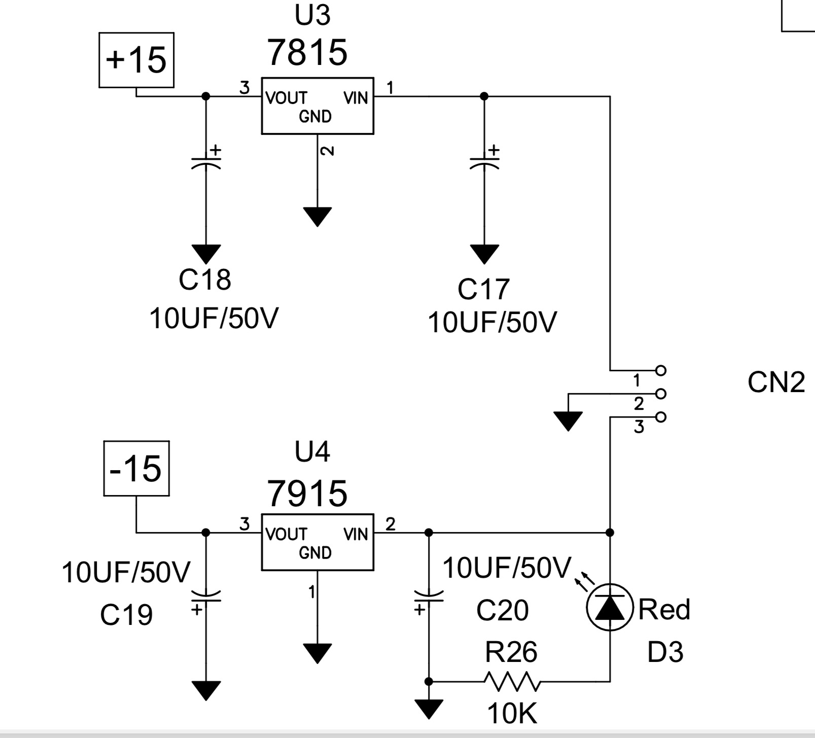

Are you asking about the regulators that are on the schematic and BOM, with the heatsinks that fit in a 1U chassis? I don't understand your question, aside from the obvious answers of, “those are the specified regulators” and “the heatsinks fit the package, the PCB footprint, and the chassis.”
What are you getting at? Please clarify if this didnt answer your question.

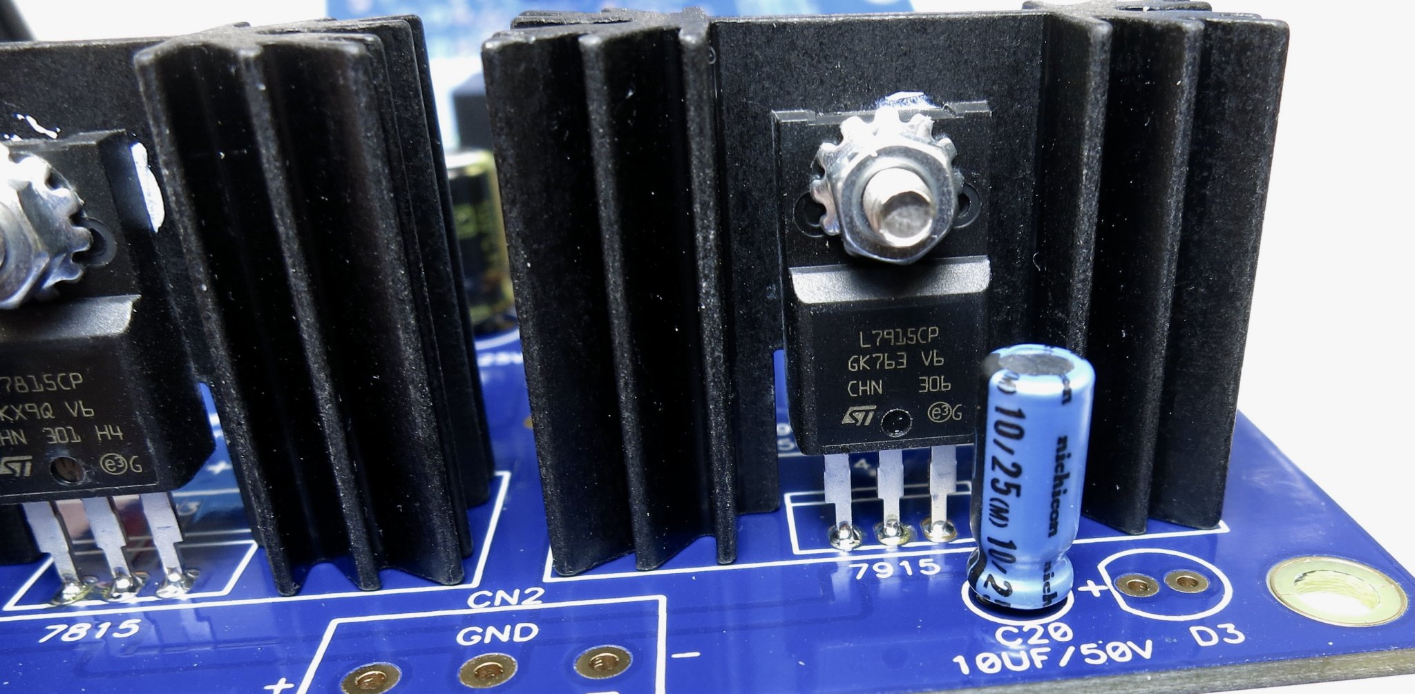

The specified heat sink is this one: 531002B02500G.
https://www.mouser.com/datasheet/2/2/Aavid_01112021_Board_Level_Cooling_Extruded_5310-1953660.pdf
The heat sink in my bin for use with the in hand Burning Amp P3 PCB’s is this one: 513002B02500G
https://www.mouser.com/datasheet/2/2/Aavid_01112021_Board_Level_Cooling_Extruded_5000-1953731.pdf
The extrusion shape is the same for both. The specified item has two mounting screw holes and a larger cutout where the regulator attaches. (reduced surface area for attached TO 220)
Just wondering a bit, why one over the other?
The specified 7815 and 7915 regulators have a TO-220FP package with an insulated metal tab.
Also wondering a bit how this was specified over the regulators with an exposed bare metal tab?

I like the epoxy encapsulated ones so you don't need mica if the case is hot. It isn't really critical on this since with even 24 volts input the regulators are running at .5 Watts.
With very quiet input for the regulators is there any benefit thinking about using some of the discrete "drop-in" replacements regulators?
There are many of these. Only a few have very good documentation. One that has good documentation is e.g. Sparkos. They also do discrete opamps.

The regulator I have been using to power the P3 breadboard first stage runs at just a few degrees above ambient without a heat sink.

The other side of the coin is also true. With a much improved PSRR Regulator you do not require a very quiet input.
