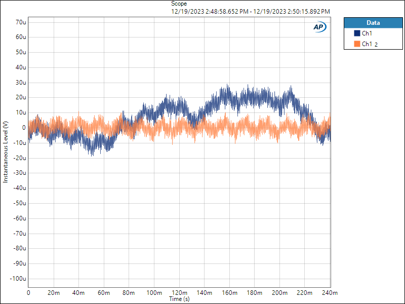

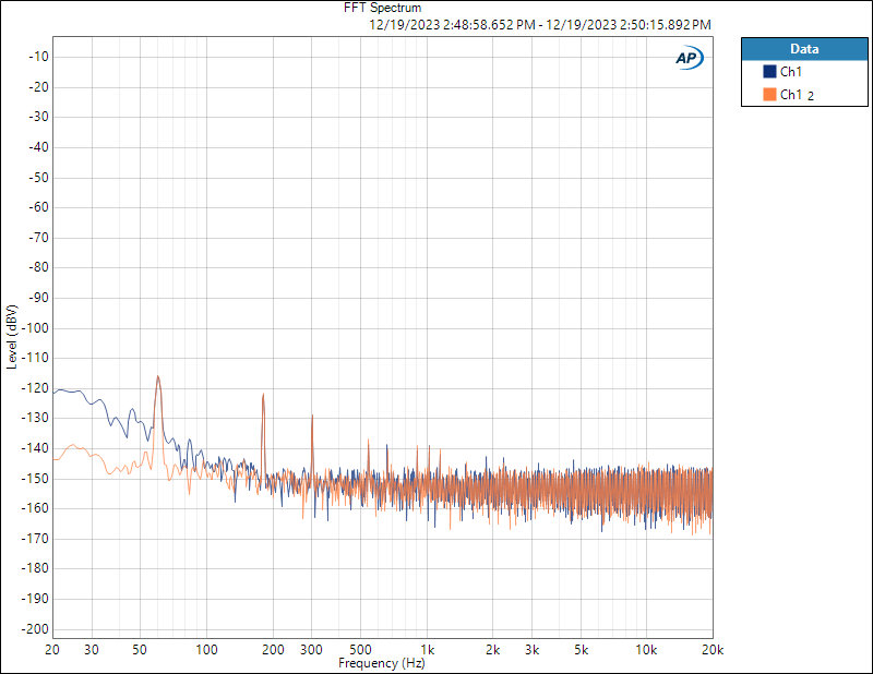

For grins I have assembled on perf board a LM7815 and a Sparcos 7815 3 legged supplies.
Both supplies are operated into a breadboard of the P3 input stage.
The raw supply for both is a TRIAD 18volt DC wall wart. See the attached AP scope and FFT plots.
The LM7815 regulator is much cleaner.
Thanks DT
Orange is the LM7815 regulator.
View attachment 1248884View attachment 1248885

Looks like 1/f noise to me.

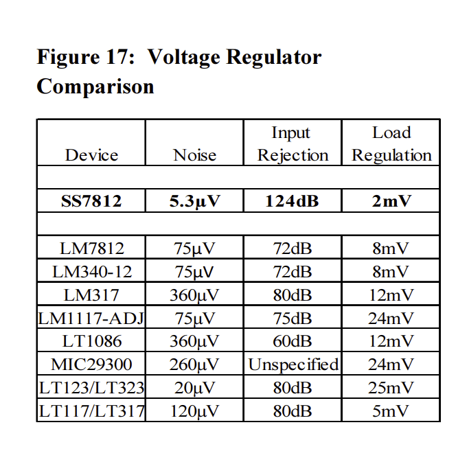

They show this table in the data sheet and there are also some written information:
It is a 1$ device vs. a 45$ ....so a buyer would expect to get something for his money 🙂
If it is a 7812 or 7815 should nok make any difference regarding the table above.

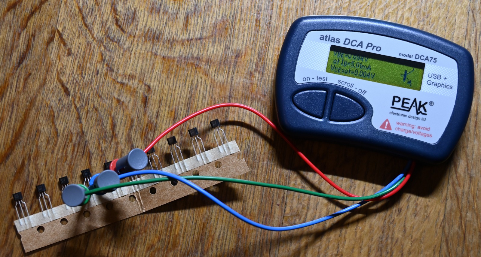

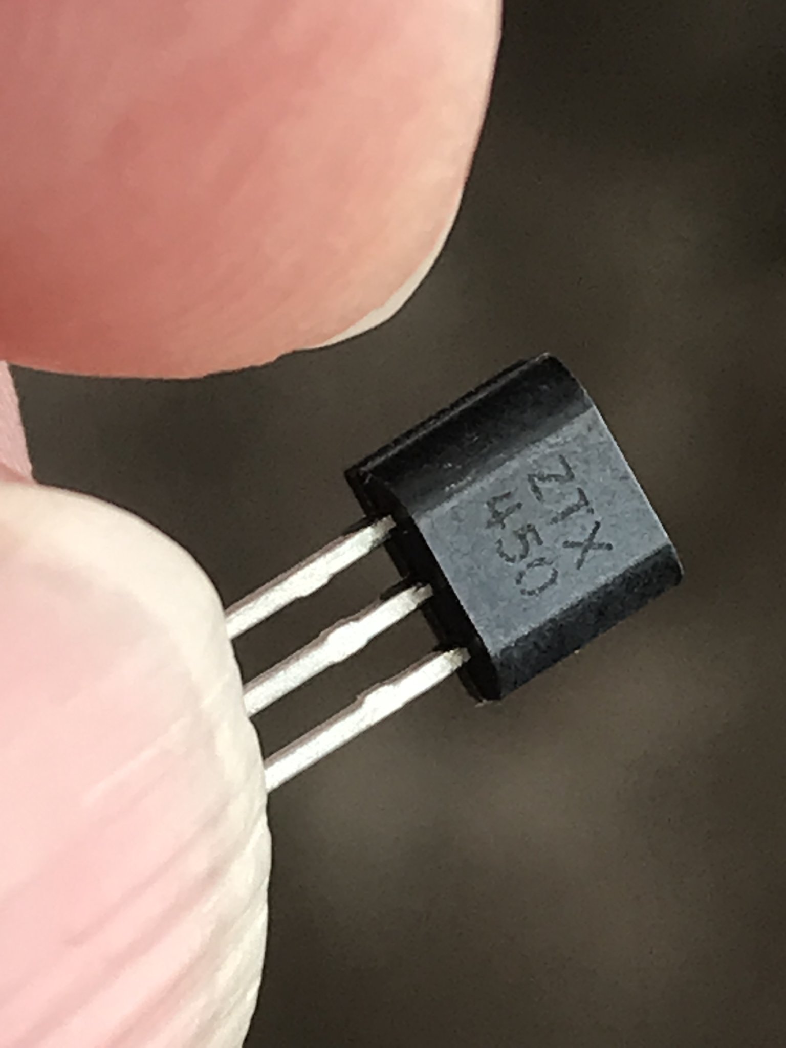

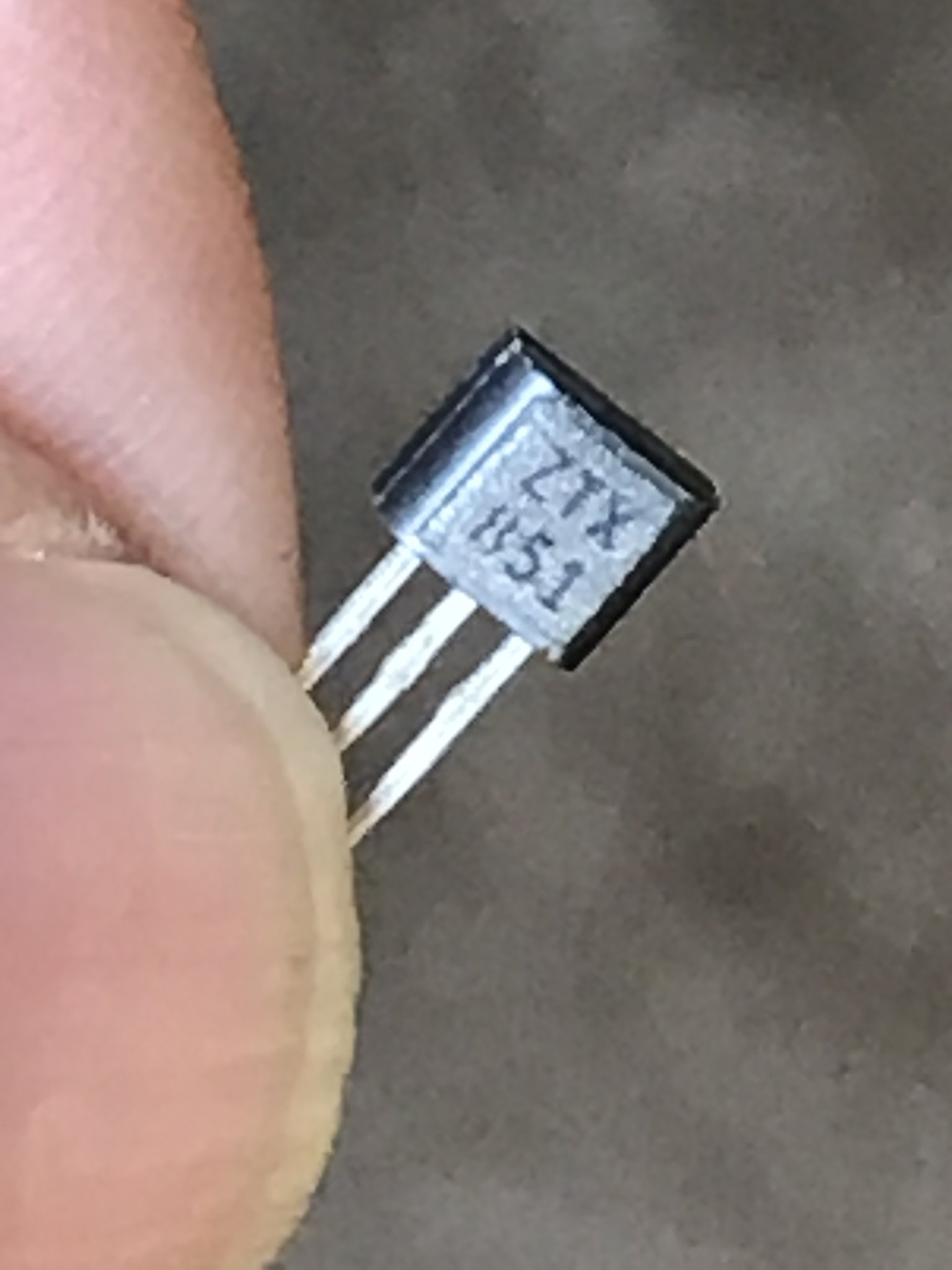

I took a chance and bought some supposed ZTX851 from "littlediode_uk" on the auction site. I received them yesterday and I suspect they are fake. The other ZTX transistors I have are marked by laser etching. These are marked with negative relief paint. Compare the two photos below. Does anyone have definitive info?
I way to get a feeling if it is a ZTX851 is to measure Vce (sat). It should be quite low because it can handle high current (5A) continuously.
With Peak instrument Vce (sat) at Ic = 5 mA was about 4 mV. It will raise to about 250 mV at 5A where max. dissipation is about 1.2 W.

Sparkos responded back with this answer:
"yes, that is interesting as our devices should have lower noise. Im not sure where or how it was all measured, like if the regulators were measured directly or if he was just measuring the output noise at the RCA outs or something, but, if you can send a schematic of the whole unit I can take a look at it and see if there is something going on that is degrading the noise performance of the discretes."
If you have a schematic drawing I can send it back for review.
Maybe interesting for others having plans of using the Sparkos regulators for P3 build.
I myself have two sets on the way from Audiophonics in France.
Take a look at the Pearl 3 schematic.
The measurements were taken between the collector of Q5 and ground.
A single 1000 Ohm resistor was put in the place of the jfets.
My goal was to get at look at the noise performance of the 7815 regulator working with the NPN capacitance multiplier and cascode.
The raw 18VDC supply is a TRIAD switching wall wart.
My impression is that the capacitance multiplier and 7815 do a fine job together as specified.

I think I can read from latest response that he doubt the test setup / equipment used is able to actual measure the noise from the regulators itself:
"If we try to measure the noise of the regulators directly, that typically requires a noise amplifier circuit to gain the noise up to the point that it becomes measurable.
My noise amp is home made with a gain of X1000 which is needed to get it up to the levels that oscilloscopes can measure it."
