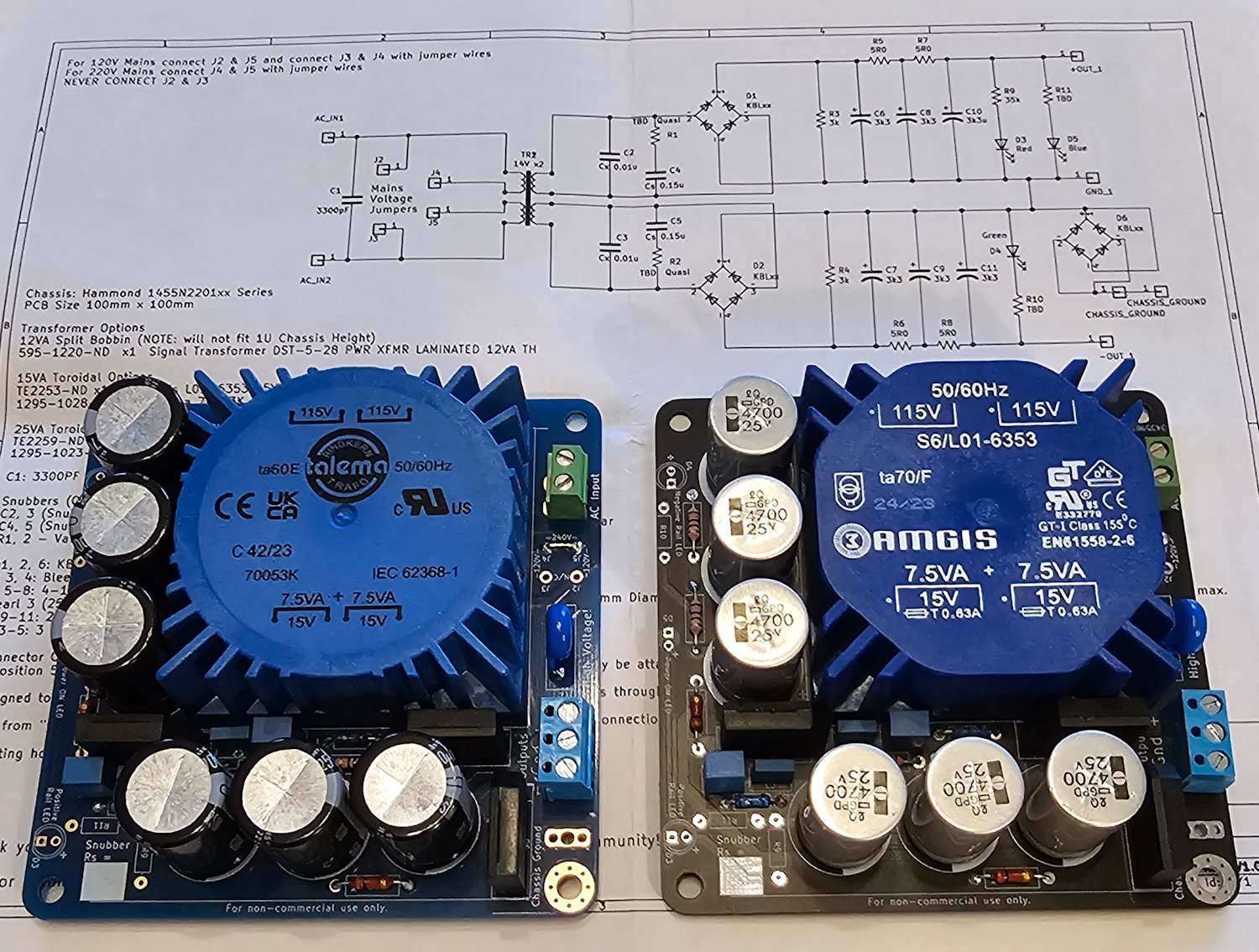

I had this kit(s) for a long time but some months ago I set my TT asaide... it was a mistake.
Some days ago I rediscovered the TT-sound and decided to build the Pearl 3, finally.
So, the psu took one and a half hours to finish, and now to the amp boards 😀
Here the psu boards, left the original kit, the other one is from @rhthatcher

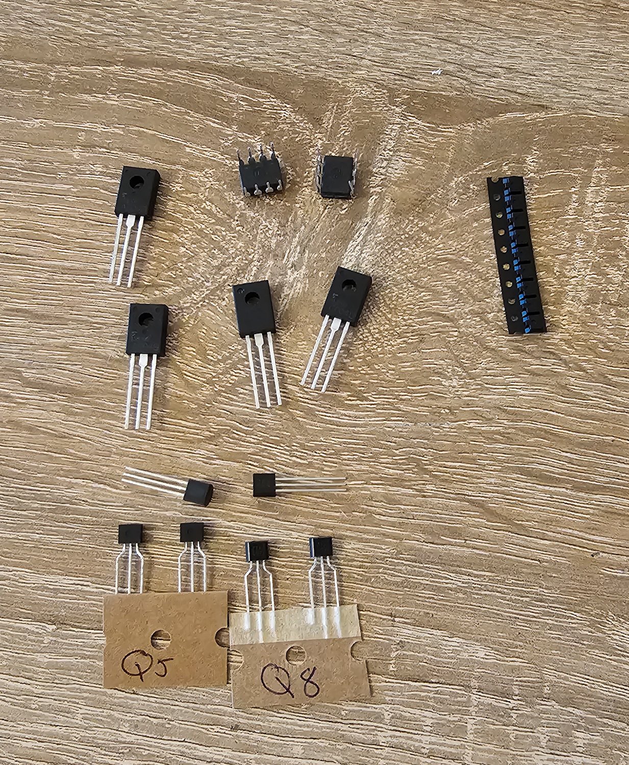

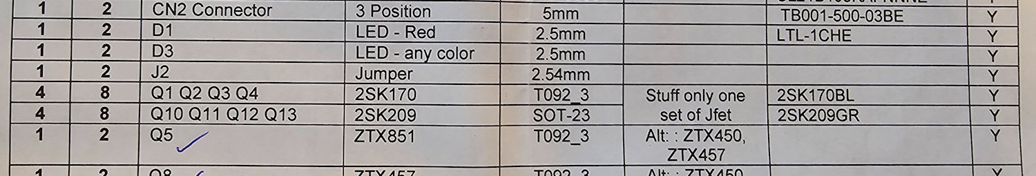

Okay, it was a fun day - minus mounting of the Sado-Maso-Devices... and the fact that there are no 2SK170 included, but according to the BOM in the kit they should be there... 🤔
(looks at printout for kit)
Oooh... I need to fix that. Thanks! 🙂

No, I don't use the damn smd jfets... you can have them for free if you want 😀damn Wiennamese ....... he wants to cheat, to get double JFets
Problem: where to get 2sk170? I know, from the shop, but it costs an arm ang a leg until it's here in Europe, unfortunately not justifiable.
Is the LSK170BK an alternative?
Use the Toshiba 2SK209's. The circuit was intended for them. They are sitting on your bench right now. The other component values need no modifications.
Genuine Toshiba 2SK170 can be had from seller Punkydawgs on eBay, send a note and ask for the lowest Idss quads he has.
Yes, you could use the LSK170 from the store, get the lowest Idss.
If using any 170s, change the source resistors to 22R.

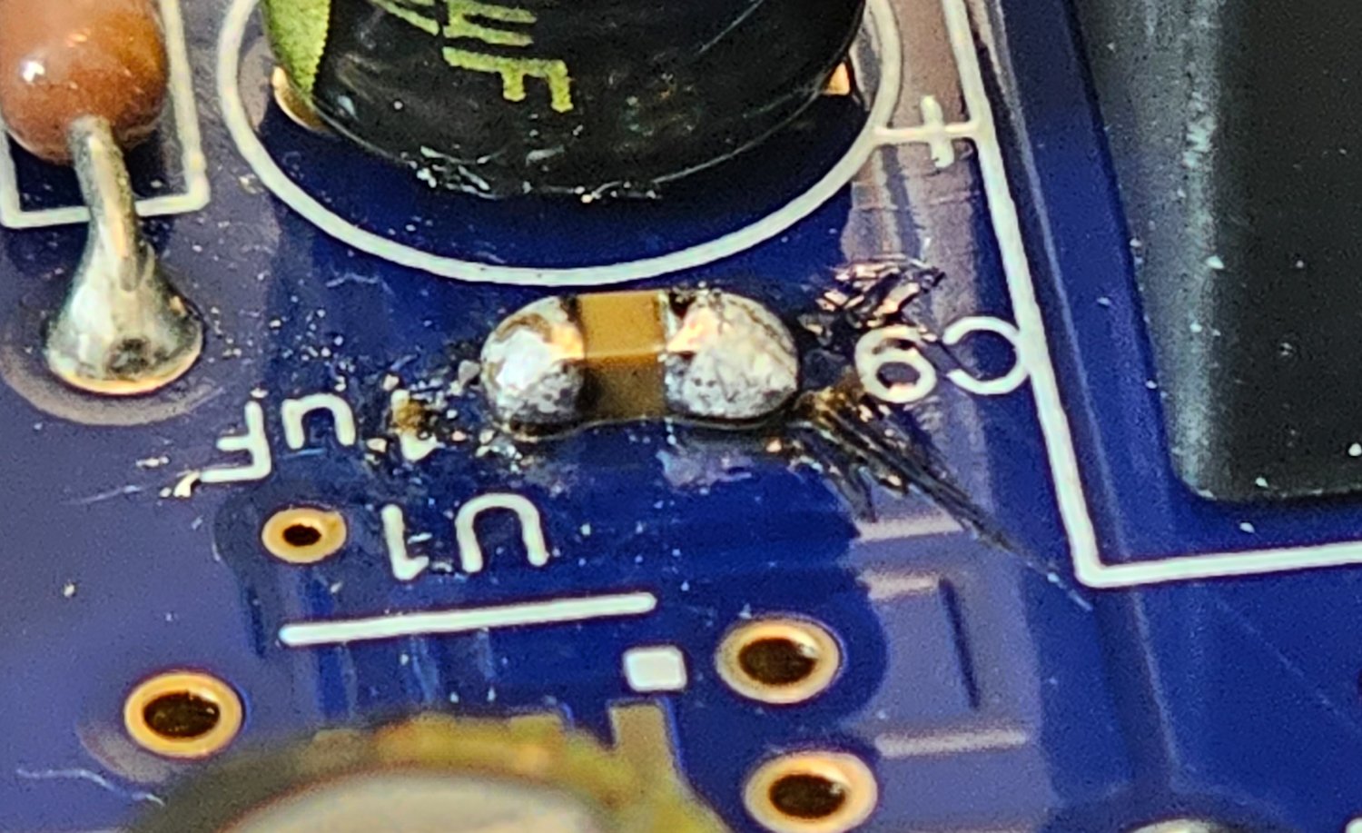

SMD is... tricky, I fear I can't do it properly. But maybe I'll give it a try. Many thanks for the advice!
Here is my smd-art 😱 I don't know if the cap is caramelized...
You must tape the device in place if soldering with a normal iron. Wet the tip, place the tip so it will touch the pad and the lead, and add a bit more solder than has a good flux.
If you are using lead-free solder, well, best of luck, you'll need it.
liquid helper flux is way to go
lead free, only for masochist ........ and those having spare smd parts
