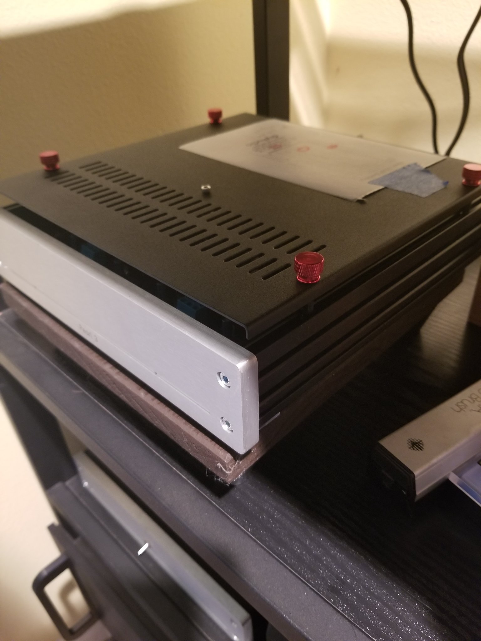

Just before I ship it back... this is the V2 of the P3. This one has all SMD... hence the "Super Mega Deluxe". i haven't opened it, but I figure the boards must be stacked inside.
Mine is the v3, and that one is made for op amp rolling... Note how I use thumb screws and spacers to make room for the big Bursons.

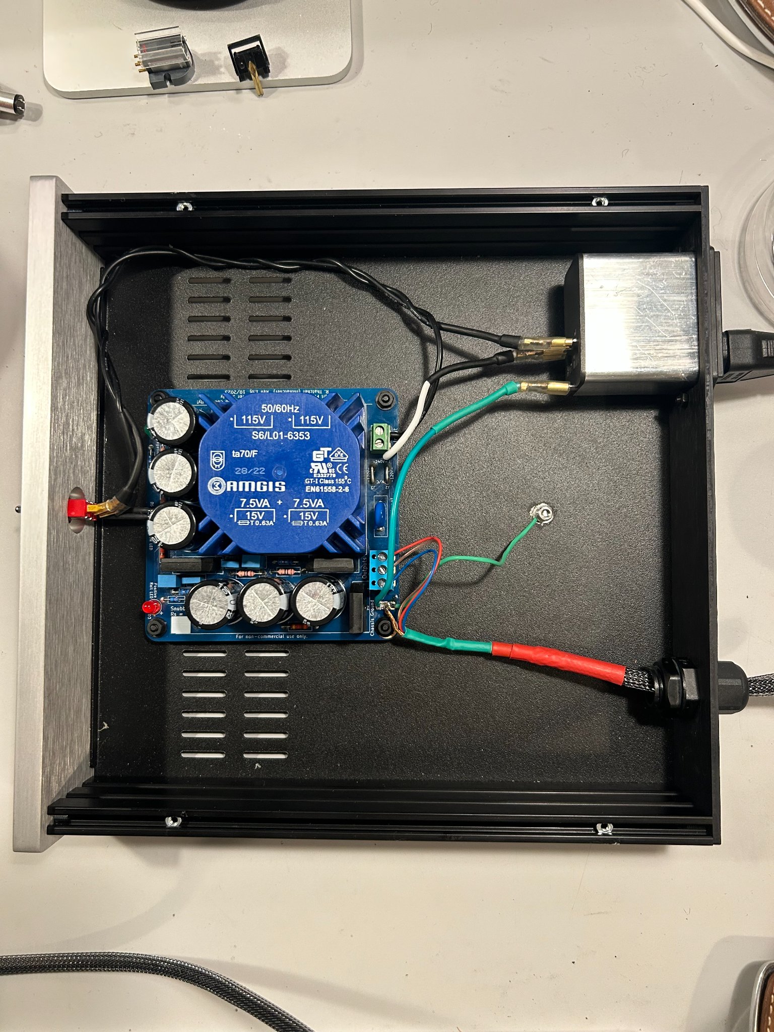

Still at this final wrap up...Power supply is now working as it should, even though the on-off symbols on the schurter were reversed(!), now fixed with a bit of fancy graphics and a reprogramming of my brain to forget which way On should be LOL. .

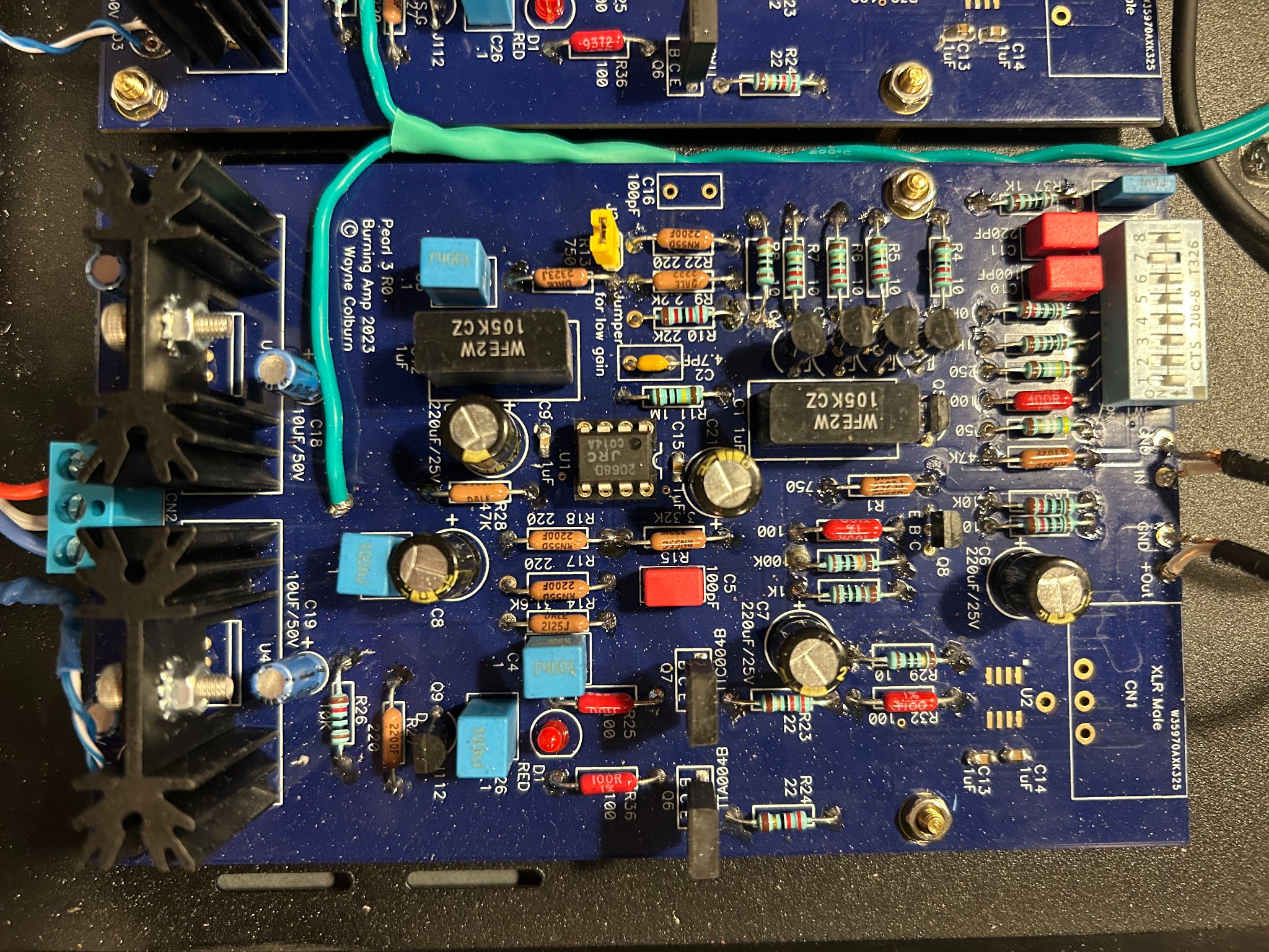

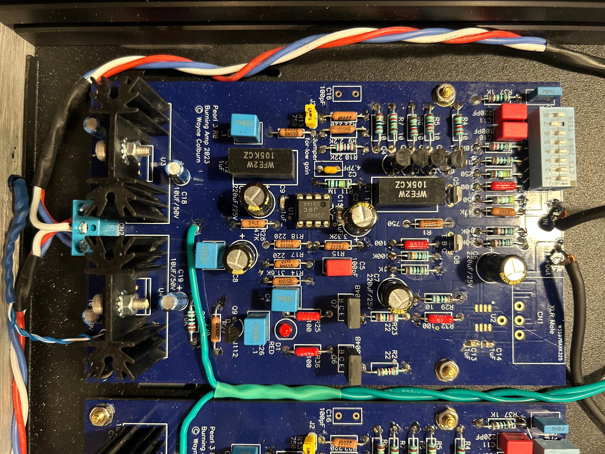

Started testing the phono stage. I'm getting 19.36 on + left side, and -12.71 on -. On the right side, 19.49 on +, and -12.74 on -. Thought they were supposed to be the same or darn close?
R27 left is 1.67, and R27 right is 2.2.
Seems like something might be awry here....I'm not seeing any bad solder joints (of course, my eyesight is even worse than it was 4 weeks ago. This is the speed at which certain blindness can attack. I think I've got less than a year of sight left at this rate). I can try to take some pics tomorrow if necessary, but not sure what would be important to photograph. Help, as always, is greatly appreciated!
I'll try to get some pics tonight, though I've been given time limits on hobbies by the wonderful partner, and i think there are plans made...
It would seem that the problem would lie in my umbilical (a phrase never before uttered in the history of the english language), as the rail voltages are spot -on coming off the power supply board, and wacky as they go into the phono boards.

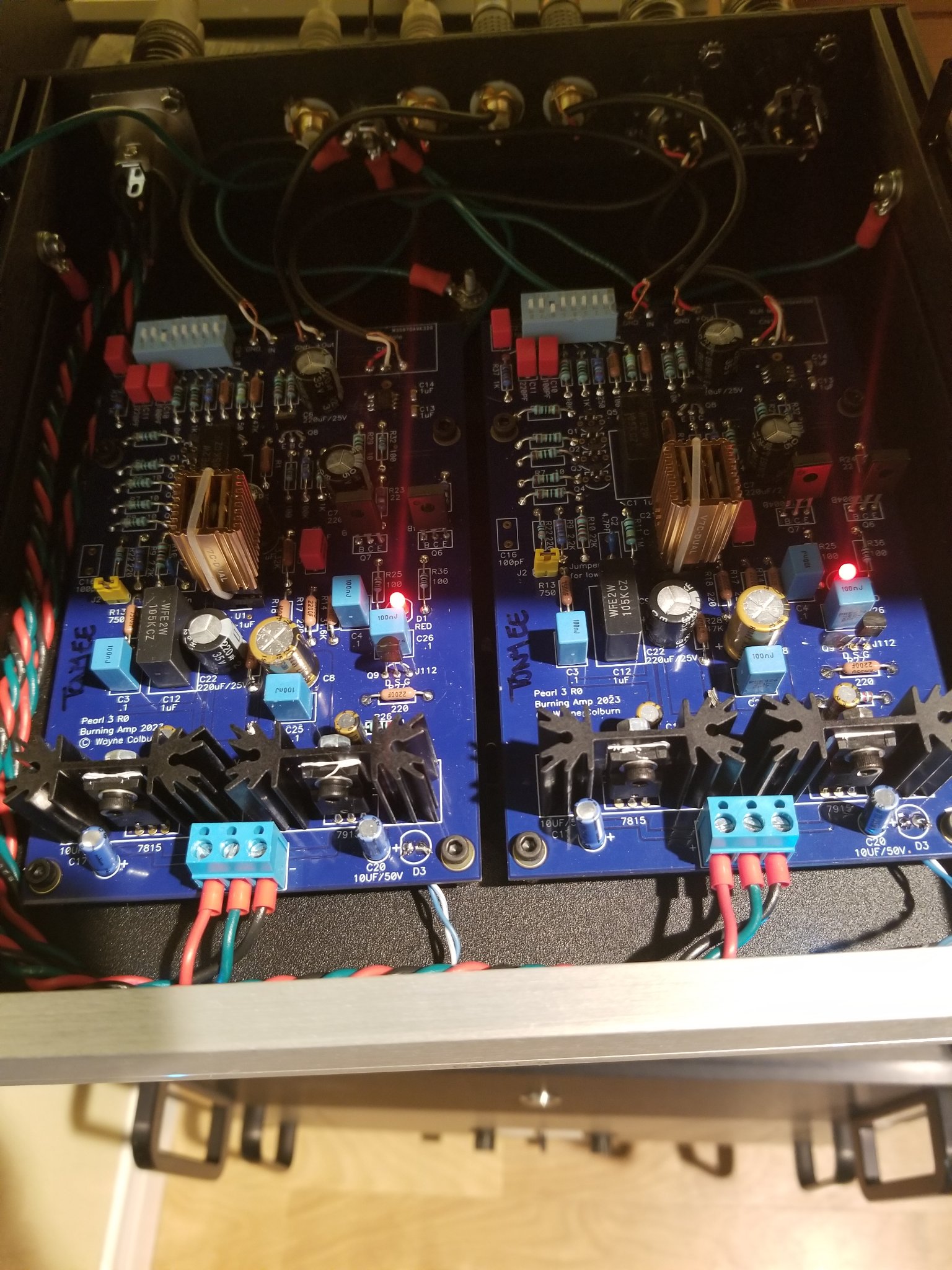

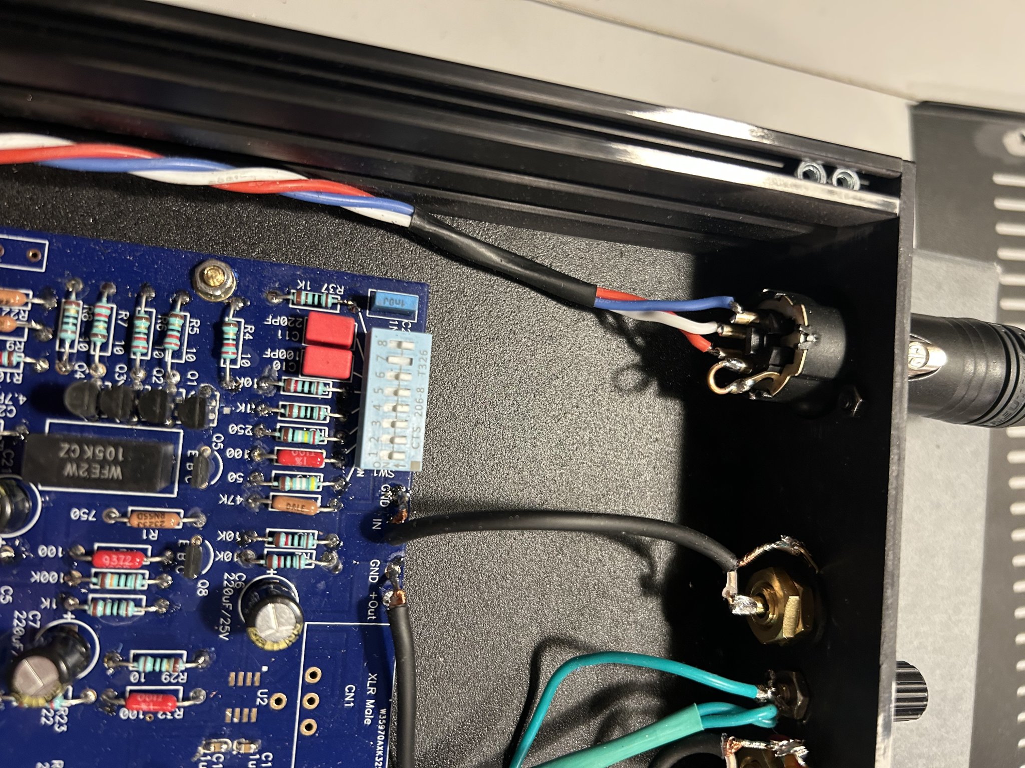

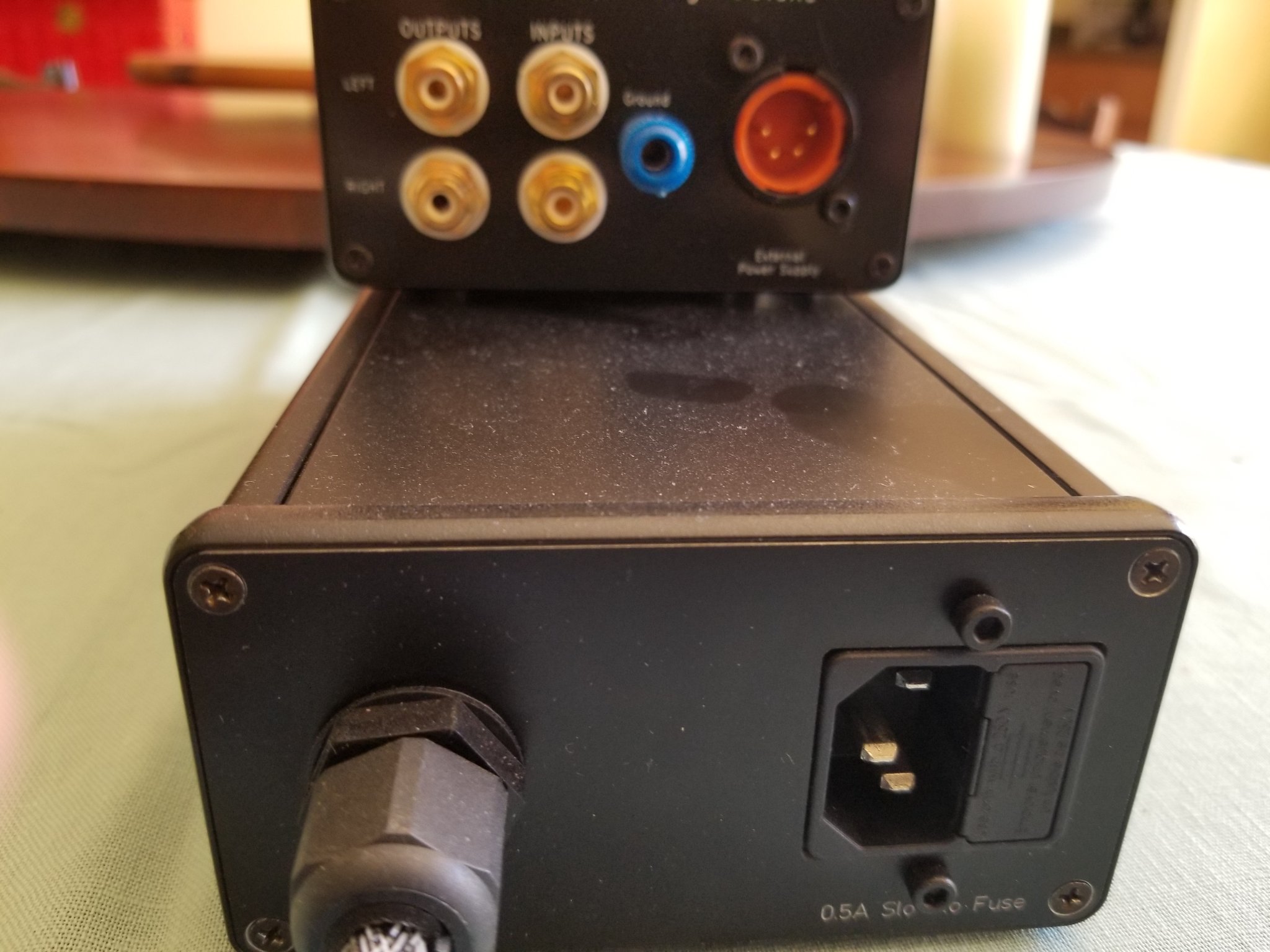

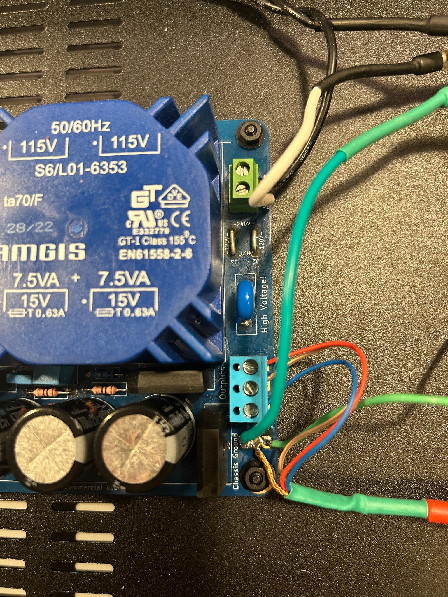

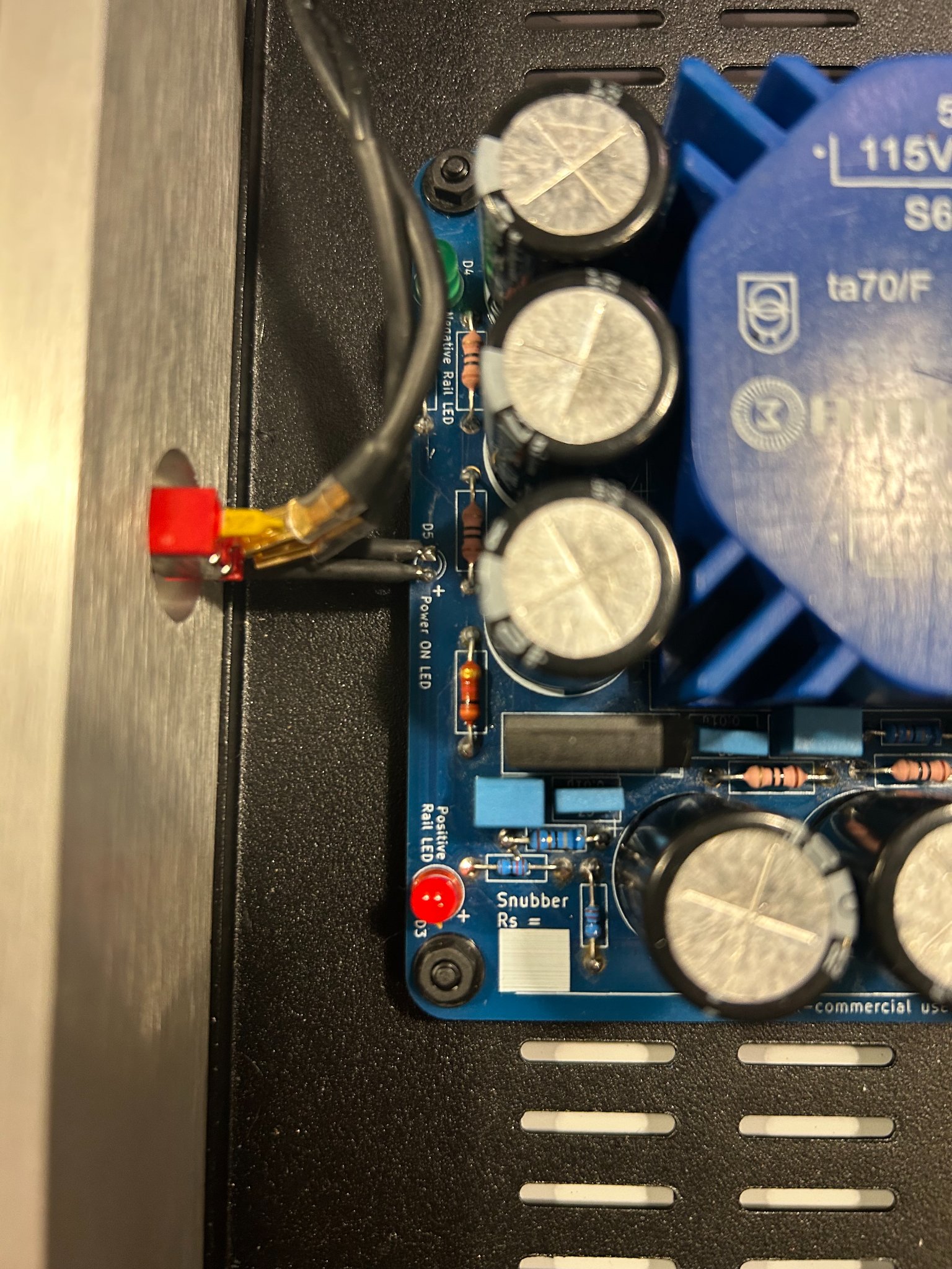

Rail voltages seem wonky. Please post pix of the power supply box and the phono box.
I apologize for the quality of the pictures, and most likely the sloppy soldering: I'm losing my sight quite quickly, and along with the disintegration of my fine motor skills in my fingers, I am really running out of time to get this right (or at least workable). Please let me know if you see anything that looks awry!

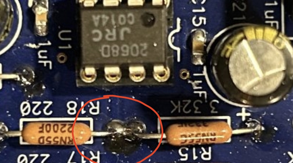

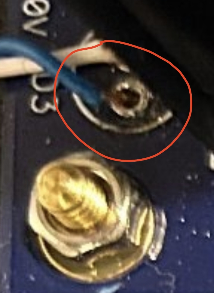

From highlighted pics above in #5347, R15 and R18 share a trace at that point anyway. No worries.
If the LED works, I wouldn't give it too much thought.
First I respect that your vision isn't in top form. I have vision trouble myself. Thankfully, mine is only a slow age-related decline. I am so sorry to hear of your situation. So, my attempt is to provide what I'd do to only need to fix it once vs. need to iterate.
You have too much current running through the Op-amp. I ran into a similar situation with my build (K170 also, but my Idss was likely much lower). So, my rails were mismatched a bit, and the PSU was sagging on the negative rail.
As soon as I set the current to specs through the op-amps by altering R27, voila.
So, unless others have a more plausible thing to try... what I'd do first is consult the exceptional build document, which says:
"U1 Bias notes. Remember Ohm’s Law V = I * R Therefore, I = V / R Assume 220R resistor in R27 position. V = I * R = 2mA * 220R = 0.44V and V = I * R = 5mA * 220R = 1.1V If you measure between 0.44V and 1.1V with R27 = 220R – you’re good to go."
You have double the maximum current through the right, and you're ~50% over on the left with your existing 220R in place for both channels.
Choose a target. Why not smack in the middle at about 3.5 mA or close. That will possibly prevent you from needing to change that part twice if you don't get it low enough.
After you swap out R27 for both channels, see if your PSU starts to play nicely. If not, look further.
Related, but separate - If you know the Idss of the K170s you used, others may have you take a look at adjusting R10 to reduce the current through the parallel JFETs. That's a tad beyond my personal expertise to give direct guidance. Me, I'd just measure the current though them and toss in a source resistor to get it where I wanted, but ... it's best to consult an actual expert that knows the circuit to see if that may help vs. a solder slinger like me.

The idss of the Todhibas is 8.5mH. R4 through R7 were changed to 22r from 10r.
I need to learn more about how all this stuff really functions. I know that's a basic formula, but i'm not sure i understand how it actually works. I've got a 315r 3watt in the drawer i could try...
No........ Those Toshiba´s are 8,5 mA idss..... not mH. Not to worry. With R4 to R7 = 22R you have nothing to worry about.
And NO........ Replace R27 with 680R/½w. 0.5w resistor for R27 is more than fine. And expect the voltage over R27 to rise a little
when increasing the resistance. I ended up in one of my builds with R27 = 815R to get 3.9mA 😉
