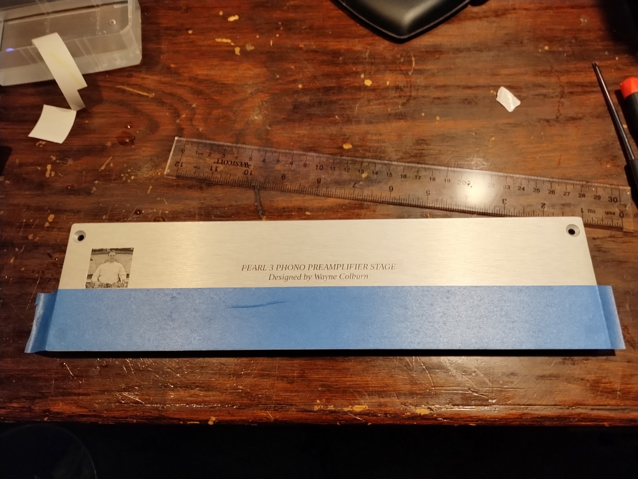

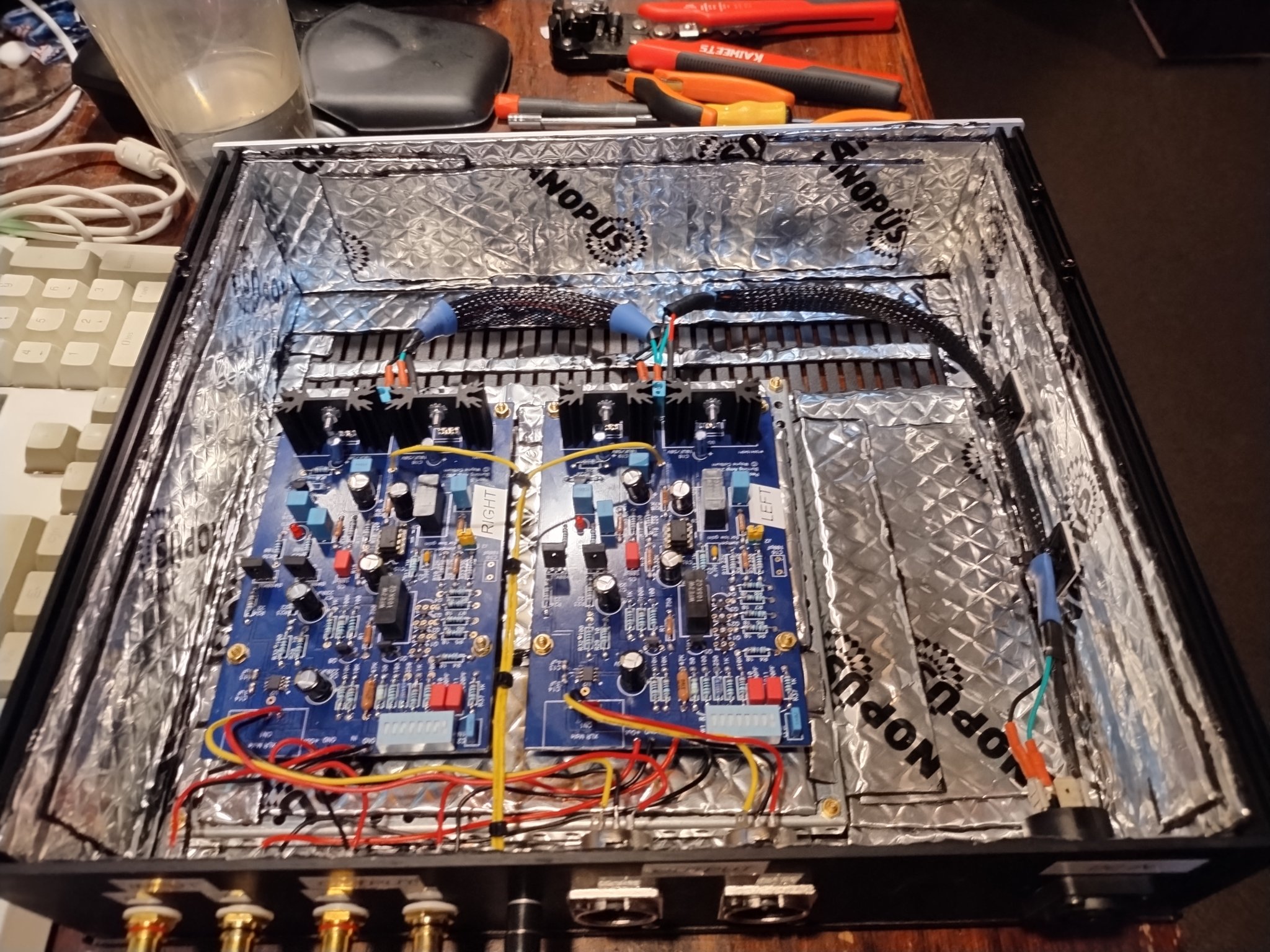

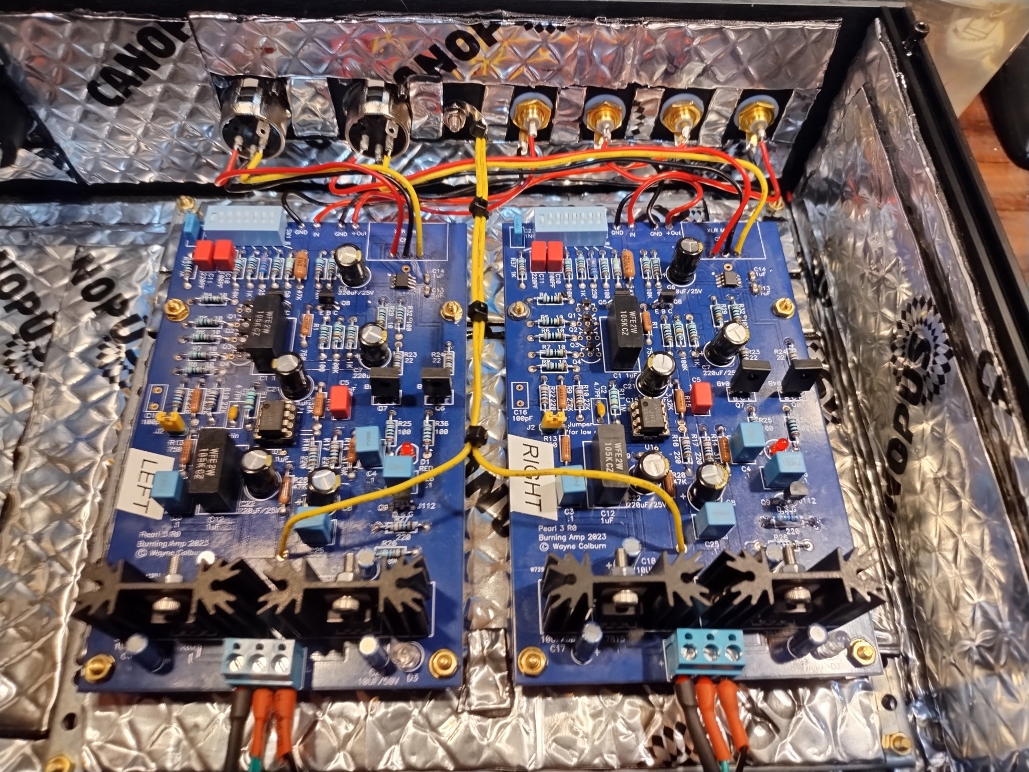

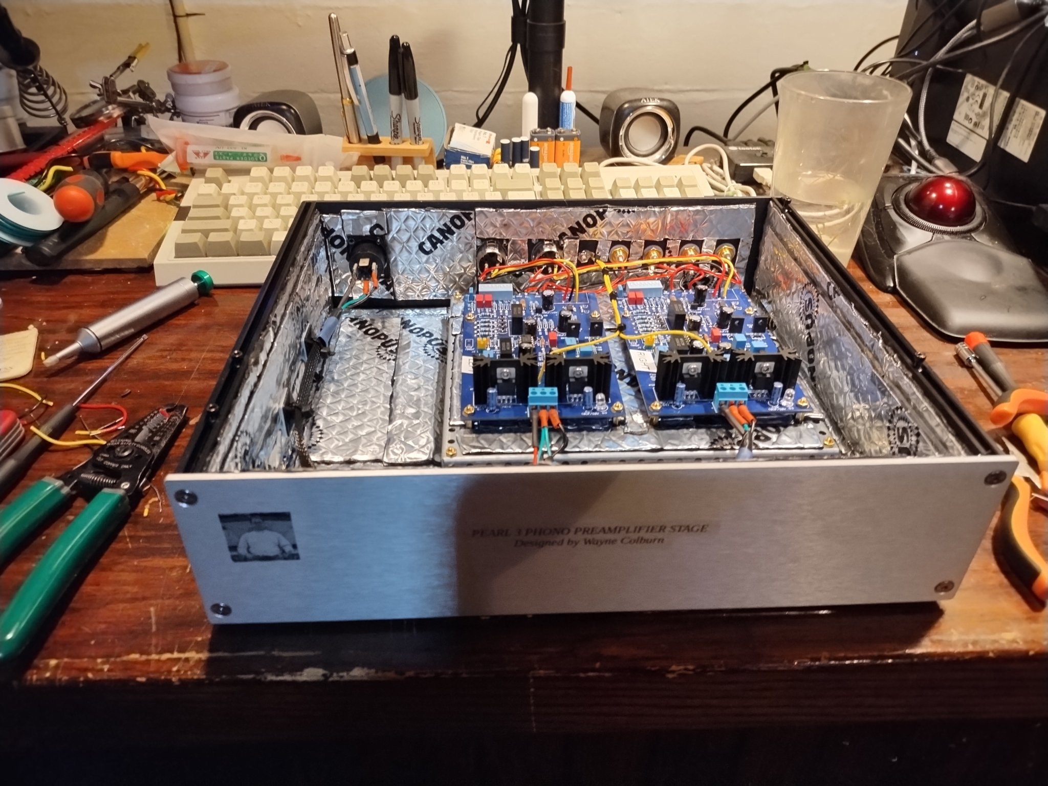

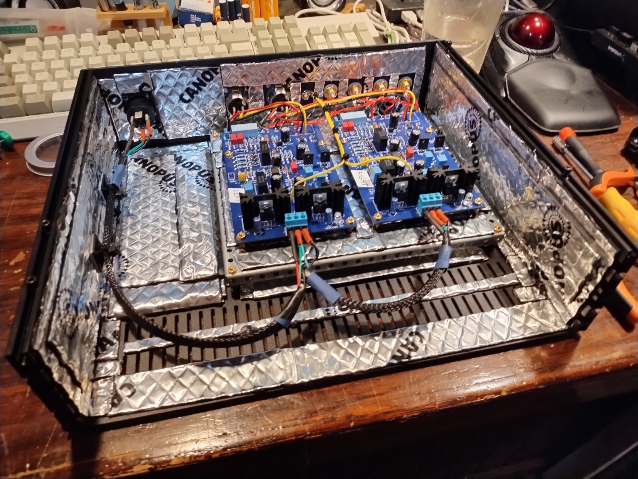

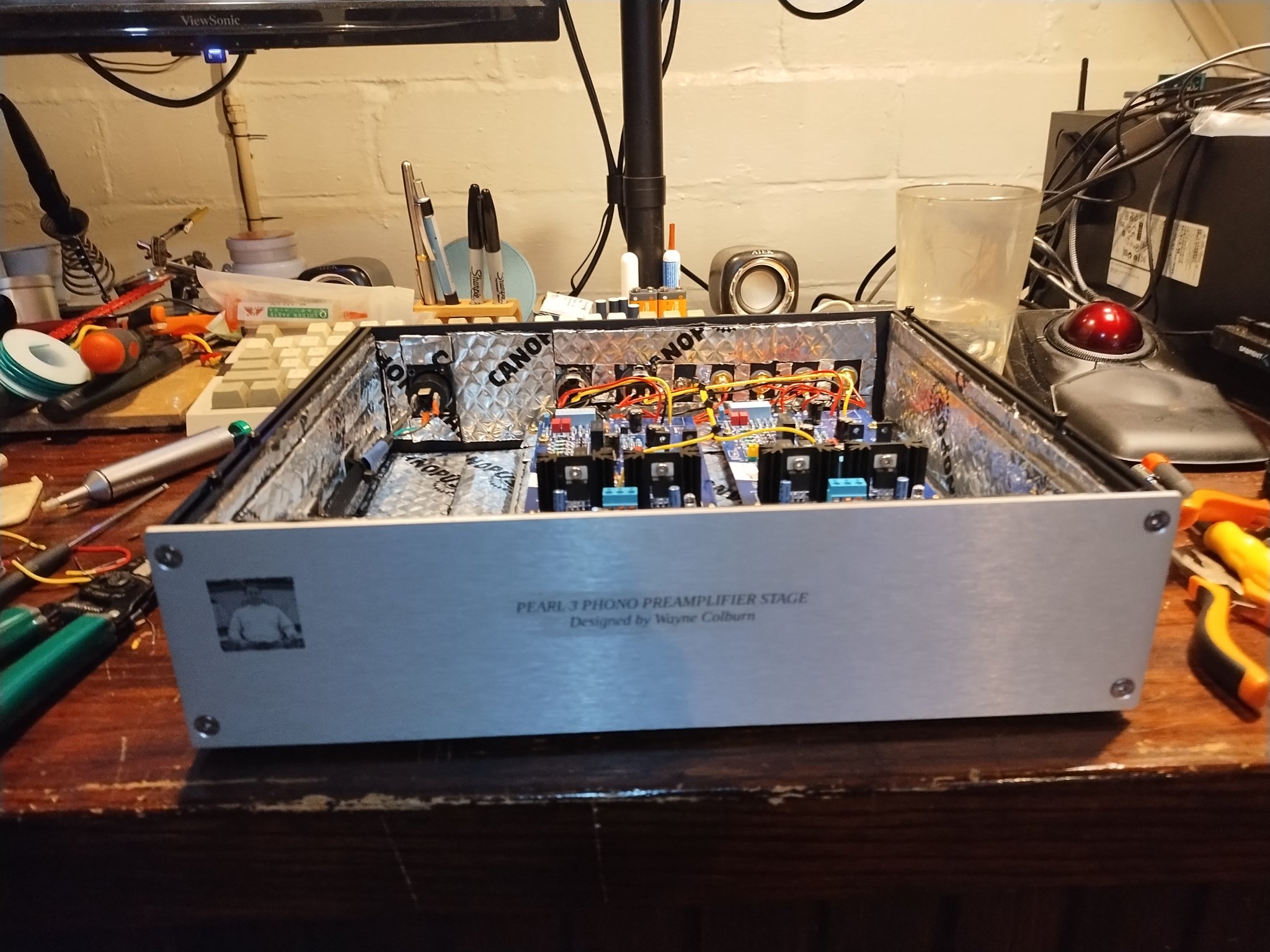

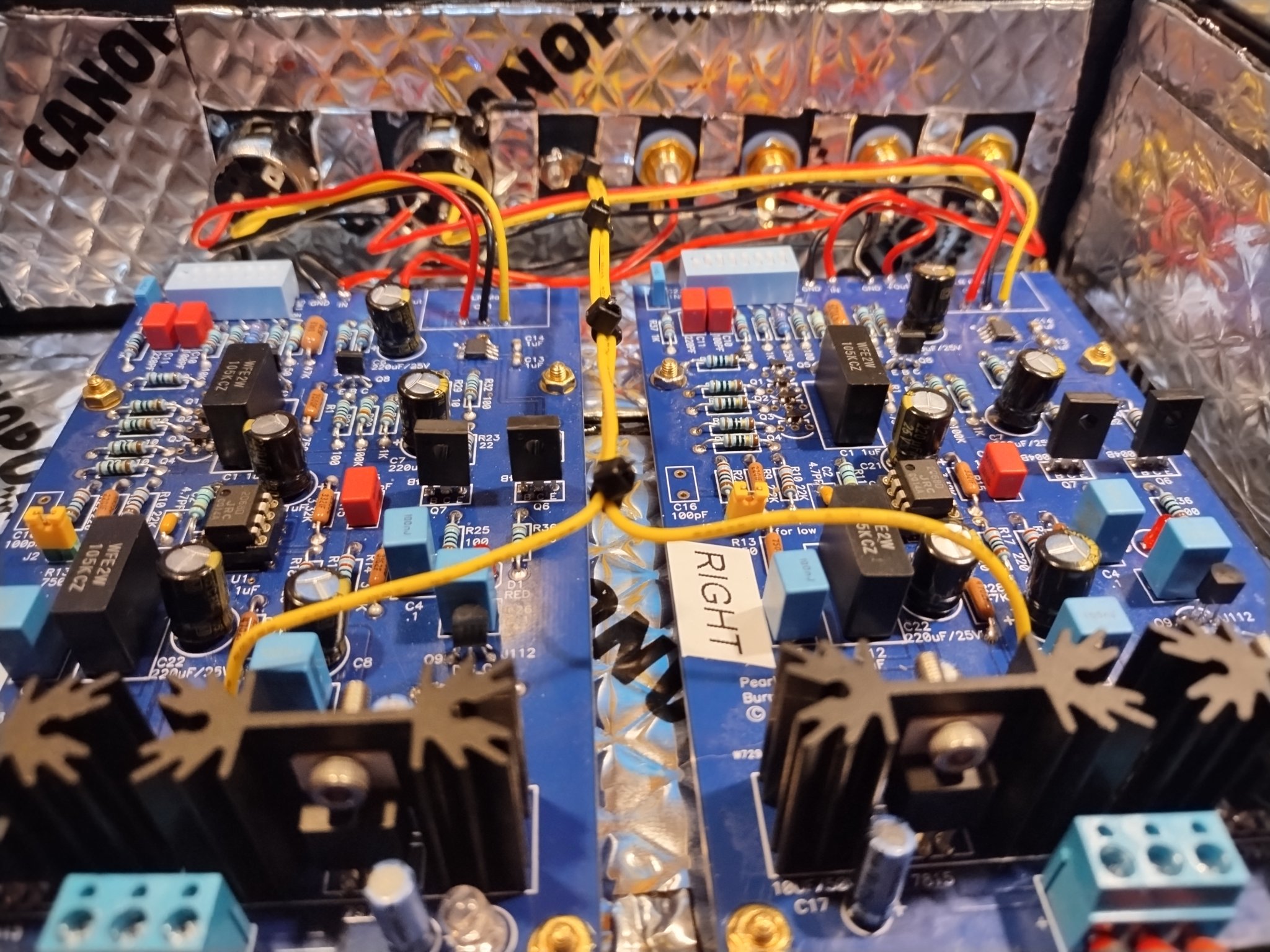

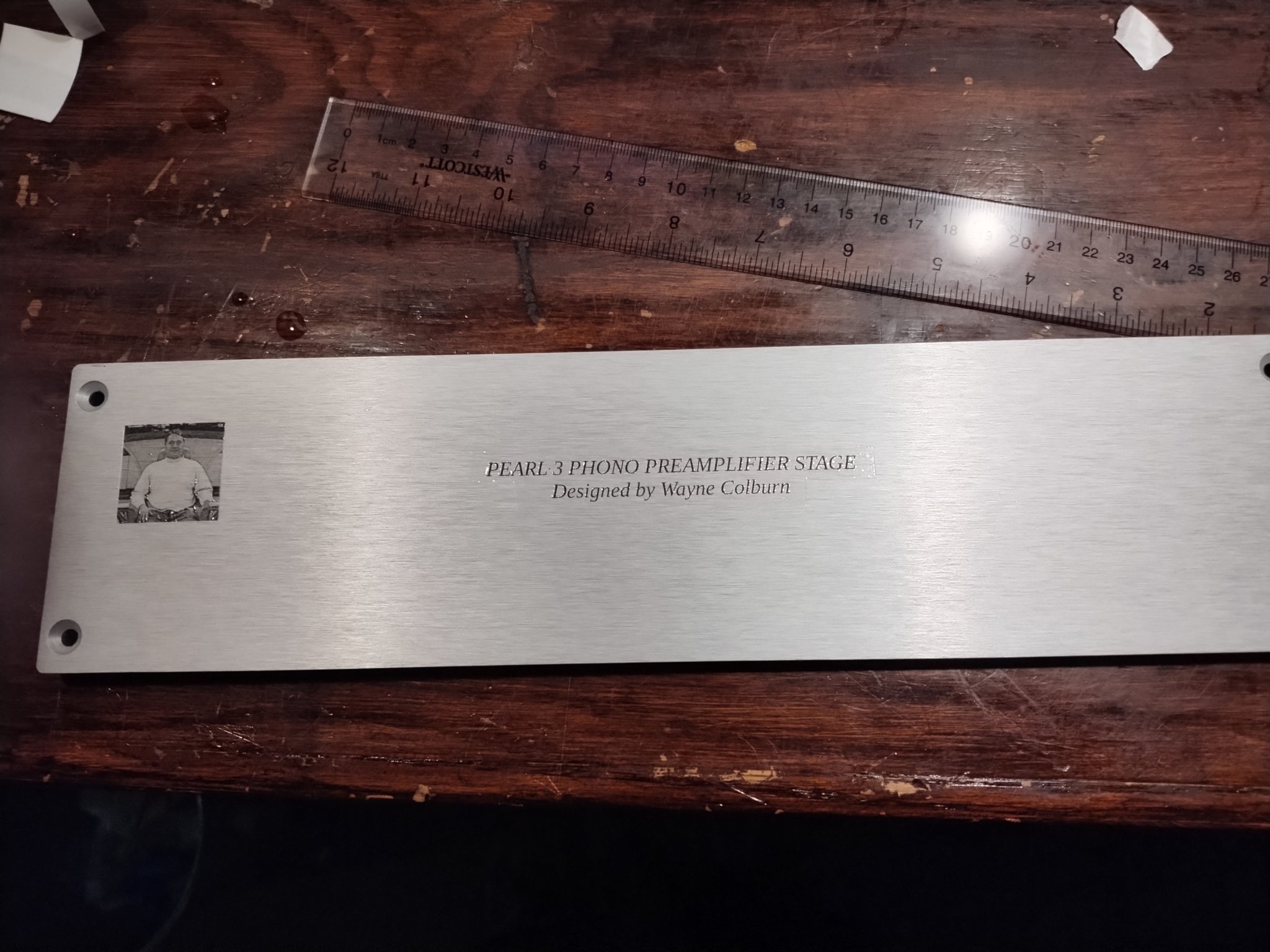

Input wiring now completed. Under test I found the voltage over R27 on each board was running at 2.2V with the 220ohm resistor fitted so I was dissipating 10mA. Way too much. I rooted around in my parts bin and found a bag of 475 ohm resistors. I fitted those and got that current down to 4.63mA on each channel - easily within spec. With the front panel fitted you can see the full damping. The top panel of the phono stage is also heavily damped.

The damping is to counteract bad vibes getting into the music during playback!! LOL. It's DIY after all.

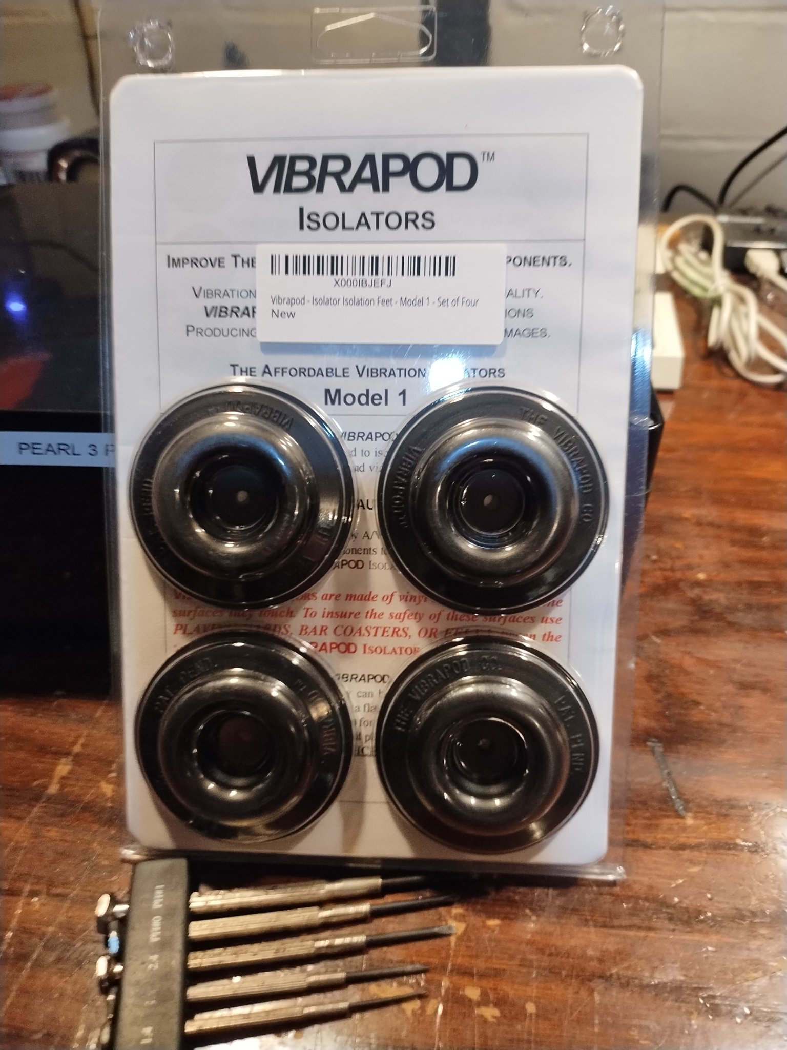

Now with the addition of the damping the phono stage weighs much more than stock so I got some nice feet to hold it up:
When you tap the enclosure, it sounds like it's made from lead!

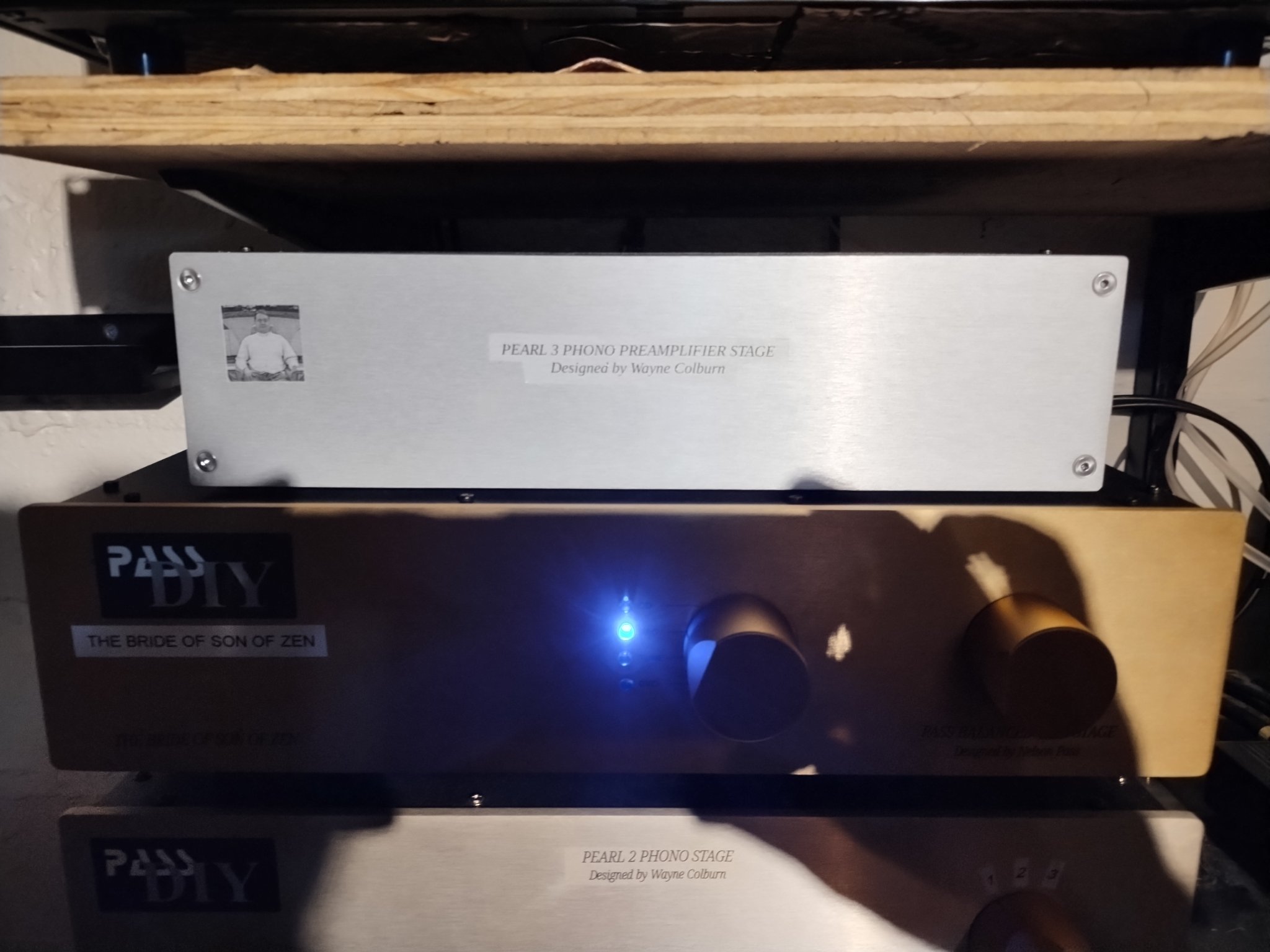

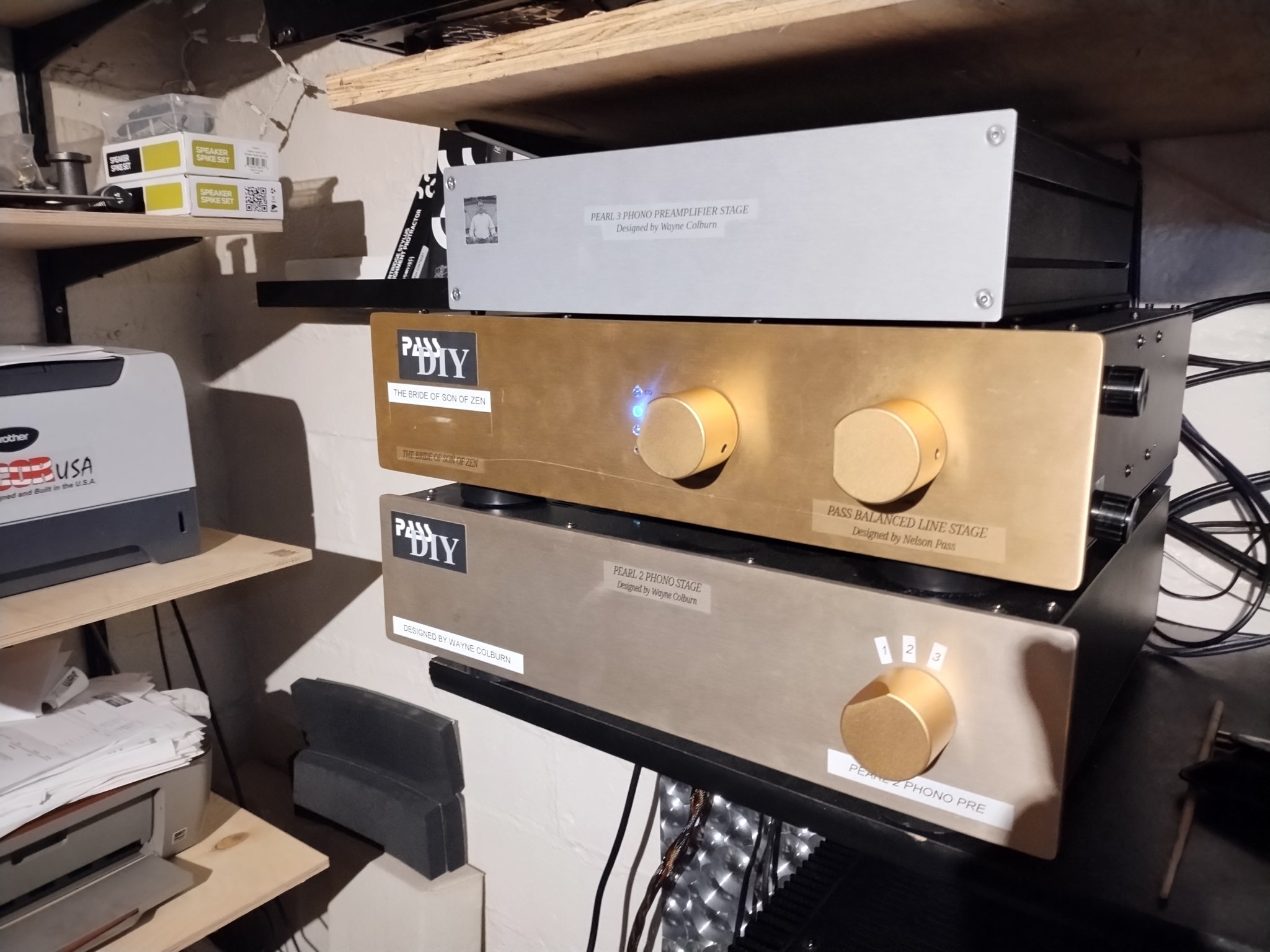

My previous phono stage was the Pearl 2 so comparing the two stages was fun. They both share the same sound signature but I would say that the Pearl 3 is more revealing. Both phono stages sound great, but I think the Pearl 3 is the new King of the castle.

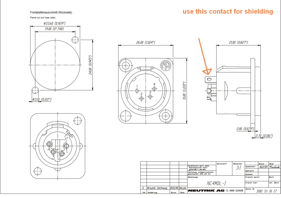

Tip! Found out that not all black metal XLR chassis (Neutrik) parts conduct current and are therefore not part of the shield. The 3-pin XLRs were fine, but the 4-pin XLR needed some paint removed to conduct. DMM is your friend 😜
Hi Dirk, That's true but in my case the chassis was not conducting because of the paint used (Neutrik NC4MD -LX B).
@freebee
Having an enclosed chassis where each panel is electrically connected to all the others is fundamental to the performance of this circuit... to the extent that they be wired together -- via bare metal patches -- as required.
If you connect the ground lug on the XLR then the housing of the XLR should be part of that shielded enclosure. That lug must be connected beneath the paint on the XLR. Right?
Somehow this wasn't the case with mine and I had to run a separate wire to the ground post.@freebee
The metal damping/shield and chassis are like the the plates of a capacitor. The shield must be connected to ground or it will act as a receiving antenna.
I'm curious what you get when you measure voltage on R27. If you are high on current and end up changing R27, I'm curious to see if that impacts the pre-reg 17.3V much. You need 2V+ before the regs, and and you have 2.3V now. So once you check out R27 I think you're ready for rock'n'roll. Or jazz, classical, etc.
I thinks that 2.3 volts is cutting things kind of close.
When I was checking things out I used the bench power supply to power up the P3 PCB's including the 7815 and 7915 +/- regulators.
For my measurements +/- 20 pre regulator voltages worked out better, as in less noise.
Thanks DT
