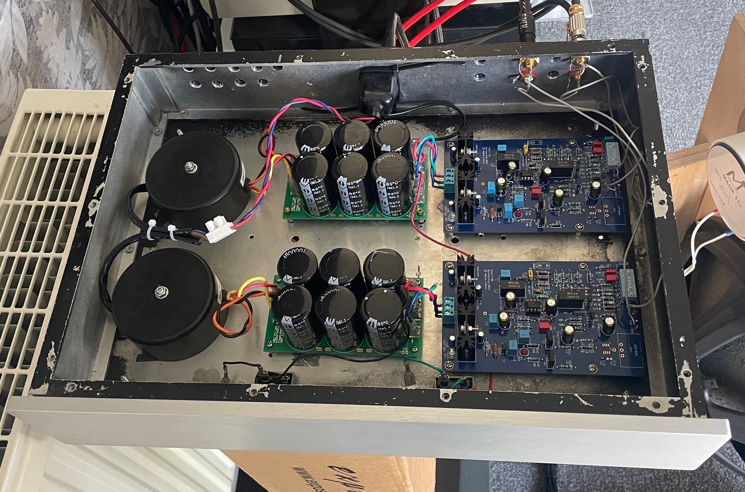

Forgive the case work......it's been many things in its 20 year life...But now housing the Pearl 3 dual mono as a quick and easy first 'lets see' what's all the fun is about.
IMO this Pearl 3 Phono Stage is a no brainer, I have for the past 5 years run with the Pearl 2 and very pleased with the sonic performance as it bettered most of what I tried it up against....up to 4K Rega, Exposure VXN, Dynavector IV and many others, but the Pearl 3 has beat all Ive tried.
Duel mono config 2 x 30VA 15-0-15 Txs into 30,000uF (CLCRC) no frills PSU. Sounds fantastic..used in high gain, there's no hum no hiss or strange noises just retrieves the info off the grove and presents it in a no fuss, this is what's in the grove. Clarity and detail are quite superb, lower registers are fuller and better defined along with a velvet black back ground compared to the Pearl 2 which also has the black background but not so dark.

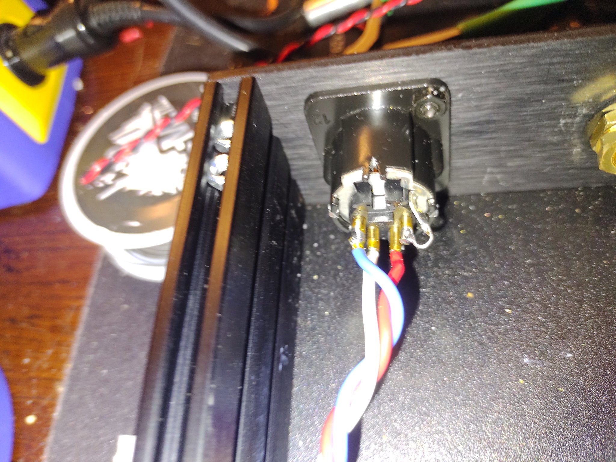

Question on umbilical wiring. On the power supply end, seems clear, shield going to ground, post 1 on connector shorted to the tab. What about on the preamp end, does pin one of connector also short to tab, and what is done with shield on phono box side...or does it float?

I would earth everything, that is both cases, both 4 pin XLRs, and umbilical shield.
Then also connect the two pcb grounds to the turntable binding post which is at earth, exactly as shown in the guide.
In practice, this is what minimized residual hum once the Pearl 3 was installed in my system.

Maybe I need to reread for the zillionth time, I see where it shows the shield going to corner of pcb ground in the power supply chassis, and in the phono chassis it shows the back of the 4 pin receptacle with pin #1 and the tab shorted.
I do not see anything illustrating what is done with shield or pin #1 and tab shorted there on the opposing ends
So, like PierreQuiroule suggested I am shorting pin #1 to tab on BOTH ends, and taking shield to ground on other end as well. This makes sense to me, but being famous for my abilities to destroy iron bar, or anvil with rubber hammer I ask!

No, I'm not typing clearly. The instructions show what to do with shield in power supply box. The instructions show the 4 pin female socket back side with pin 1 shorted to tab.

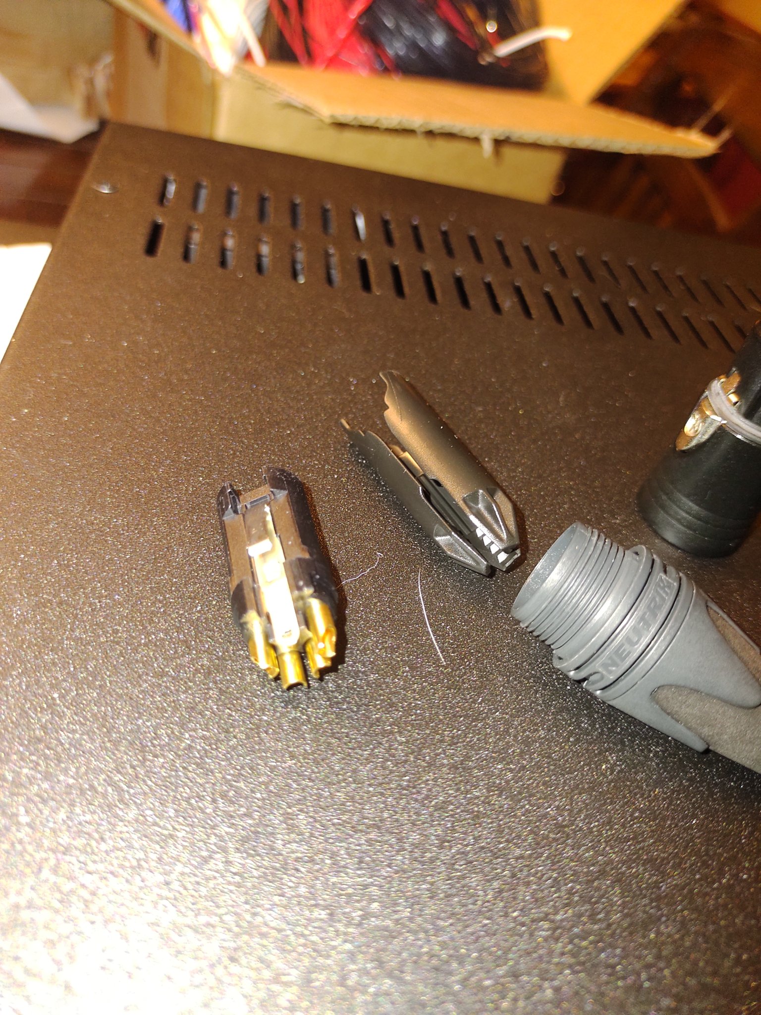

What I don't see is whether the other end from power supply, with the male XLR jack (on end of umbilical) there is also a pin#1 and small tab. I don't see where it shows them shorted. Also on that end of umbilical, should the shield also be shorted to that same tab that pin #1 is shorted to.
Speaking of the 4 pin XLR plug on end of umbilical that tab is small. I guess best to solder twisted shield in pin #1, then take wire from there to the tab.
I will start with this arrangement and see if it is quiet or not, and go from there.

Right. Got you.
One expects that the housings of the XLR jack (panel) and plug (cable end) will help with the task of shielding and therefore be connected to ground somehow, somewhere. Connecting the cable braid/shield as you describe should do that.
One might also assume (hope) that when plug is mated to jack that an electrical connection is made between the two. Connecting pins 1 to tabs in each might change that from a hope to a certainty.
