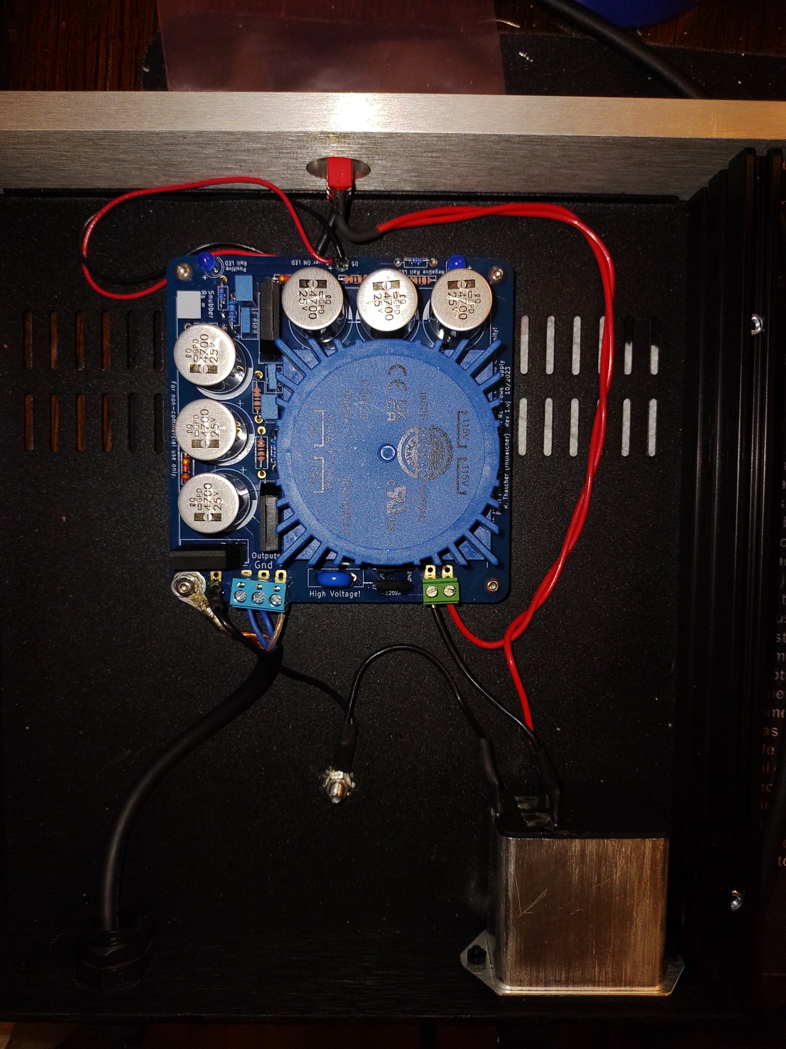

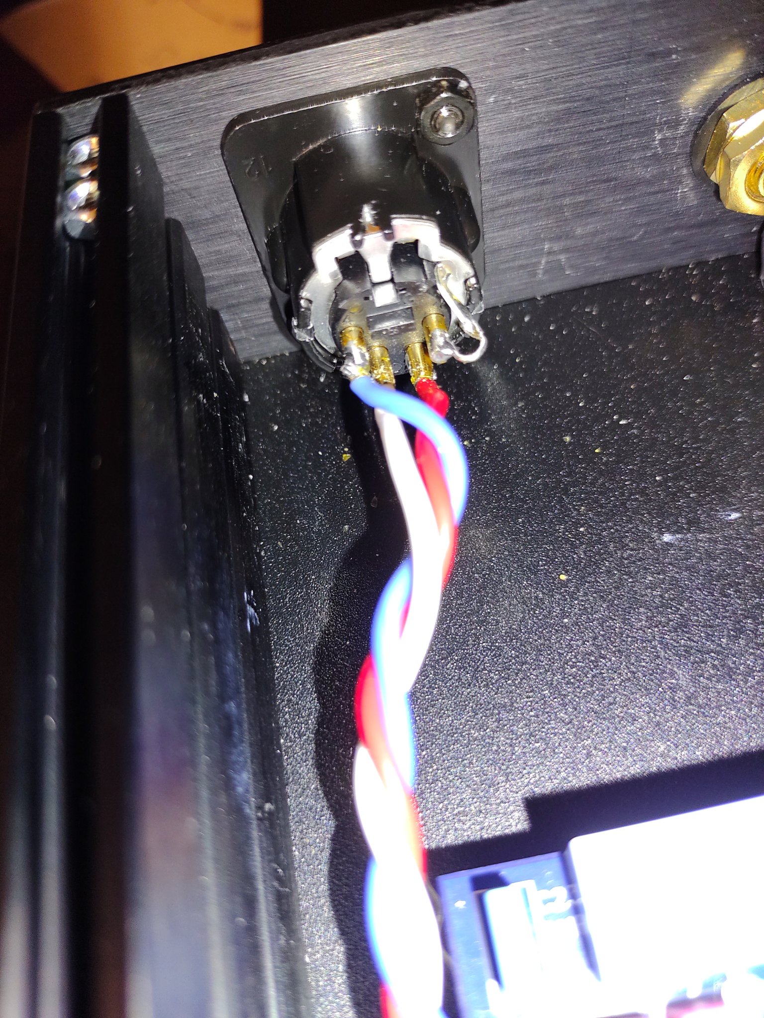

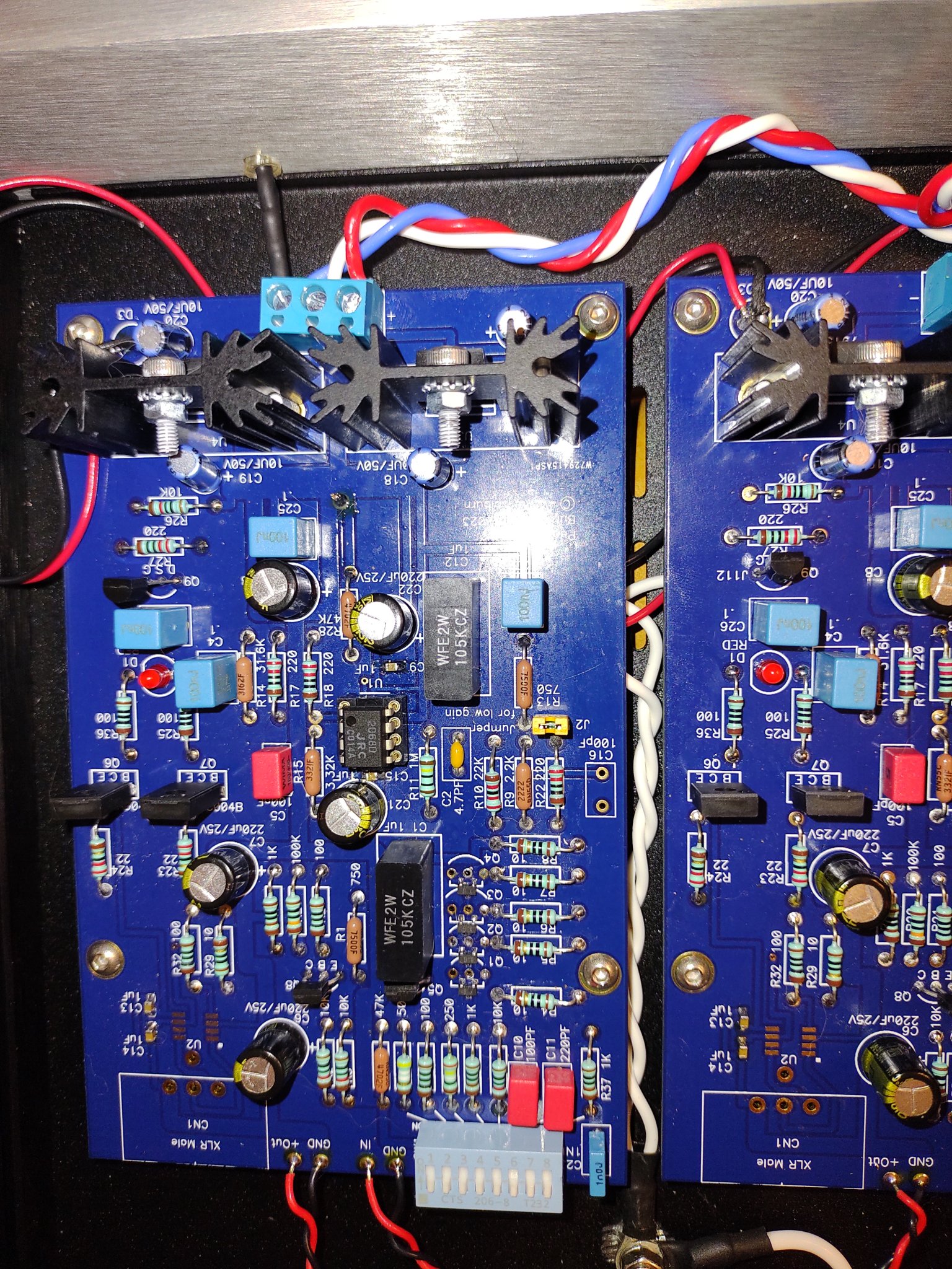

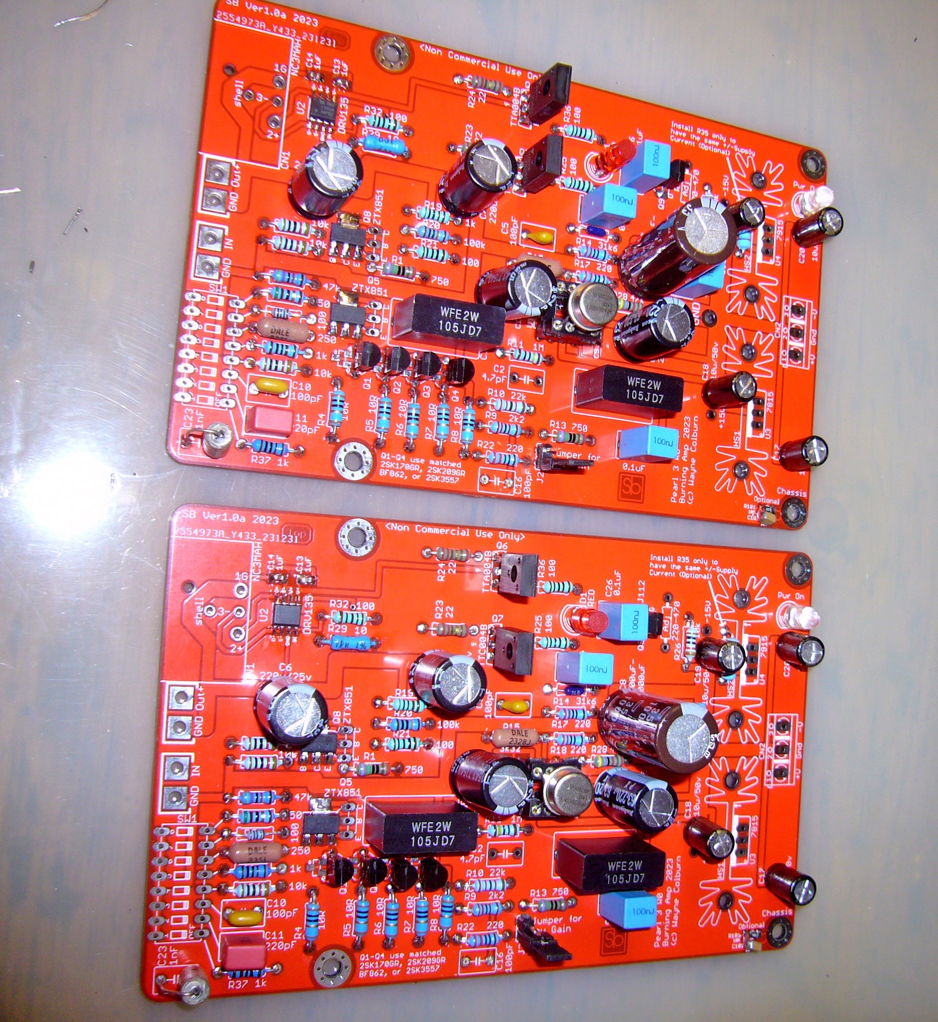

First power up, no joy yet....Power supply good, voltage at end of umbilical same as power supply outs. Hooked it up to phono unit
both front LEDs light up, right channel red led is not on. Measuring B+ on right channel, only 2.3 volt DC! Going back to xlr jack, only 2.3 on the back side pin
as well. Powered down, pulled power umbilical, yes, 23. something, but hook it up, down by factor of 10. I checked regulators, in proper position, but I dont see how they could affect voltage before it got to them.
Even left side channel whose red led lit up measures 2.3 volts. Ive stared at it and poked around, but nothing obvious to see. My chassis mount 4 pin xlr seems to lower voltage from 23.4 down to 2.3 volts.
ideas?
