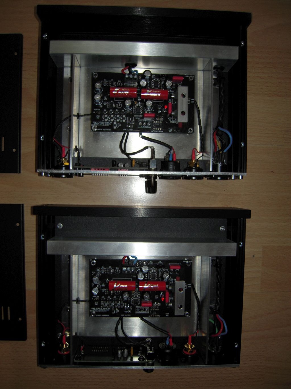

A004 and C004 are in the correct positions, and I've swapped the opamps between the boards to no effect. I've also re-checked all of the cabling and channel connections and it does indeed seem to be a problem with that board and not anything pre- or post- the Pearl 3.

On the inoperative PCB, are both the LED lit?
What is the voltage from opamp pin 4 to gnd? From pin 8 to gnd?
How tall are your standoffs? Perhaps someting is shorting out underneath?
Troubleshooting can be frustrating. If you have not done so already, flip the board and carefully inspect for solder bridges. It happens...A004 and C004 are in the correct positions, and I've swapped the opamps between the boards to no effect. I've also re-checked all of the cabling and channel connections and it does indeed seem to be a problem with that board and not anything pre- or post- the Pearl 3.
Next, set your Voltmeter to DC, ground the black lead, then probe and compare bias voltages between your known-good and faulty boards to verify that they are the same. Check supply rails, output, and both sides of R1 as a start.

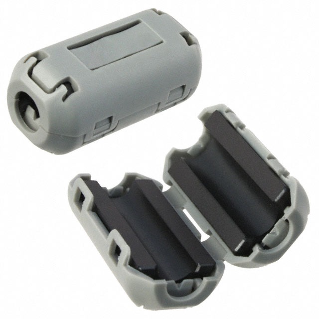

I’ve always lived in a place that has lots of background radio interference, a snap-on ferrite clamp attached to the turntable interconnects will fix it.
Fet and bipolar inputs are good for picking up radio stations. Ferrite clamps or the small beads with a few turns of wire on the RCA inputs usually fix it.

They are, yes.On the inoperative PCB, are both the LED lit?
On the good board, pin 4 to gnd is -15V and pin 8 to gnd is +15V. On the bad board I'm reading -6.8V and -.061V respectively for those pins.What is the voltage from opamp pin 4 to gnd? From pin 8 to gnd?
10mm tall and nothing from the board is touching the chassis underneath.How tall are your standoffs? Perhaps something is shorting out underneath?
Either side of R1 on the good board reads 5.525v and 14.08v and I got a big zero on either side of R1 on the faulty board. I'm checking for solder bridges and easy-to-find shorts and there's nothing I can see. I'll keep looking though.Next, set your Voltmeter to DC, ground the black lead, then probe and compare bias voltages between your known-good and faulty boards to verify that they are the same. Check supply rails, output, and both sides of R1 as a start.
Sigh. Yep.
Only checked those like three times. Or thought I did. I will swap and if you don't hear back from me, my problem is solved. As always, thank you so much for the help and suggestions. I'm getting better at this with everything I build, but sometimes the easiest oversights amount to literal silence.
Don’t beat yourself up, that’s great news that it’s something so straightforward to fix! AND good news that it doesn’t hurt the regulators or the circuit when that happens.
Will be looking forward to hearing your impressions of the Pearl 3.
Ok. Swapped the regulators to their proper positions and we're good to go. Records are spinning and music is playing. So far, the preamp sounds great. It replaces a Hagerman Bugle 2, which sounded amazing, but the Pearl 3 is already leaps ahead.

Cables have been swapped, and it's still there. I've got some ferrite clamps arriving in a day or so, which might help. That said, if you've ever heard this noise and know what it might be, let me know. I'm so close on this - I just need that background to be quiet.
