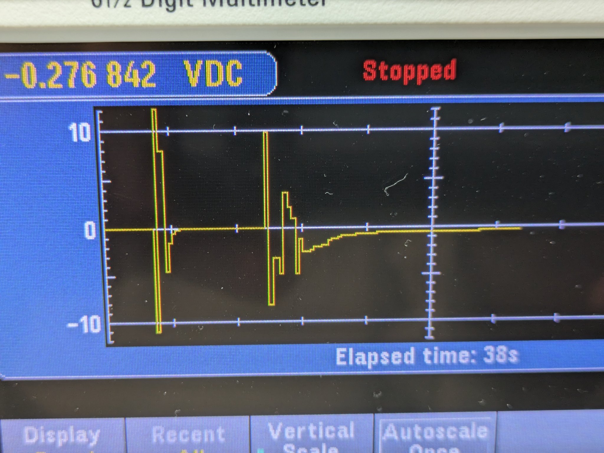

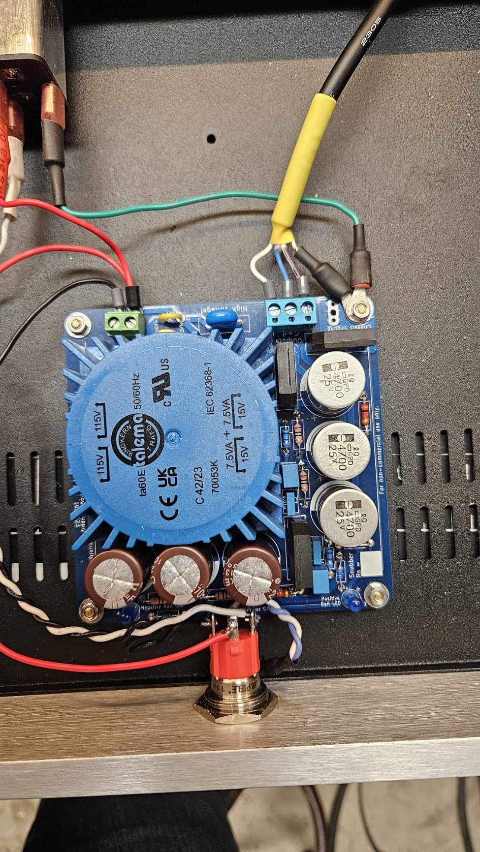

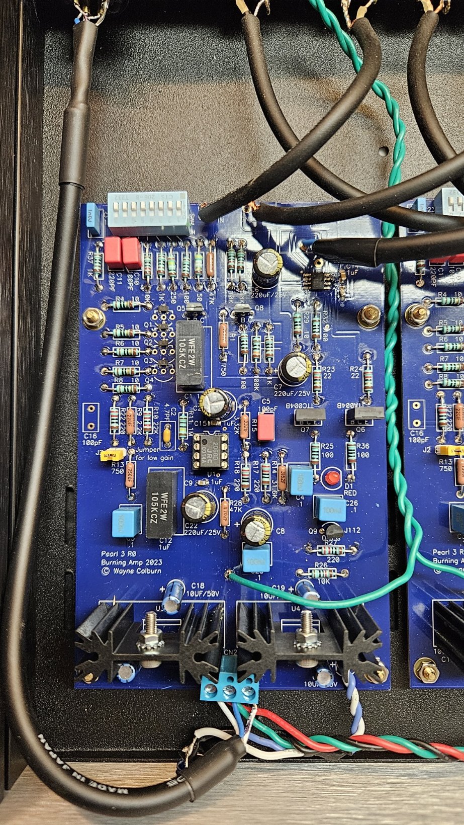

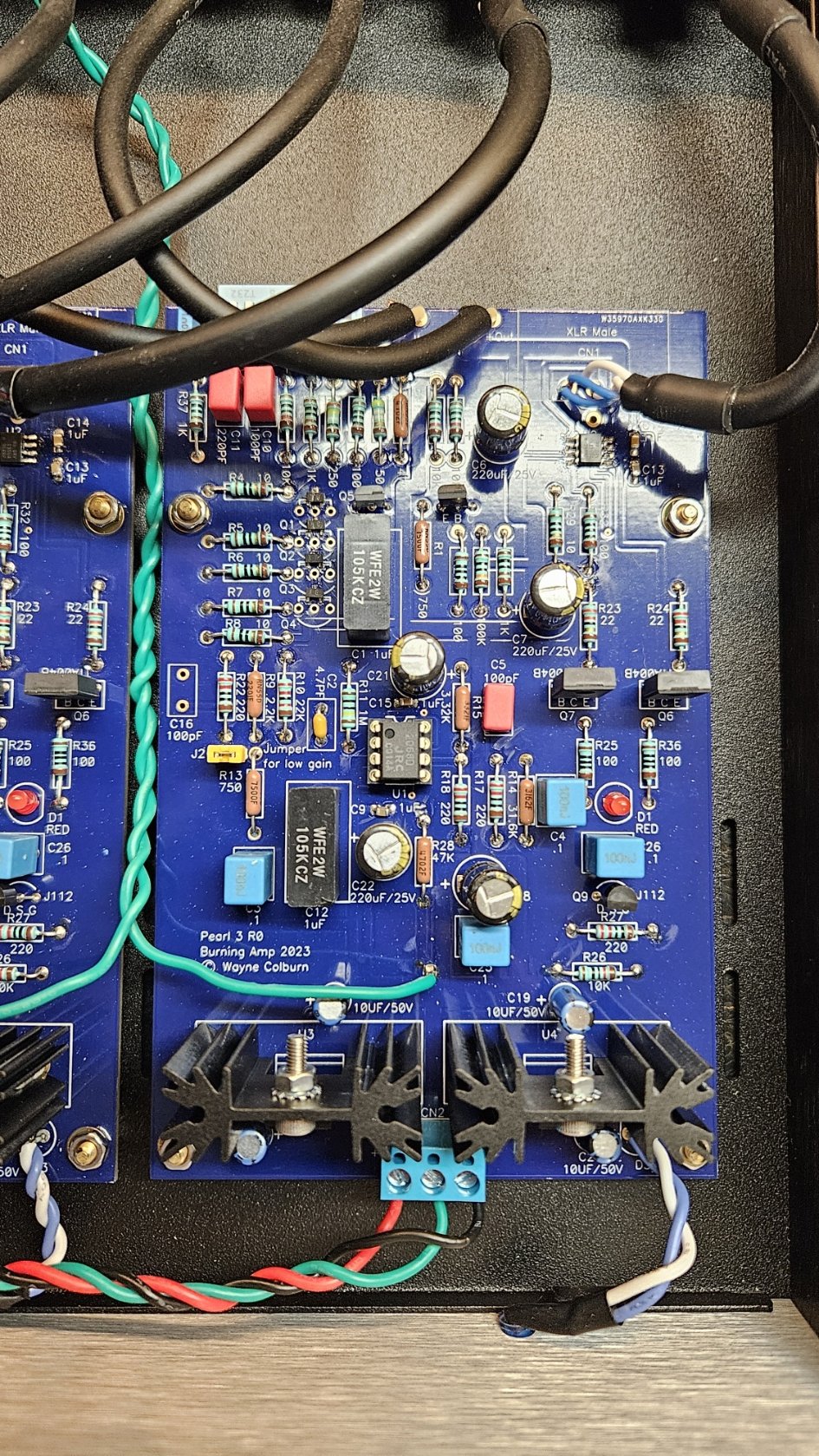

Hello All!
I finished the build and have a couple of problems.
1) When the power switch is turned on, there is a loud pop...that sounds like someone is dropping the needle on the record. This also happens when switched off.
2) Once the unit is powered up, it is silent until I play a record. The cartridge hits the vinyl, then a high-pitched wine that sounds like an old radio in between stations is present. The unit seems to function well otherwise.
I am attaching photos and am hoping someone will help me troubleshoot. I have no clue where to begin.
I will admit that I made a mistake building the power supply and managed to install the caps backwards-something I will never do again. I replaced all three on that side for good measure. Now, I think that I may have damaged something else.
Any words of wisdom are appreciated...

Are you turning it on or off with the input selected and not muted? That can definitely lead to pops with a lot of equipment
Well yes i was, but will not in the future. I just did not know if that was to be expected.
I made some progress in addressing the whining issue. It seems that when I connect the turntable ground to the ground pin of the XLR, the whining stops. Although I installed the XLR drivers initially with the intention of using them, I'm not currently utilizing them. I was using an audio probe to locate the source of the noise. What's odd is that connecting the turntable ground to the grounding post doesn't make any difference. I have everything grounded correctly and double checked..??
I suspect you have a cold solder joint between the board and the post. I believe the post and the xlr ground should be electrically the same so a cold joint is likely i think
Have you connected each PCB ground to the turntable binding post as per the build guides? If not, you should. This might not solve your problem though... but it can reduce hum.
Yes I have each PCB grounded to the post as per the build guide...i will re flow the solder joints tomorrow and see if that helps!. Thanks all!

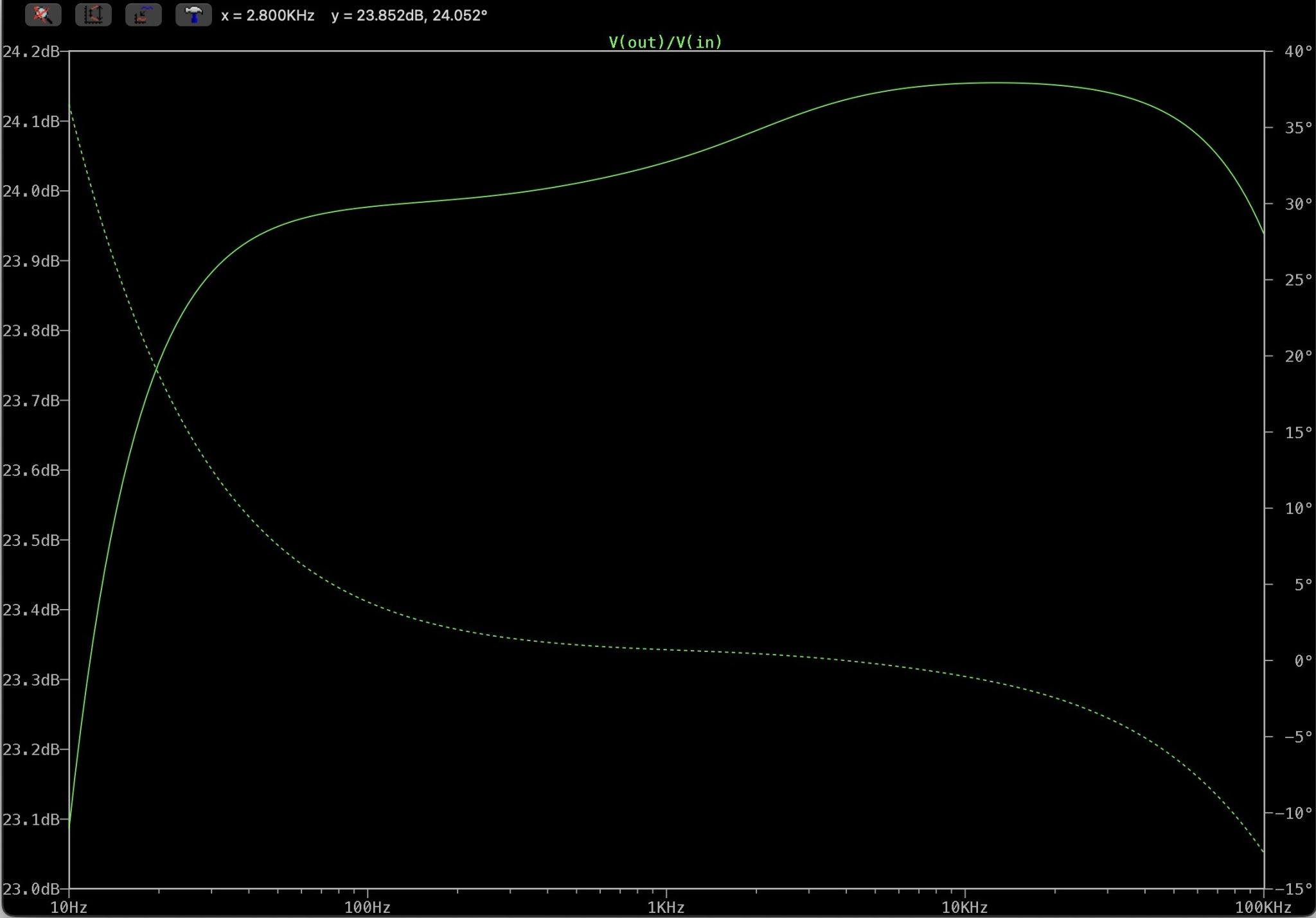

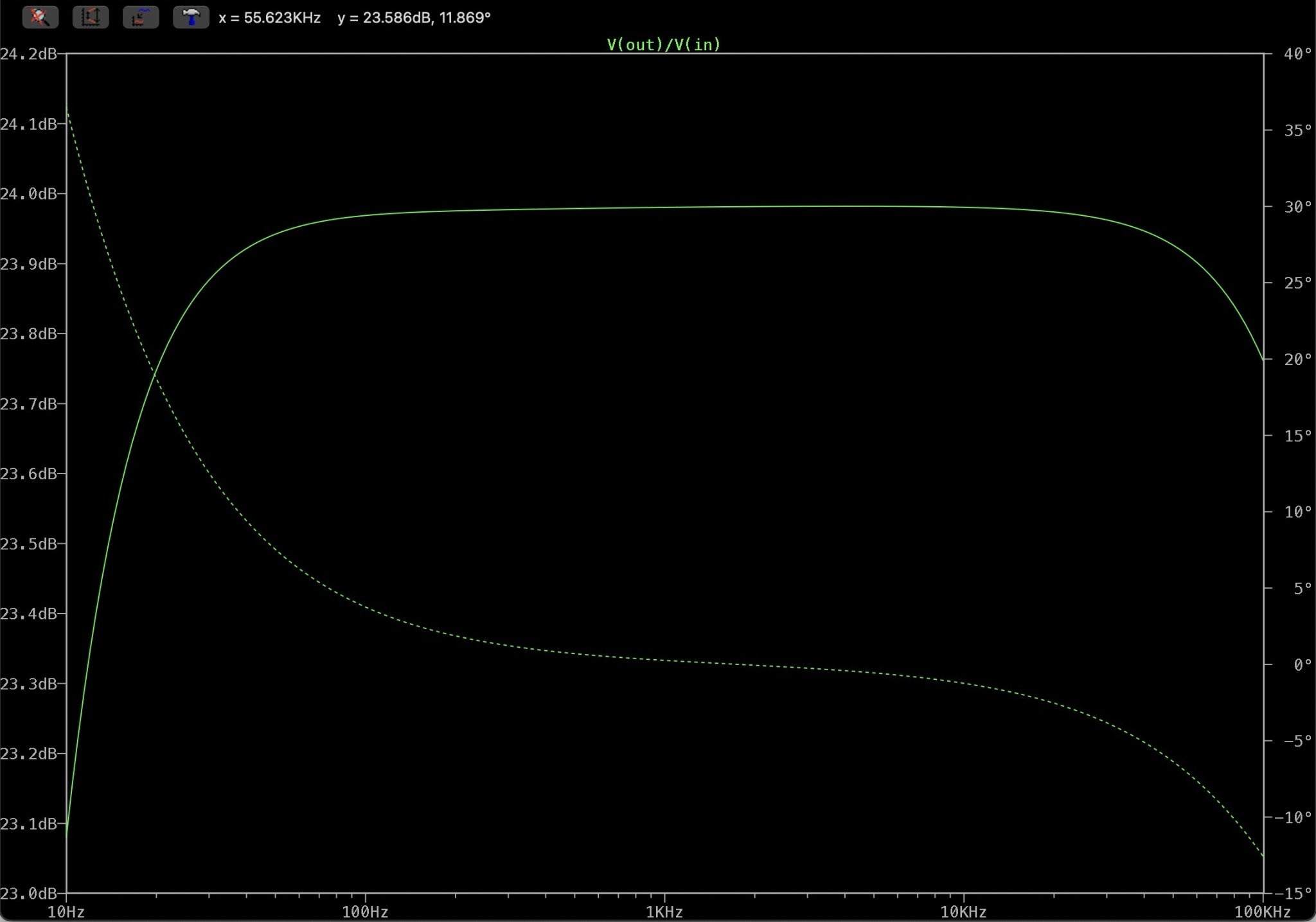

...on the subject of tweaking EQ components, I noticed that R13 benefits from a correction to 760 Ω, since the presence of R28 has the effect of slightly lowering the 75 µs time constant. If you're matching caps by hand, you could alternatively try to select a higher value for C3 - I calculated 101.5nF as an optimal value. I was able to find a matching pair caps for the C3 position at 100.9 nF out of the stock that I had, which was not enough on its own to fully correct the time constant.
Note that raising R28 helps a bit, but also lowers the LF cutoff frequency a bit - whether that concerns you or not is a matter of preference. I would personally prefer not to let the LF cutoff drift too low as I run a pair of subwoofers and therefore do want to keep the rumble frequencies under control.
After some more fiddling, I found that a slight reduction of R15 could mostly compensate for the remaining error in the R13 / C3 time constant. I soldered a high-value resistor in parallel with R15 on my boards to implement this adjustment.
Final assembly of my P3 boards should happen soon, and then I'll try to get some measurements to confirm the real-world performance matches simulation.
Here's how the EQ looks with default circuit values (exact), and then with R13 = 762 Ω and R15 = 3.313 kΩ. It's a pretty tiny change, but if you're fussing with hand-matched component values then perhaps worth the extra little effort.
