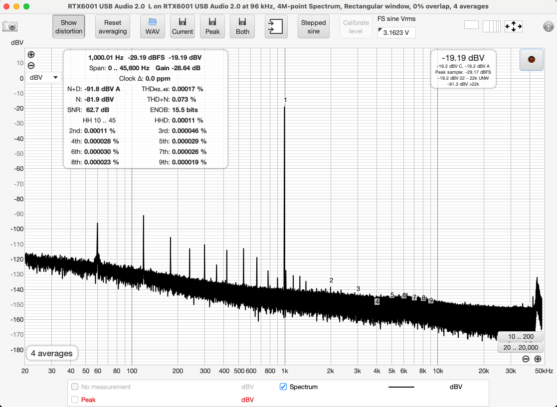

Measurement taken off single ended output.
Jumper off (high gain)
Switch 1 ON (50 ohm input impedance)
fc 1kHz
Vin 0.328 mVrms
Vout 1.0 Vrms
Gain 69.7 dB
THD < 0.0002 percent mostly second harmonic
Repeated on other channel to be sure.

Hello,
Give us a peek at the headroom.
Turn up the input voltage until the harmonics are up out of the noise floor.
If that RTX6001 analyzer has an oscilloscope function turn up the input voltage until we see a little clipping.

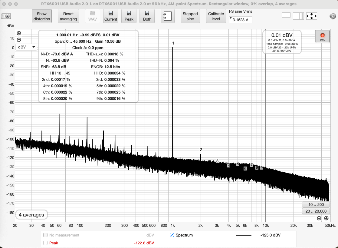

Of course headroom depends on the jumper and switches settings. I measured with jumper OFF (high gain) and all switches OFF. For these settings clipping starts at just over 3 mV rms (8.6 mV peak-peak) input. Pearl 3 output remains clean (THD < 0.004 percent) until 9.1 Vrms out. Clipping occurs (THD ~ 0.2 percent) at 9.4 Vrms i.e. when the output swing of +/- 13.3V approaches the +/-15V output stage supply rails.Give us a peek at the headroom.
Bottom line, no surprises. Nothing to see here.

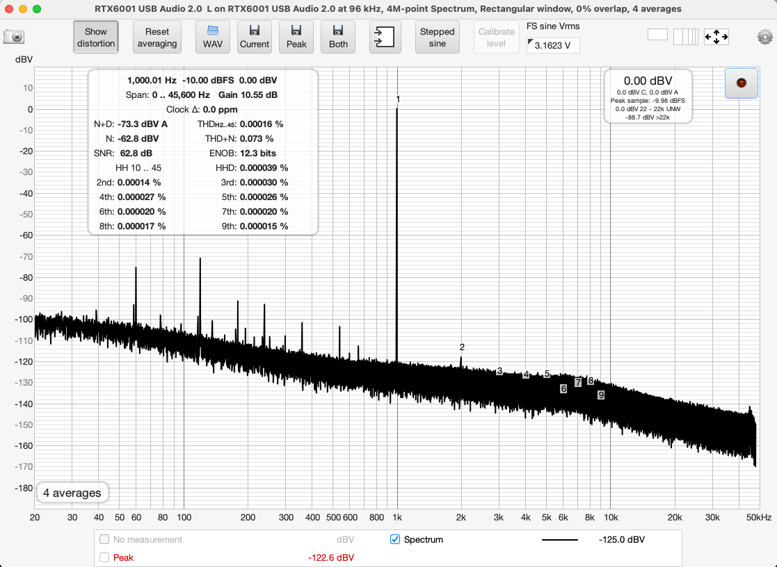

Jumper on (low gain)
fc 1kHz
Vin 0.328 mVrms
Vout 0.11 Vrms
Gain 50.5 dB
Looking at the RTA, and for a same Vin, I see no difference in distortion compared to post #3166 showing the high gain setting. In either case, it is so low as to be very hard to measure reliably.
