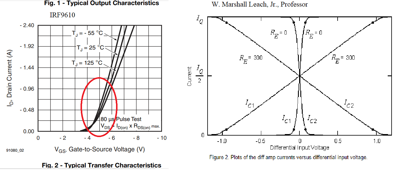

now, also important to outline factor that some balanced configurations are not having stellar performances*** when used in any SE scenario ( be it SE in , or SE out or whatever) simply as result of chosen approach to get to stellar performance when used fully balanced; just one factor more when evaluating
in short....... my stance in general - is that Bal is not superior to SE, nor SE is superior to Bal; horses for courses
***some Bal stages are having extremely low THD when used in native modus operandi ( Bal) while having sorta highish THD (even harmonics ) when used in non-native modus operandi ( SE)
anyhow, remark "if done properly" is there to point importance of comparing two equally good solutions when using particular constructions to evaluate principles, outlining stance that one is not better than other, it just can be more appropriate, either for intended context of use, or simply to listener's preferences

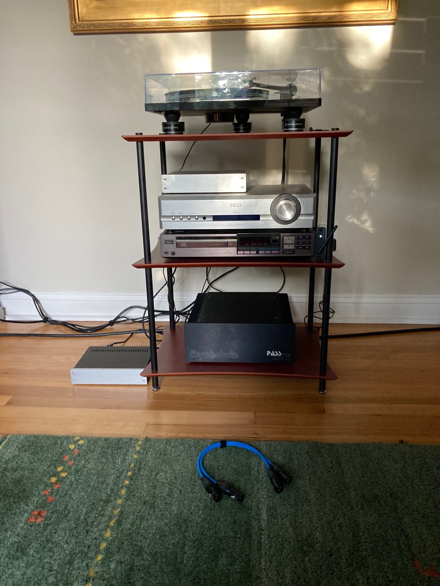

I just A/B'd side A of this record. Balanced played first, then single ended. The only thing I changed was the inputs to the preamp.
Balanced is set back and clearer. I listened to balanced first, before the little Aleph Classic was warm. Single ended is forward and warmer. It's harder to hear exactly what Leadbelly is saying when single ended.
There is a difference I am certain.
No. They're both Blue Jeans Cable, 1 foot. The single ended is Belden wire, whatever the Blue Jeans standard is, the XLR is the newer Canare DA202.
In other systems I (we've) heard a difference between Mogami XLR and this Canare DA202.
It's probably my preamp that makes the most difference here, what it does with balanced in vs. single ended. So unless one's preamp and amp are up to it, going balanced out from a Pearl 3 might not matter. But in my case I absolutely prefer balanced out.

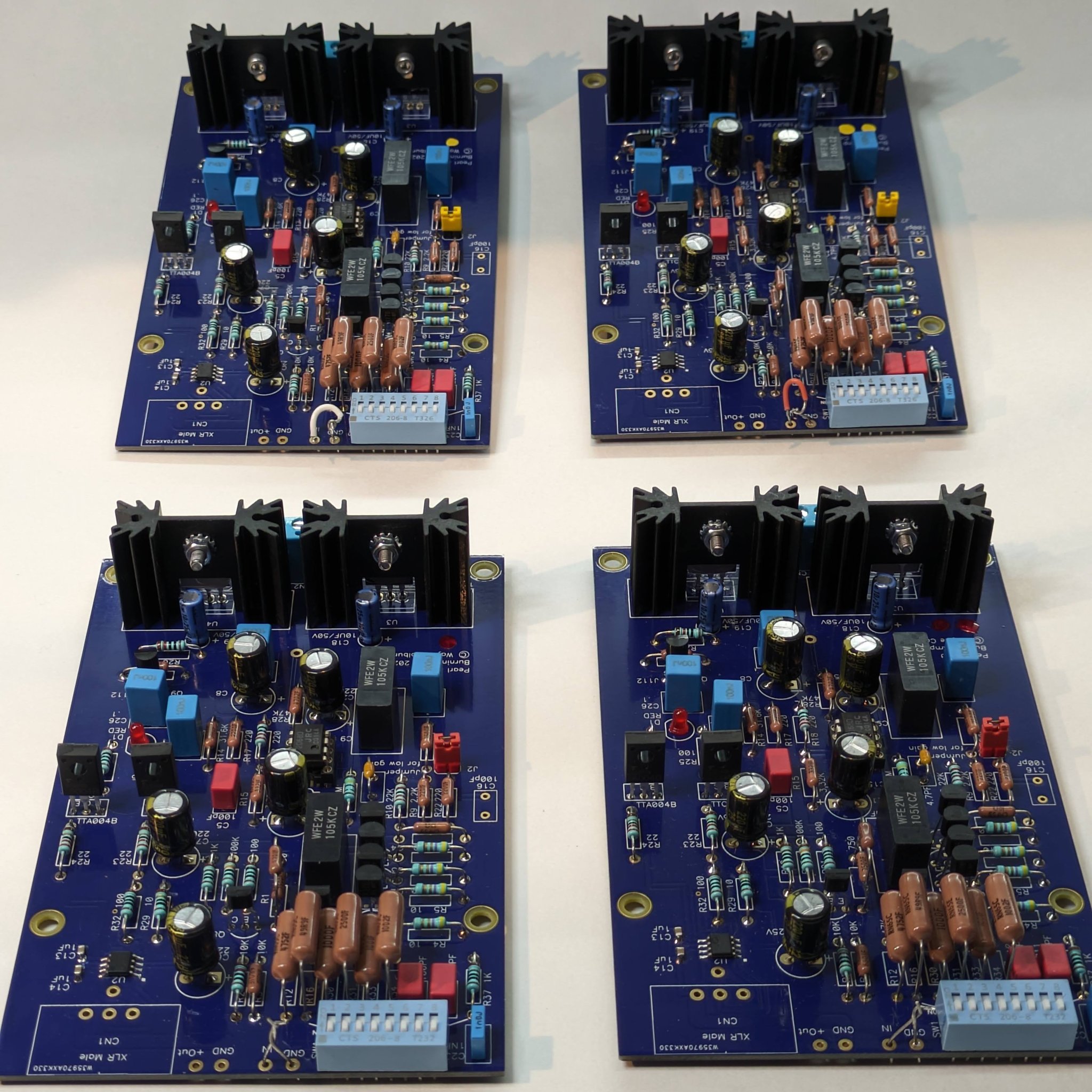

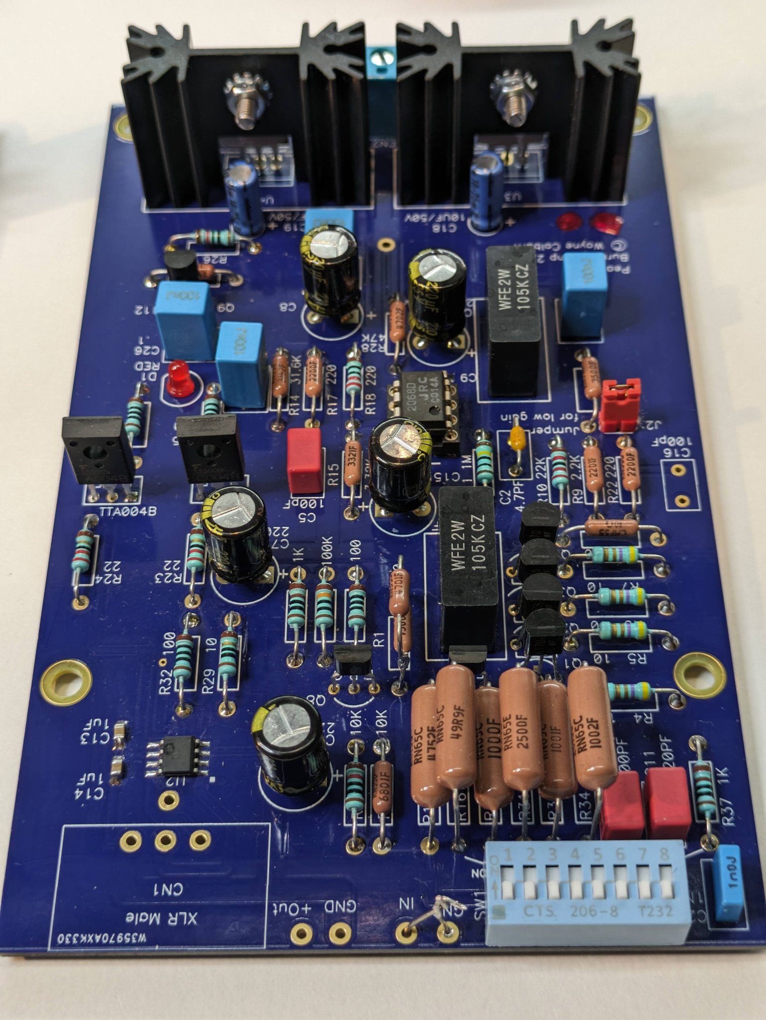

Stuffing complete. Four boards biased as planned. Because I'm obsessive, I adjusted collector load resistor and cascode voltage down to account for ~3 mA per 2SK170BL JFET. As a result cascode Vce now measures 1.0V if J2 is closed (MM) and 1.5V if open (MC). So far so good.
3 ma X 4 Op-Amps := 12 ma total.
After seeing all the RN65 resistors stacked up I am looking at R1 a RN55 resistor specified at 0.1 Watt, at 12 ma it is cooking at over 0.1 Watt. A little heat and excess noise?
Thanks DT
Yes, I agree. Not knowing what value I would need, I stuck two RN55 in parallel in there. B.t.w. the RN55 really is a 1/4 watt resistor, downrated to 1/8 watt for mil spec. So perfectly safe. Still, turns out Mouser has the value I need for R1 in RN65 so will add this to my next order.
