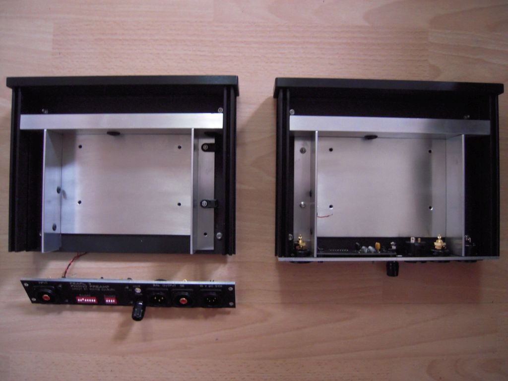

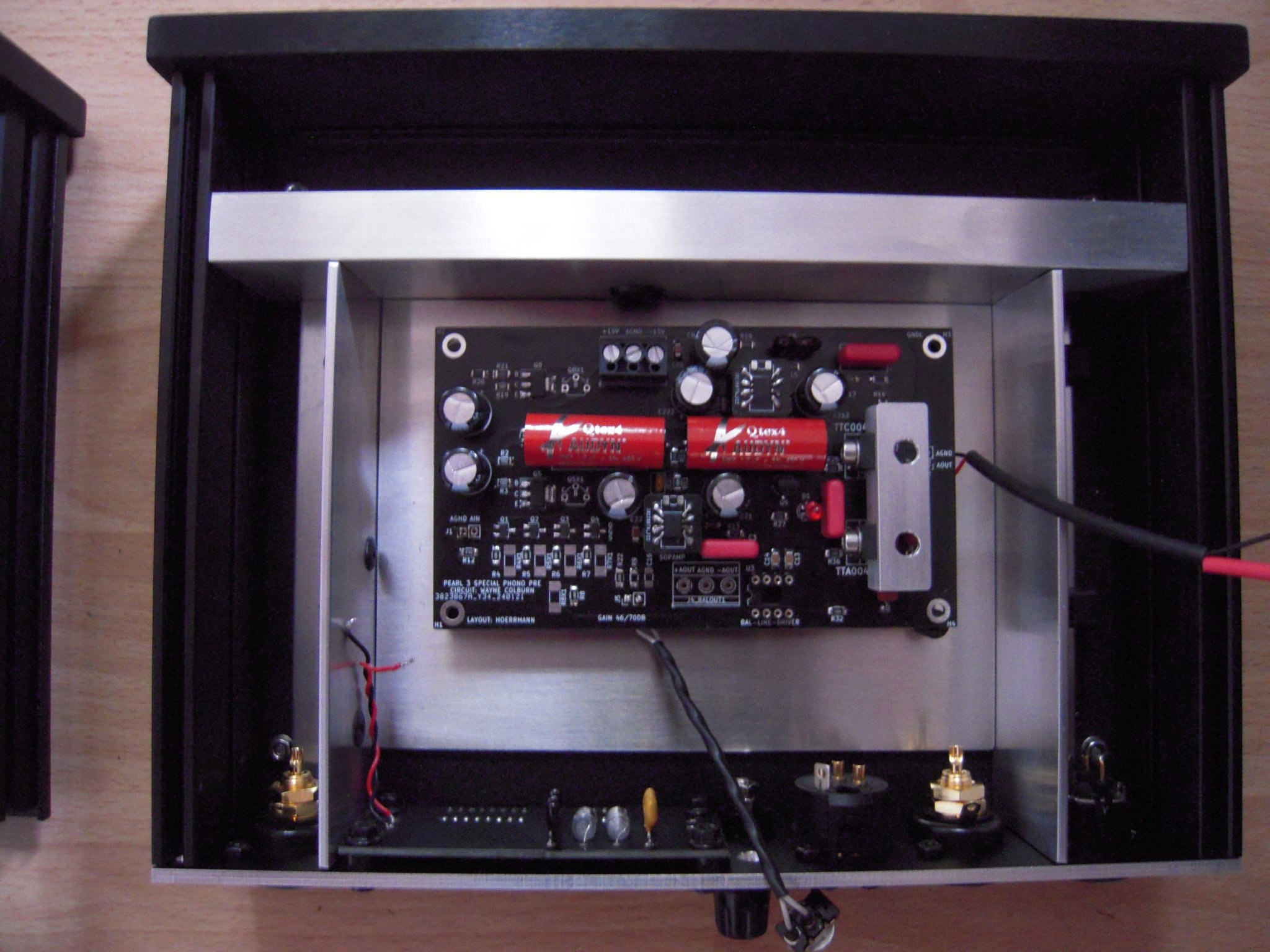

today I will try to complete my third variant of the PEARL 3. I made my own pcbs for use with single OPAmps.
I listened to this variant of the PEARL 3 the last few weeks and used two OPA827 per channel. Very nice OPAmp -
I like it a lot. I used a lot of SUSUMU - smd - resistors. C1 and C12 are some bigger caps from AUDYN.
And I put some extra layers of aluminum into the MODUSHOP - cases for some extra shielding. Absolutely not necessary!
I will see, if this lazy sunday brings those pcbs into the cases... ☕
Have a nice weekend and hopefully enjoy fantastic sound out of your PEARLs...
(and it doesn't matter if it is a PEARL 1, PEARL 2 or PEARL 3)
Cheers
Dirk 🙂

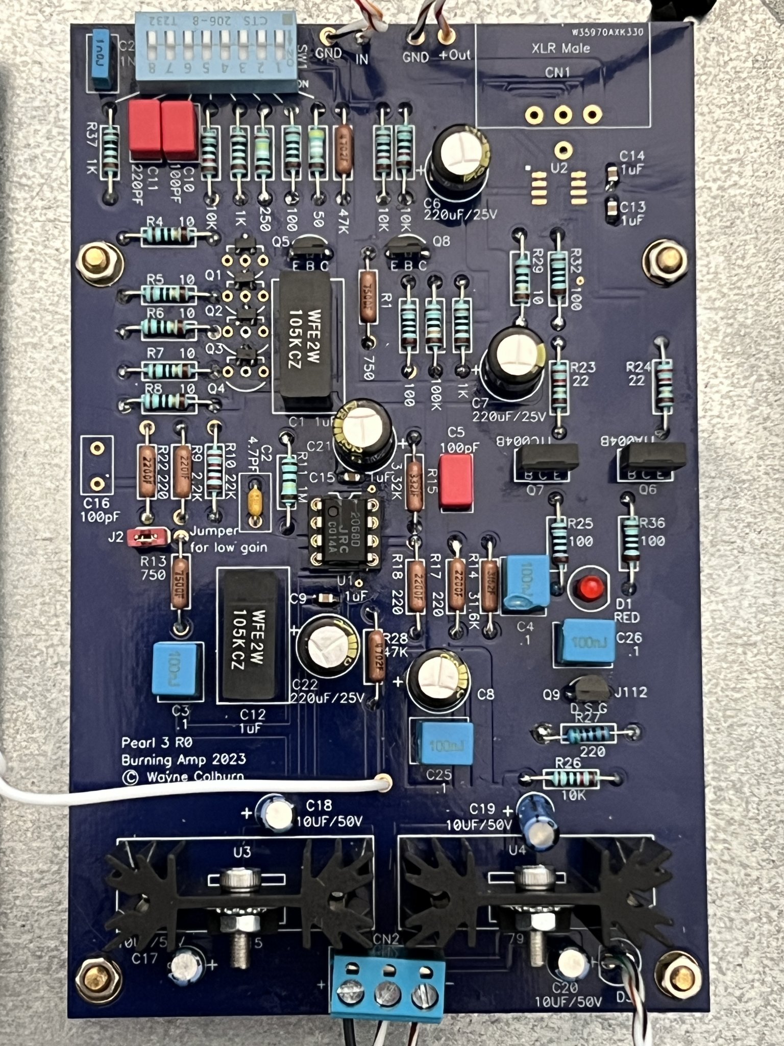

I've completed my build and one channel is working perfectly–the other is silent. The board is powered up properly so I'm guessing it's the signal path. Input and output wiring is fine, and I've checked all of my solder joints and they look good. I'm not sure what next steps I need to go through to check the board, and what, exactly, I should be troubleshooting. Any guidance would be greatly appreciated.
It probably doesn't need to be said here but, standard troubleshooting when 1 channel is out:
Start at 1 end of the signal chain and swap channels moving forward or back to see if the problem switches channels. I usually save swapping cartridge lt->rt for the last, hopefully not needed 😉
Thanks. Wiring and cable connections to and from the Pearl are all correct. I checked those first. I should have added that in my original post.

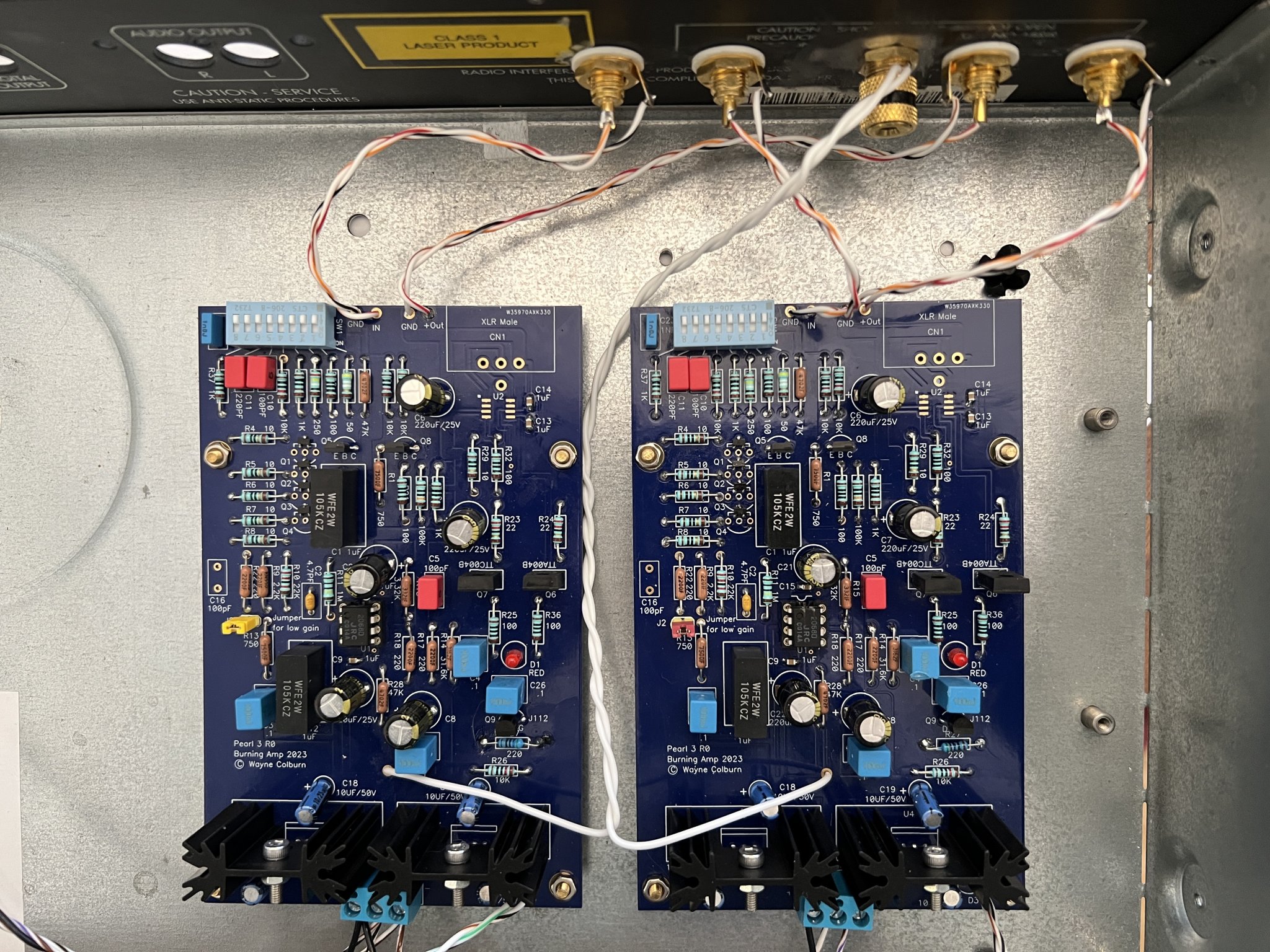

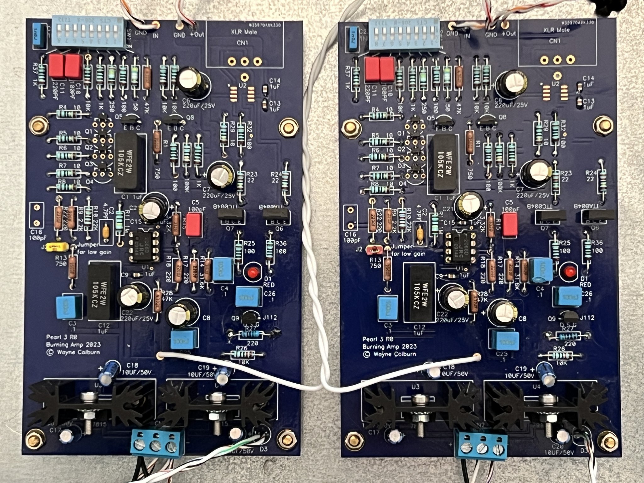

@bpr Post a series of well-lit, in-focus photos, and the hive brain can get to troubleshooting.
I've attached three photos. The single board is the faulty one in question. I've also included photos of the interior of the enclosure with both boards and a closeup of both boards. In each of those, the board on the RIGHT is the faulty one.
Verify that the TTA004 and TTC004 are in the proper positions on the bad board.
Also, C4 is quite possibly dead because of the melted bit, but that wouldn’t make silence…
