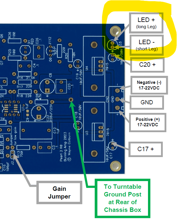

The green (negative rail) led is weak. I replaced it, but it was OK, The resistor was reading 25k, I replaced it with a 20k and it got a little brighter. Another thought. All boards are on the same temporary chassis. I have not done anything to add an additional chassis ground to the phono boards, but they are connected to the input jack on the front panel.

Yes on dim green led. I thought it might be an issue so I replaced the existing led, there was no change. I measured the resistor (spec 20k) and it read 25K. I replaced it with a 20k and it got a little brighter, but not a bright as the red or blue.
Does D3 light up on the phono boards? And what is the R26 resistor value on the phono boards?

neither D3 lights up. R26 on both board reads 10K, which is spec. I'll disconnect one board from the psu and see what happens. I did have one issue about a week ago, I installed Q6 backwards; I couldn't save it so I had to order a new one that came in yesterday; but everything seems ok now.
Wow, I just disconnected one phono board and got 18 vdc on the psu and the connected phono pcb.

Does d3 light up with only one board connected?
What happens if you power up the board (only that one)? Also 18V rails?

I think there’s two problems… something related to the improperly installed transistor, and an undersized transformer.
The math does not work out to get a 12v transformer to work with 7815/7915…
12*1.4=16.8
Minus two diode drops for rectification,
16.8 - (0.7+0.7) = 15.4
Minus at least .5v across the CRCRC
15.4 - 0.5 = 14.9v
As Tungsten mentions, the regulators need at least 2v greater input than output, so I’d say the raw DC supply needs to make no less than 17vdc under load.
Which shouldn't possible with a 12vac transformer in this circuit, unless the transformer has very poor load regulation.
Once the rest of the circuit is sorted you could change the regulators to 7812/7912, or get a 15v transformer.

Don't know if I was clear previously. D3 was in backward and is now working. With one board connected, the psu rails and the one pcb voltages are all at 18.
