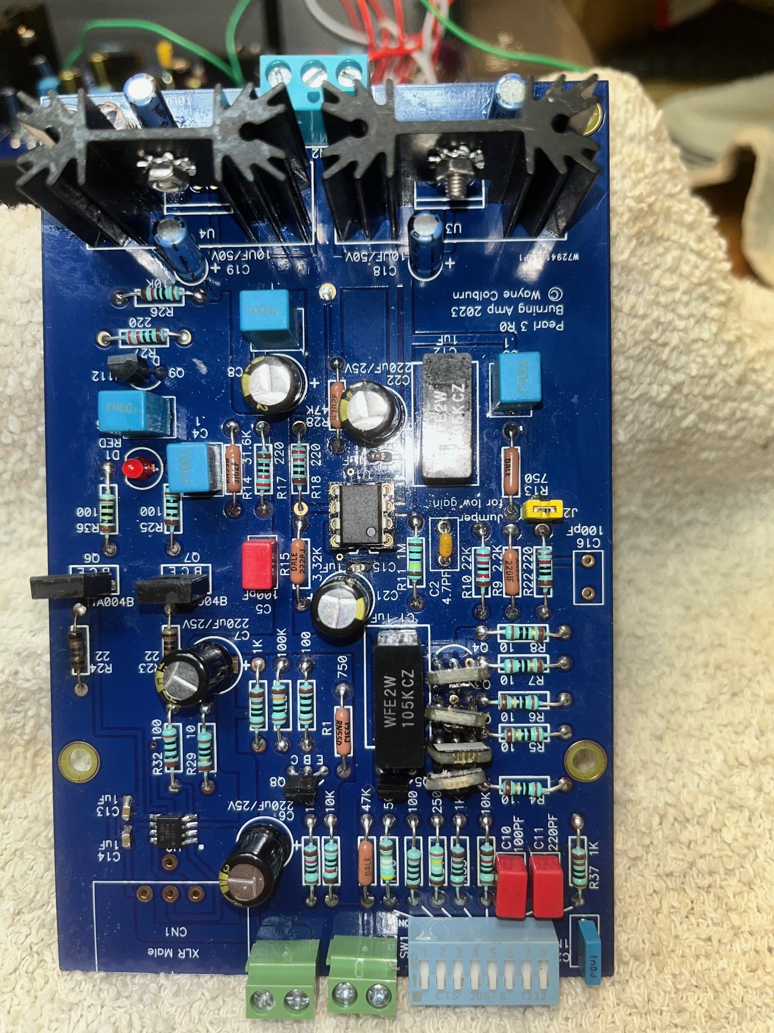

Hmm, I getting 9.5 on the second board (with the 18v board disconnected). I haven't changed D3, but that shouldn't make any difference. I cannot be sure, but it's likely that the second board is the one with the Q6 issue. I can't do any more today, but I can look at it tomorrow. If you have a schematic showing dc voltages, that would be useful. Also, any other ideas appreciated.
IDK, Looking at C14 on the 2nd photo, it might be shorting. The capacitor is turned some. Did it bridge solder underneath?

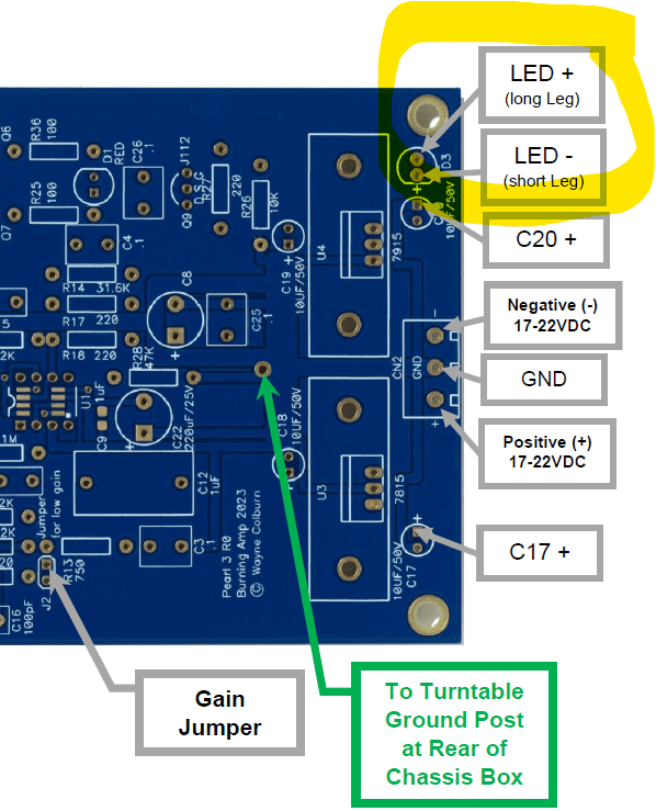

I made this mistake as well. I thought it was odd, then realized that the plus side was for C2!Also, check d3. Note from the build guide... The + symbol is for C20, NOT D3
The led on the power supply...guide says "treat like described" in phono part. It has a + by the round hole. Instructions for phono led say "long leg is square (positive) hole. Yet the + is by round hole. I can figure out how it should go, but didn't know if this was a flub in the guide, or more likely my user error? It was getting late ...unlike phono part, no cap pad near it...

I made the mistake too, and had read the manual.I made this mistake as well. I thought it was odd, then realized that the plus side was for C2!
This begs the question: did anybody not make the mistake of wiring the led backwards? 😆
The cathode is correctly marked on the led silkscreen. (the flat side of the outline)
Yes, I agree that the capacitor’s + symbol is confusing. Luckily if the LED is inserted backwards, nothing gets hurt and you only need to reverse it.

if that's directed at me, ( I assume not ) No. I'm talking about the power supply box and its single led on front panel. no cap near the led pad, + by round hole... guide says "same as phono box led ", which says, long leg (positive) in square hole....these are the LEDs that fit into the front panel, right?

D3s on both phono boards were installed backward, have been replaced, and work fine. The board symbols and the instructions are clear. Operator error - RFD!

Phono 2 is the board where Q6 had been installed backwards (RFD!). New Q6 now in place.

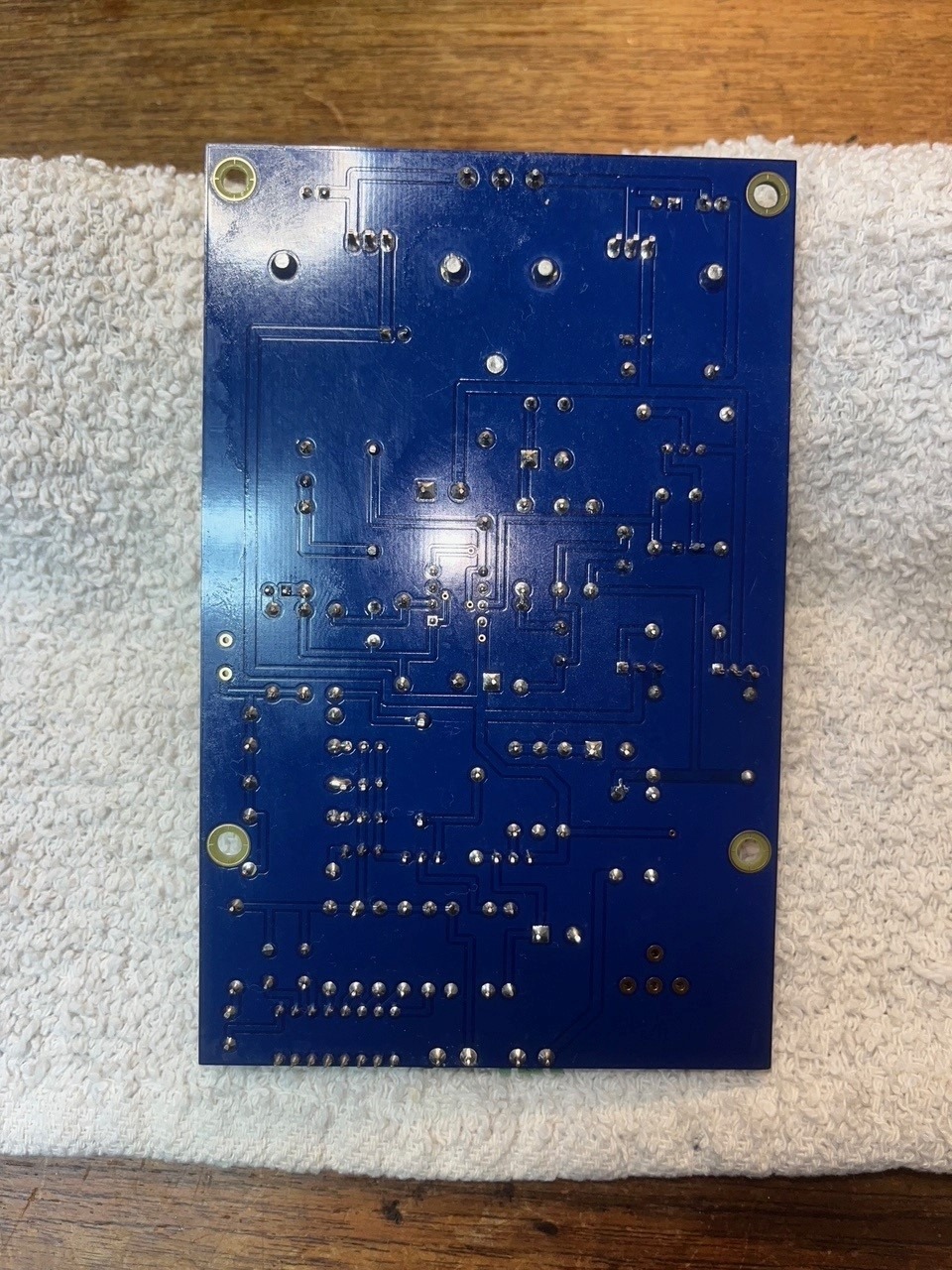

Inspection shows no suspicious soldering. Comparison of dc voltages of both phono boards when connected (10v, 10v, 10v) shows no differences between boards. Apparently schematic with dc voltages not available.

It appears that Phono 2 has a problem. Can you take some pix of the top and bottom of Phono 2? Let's figure out how to see that board show 20V unloaded on Phono 2. THEN what is the loaded voltage for Phono 1 + 2?

Agree that board 2 is likely the problem. If PSU + Phono 2 was 20v, then not so likely. I'll get some pics to you.I have ~50 of the 15+15V transformers in kits in my basement.... So we can solve that if needed.
