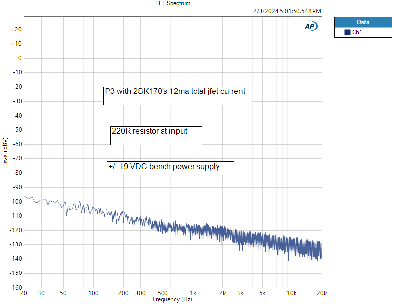

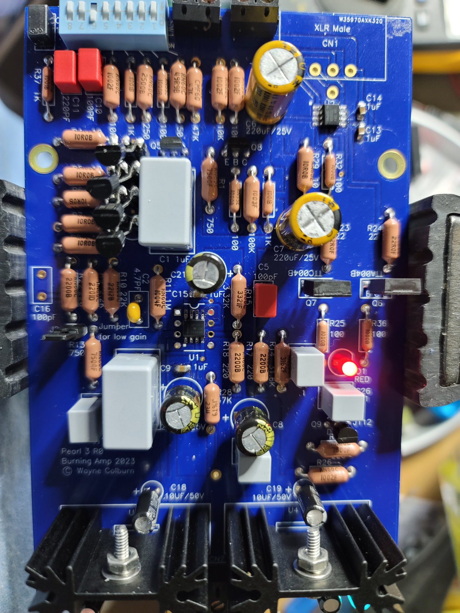

Hello All,
The DUT (Pearl 3) is on the bench powered up in the rubber jaws of my PanaVise. There is a 220R resistor across the input because it was handy. The resistors are all Vishay RN types mostly RN60’s. The Op-Amp is a 1656. C6 and C7 are both nichicon 100uf. The poly caps are mostly Vishay. The LM 7815 and LM7915 are both installed on the PCB.
The low gain jumper is installed at R22.
The Keysight bench supply is in series mode with 34VDC output, or 19VDC and -19VDC to the on PCB regulators. The power is a regulated 15 + / - VDC. The LEDs are both on.
The jfets are closely matched 2SK170’s with an Idss of 7.4ma. The current measured across R10 is a total current of 12ma. The jfets are plugged into sockets on the PCB, later I will roll in some 209’s and others.
The bias current through Q9 is 4ma.

Considering the size, 1,000uF, perhpaps ? 😉C6 and C7 are both nichicon 100uf
You are correct that is a typo. I tried to go back to edit but it was too late. Thanks for pointing that out.
Yes they are 1000uf capacitors.

Hmmm… this is perplexing. Everything look right, as far as I can tell in the photos, there are some details obscured by lack of resolution, but that’s easy to fix moving forward as needed.
So let’s begin by simplifying things a little, please disconnect the balanced outputs at the PCB and see if that makes any difference.
Also the umbilical at the RIAA chassis should have shield on pin 1, and pin 1 at the XLR Jack would be connected to the tab on the connector itself as shown. You may have it wired as shown, but can’t tell in your photos.

See the attached FFT plot of P3 in shielded16ga. steel cookie tin. Power wires are not shielded. FFT 48K length and 5 averages.
Not a hint of power line harmonics.
Removing the 220R resistor at the input and connecting the cartridge, plus grove noise will change things.
Thanks DT
220R is ~ 1.9nV/RtHz at room temperature...you have to adjust for the gain of the P3 (66 to 70dB) -- you should get a flat line past the 1/f noise corner.
One notable DIYAUDIO'r uses a 60R (~1nV/RtHz) resistor for his "sanity test" in the low noise amplifiers he has published over the years.
The 50/60Hz is extremely difficult to rid even if you are using a battery supply and muShield! I leave it to the men and women at Keithley!

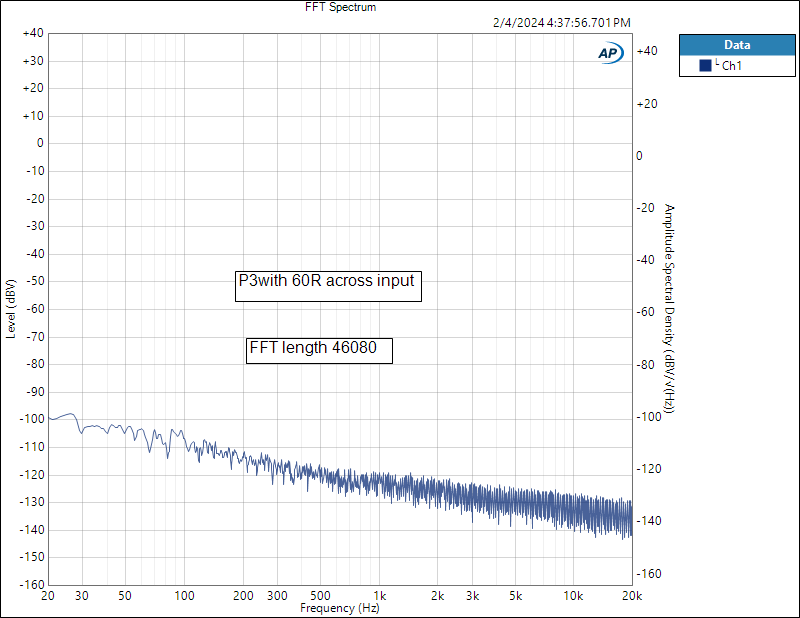

Hello All,
Still sorting out some observations.
I did input a test signal into the P3 PCB on my bench with the 4 2SK170's (Idss := 7.4ma each) the gain measured 50.4dB.
I am not thrilled with the AC power line harmonics that apparently leaked into the input and or BNC test lead from the analyzer. I will sort things out a bit more prior to posting that FFT plot.
jackinnj mentioned that there is a sort of standard using a 60R resistor at the input of low noise amplifiers for a "sanity Test".
I repeated the FFT posted the other day, now this time with a 60R resistor across the P3 input. Again the there is no apparent AC powerline harmonic distortion leading to to the thought that the power supply including the on PCB LM7815 and LM7915 regulators are innocent.
Also the 6 foot long conductors from the bench power supply are not shielded yet there are no apparent power line harmonics in the FFT plot.
So it looks to that a little bit of AC distortion at the input with 50.4dB's of gain can impact the noise at the output.
