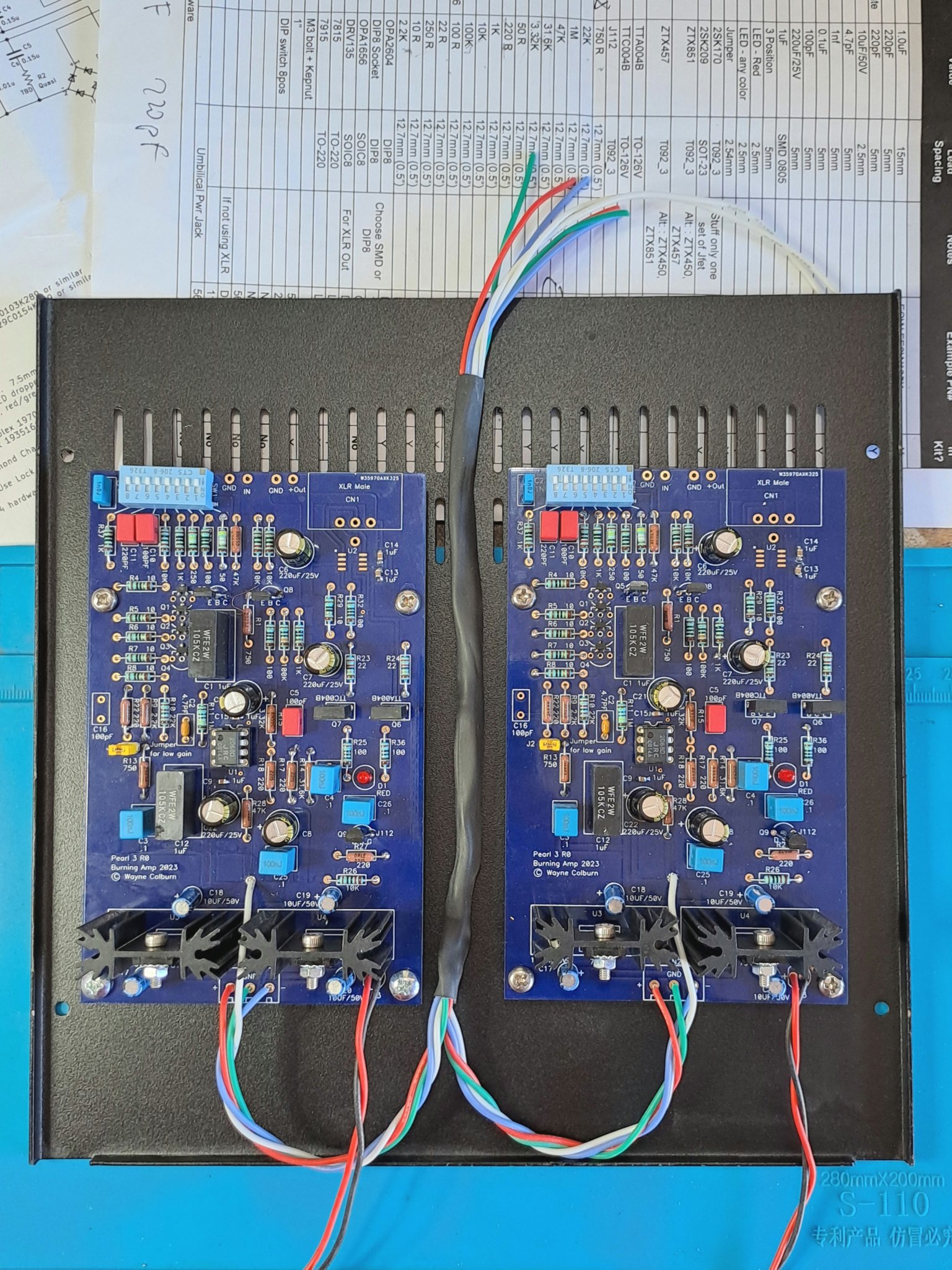

May I suggest something I was considering. Reverse the orientation of the top and bottom plates if you can so that the vents are above and below the regulator heatsinks, and so that the signal lead wires to/from the Pearl 3 are covered by solid metal lids.
@ranshdow On a steel covers Modushop Galaxy, there is a bent-in tab that is intended to be placed against the inside of the front panel. This allows the rear panel able to be flush with the chassis top and bottom. If the panels are reversed, that tab will overhang the rear panel which looks awful and may impinge on connectors or printing, etc…
That said, it’s logical to want the solid metal over the inputs and outputs, which is why the Pearl 3 custom chassis has the vents on the “other“ end of the panel. It’s a subtle difference from stock, and was chosen for the exact reason you mention.
Your post made me realise that I have been doing it the wrong way round for years in a pair of enclosures for my DIY Bugle... 😕 Top side can be reversed, bottom side not because of the holes drilled into it. Oh well, I actually did not think it looked horrible, and I do not look at the back side anyway...

This way, input and output cables would cross the whole cabinetMay I suggest something I was considering. Reverse the orientation of the top and bottom plates if you can so that the vents are above and below the regulator heatsinks, and so that the signal lead wires to/from the Pearl 3 are covered by solid metal lids.
from the Faraday Cage aspect perhaps it matters less where the holes are than that there are holes at all?
for heat management hole location manages airflow. this isn't supposed to be critical in this unit -- provided the on-board regulators aren't asked to work too hard. the enclosure doesn't need holes at all, no?

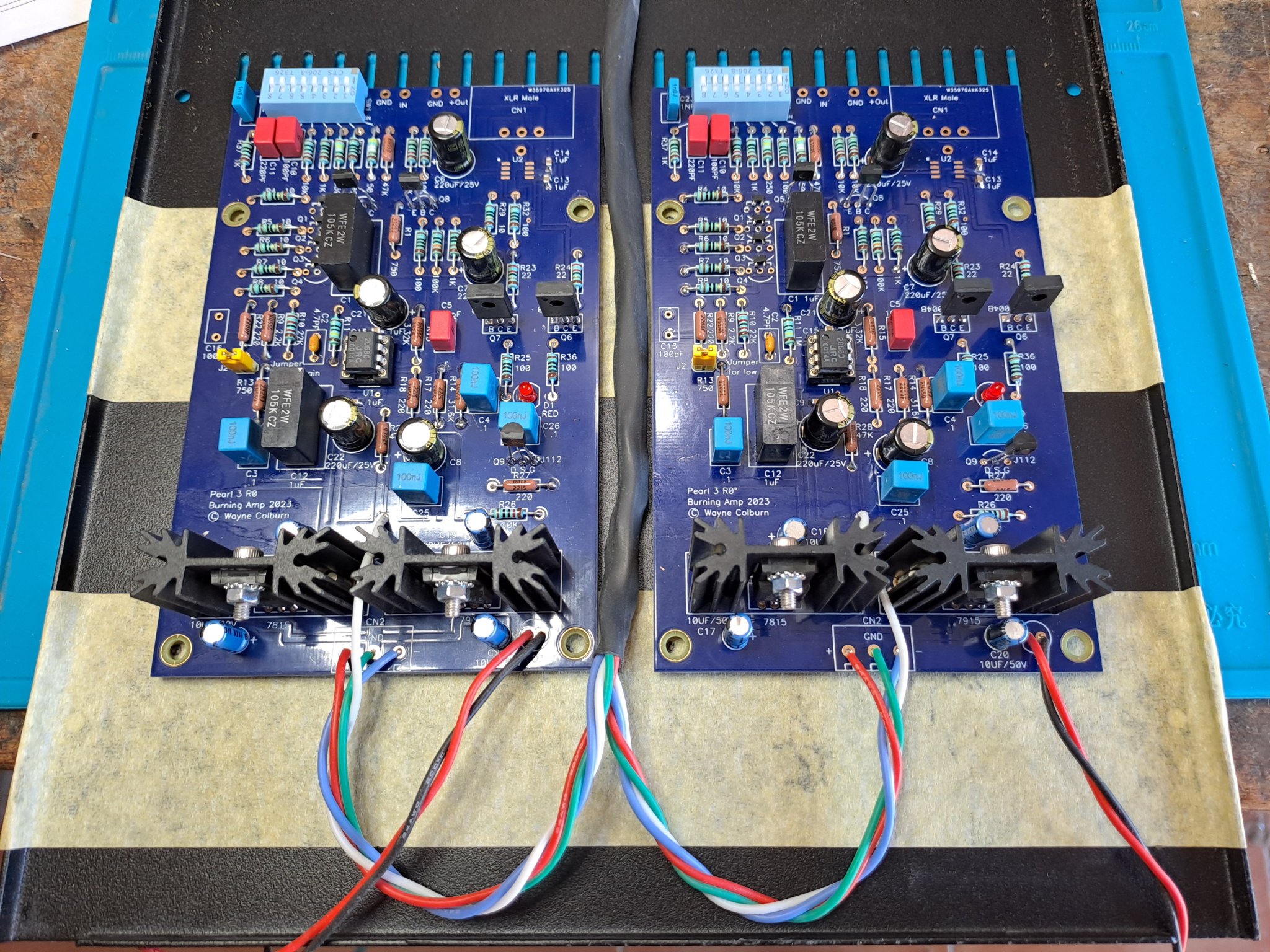

Stupid question I’m sure, after ordering the umbilical from Mouser…i ordered the Mogame 2549 as indicated in the BOM, only to realize that the build guide was calling for “at least 3 conductors,” and the 2549 is only 2 conductor. So i ordered the 2534 starquad - 4 conductors - as recommended in this thread back about 30 pages or do. Soooooo…because i have been breathing too many fumes stuffing the boards, my brain is unable to determine the correct protocol for what one does with the 4th conductor.
Please help this poor confused nincompoop….😉
It either floats unconnected or connects the chassis grounds together. I think everyone says to try it both ways to see what is quietest in your system.
