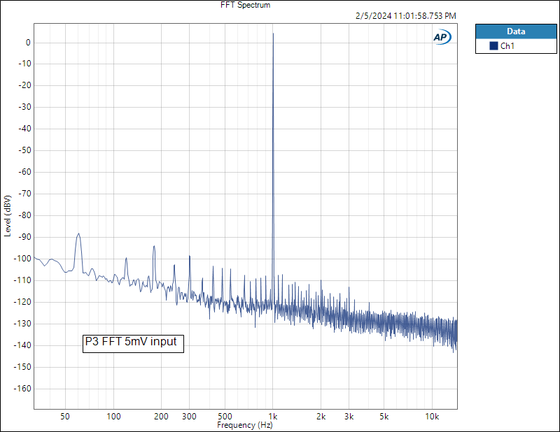

Hello All,
Went looking around, things seem to hide from you after you move.
Tested the P3 again today with different test leads, too short to get more than a couple of feet away from the bench with all the AC connected devices, There is less AC power Line Harmonics leaking into the P3 input today. I ordered from Mouser longer and I hope better Pomona test leads.
I have looked around at test reviews of other Vinyl pre-amps with the state of the BNC test leads on the bench today’s’ P3 test plots are as good as or better than I was able to observe on line.
At 5mV input the Gain at 1K was 50.4db. The output fell at 1.656 VRMS (more than you would ever use, “turn it down”).
The THD+N was 0.005%
Thanks DT
See the test plots below:

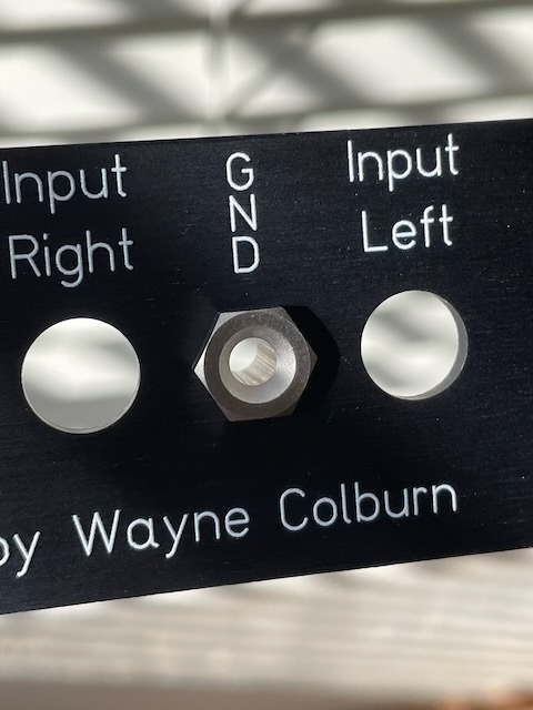

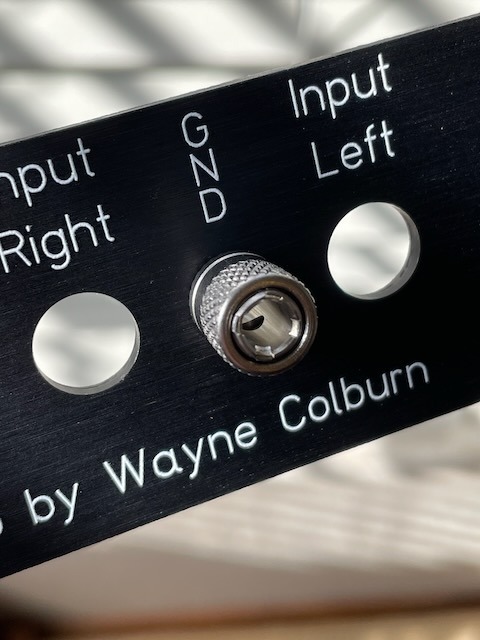

GND Post Options
I found a couple of nice grounding post / jack alternatives for my Pearl 3, and figured others might be interested:
• Cinch 111-2223-001 - uninsulated binding post with knurled thumb nut, nickel
Very reminiscent if not identical to the ground posts found on 70's - 80's vintage Tektronix test equipment. TM500, 7k series scopes, etc. In fact, noticing the ground lug on one of my Tek scopes shortly after my chassis kit arrived is precisely what inspired me to go searching for a similar grounding terminal, and I was delighted to find these. Knurled thumb nut is captive. This one did not come with a ring terminal; just the inside nut is included.
• Cinch 108-0740-102 - uninsulated low profile banana jack, nickel
These have a really nice low-profile look, which might suit those who know they only need a banana receptacle for their grounding wire. This one comes with a solder-tag ring terminal.
Both are available from Mouser, and both require drilling the rear panel hole to ø 0.25 in.
I'll be going with the knurled thumb nut version myself. 🙂

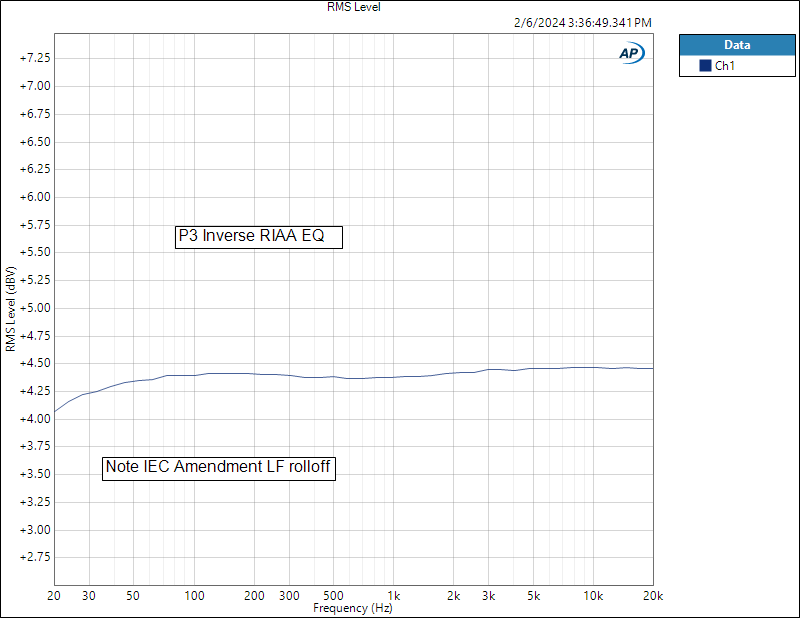

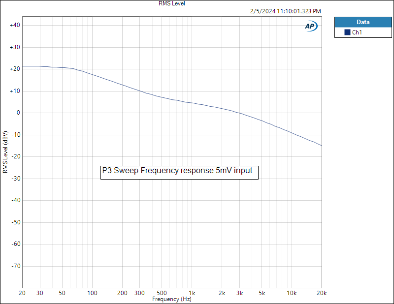

Hello All,
Still sorting the P3 on my my bench. Your mileage may vary.
I have been over at the ap.com site looking into measuring the results of the P3 RIAA pre-amplifier fabricated hear on my bench.
Using the Audio Precession Inverse RIAA Equalization Curve the a vinyl pre amp would produce a horizontal straight line on the FR Plot. The plot pretty much shows + / - 0.1dB of a flat line on the plot.
The Low Frequency ~0.3dB roll off is the the result of the IES amendment built into the design. I think.

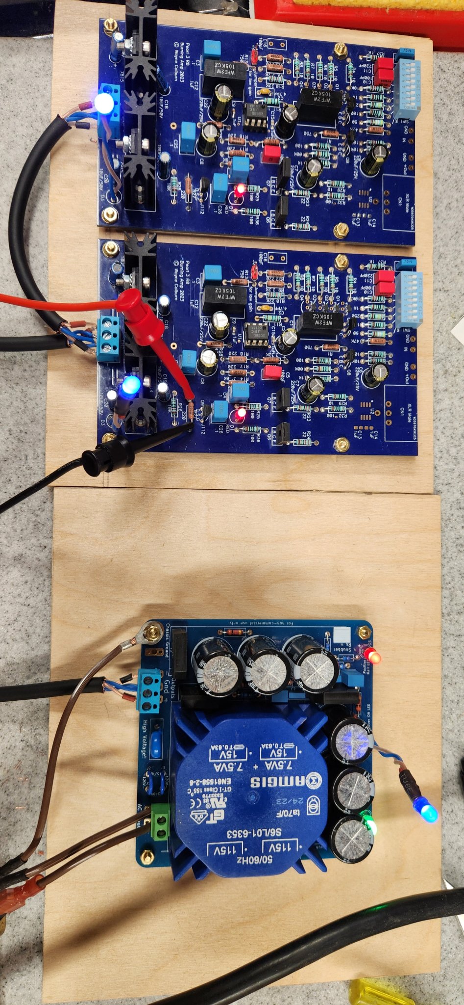

Looks good on the frequency response and noise DT. Love those RN60 resistors.
The jfets are closely matched 2SK170’s with an Idss of 7.4ma. The current measured across R10 is a total current of 12ma.
I think you meant R1?
I am also going to use 2SK170's from my stash, I have a closely matched octet at 6.3mA Idss which I've been saving for a new phono.
But looking at the data sheet curves I estimate I should get about 12 mA through Q5 C-E & R1 ... now, I've been trying to figure out how that doesn't just saturate the collector of Q5, because it's base should be sitting at about 7.1V, and at 12 mA, R1 should be dropping 9V. Have I mucked up my math somewhere, or does R1 value need a little adjustment based on the JFET you stuff? Wayne mentioned the K170's should just drop right in.

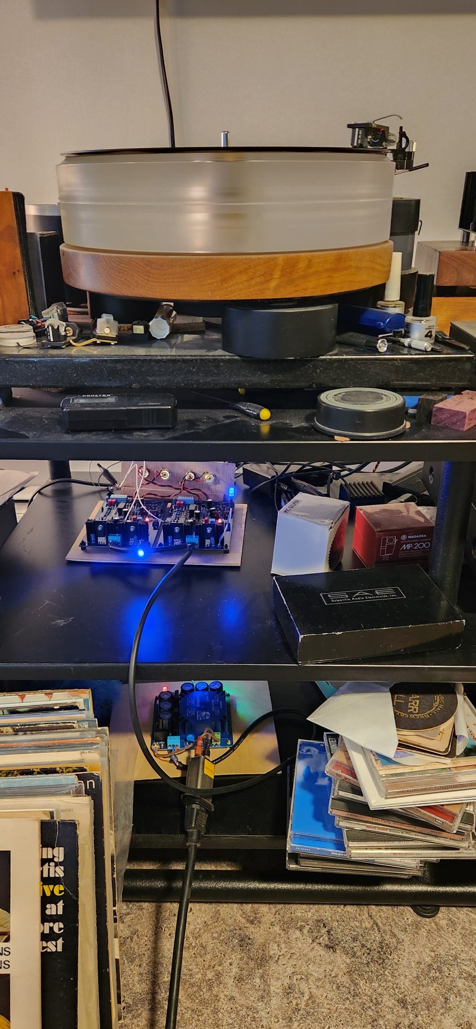

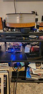

It's alive and sounds great! Just ordered the case. Sitting out in the open on a piece of wood it is spooky quiet with nothing playing.
Measuring -14.9 and +15.2 on both channels. With R27 at 680R one channel is 3.90mA and the other is 4.35mA. That is the extent of my testing.
Not much of a reviewer but this thing is a keeper! I think I now understand what people mean by a blacker background. Sound stage is really good and it is easier to notice all the various details in the music.
Thanks to everyone that made this possible, and for all of the help and inspiration provided by this forum!
Good eye, you have to keep an eye on me. It was R8 I did the current calculations with.
E = IR, voltage drop across R8 / 10 Ohms equals total current through R8 or 12ma +/- a red curly hair.
OK, I didn't account for Q5 base current pulling the R2 / R3 bias network to roughly 0.6V lower. I'm still not sure that leaves enough voltage on Q5 collector without reducing R1 though...
With my pencil, paper and HP calculator it looks like with this circuit there is a voltage divider thing going on. From the reports of other members here on diyAudio it looks like we get about 41% of jfet Idss measured across R8. For your matched 2SK170 sets of 4 jfets that is 6.3ma * 4 * 0.41 gets ~= 10.33ma total current through R8.
This is right in the center of good, this is more Idss current than the GR 2SK209's that most people are using. You likely do not need to change anything.
