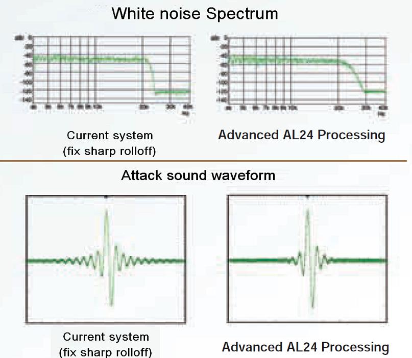

AttackKing sound --> Slow Rolloff mode
This is a catalogue of DENON DCD-SA11 with slow and sharp rolloff automatic changing new ALPHA system.
I read this figure, DENON seems like to choice slow rolloff if play back attackking sound like attack hi-hats.
I don't understand why they don't choice sharp rolloff that good high frequency responce.
And my biggest suffering is, does not a problem occur even if changing rolloff curve of long TAP FIR filter, when playback music.
