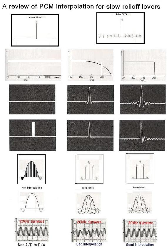

Lovers opinion
__1) slow rolloff lovers (They forget interpolation, so they take RINGING not be good)
__2) sharp rolloff lovers (They know interpolation, so they understand RINGING to be needed for good interpolation)
__3) analogue LP's fans (They forget why needs LPF when A/D & D/A conversion, and they are confusing RINGING with distortion)
KEYWORD is
_____________ IMPULSE _____________
__sample_____ OVERLAP _____sample__
__44.1kHz_____ 44.1kHz _____44.1kHz__
KEYWORD is

There are 2 characteristics, when playback TEST CD playback mode is no ringing impulse mode, and when playback Music CD mode is ringing impulse mode, changing automatically.
Therefore, if we playback sine wave, there is not distortion like slow rolloff.

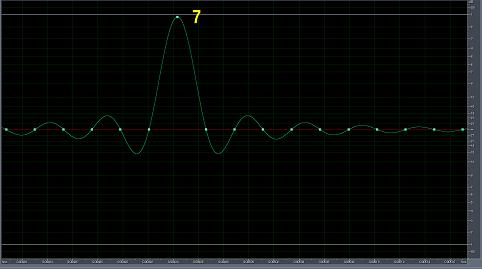

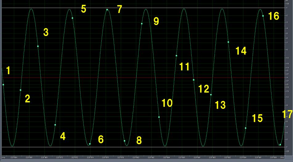

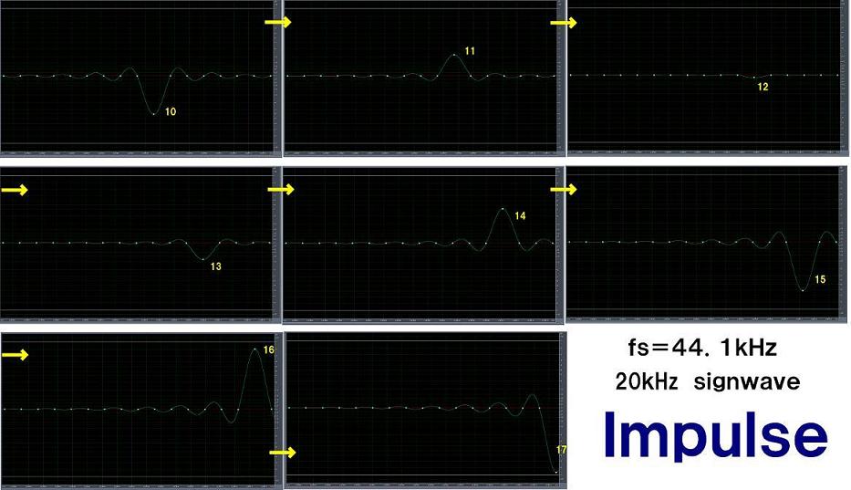

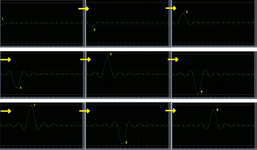

at 16bit 44hz / CD format, you have only 2 samples to represent a 20khz sinewave (2 samples / sinewave cycle), the problem stems from this root cause.
So this is a highly biased test, cause 8x interpolation attempts to guess and adds many more samples, and if its linear phase and steep, then it adds them in a correct way (again this is all for continous sinewave - nowhere in music!!) .
This is the same biased test as the NOS 000-111 squarewave (again , nowwhere in music!! 000-111 is not bandlimited).
The deception around digital filters (or their absence) is insane, and ther is a boatload of arguing going on everywhere.

Slow roll-off @ 20khz :
AM modulation on 20khz source, looks rather like a "musical waveform" instead of measurement data
AM modulation degree is lot smaller @ 15khz , actually its insignificant.
AM modulation non-existant @ 10khz sinewave test.
Should I care about AM modulation at 20khz?
