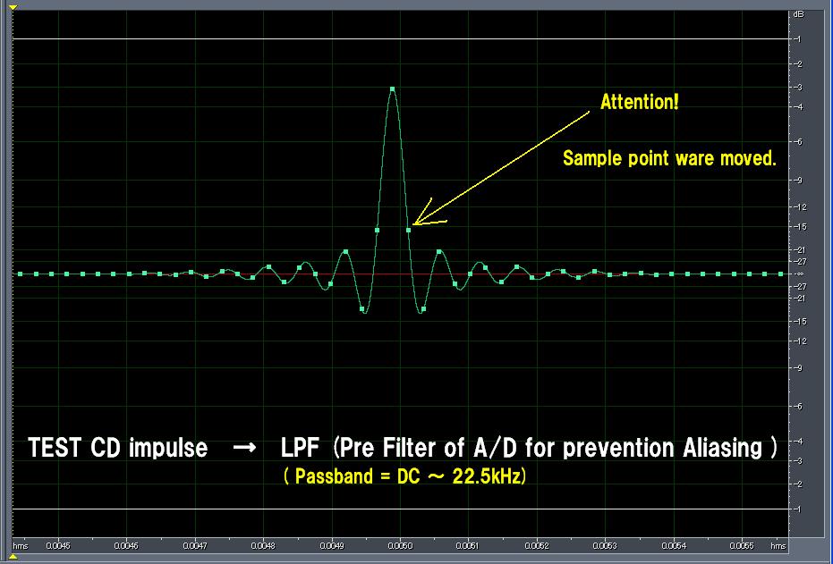

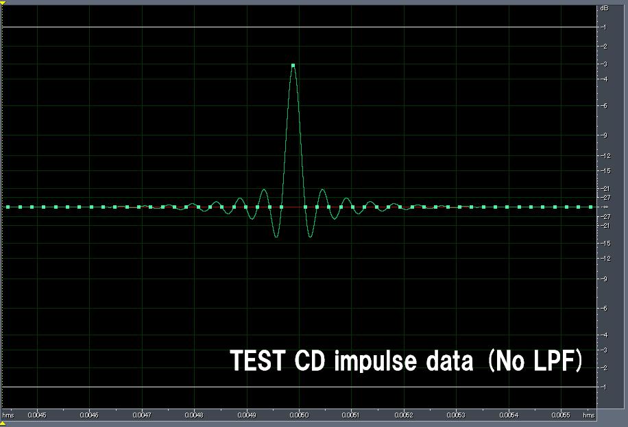

Low Pass Filtering Impulse = A/D data
Hi! I am Tetsuya, Planner of original ALPHA's joke mode.
Let's think about "Band Limitting Impulse" like A/D conversion Music.
This Impulse is "TEST CD's data"
The data of sampling points are 000000010000000....

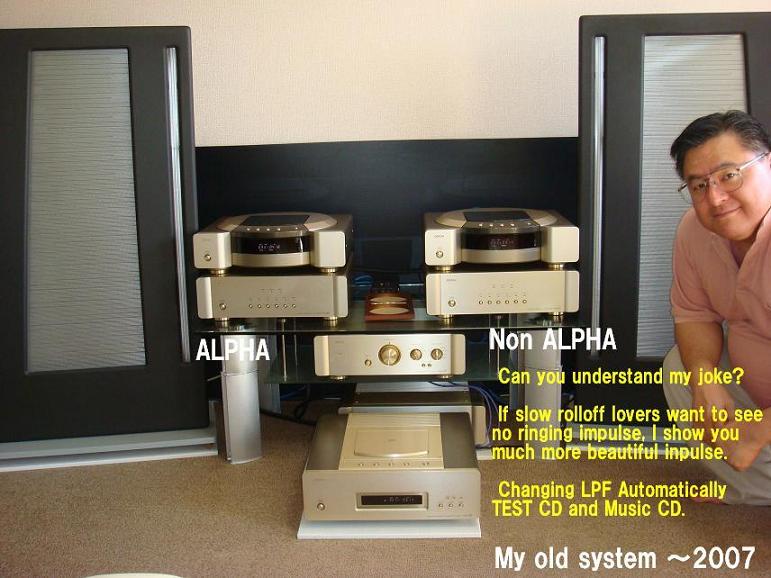

DA-S1 is this.
These D/A converters are my DENON DA-S1.
One DA-S1 is setting non ALPHA mode, and another DA-S1 is setting ALPHA mode.
If you have DENON CD Player that have original ALPHA processor, you can easy to set Non ALPHA or ALPHA by front pannel button.

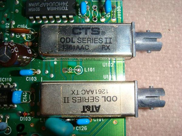

My DP-S1/DA-S1 also "384fs clock direct sync with ST-Link fiber cable, no PLL" But DP-S1/DA-S1 has selectable slock system.
1 is conventional S/PDIF AES/EBU DIR with +/-1000ppm rock in range LitaO3 VCO mode PLL,
2 is conventional DIR with +/-50ppm rock in range VCXO PLL and
3 is one clock crystal oscillator for CD decorder and Digital Filter DAC, by transmitting 16.9344MHz clock signal with ST-Link fibar cable.

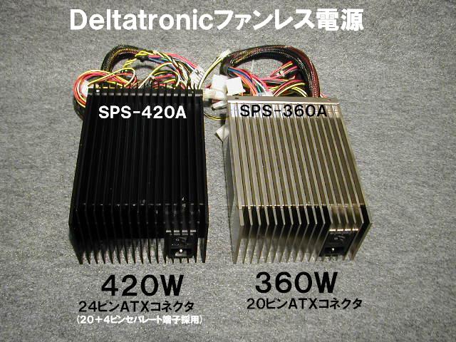

Measurement mechanical noise
Measurement my HDD transport ( Just PC )mechanical noise
http://www.teddigital.com/serv02.htm
attached file picture is FAN less power supply.
Measurement and recording of FAN noise
http://www.teddigital.com/serv01.htm
Is such an effort useless?

Re: DA-S1 is this.
HI Tetsuya ( hey you are young , not old!).
Wow ! I was near sure of that.....two pair DENON !!
So you can hear easily "a difference ", no?
At the time, 15 years ago , a friend of mine had the Denons jewels.
I have listened at they 2-3 times but a lot of time is passed....
Please can you says what type of differences you can hear ?
And I am curious to see measurements in NON-ALPHA mode too.
I imagine frequency response do not change, impulse become ringing, etccetera. Am I right?
As I said my stupid friend has sold it !
But now, after your explanations, I am confused;
You speak of Joke, but I remember you have won various "awards" for your Alpha Processor.
All "Ignorants" in the Jury? :
One more . If I have well understood, your circuit is "incomplete" sort of, because during the A/D phase-process you do not have the "corresponding "-"specular" circuit.(?) Am I right or totally wrong?
Thus, apart beautiful pics for "morons audiophiles" ( ironic here), does Denon made a sort of "false"- technically and ideological ?
I am very worried by this aspect. Am I totally wrong?
and Cheers,
Paolo ( disconsolate ex Denon-fan)
