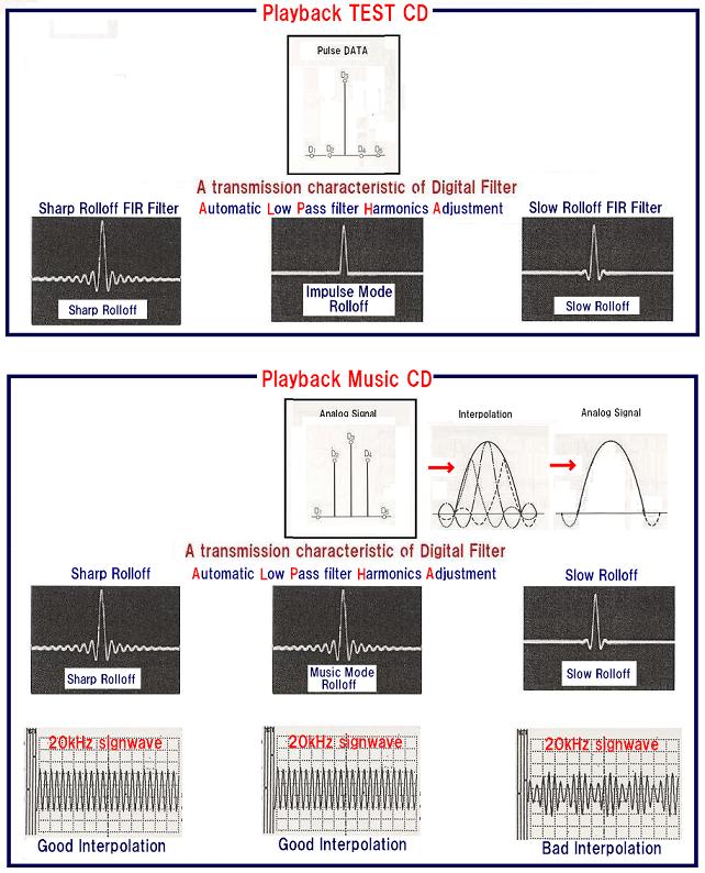

Original ALPHA processing in 1993 has 2 function.
One is Adaptive Line Pattern Harmonized Algorithm that revises 1LSB stepped wave pattern.
Two is Automatic Low Pass filter Harmonic Adjustment that playback no ringing impulse waveform, more beautiful than WADIA's when we played a test CD.[/B]
Understood. Two is foundamental IMO....
New ALPHA processing from 2004 has 3 function.
One and Two are same as 1993 original.
Three is "Slow Rolloff" and "Sharp Rolloff" automatic changing function. And these new generation model has very long TAP FIR filter made by powerfull Analog Devices's SHARC DSP.
I think it is no problem, when changing rolloff curve with muring .

2nd function of ALPHA (changing LPF carrasterics TestCD & MusicCD)
Hi! inertial,
ALPHA has 2 function.
The first one is revises 1LSB stepped wave pattern, this is not joke.
And the second is, we can get no ringing impulse, much more beautiful than Slow Rolloff when we played a test CD.
This is [my] joke for "Slow Rolloff freaks". I say [ ] reason as follows.
I don't like SlowRolloff that because remaining mirror noise up to 22.05kHz @fs=44.1kHz, very bad high frequency waveform.
My opinion is we must cut mirror noise up to 1/2fs by long TAP Sharp Rolloff FIR and analog LPF.
And many people misunderstand, that they think about short ringing when playback impulse in TestCD is better than long ringing.
Long ringing is very important for good interpolation at D/A conversion. People should notice it.

Hi! inertial,

nagaesan said:Hi! inertial,

The first function of ALPHA processing was devised by Dr.Hayashi, and developped by Mr.Ohtsuka.
But second function, I devised, and Mr.Ohtsuka developped.
In addition, the naming of this 2 function "ALPHA", the person is Tetsuya Nagae who likes technical jokes.

Inertial, read more carefully, especially the graphs.. The joke is :
Automatic
Low-
Passfilter
Harmonic
Adjustment

LPF characteristics when playback Music or Test CD was changed.
I say that RINGING is better than NO-RINGING for Music.
Do you know "interporation"?
Why slow rolloff 2okHz sign wave is bad than sharp rolloff?
For slow rolloff lovers, NO-RINGING when playback TEST CD (impulse or square wave), it is more beautifl than slowrolloff DF's short-RINGING.
And do you know the purpose and the difference of WADIA's slow rolloff FIR filter by one stage interporation and others(like SM5843A or DF1706's "3 stage cascading FIR filter) ?
WADIA's short RINGING impulse have become slow rolloff by short TAP FIR but one stage 16fs oversampling for no analog LPF device.
DF1706's purpose is ....... getting "short RINGING impulse" itself.

nagaesan said:I say that RINGING is better than NO-RINGING for Music.
Hi Tetsuya ,
Perdone me . My basic english can seems as like "provocation".
It is not so. I'm sorry if I have exposed bad my "thinking".
I am ignorant on digital, this is evident 🙂
When you say "Why slow rolloff 2okHz sign wave is bad than sharp rolloff? " is this statement motivated by math ( objective) or by listening preferences ( subjective) ?
Interpolation ,I have to study it !

When you say more beautiful, do you intend because oscillogrammes looks visually better ( to inexpert eyes) OR because the sound is more pleasant ( to ears)?
[/B]
Maybe I have understood jet the basic principle but nothing more
[/B]
Ok, this is copiright by wadia. I remember the first listen of the 2000 DAC. WOW!
DF1706's purpose is ....... getting "short RINGING impulse" itself. [/B]
