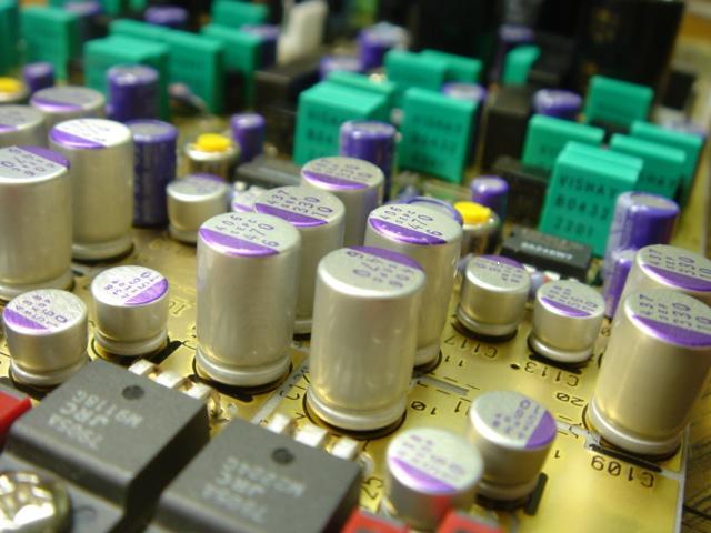

Hello PCM1704 enthusiasts,
I choice SANYO OS-CON for CAPs of PCM1704.
http://www.edc.sanyo.com/english/products/capacitor/oscon/download.html
As you know this SANYO OS-CON is very low ESR and good frequency characteristics.
1997, I used REF-DC was 47uF, SERVO DC was 47uF, BPO-DC was 100uF as is PCM1704 datasheet.
But from 2004, I am using REF-DC is 330uF, SERVO DC is 330uF, BPO-DC is 470uF not as is PCM1704 datasheet.
http://www.teddigital.com/COPS1708z201_en.html

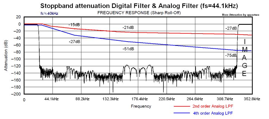

352.8kHz Image Noise and Analog LPF
Hello Telstar,
I think low order analog LPF is good for hearing music than high order.
But in 8fs interpolation D/A conversion, with digital filter like DF1706 and 2nd order analog LPF fc=40kHz, we must attenuate 8fs(352.8kHz) image noise.
Did you chack high frequency waveform quality that 20kHz signwae @fs=44.1kHz?
Hello Telstar,
I must check spelling
Did you check high frequency waveform quality that 20kHz signwave @fs=44.1kHz?

Analog LPF when we use 8fs DF DF1706 and 96kHz DIR DIR9001.
Hello Telstar,
Lets's talking about analog LPF when we use 8fs DF DF1706 and 96kHz DIR DIR9001.
You choiced 2nd order bessel analog filter. And rudee choiced 4th order. Now, many CD player manufactures choice 3rd order analog LPF with 8fs DF.
I imagine why rudee choice 4th order LPF, that he used DIR9001, this is OK fs=96kHz. If this passband are 40kHz when 96kHz source, cutoff frequency is over 60kHz or 80kHz.
I think that there are various opinions, how far should suppress the 352.8kHz image noise, but when we should think about LPF, it is necessary to think in a partial part.
1)Source 44.1kHz or 96kHz
2) Cut off frequency 40kHz or 60kHz or 80kHz or 100kHz
3) Decrement -12dB/oct or -18dB/oct or -24dB/oct
4) Characteristic Bessel or Chebyshev Type1 or Type2 or Butterworth or Elliptic
5)Type of circuit Sallen-key or GIC or passive

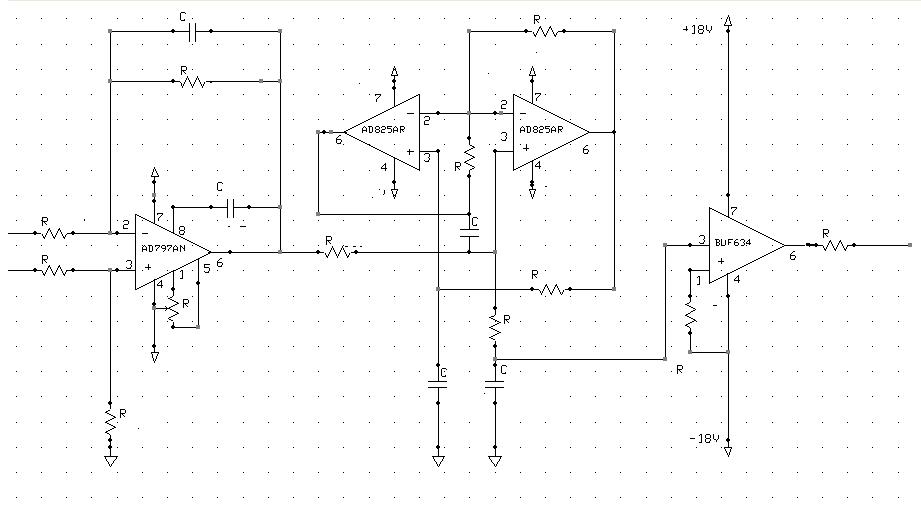

By the way, this is 3rd order GIC analog LPF of my PCM1704 board.How do you think about this at 8fs over sampling @fs=44.1kHz?

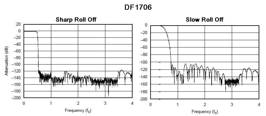

nagaesan, how do you like "slow" roll-off in digital filter (df1706) ?
I want to try 4x OS (192khz exactly) "slow" and 3rd order 18dB/oct low pass, maybe not enough? I only care about HF supression this time , no slew rate related. Just simulated, im down to -120 dB at 38000 hz with this digital filter.
BTW Im sure your design qualifies as enough HF supression , but not so sure about mine

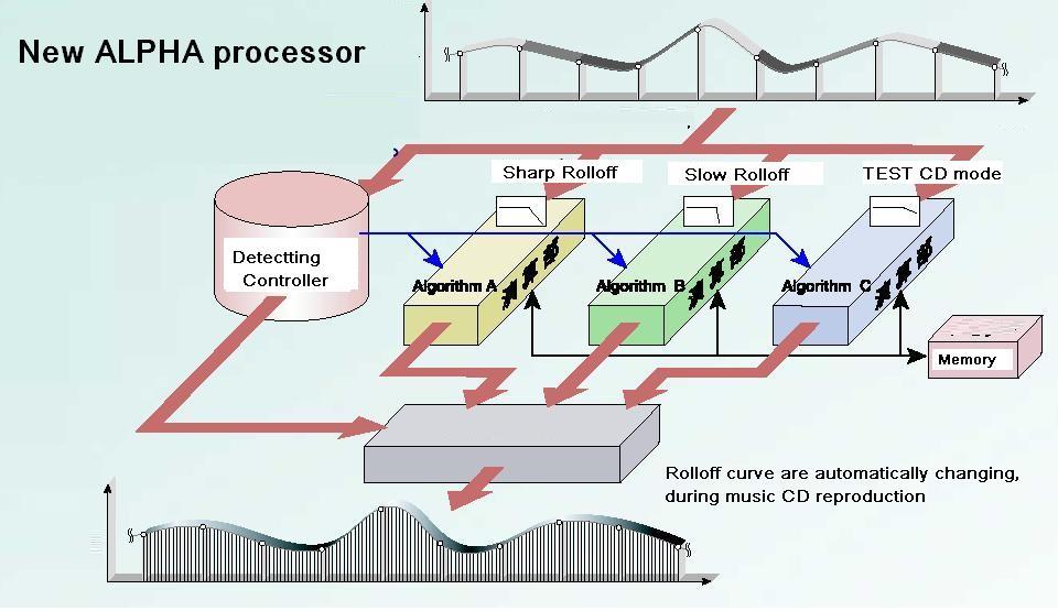

The Slow Roll off effect between DF1706 and Wadia's
My opinion of Slow Roll curve of Over Sampling FIR Digital Filter @fs=44.1kHz source hearing is follows.(Please do not be angry I write this reason clearly.)
-- Tetsuya's opinion --
1) It was nice idea, that one stage interpolation, very low Taps FIR filter like Wadia 2000, 2000SH, 64.4, etc...
2) It is stupid things, that 3 stage cascading type interpolation DF.
The interpolation FIR filter of Wadia 2000 was used AT&T DSP16 x 4. And this FIR filter is one stage interpolation with very fast oversampling that was 16fs but very low TAP (15 TAP FIR), because using DSP which there was a limit potential.
Naturally, this very low TAP FIR filter's roll off curve was came to "Slow Roll Off".
When I tested Wadia 64.4 D/A converter @20kHz signwave, there was amplitude modulation and response was -2.7dB.
But the sound of Wadia 64.4 was very nice because this model has "One stage" FIR filter and good analog circuit.
I think that you remember in about 1989 to 1992, it was prevalent "Slow Roll Off". Luxman DA07 and Pioneer PD-T09 with "Legart Link Conversion" are "One stage FIR filter with Slow Roll Off"
And in 1992, NPC rereased SM5843A slow roll off FIR filter for ONKYO integra C-1E.
As you know SM5843A is 3 stage cascading type interpolation Digital Filter, output word length was 20bit, and internal 21 x 22bit parallel multiplier / 25bit accumlator.
About 1992 or 93, I was contacting NPC (Nihon Precision Circuits) people for planning DENON DA-S1/DP-S1 and DCD-S1 CD Player. NPC people Mr.Tohyama and Mr.Takeda requested me to adopt SM5843A for DCD-S1.
But I said "No thank you, I don't like slow roll off DF".
When I say like that, NPC people explained me, "SM5843A has Slow Roll Off also Sharp Roll Off curve".
In sharp roll off mode, the 1st stage of interpolator was 2fs oversampling with 153TAP FIR, 2nd stage was 29TAP, and final stage was 17TAP. It was nice stop band attenuation spec.
And in slow roll off mode, the the 1st stage of interpolator was 2fs oversampling with 25TAP FIR, 2nd stage was 29TAP, and final stage was 17TAP.
Then we adopted highly cost SM5842AP for DA-S1, but we need much more low cost DF for DCD-S1.
For such a reason, we DENON adopted SM5843A with sharp roll off mode for DCD-S1.
Hi Mr. Tetsuya, excuse my basic questions because I am a totally newbie ( but I have good ear ! 🙂
I do not understand 100% your comments 1) and 2).
Is it nice idea or "stupid" idea ? ( or ironic ? )
When I tested Wadia 64.4 D/A converter @20kHz signwave, there was amplitude modulation and response was -2.7dB. [/B]
Excuse again, Please what is TAP ?
[/B]
Agreeed about the nice sound of wadia, but IMHO his analog output stage is "rubbish" ! 🙂
I think ( theory) the impulse response and indicial response is the key; am I wrong?
And in slow roll off mode, the the 1st stage of interpolator was 2fs oversampling with 25TAP FIR, 2nd stage was 29TAP, and final stage was 17TAP. [/B]

SharpRolloff and SlowRolloff automatic changing
Hi! inertial, thank you.
I am not a developper but a planner of ALPHA processing of DA-S1 or DCD-S1. This developper of ALPHA was Dr.Hayashi and Mr.Ohtsuka. And now I moved to the other sections, recently, young DENON people are in charge this renewal and development.
For such a reason I have no plan of inprovement of ALPHA processing, but recently there is the part which I cannot understand new ALPHA processing which young people developed.
Original ALPHA processing in 1993 has 2 function.
One is Adaptive Line Pattern Harmonized Algorithm that revises 1LSB stepped wave pattern.
Two is Automatic Low Pass filter Harmonic Adjustment that playback no ringing impulse waveform, more beautiful than WADIA's when we played a test CD.
New ALPHA processing from 2004 has 3 function.
One and Two are same as 1993 original.
Three is "Slow Rolloff" and "Sharp Rolloff" automatic changing function. And these new generation model has very long TAP FIR filter made by powerfull Analog Devices's SHARC DSP.
I think it is no problem, when changing rolloff curve with muring .
I think DA-S1 was not perfect, there are many points that we should be improved refer to WADIA's nice circuit, but I do not admire that doing a thing. Still I don't like "Slow Rolloff".
If there is a person knowing FIR filter, please teach it to young generation people that changing characteristic of rolloff curve, during music reproduction is nice function?.
