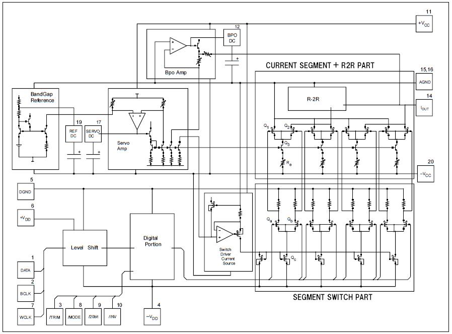

I'd note also that the DAC output isn't "processed" or "run through" by the BPO. BPO is an offset current derived from the same buried zener reference used by the DAC sections. Without the BPO the PCM1704 would output 0 to -2.4mA. The BPO biases the output with 1.2mA current to make the output symetrical around zero: -/+ 1.2mA.
You can see this clearly on the PCM63 where both the raw DAC output and the Bi Polar offset current are available as separate pins.

spzzzzkt said:I'd note also that the DAC output isn't "processed" or "run through" by the BPO. BPO is an offset current derived from the same buried zener reference used by the DAC sections. Without the BPO the PCM1704 would output 0 to -2.4mA. The BPO biases the output with 1.2mA current to make the output symetrical around zero: -/+ 1.2mA.

Re: Re: BPO
Yes, there are obviously some differences between these chips but the basic architecture is the same in all the BB Colinear dacs.

If I have well understood, you says that BPO is not in series on the signal output ( for the audio-band) but it is in parallel, am I right?

Re: Re: BPO
Yes, in parallel.
nagaesan's attachment shows a block diagram of the pcm1704 architecture. The connection of buried zener reference -> BPO Amp is to the Iout. You can see why the ref and BPO decoupling caps make a difference to sound - any excess noise is dumped straight onto Iout.

PCM1704 size and type of capacitors
Nagaesan kindly offered up the architecture of the PCM1704 which was most illuminating.
I note that rather large electrolytics are specified for the relevant capacitors in the TI datasheet (large for those of us who prefer 100% polypropylene film at least):
REF DC 47uF electrolytic
SERVO DC 47uF electrolytic
BPO DC 100uF electrolytic
I am considering going 100% film and am wondering if the actual values have much importance.
My thinking is that the value of REF DC is is unlikely to be of importance to the operation of the part particularly if the supply to the chip is very well bypassed, but that the value of SERVO DC and BPO DC does have some significance on the operation of the part where one might actually benefit from going bigger. On the flip side, it seems reasonable that the noise quenching qualities of smaller film caps should be way better than the larger electrolytics specified.
