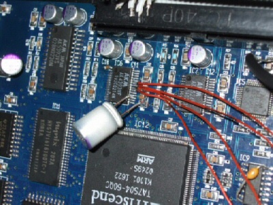

Re: Several parts not needed with the AK4395
Hmmm, I found that on my deq2496, a nice Oscon directly on the AVDD pin improves the sonic (I am using tranny direct out).
I found the deq2496 poorly decoupled. Eg, for the ak4393 on the datasheet, the Avdd and Vrefh should have separate caps, but the deq only only have 1 ceramics for both pins.

I've done most of my work on the DCX2496. Never looked at that on the DEQ. It's interesting that the supply around the dac is different between these otherwise similar units. The DCX has a separate 47uf and bypass for Avdd and Vrefh. I have a DCX board with every electrolytic bypassed with an oscon and a film cap and honestly don't know if I could tell it apart from a board without.
Still, either Behringer offers amazing sound for the money (at any price?) with a direct out mod using either high quality transformers or caps. I like the extra detail of the caps and, with the 4395, don't need the filtering of the expensive transformers, which really adds up times 6 channels in the DCX.
You will also want to try the AK4396 which is a drop in for the 4393. It is night and day better especially if you don't want to bother with the clock.
