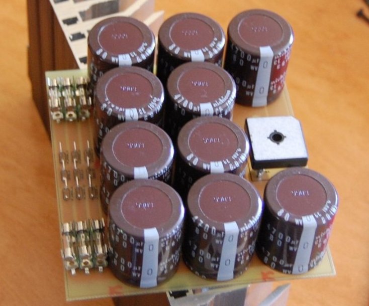

I had a malfunction with my power supply. It seems that the rectifier diodes (1N5406) were not up to the task of charging all of those filter caps. Two of the four failed, and went short circuit. This happened as I plugged the transformer in, and tripped the panel breaker.
SO, I designed and build a new one, with the GBPC25 rectifier. I made the shape different, square rather than rectangular. I think two of these will fit better in the chassis.
Doing things in a rush, i made the fuses a little too close to each other. I have slipped a thin piece of plastic between each.

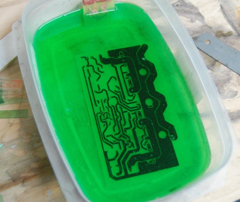

Not lime Jello, boys and girls...
I put some final touches on my new board layout, ready for etching.
My new supply of blank boards is still not here, but I did have a few pieces of double sided left. I used one that was big enough and went ahead and etched the board. I have a pretty good system going for this and I only use enough acid / peroxide mix to do one board. I then discard that mix. I have tried to re-use it in the past, but it has lost all of it's potency. Better a fresh batch every time.
For trace repair if needed, I use a paint marker. I gave up trying to find that magic Sharpie that this mix will not eat. Paint marker works beautifully, dries fast and is absolutely impervious to the acid mix.

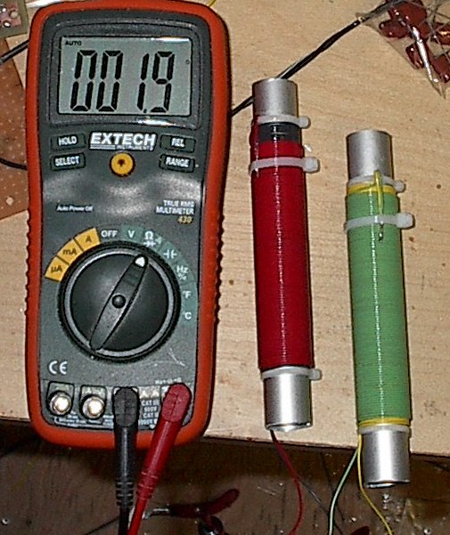

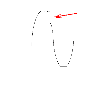

I have a clipping "problem" at 20kHz. The sine wave top breaks harshly on the down slope. I don't have a pic of this, but I drew a bit of an illustration below.
Am I right in assuming this is caused by the EF on the VAS going into saturation? If so what is a cure?
Playing with the simulation, if I increase R7 (collector to ground on the EF) from 4.7k to 10k the problem is reduced. What I'd like to know is if this will work in the actual amp and will it have a detrimental effect on the performance.
This shows a little at lower frequency, but is very minor and not as harsh as at 20kHz.
Reducing R5 sounds like a good idea, I'd like some more standing current in the VAS driver. Right now there is only about 100µA to turn off Q8. I'd probably decrease the resistor to 1k or even below. 680 ohms will give just below 1mA standing current.
Something else that can be tried is collector of Q7 to collector of Q8 instead of resistor to ground, this will make sure only the faster Q7 can saturate. Baker clamp is another possibility. A diode which can take full rail-to-rail voltage across C5 with anode towards Q8 collector. Maybe not as good though as this will add some nonlinear capacitance in parallell with cdom.
Decreasing or removing R7 is not a good idea, it will make Q8 saturate even harder and possibly blowing Q7 on clipping if it is removed altogether.
Lowering R2 and R3 even more might also help if it's not saturation of the VAS that is the problem.
