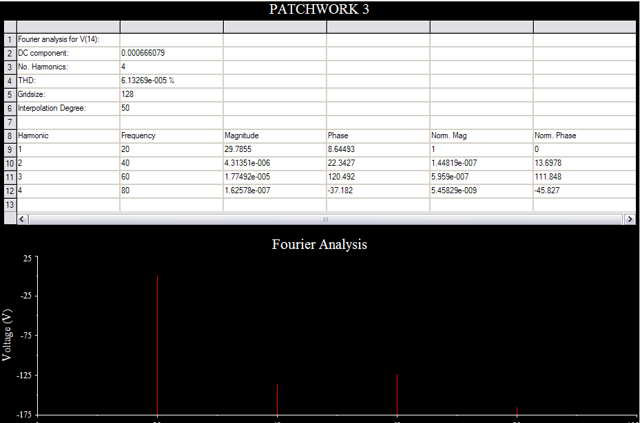

Hi Andy,
I'm baffled. I have re-run the simulations at 20Hz, giving it more time to resolve, but the results are the same. Distortion for the CCS is still nearly as high as the bootstrapped at this frequency.
Is there another mechanism at work here that will increase distortion at low frequency with the CCS version?
Yes, I changed the inductor to 10nH and left the R alone.
andy_c said:
Not that I can think of. My only thought would be to run the transient analysis with a really big stop time, like 100 sec or even longer - as long as you can - to see if the low-frequency transient of the capacitors charging up is fully settled out.
Well, it's not happening. Longer runs equal even lower distortion for the bootstrapped. After 100 seconds, it's less than the CCS.
The figure? :down:

Okay, but we weren't talking about bootstrapped vs. CCS/CCL just a minute ago. The issue was why the 20 Hz distortion of the CCS/CCL version was more than the 200 Hz distortion of the CCS/CCL version. Absent a SPICE quirk with simulation time or similar, I can't see why this should be.
As an aside, it might actually be that the bootstrapping capacitor is so large that the increasing distortion as frequency decreases is not seen until a frequency considerably lower than 20 Hz. That would be a good thing.
So, in short, it would be interesting to see:
1) 20 Hz vs 200 Hz distortion of bootstrapped version (using long simulation times).
2) 20 Hz vs 200 Hz distortion of CCS/CCL version (using long simulation times).
I'm not trying to convince you of anything, and it makes no difference to me whether CCS/CCL is better or worse than bootstrapped. It's just that previous simulations resulted in an apparent contradiction that would be good to resolve.

I'll do this Andy and post the results.
First, I want try a run at a lower frequency to see if this backs what you say about the feedback cap.
Fundimental = 5Hz
stop time - 2000 seconds (a looooong run)
It's showing - a bit. This is 10 times greater than at 20Hz.

Here they are:
These ran for a long time. 500 seconds at 20Hz, 50 at 200Hz.
Lower distortion on both counts for the CCS as opposed to the bootstrap. Surprised that distortion at 20Hz was better than 200Hz for the bootstrap.
I will see if I have time later to run these again, for verification.
andy_c said:
Ahhhhh, it all makes sense now 🙂.
Yes, looking better. I used my cap model in the bootstrap version.
I forgot that the low frequency stuff needs an incredibly long time to get accurate results. Each of these took more than 10 minutes.
Still, look at those figures. It's not as cut and dried as it was made out to be, with low frequency edge going to the CCS, and the high going to the bootstrap.
