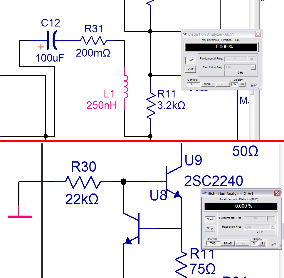

Thoughts on the appropriate values for an equivalent RLC circuit for this? My interest in this is high enough to dig deeper.
Ok, I used an RLC of 100uF, .2ohm and 250nH. At 20Hz it's not showing a difference in the low frequency distortion figure - still .001%
I doubled the L and R, no change. I doubled again - no change.
It was only when I had the L up to 8uH and the R up to 6.4ohm that I saw a 0.0000004% difference.
Something wrong here? Or is this a case of too much importance being attributed to an very minor and insignificant scenario?

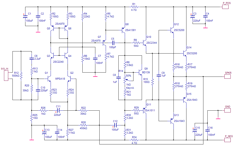

The updated schematic:

Let me take a shot at explaining the bootstrap cap here. First consider that the output is, roughly, a low impedance version of the VAS output, since it is a unity gain emitter follower. It follows the VAS output. Now, consider the circuit with no input, the center of R30 and R31 is at half of the negative supply once cap C12 is fully charged. C12 has half of the negative supply voltage across it since the output is at 0 V. C12 and the combination of R30 and R31 have a long time constant since C12 is large. The voltage on C12 doesn't change much at and above midband audio frequencies due to this long time constant. C12 maintains a relatively constant voltage across R30 due to this long time constant, and because the main out follows the VAS output. Constant voltage on a resistor requires constant current since i(t) = v(t)/R. The larger you make C12 the better it will maintain a constant voltage across R30, and to lower frequencies. This is the frequency dependency that I was talking about.
Also, as the main out goes to the negative rail for full output, C12 boosts the voltage to the VAS, remember it is charged to 1/2 the neg supply and ideally ignoring discharge of the cap you would see about 1.5 times the negative supply on fully output negative peaks at the junction or R30, R31, and C12. I suggest that you probe it and drive the amp to full output.
I did this in real hardware as a young kid when I built a copy of the HK Citation 12 ... that was a long time ago ... lol!
The boostrap in a sense provides a high supply voltage, or one that tracks the signal to the VAS, however this only happens for one side of the signal swing, obviously.

I did the impedance tests on both versions. The version with the CCS frontend faired considerably worse than the bootstrap version, so I fail to see the point of it. The bootstrapped version held distortion below the 0.001% level.
What I meant when I said RLC was for simulation purposes, to take into accurate account what the detrimental effect of the bootstrap cap is. Considering that I increased resistance and inductance to the point where it didn't resemble any capacitor that you would use for this purpose, I think the effect can be discounted.
What is happening here? Why is the simulation giving me these results if they are not close to actuality? Why am I hearing many different reasons why not to use this current source, only to turn around and run the simulation or the actual operating amp which disproves the reasoning?

Everyone has their reasons why they would do things differently. Mine are without prejudice, as I haven't formed any of these beliefs yet. When I change something, it needs to be for better results, not to appease the popular opinion.
The series input resistor has nothing to do with the bootstrapped VAS, more to do with the effect of the LTP cascode. Just something else interesting to look at. Is there a difference with and without the resistor for the same output level?
You say that the LF distortion is inconsequential, and as I understand it you mean to _you_. Andy was simply showing that it is higher than at midband to demonstrate a disadvantage of the bootstrap. If none of these things matter to _you_ then go ahead and use the bootstrap if it makes you happy. I don't think any of us expect to change your mind, we are just pointing out the difference because you asked.

Here they are. I have my home-brew cap model in effect with the added .2ohm resistor and the 250nH inductor. Bottom CCS, top bootintheassstrapped. 🙂
really, what is the problem here? I don't see one.

Let me backtrack a bit. Earlier on, I mentioned that the bootstrap circuit should, for a sufficiently low frequency, show a distortion that increases as the frequency goes down. This again being due to the decreasing loop gain as the capacitor impedance rises, along with decreasing load impedance seen by the VAS.
So you did sims of the bootstrap circuit at 20 and 200 Hz, and indeed the 20 Hz distortion was higher than the 200 Hz distortion. This should not happen with a combination of constant current source for the input stage and constant current load for the VAS though. That's why I was baffled. I may have misunderstood your earlier post on this subject. At any rate, you seem committed to the bootstrap configuration, so I guess it's a moot point anyway.
Regarding SPICE models of electrolytic capacitors, Cornell-Dubilier has an app note about that in this PDF file. Here's what they say:
"Typical series inductance values of radial and screw-terminal capacitors are about 1-2 nH/mm terminal spacing. This value does not vary significantly with temperature or frequency, so this portion of the impedance modeling is simple."
