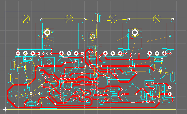

I can mount the semis vertical, three boards per heatsink and and get good contact.
I'm waiting on supplies. I ordered a bunch of blank PC board from a guy on Ebay and I need this to do the boards. Also waiting on the new transistors from Pacific.
This gives me time to work on the board layout, getting it as concise as possible.
The pin out for the 2SA970/2240 is the inconvenient E C B making a mess of things.

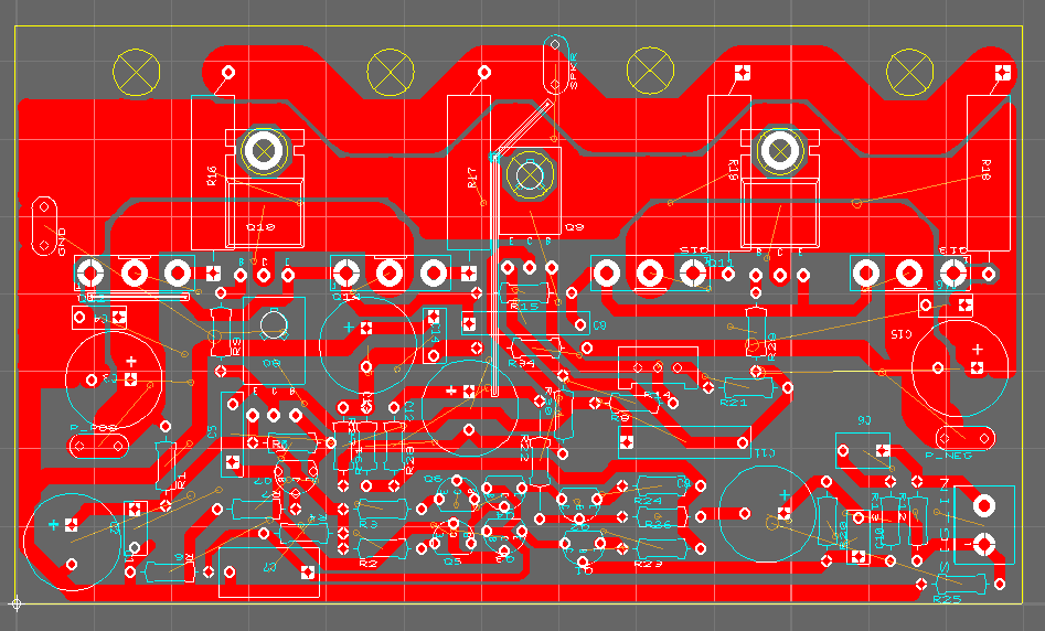

Getting much closer on the board layout. I managed to do it with only 2 jumpers.
Hi MJL21193
I see the pcb is coming along nicely, what software you using??

Thanks. Ultiboard.
My goal was to make the layout as compact as possible and as efficient as possible. Notice how the ballast resistors double back over the outputs, putting the output trace at the outside of the board. As much a star ground as possible, with little intrusion on the front end.

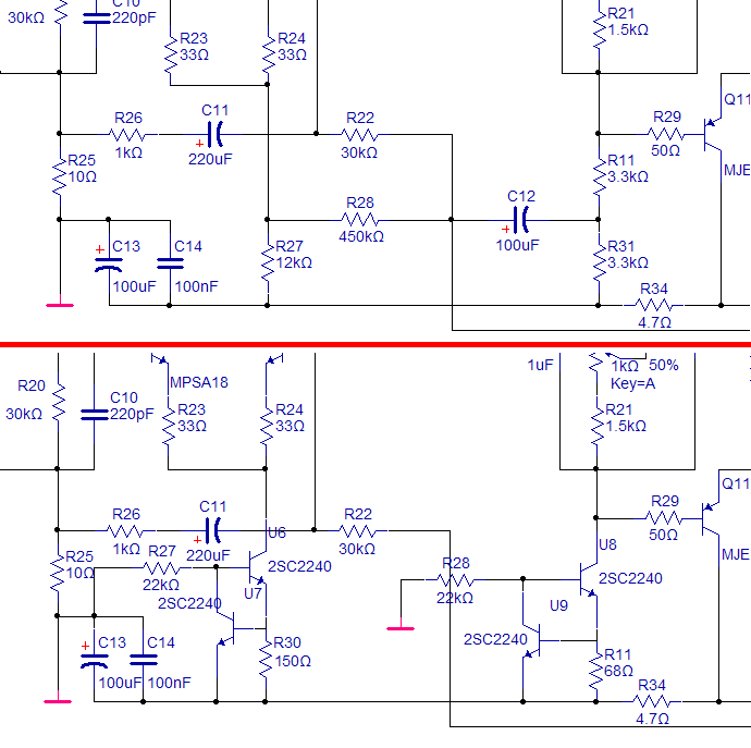

I did some experimentation. I fitted the LTP and VAS with 2 transistor current sources. As shown below, the upper is original and the lower is 4 transistors heavier. The LTP runs at ~4mA and the VAS at ~9mA, nearly identical to the original.
Interesting results, I must run this on LTSpice. Ive never used bootstrapped circuit before, maybe I should make some time to measure one but with a scope. The result could be attributed to spice inaccuracy.

homemodder said:place a resistor between the current source and the LTP emitters. The resistor will isolate the current source capacitance from the LTP and also limit dissipation in it. When done using a low cap high beta tranny you will not hear any difference to a purely resistive source and can have the added benefits of a active source.
but you missed the significance of the series resistors to the CCS collectors. Drop about half the voltage over the resistor.MJL21193 said:I did some experimentation. I fitted the LTP and VAS with 2 transistor current sources. As shown below, the upper is original and the lower is 4 transistors heavier. The LTP runs at ~4mA and the VAS at ~9mA, nearly identical to the original.
Then consider what happens to your carefully set up currents when the mains voltage is 10% low or just as bad 10% high. Active loads are much more tolerant of this variation.

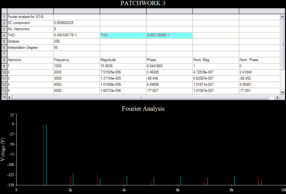

What happens, according to the sim is an increase in distortion - 0.0001% more for a 5V drop and 0.00001% more for a 5V rise.
For 10V up: 0.00006% higher.
For 10V down: 0.0004% higher.
So, running the amp with considerably higher or lower voltage will not have a major impact. Even running a full 20V below speced supply, simulated distortion is still less than 0.001%.

But, I went ahead and ran the distortion at 20Hz for the CCS as opposed to the bootstrap and...no difference. I get the same with both at 20Hz and nearly the same at 200Hz.
The difference, as mentioned before is 0.001% at 20Hz and 0.00002% at 200Hz.

Hmm.
The only reason to putting a resistor between the current source and the LTP emitters is to limit the dissipation in the current source transistor. It will not isolate the LTP emitters from the current source capacitance in any meaningfull way whatsoever.
The same common mode AC signal will exist on the collector of the current source transistor, resistor or no resistor and the same AC currents will flow through the capacitances.
If anything the effects of the b-c capacitance of current source will be greater with the resistor and the c-e voltage is lower, making Cob bigger.
I don't think there is anything wrong with LED biased current source with a single transistor either, especially WRT its "sound".
