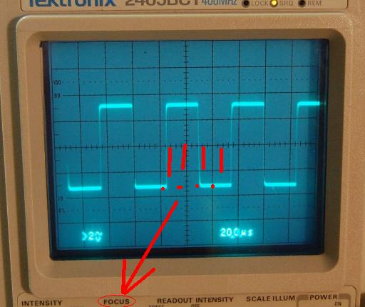

but it looks like sticking to the +ve rail for a period and then it releases and jumps down to the current drive voltage level. That is the time delay until the semi unsaturates?MJL21193 said:I have a clipping "problem" at 20kHz. The sine wave top breaks harshly on the down slope. I don't have a pic of this, but I drew a bit of an illustration below.
Am I right in assuming this is caused by the EF on the VAS going into saturation? If so what is a cure?
Playing with the simulation, if I increase R7 (collector to ground on the EF) from 4.7k to 10k the problem is reduced. What I'd like to know is if this will work in the actual amp and will it have a detrimental effect on the performance.
This shows a little at lower frequency, but is very minor and not as harsh as at 20kHz.

Yes, but when I think sticking I think it stays there and doesn't recover. I had that problem before.
I'm going to jumper on the actual amp from the C of Q7 to the C of Q8 and see how that looks.

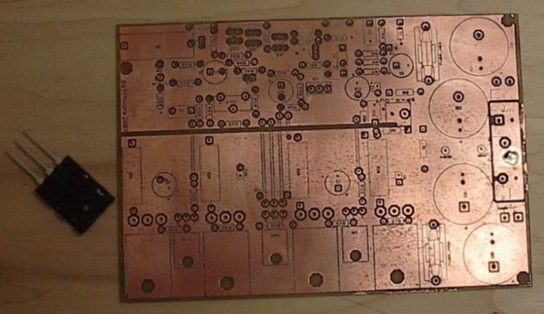

Nice boards John. I especially like the "silk screen". Nice tip from Tom, have to give it a go myself. Haven't seen Tom around here for a while; one of the few who's posts were worth reading.
Anyway, I wonder how well that component overlay transfer would stick to the copper of a double sided board with a top layer ground plane?

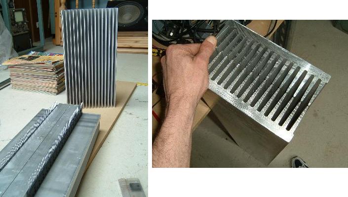

Your heatsink appears to be painted black on the flat side. How do you prepare the aluminium (etch primer?) so that the paint sticks?
I'm comtemplating having a go at painting the heatsink pair for the series pass supply rail regulator of my amp, as they will form the sides of the power supply case. The paint not only has to adhere well, but also be very thin, otherwise it will actually reduce the thermal dissipation of the heatsink.
If it doesn't work out I'll just send them out for black anodising.
Anyway, I'm still waiting for metal work to be done, but I'm afraid I'm going to have to out do you WRT the heatsinks 😀 😀
Pic attached. Series pass regulator heatinks on the left, (to be)fan forced tunnel on the right.
Hi Glen. Yeah, I saw though humongous things before (your 70,000 watt class A?? project 😀 )
I had to sand this flat with a belt sander, then I used a random orbit sander down to 400 grit. It made it about as smooth as I need (these heatsinks are grossly oversized for the purpose). Cleaned with lacquer thinner and sprayed with ordinary flat black paint in a spray bomb. 2 or 3 thin coats, I can't remember, but enough to give an even appearance.
As for the silkscreen, I have done it on my double sided boards before. It works better on thinner copper (say 1oz as opposed to 2oz) as you tend to lose some print in the "valleys".
Early work. The first real working version of this amp from last year.
Hi MJL,
who's toner do you use in the laser printer?
Brother's does not work/transfer/stick and so far I have been unable to source an alternative that fits the Brother HL6050.
Any candidates?

I use an HP Laserjet 3050, with their toner cartridge.

I have been mucking around and tried a UF1003 diode. This has neatly fixed the clipping problem (I'll get a picture when my camera battery charges).
Am I wrong in thinking the UF1003 doesn't look bad here? It has high enough reverse voltage and the junction capacitance is reasonably low (20pF).
