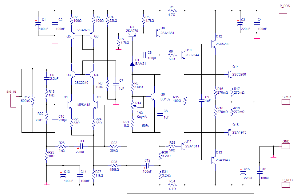

homemodder said:Looking good indeed, can you post schematic with all the chaanges you made so far.
Here it is.

It's not sticking though - it's recovering immediately. The VAS is not saturating, just the EF.
John, I would say that it is "sticking". Note the length of the pos flat top, versus the neg flat top. If you overlay a perfect sinewave on your clipped waveform I'd expect the pos clipping to extend ("stuck") past the point where the sinewave heads back to zero. The front end overloads around that point because the output is not following the input, and when the VAS finally recovers, that high slope edge is where it "catches up" to where it should be. This sticking is also referred to as charge storage, and the feedback loop time constant changes when the VAS saturates which probably explains the ringing as it comes out of clipping. I've looked at this in some detail as I think we discussed in your original thread where I suggested a Baker clamp.
It can help in understanding to take a look around the diff pair and EF to see how the VAS is driven while in overload.
Pete B.
Hi Pete,
I was off in the terminology again. I thought that "sticking" was where it would hit the rail and stay there. My mistake.
In the simulation, it looks as though the EF is saturating. The VAS looks normal. I didn't look at the differential pair to see what is going on there - I just assumed that it was functioning normally. Do you think that there is some way to minimize this clipping behavior, before the Baker clamp?
In the original thread, I couldn't get the Baker clamp to work in the simulation, remember? I managed to get it working in this simulation by trying different diodes (models). I'm baffled by this. Andy's model for the BAV21 will not work properly in my sim, neither will the Multisim version. I've had luck with the MUR115.
Long and short is that the clamp works fine in the actual amp. It doesn't effect the stability and doesn't seem to have an adverse effect on sound quality. In the simulation, distortion increases slightly, but I have room to spare in this regard.
Don't know what is causing the simulation issue. You might just look at the model differences for the one that works as compared to the ones that don't.
The Baker clamp is a good solution, especially with the diode that Andy suggestsed.
Pete B.

MJL21193 said:Do you think that there is some way to minimize this clipping behavior, before the Baker clamp?
In the simulation I probed the base of the EF. When at near full unclipped output, I have ~450uA. With mild clipping nearly 2mA.
By increasing the emitter degeneration resistors in the diff pair I can minimize this current jump. I took the value from 33R to 200R.
Am I on the right track here?

Hi John,
The emitter resistor change will make the GBW lower by a factor close to 33/200 and will increase the distortion by roughly 200/33., so it's not the right thing to do.
This also raises the question of why there is a collector resistor in the EF. Was that for power dissipation reasons? With no collector resistor, it can't saturate. Saturation for a PNP happens when the collector voltage is higher than the base. That's how the Baker clamp fixes the problem for the VAS CE stage. It clamps the collector voltage so that in the worst case, the collector is at a voltage the same as the base. When the collector-base junction becomes forward biased (P positive with respect to N), that's what causes the big increase in base current. Think of it as an internal diode between collector and base, with the cathode connected to the base and anode to collector. When this diode becomes forward biased, a big increase in base current occurs.

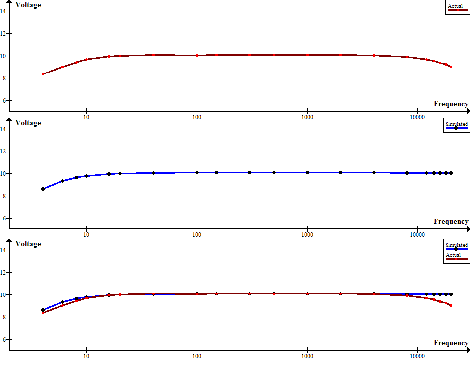

Getting back to the bootstrap topic: I did an interesting test this morning. I needed to put a face on the supposed limitations of this topology. Possibly, all of this has been done before, with much more methodical and exhaustive testing done.
I thought I would measure the voltage at the junction between the top bootstrap resistor, the base stopper to the Q11 driver and the Vbe multiplier. I thought I could just measure the AC voltage here and sweep the frequency up from low to high, taking note of the values. I set the output of my function generator to a sine wave at 20Hz and adjusted the amplitude to give me 10VAC at that junction. I called this my baseline.
From here I dropped to 18Hz and took note of the voltage. Then to 16Hz and so on down to 4Hz, taking measurements as I went.
I then swept upwards to 20kHz, taking measurements all along the way.
To my way of thinking, this effectively maps the linearity of the bootstrap over the swept frequency range.
I then did the exact same test with the simulation of this amp, using my RLC mockup in place of the bootstrap cap.
The results are below. Top is the charted voltage at frequency of the top bootstrap resistor.
The middle is the same in the simulation and the bottom is one over the other for comparison.
Thoughts?

Let me just point out that you seem to be looking for a solution to the current jump as if it is a problem. It would probably help to step back and think about this - you have a high gain amp where the gain is used to correct for distortion/errors in the output - if the output ever cannot track the input with low distortion then the high gain amp attepts to produce a large correction voltage/current. The output cannot follow the input in clipping, slewing, and when it is shorted and therefore the front end tries to produce a large (overload) correction.
I believe that it is an oversight not to include R7 as from what I saw the EF and VAS can fail without a protection transistor. I would probably leave in R7 even with an EF/VAS protection transistor. Its important to also look at what the amp does with a shorted output as we discussed in the original thread.
You ask about the LTP degeneration resistors - you're lowering the gain when you increase their value and making the front end more linear in overload. However, as Andy pointed out lowering the gain increases distortion. Its a tradeoff.
If the amp has high enough slew rate, current limiting during clipping and for a shorted output, and recovers cleanly from overload then it seems that there is no reason to increase the LTP emitter degeneration resistors beyond the value that provides the lowest distortion. They do also make the design less sensitive to diff pair mismatch which is not an issue if you match devices.
It is looking good John, like a JE-990 converted to a power amp, with some nice improvements. Cascoded LTP, jcx's trick of bootstraping the LTP, and R7 to improve overload handling/recovery. I remember that you removed the bootstrap to the cascode reference based on simulation results, but I have to wonder if this agrees with real hardware - a minor point.
Pete B.
I don't think I can take credit for bootstrapped tail current souces, they predate my birth date
If I were modding what I see in the last schematic I would go for more current gain by using cfp driver stage and high enough bias that it would always be in solid Class A
this should increase gain by presenting higher impedance VAS load, the VAS bootstrap would give a higher Z if the C were moved to the lower driver emitter
the tail bootstrap R ratio needs to be readjusted to give the new higher current and have the correct divider ratio == feedback divider ratio
and while not "simple" I would play with TMC or 2-pole compensation to put more of the (increased) loop gain in the global loop at audio frequencies where it improves both input and output stage distortions
Hi Pete,
R7 stays. Clipping performance is not improved by it's removal. I like how it limits the current through the EF, and by extension, the VAS.
Thanks. Everytime I do a new or improve amp project I pick up a few more things. Still, a long way off in my understanding and it shows I expect.
What drive me onward are tangible results - I need that working unit in front of me. I also, if I don't mind saying so, have a talent (it must be talent, as I don't actually know enough) for sniffing out the cause of problems.
For example: It turns out that this latest board, with all of the tests that were done, had a blown ballast resistor. R17 on Q14 was open. I discovered this when I tried to set up the idle current. The voltage across this one read 408mV, while the one next to it had 15mV. It didn't occur to me that the emitter resistor could be open, and I was getting ready to pull the output, thinking it was faulty. What made me measure the resistance of the resistor? I don't know.
I have more faith in the simulator now than I did before, especially where the distortion measurements are concerned. The feed-forward to the cascode would always increase distortion, no matter how I configured it. This was even more apparent when I learned how to use the Fourier analysis, giving much higher resolution.
In contrast, the bootstrap to the LTP would lower distortion. It was just a matter of hitting on the correct value for the resistor.
Now, the amounts involved are relatively small, but it's all cumulative and it makes up for the small amount of distortion introduced by the Baker clamp (this may or may not be accurate, given my troubles with diodes in this simulator).
Now you tell me! I guess this is something that i should have known.
It makes sense - even though I have selected fast outputs, there would still be a lag between driver and output.
I will see about implementing this.

Let me understand what it is you are saying: The drivers themselves, not the outputs, in class A operation?? I like it!
BUT,
Lets save some of those for the sequel! There's V4 to think of...
If you have trouble with sticking on the bootstrap side you can add a diode to clamp the voltage so it can only go outside the rail by 1 diode drop. Then you put one diode in series with the feed from bootstrap circuit to VAS so that the voltage on the driver base/bias spreader is clamped at rail voltage. This prevents saturation in the driver transistor.
