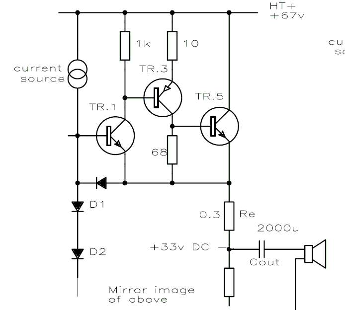

The hybrid CFP driver of the Quad triple looks interesting - only two B-E junctions to temperature compensate.
I doubdt the HF crossover distortion performance is ideal though.
I'm currently experimenting with this as the series pass element in my 100A peak power supply.

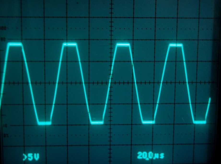

Looking at clipping performance and I see that this clamp did not completely cure the slight sticking in the bottom half. Decreased yes, but not eliminated.
Clipping is very symmetrical - top and bottom start to clip at the same time.
MJL21193 said:
I'll answer my own question: Vbe multiplier was thrown off by this clamp arrangement. It was drawing current too over bias the outputs. I adjusted the Vbe pot and brought it back down to normal.
I'm going to bring the voltage up to +/-30V...
...It won't go there. The Vbe resistor values will need to be changed as I can't adjust the pot low enough.
Hi John. One of the most obvious and greatest drawbacks of the bootstrapped VAS (which I did not think of ‘till now) is the fact that the quiescent VAS current is proportional to the supply voltage.
The problem here is that the VBE multiplier has a small dynamic resistance, so the reasonably critical biasing voltage for the output stage will vary along with the rail voltage.
If you set the output stage quiescent current with a reduced rail voltage (say +/-15V) you’ll find that it will increase when you crank the variac up for the full rail voltage.

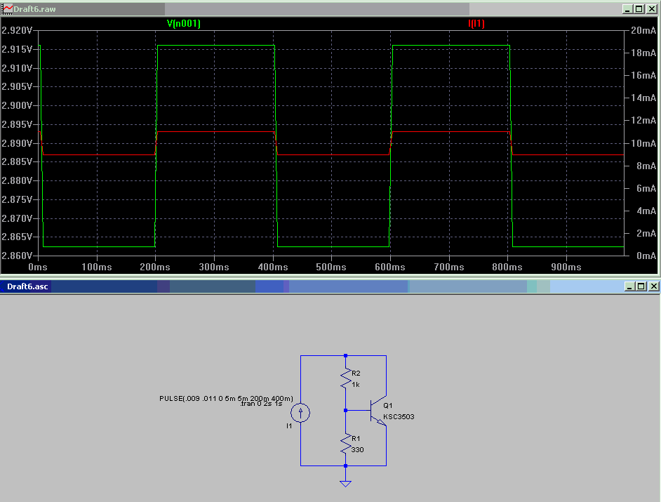

Here is a quick simulation to demonstrate the problem.
A Vbe multiplier is made and the 10mA standing current is modulated +/-10%.
This results in a voltage variation of ~50mVpp.
With 0.27ohm emitter balast resistors this would result in a output stage bias variation of nearly 100mA.
Glen

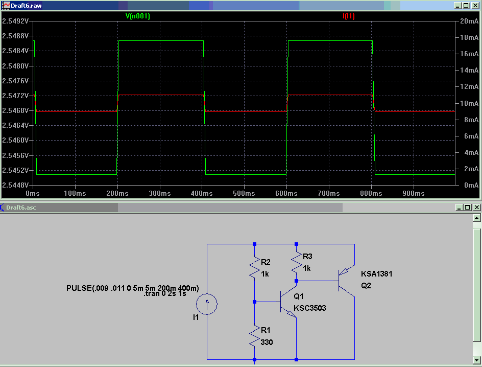

G.Kleinschmidt said:Here is one possible solution to the VBE multiplier bias problem.
A VBE multiplier is made with a NPN-PNP compound pair.
Under the same testing conditions (10mA+/-10%) the pp bias voltage variation is reduced from ~50mV to 4mV.
This is fine Glen, but is it necessary? With my proper permanent supply, I was experiencing rock steady idle current.

more changes...
Thing 2: I moved the bootstrap caps feed from the output to the emitter of the lower driver. In the simulation, this brings on a massive drop in distortion.
In the actual amp, there is little to observe. I have the same rock solid stability as before, clipping behavior is unchanged. All systems are go for -
Thing 3: Increase the emitter resistors on the diff pair and drop the Miller cap value. Using Andy's formula (thanks again 🙂 ), I considered how far I should go. I thought I'd consider the capacitance of the clamp diode I'm using (20pF) and therefore I used 2 - 15pF's in parallel. I replaced R23 and 24 with 75ohm.
With my 30V lab supply stability is still good, though there is some overshoot on the leading edge of the squarewave. Clipping looks fine at 20kHz.
I screwed it back onto the heatsink and tried it at full power. It looks really good. The overshoot on the squarewave is gone and clipping still looks good. Clipping at full rail voltage was before and still isn't as clean as at the lower supply voltage. There is a tiny touch of that sticking that shows in the bottom wave in the top too, but it's well into clipping when it happens and it doesn't show signs of instability.
So, all three changes executed successfully. I will work up a revised schematic with these changes.
