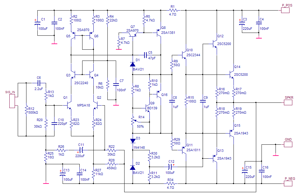

Schematic update:
Q16 (not Q9) takes the higher current and should dissipate more power. Q9 passes just 0.6mA (600mV/1k0) and will dissipate just 1mW to 2mW.
AndrewT said:Q16 (not Q9) takes the higher current and should dissipate more power. Q9 passes just 0.6mA (600mV/1k0) and will dissipate just 1mW to 2mW.
Thanks Andrew,
Q9 mounts to the heatsink for thermal tracking. I will use an MPSA56 for Q16.

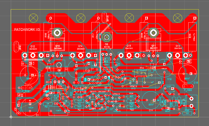

I'm working to fit everything into the last board layout. This is just a bit easier than creating a brand new layout. 3 new diodes and an extra transistor doesn't sound like a big deal until you need to fit them into an already tight layout.
I haven't tried the 2 transistor bias yet. I didn't feel confident doing it on the working amp - just too many things would need to be changed that could effect the stability, thereby ruining my assessment of the change. I think it's better that I go ahead and make a new board that includes all of the proven changes (feed for bootstrap moved, clamps) and has the second transistor for the bias generator. If it proves to be unusable, I'll simply remove it from the board and change the values of R10.
I need to order the BAV21's from B&D, but I got to thinking: Available only in surface mount at Digikey - am I ready for SMT? I like the idea - not as many holes to drill, even tighter board layout, better availability of (many) parts, cheaper(?).
I'm starting to sway...🙂

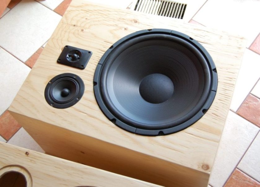

The speaker it's driving is my older transmission line 2-way with a Vifa PL18 midwoofer and Scanspeak D2905/9500 tweeter. A good speaker and not really a difficult load.
This combo is easily keeping pace with the unit pictured below that I'm using for the left channel - an active 3-way with each driver running off its own LM3886. I built a pair of these for my workshop (yeah, overkill 😀 ).

And done. I managed to squeeze it all in and it doesn't look bad. I just need to check it over to make sure I haven't made any mistakes.
My new blank PB boards came, so I'll be able to make this one today. Hopefully all goes well.
megajocke said:Looks nice 🙂

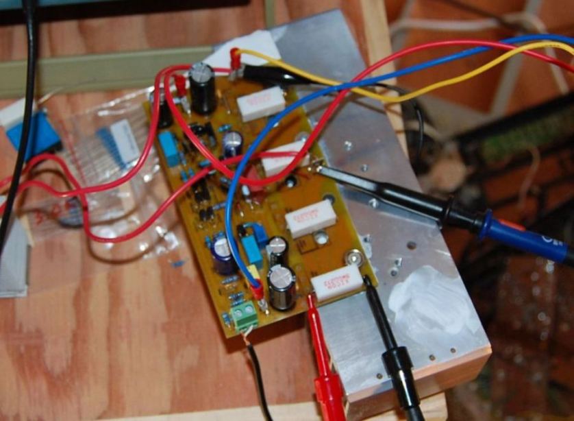

I'm populating the new board now. These new boards are a bit different - the unclad side feels a bit waxy. My silkscreen didn't stick as well. Next time I'll sand it a bit to give it a better grip.
A bit of a pain that I don't have all of the components I need. BAV21 and 47pF silver mica plus I have just ran out of 3.2k resistors.
I'll be giving this one a try later. To be honest, I'm not expecting any surprises.
All went well - it's running stable. I have the 100pF Miller cap in place and I'm using the higher pF clamp diodes, so I'll get a better picture on final stability when I get the new parts.
I had to decrease R8 in the Vbe multiplier from 1k down to 470R in order to adjust the idle current. Also, it's very touchy - lucky I have a multiturn pot or it would be very difficult to get the bias dead-on.
I haven't ran it on full supply voltage yet.
The isolation pad right now is a sheet of printer paper smeared with compound. I don't have enough mica left either. I bought a few sheets of thin Kapton film that I was going to cut up and use for pads but I can't punch clean holes through the stuff. 2 pairs of hole punches, one new, both too dull to cut.

I'm not feeling the love for this new Vbe arrangement. It drifts like crazy and I can't seem to do anything to fix it.
Starting off cold, I adjust for ~15mV (55mA) across each of the output emitter resistors. Sitting at idle, it drifts up 3-4mV as the sink warms up. Cut that back to 15mV and give it some signal. It's pulling .5A into the 8ohm dummy load for 20-30 minutes. The load is quite warm and the heatsink is warm also. Cut the signal and measure the idle current again. It's now standing at ~80mV (296mA)!
Now maybe I did something wrong? Were there considerations to take into account for the second transistor? Gain?
In the meantime, the previous board is still operating and playing music. It's been this way for three days. I check the idle current on this one and it's still steady at 55mA.
I think I will abandon this and go back to the single device Vbe, adding the small value collector resistor.

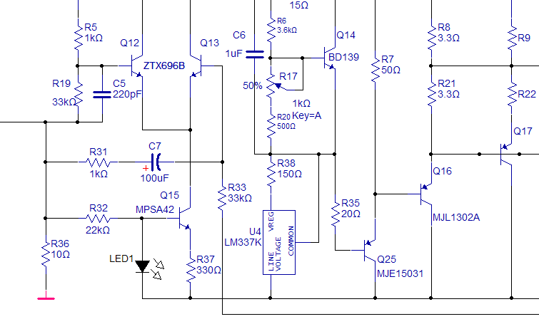

Playing around with another design, I tried something different. I used an LM337 as the current source for the VAS and it seems to perform very well. The sim says it does a better job of restricting output stage current fluctuations when the supply voltage drops or increases.
Will this work properly in this configuration? Or have I got it wrong here.
