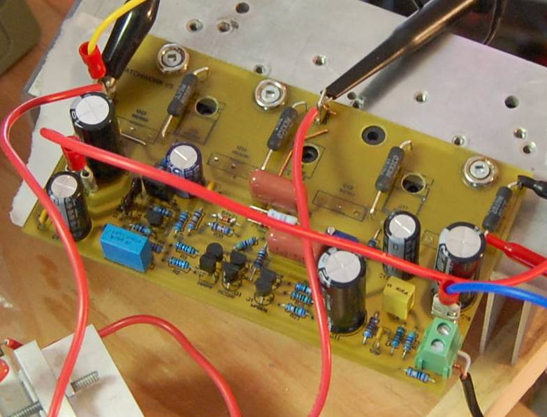

Working at +/-30V. No signs of instability. Idle current is tracking perfectly.
Amoung the new parts from DK I have new multiturn 1K pots. The ones I have been using are from Sure Electronics on Ebay. They look like Bourns 3296W, but they are "bourts"3296W. They haven't given me trouble, but trouble I don't need so I have new Cermet ones. Also the new 47pF silver mica for the Miller cap.
Stability into the dummy load looks good, clipping looks good. Still have the slight sticking on the bottom wave, but I'm not sure that can be cured anyway.
Squares at 20k look sharp with no overshoot and no ringing. Still testing without a Zobel.

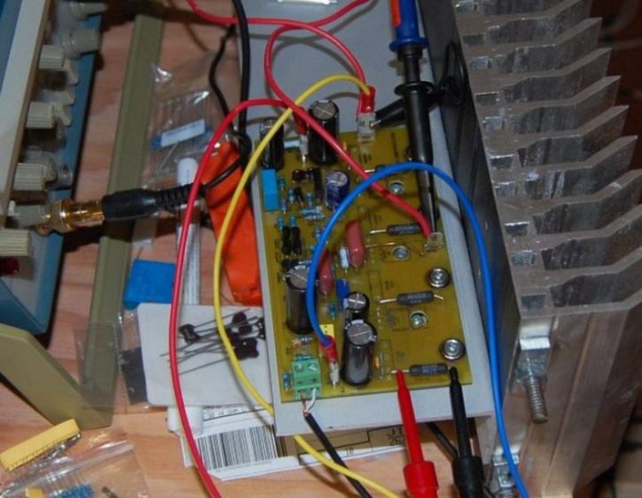

I went ahead and prepped the big heatsink for mounting of this board so that I could do some full power tests.
I set the idle (which was only 17mA difference from the 30V supply) to 55mA per device and left it with a signal to warm up.
Good and warm the idle current is reset and I let it sit again for a while. After about 20 minutes of the outputs drawing 250mA, I check the idle again. It's rock solid. No more issues there.
It's warmed up, I'll do some tests. Stability is still fantastic - no sign of any ringing in spite of the open arrangement and the heatsink not being grounded.
Clipping.
Sine wave clipping at 20k is sticking again on the top. Below that, at 10k and lower it's fine.
Square waves look good and sharp at 20k, but have a small overshoot on the bottom.
So what has changed? For one, the diodes are different - I had been using the UF1003. Also the Miller cap had been reduced to 47pF, with little influence from the clamping diodes capacitance.
Could I have damaged the clamping diodes with my soldering job? I pretty much just dabbed it with my iron, very quickly. I don't know how much heat these can take though.

I have bypassed D1 with a UF1003 and clipping is back to (nearly) normal. I think that maybe reducing the miller cap to 47pF is compromising clipping performance. I saw the same behavior before when I reduced it.
I will try it with the Miller cap doubled up to 100pF again, leaving the BAV103 in place.
Yes, that's it. Cdom needs to be 100pF to get that good clipping performance. The overshoot on the lower half of the 20k square wave is gone also.
This means that my soldering job on the BAV103's did not damage them.
I'm wondering what the effect would be if I were to increase the emitter resistors in the differential pair, leaving the Miller cap at 100pf? Even better clipping recovery? What does that do to my slew rate? It must be high enough anyway, there's almost no discernible slope in the vertical of the 20k square wave.
I'm not going to bother with pics of the clipping or squarewave, as they are no different from before.
Measured DC offset with the input plugged into my FG, turned on but the amplitude set to "0" is ~10mV. Maybe a lower figure could be had if the diff pair transistors were matched (I didn't do).
All in all very good. Some real life distortion tests will come soon, be those only with the RMAA. This gives a very accurate indication of what's going on anyway.
