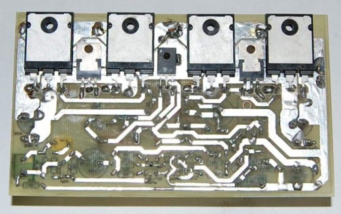

I have the other 5 boards done. Etched, silkscreened, tinned and ready for parts.
Looking like an amp factory. Wow is this repetitive. The tedious part is measuring each of the resistors. Some are good reliable Yageo but the others are the cheapies from Sure on Ebay.

Hello, John. Could you share how did u make the boards ? They seem like factory-made, I can do the tracks that good as well with the laser toner transfer method, but how in the world did you do the perfect tin coating? :bigeyes:
Here's how I do it for single sided boards:
1 - Print the design and iron on. I have been leaving the iron on the paper for longer, just letting it sit there for 5 minutes at a time then move it around rubbing. I find this takes less effort and the pattern transfers are crisper.
2 - Etch with 2 parts peroxide, 1 part muriatic acid. When finished I rinse with warm water and use wet/dry fine sandpaper to remove most of the toner. I then clean the rest of the toner with lacquer thinner.
3 - Print and iron on the silkscreen. After the paper has been cleaned off I dry it thoroughly and spray a coat of lacquer to protect the silkscreen and to make it more visible. You could use clear urethane also, water based or solvent. I happen to have the lacquer and it dries very fast.
4 - Tinning. Go to the hardware store and visit the plumbing section. Buy a roll of lead-free plumbing solder and some plumbing paste flux. Also, a cheap 25 or 40 watt soldering iron. Coat the copper side of the board with the flux, using your finger to spread it thin. Take the tip off of the soldering iron (if it's small. If it has a big tip, keep it on there) and let it heat up. I have ground a flat part on the end on mine that I've tinned.
Melt the solder onto the iron and use that like a paint brush to tin the traces. Be careful not to heat up the traces too much or they might separate from the board. You can use your regular iron for the small traces. Continue until all of the board is tinned. Wipe the board off with a paper towel to get rid of the excess paste flux and clean with steel wool. It's ready for drilling.
5 - Drilling is done after the tinning, even if you have printed the trace pattern with the drill holes open, they will not cover with solder during the tinning as easily as if they were drilled. This is not obvious and I found it out through experimentation.
You end up with a nice looking board that is lead-free and will not oxidize like bare copper will. It has the added benefit of beefing up the trace thickness, for improved current flow.

Hi John,
just something you could try in the future for tinning that also gives excellent results is to smear a thin layer of solder paste and stick the board in the oven for a short while. The result is very pleasing and absolutely flat surface.
Nico
Hi Nico,
I did this the first time with a propane torch :hot: and the solder flowed out very flat. It's very convenient with the iron though and it takes a minute or so to do a really smooth job.
