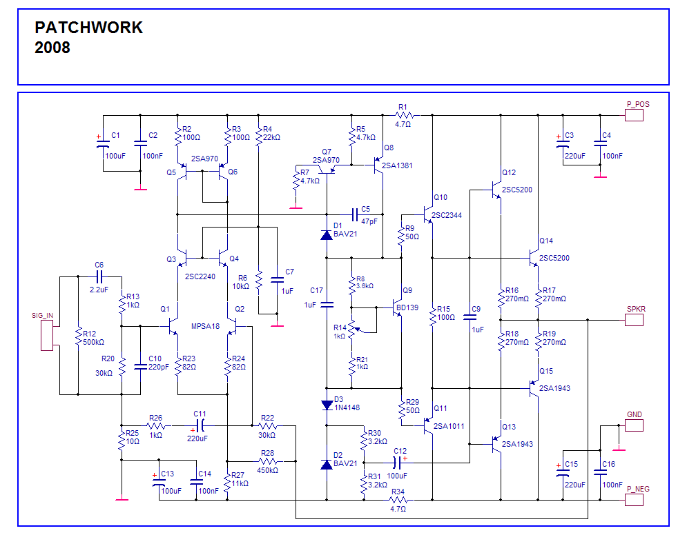

is the correct transistor coupled to the heatsink?MJL21193 said:I'm not feeling the love for this new Vbe arrangement. It drifts like crazy and I can't seem to do anything to fix it.
Or
should both transistors be thermally coupled?
I hate your 337 solution for VAS CCS.
A red LED + 120V transistor + resistor is a tried and tested method that works, or use the existing red LED to save on components.

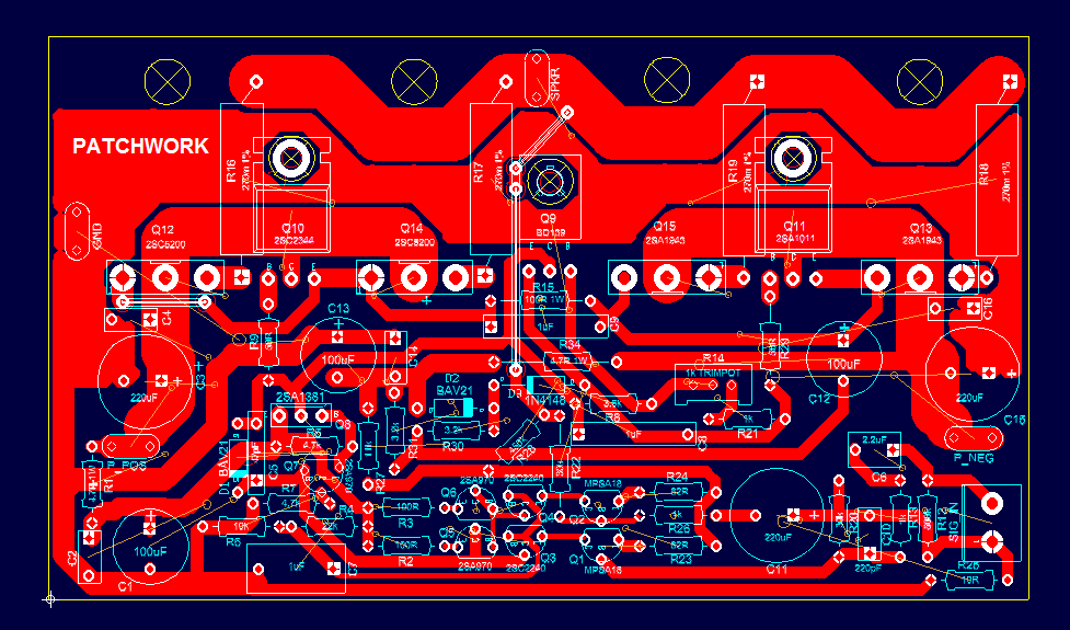

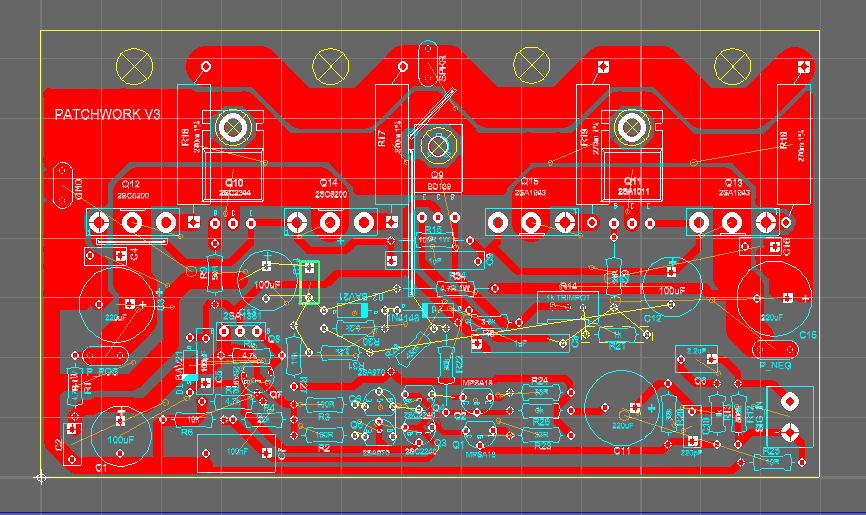

I'm working on the board layout AGAIN(!!!!!!). This time for the last time as far as this amp is concerned (what? never say never?).
I need to be getting six of these made, plus the chassis to put these into service. I think that we have pushed the design to a new high and it betters the original by a wide margin.
Was the adjustment pot a new one or did you remove it from another piece of gear?
Also, it's a good idea to put a resistor in series with the pot to limit the adjustment range of the bias circuit. This will allow finer adjustment.
New pot (fresh crop 😀 ).
It's ok, I'm not going to try to make that Vbe multiplier work as the one I had in the first place does a great job.

MJL21193 said:
Sometimes you need to improvise. 🙂
There is something funny going on here. Are you using one of those recycled TO-92's for the PNP trannie?
I'd try replacing both the NPN and the PNP before giving up.

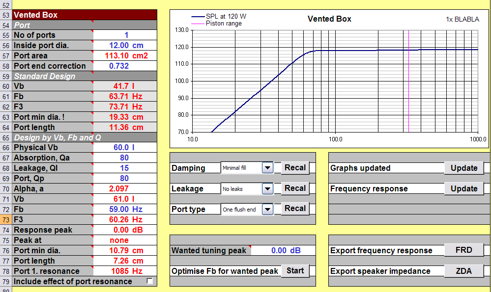

BTW (OT), since you are the resident Unibox expert, what bass reflex results do you get for the 5320 driver here:
http://www.phlaudio.com/datasheets/38_pdf/5320_5370.pdf
PHL says use Vb=65L and tune to 46Hz. I tried, but I keep getting BS figures for the port length.

re the two-transistor VBE, I remember reading a few things about this, and t is the FIRST transistor that should be thermally coupled, not the second. I don't think it's worth pursuing these days though... a single TO-126 device mounted to the heatsink works well.
No recycled parts, but my spider sense was tingling about something funny going on, anyway...
Too late. I've given up on that and have been working on the board layout with the old (reliable) Vbe.
Expert, eh?
That driver CAN be in a 65L box tuned to 46Hz with a port dia. 10.4cm x len. 15.6cm but it will give better response in a 60L tuned to 59Hz.
What are you planning for that one?

Still working on the layout. I had a lot done, forgetting to save (in a trance) and lost all of the work when the program "encountered a problem" and shut down. Nice.

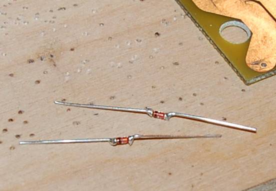

Ive been researching some suitible diodes for use as clamps and found a excellent range of japanese diodes, is there any real advantage that can be measured or heard with a faster recovery part. What relevance is it of say using a 100 or 150 ns part. The very low capacitance is of great importance but speed??? There are some japanese parts that have 1.5 pF, 1amp and 200v reverse capability.

homemodder said:AndyC
Looking at the Fairchild BAV21 data sheet, the reverse recovery time is 50 ns max, and typical capacitance varies from 1.15 pF at 0V to 0.9 pF at 15 V reverse voltage. I'm not sure about the availability of these outside the U.S. though.
Reverse recovery time specifies how fast the device can be turned off after it's turned on. So having a faster reverse recovery time would, all other things being equal, result in faster recovery from clipping. But there's all sorts of other things that affect clipping recovery, such as the dynamic nonlinear behavior of the feedback loop, which may dominate. Also not all reverse recovery times are created equal. They spec a forward current at turn-on, then a peak reverse current (due to stored charge) during the turn-off portion, then a final reverse current which is typically 1/10 of the peak reverse current. So for the same diode, many reverse recovery times could be defined depending on the current values chosen. A 1A forward current spec is overkill, and probably implies a device that's slower than a lower current device (because of larger junction area).
If the amp does not clip, the reverse recovery time trr of the diode is not relevant. What trr really boils down to is the capacitive portion of the diode impedance in the forward biased state.

I want to order some different drivers from Digikey (2SA1837 / 2SC4793) to use instead of the 2SA1011/2344 mainly because of the insulated package. That's that, but I want to get the clamping diodes there too. Unfortunately, they only have surface mount, but I thought I'd solder a couple leads on and use it through hole.
Anyway, while searching I found the BAV103. This is a slightly bigger package so it would be a bit easier to Jerry up.
These are very similar, no?
Those look good too, but why not solder them on surface mount? I believe it will be much harder to try to solder on legs as they'll fall off when you heat it. Soldering "big" surface mount parts isn't that hard. 🙂
megajocke said:Those look good too, but why not solder them on surface mount? I believe it will be much harder to try to solder on legs as they'll fall off when you heat it. Soldering "big" surface mount parts isn't that hard. 🙂

I think I can manage to get it soldered and besides, I went through 6 board revisions for this amp and I can't do another. I should have laid out these for surface mount in the first place. No problem on D2, but D1 has a wide power trace running through it.
I'm seriously thinking of going more that way for future projects. I can make a pretty good board with very fine traces so that wouldn't be an obstacle.
I've put through the order to Digikey - should be here tomorrow.
