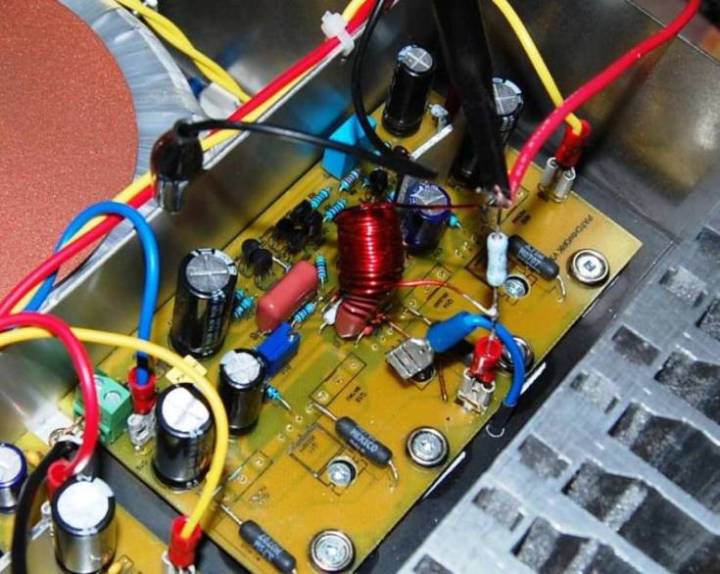

I would like to know why I'm getting worse square wave performance with the Zobel connected. I'm seeing overshoot at 1k double in magnitude to what it is without the Zobel.
I removed the Zobel and just used an L//R with an open air coil - about 12 turns around a 10mm cap as the form. This has cut the overshoot down.

I have made some changes that seem to improve a few things. I replaced the clamp diodes (equivalent to BAV21) with the UL1003's that I have. Clipping performance is much cleaner. I'm not sure why that is, but who am I to argue. I did this on the board that still has the 47pF Miller cap and HF stability looks better (there was some ringing when driven close to clipping before).
I have been experimenting with different size inductors to find the best fit. I want to eliminate the overshoot without overdoing it. So far I have found that 9 turns on a 12mm form is too little and 15 turns on the same form is too much. The original 12 turns on a 10mm form is the best fit so far.
All of this means that I will need to undo the Zobels at the binding posts. What a pain.
Ok. Zobel is out. I know that many say that the Zobel should be there regardless and that it shouldn't have an impact. Every other amp I've built has needed a Zobel or it would oscillate or ring. Not this one, so I'm going to go with that and just use the L//R to damp the slight overshoot.
I have arived at the best-fit inductor. This paralelled with the 4.7ohm resistor is giving me the results I was looking for. Overshoot is controlled, clipping performance is good and the amp easily handles a capacitive load (I've tested up to 1uF). Amp is stable and the idle current is steady.
A couple of hours down the drain to install the Zobels on the binding posts, plus the time to remove them. All in the name of progress though.
I need to pull the other boards out and make the changes I did on this one. I'll also need to make 5 more inductors and I think I'll mount these, along with the resistors, on small boards next to the binding posts.
Here's a look at the inductor. 20 gauge wire, 14 turns on a 10mm form.

AndrewT said:
Where was the R//L mounted? Before or after the Zobel?
Hi Andrew,
There wasn't an L//R at first. I thought I would try just the Zobel.
When the Zobel didn't perform as expected (I should have known, this was apparent before) I tried the inductor/resistor before and after the Zobel, I tried to reduce the C on the Zobel, I tried to increase the C also. The same result - overshoot was more pronounced. The inductor would damp it back a bit but I didn't see the reason to do something undesirable (overshoot from Zobel), only to try to counteract it with another mechanism (inductor).
I know that a better approach is to find the source of the overshoot and correct it, and to determine why the Zobel inflames this situation, but the solution I'm using seems to be adequate. The amp runs stable, the inductor kills the overshoot and doesn't complicate things.
Do you have any ideas about why the overshoot would increase with the Zobel?

That should not happen. Where are you connecting the CRO probe ground clip?
Excessive squarewave overshoot generally means too little phase margin. First thing to do is to pull the 47pF and try a ~82pF miller comp cap.

Hi John,
I may be talking out of turn again, but overshoot and undershoot I have traced to the combination of miller cap and NFB cap.
These must be tuned until the overshoot and undershoot smooths out and you find the typical 1 st order response (slightly rounded).
We had a similar problem on our first few prototypes.
We have successfully dampen the effect by putting a low value resistor in series with the miller cap, whether this is common practice I do not know but it worked for us.
Kind regards
Nico

The ground clip for these tests was on the wire out from the binding post to the dummy load. I observed the same behavior while testing the amps in their "raw" state, with the probe gnd clip on the main board ground or at the load.
I was operating with 100pF for Cdom and still had this overshoot. Do you think 2-pole compensation would help?
I'm going to test the amp with an inductive load to see how it reacts. If it maintains stability, I think I can safely forget about the Zobel.

I tried every conceivable combination and location for the Zobel. Before the output inductor, after it. Close to the board, back at the binding posts. Changed cap values, all to no avail.
Like i mentioned above, I will do a test with an inductive load and see how the amp holds up. It it goes crazy (it didn't when driving a real 2-way speaker with a fairly complex passive crossover) I'll go back to the drawing board and try to track down the cure. It wasn't a problem in the original Patchwork, maybe due to the slower devices used.

I'll be doing further investigation but in the meantime the output inductor has effectively killed the overshoot. I'm seeing excellent stability driving a capacitive load with an almost perfect squarewave before the inductor while driving the 8ohm dummy and a 1uF cap.
I have just tried an inductive load with a ~.5mH coil in series with the dummy load and I saw no signs of instability. 10kHz squarewave was nearly sawtoothed and here's a look at the 1k squarewave:
Here is the coil:
Probe was connected after the inductor (at the dummy load) on the above pic. This pretty much settles it. I don't need a Zobel here
