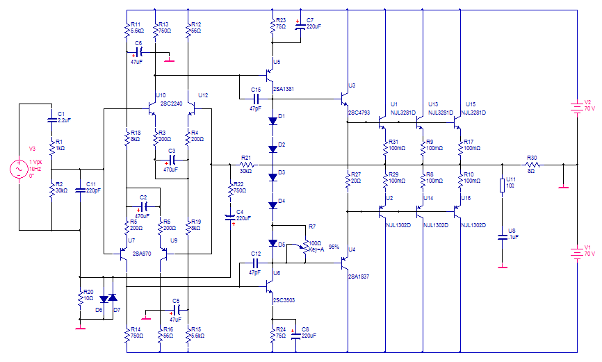

I have a tentative scheme for the thermal tracks. Still need to iron out a few details.
Looks like you'll have way too much bias voltage like that, if you change to triple-EF output you could probably use the same vbe multiplier circuit as in the leach amp (4 diodes). The 2 diodes that are left could be used for something fun, like overtemperature protection if one wants 😛. That circuit you have now with CFP drivers could maybe work with two diodes and a whole vbe multiplier in series with them or three diodes with a pot in series, maybe a 1n4148 across the pot could be useful...
A good thing with the CFP is that driver temperature won't disturb the bias almost anything at all. I'm planning to try CFP predriver/driver with these for that reason.
But didn't you have problems earlier in the big amp with CFP predriver-driver? I belive you can probably get it working if you use base resistors on outputs, but I probably wouldn't try without at least some means to add them easily.
Those VAS devices look nice, I'll save the part number - those look very useful as VAS/predrivers 🙂
Hi Mega,
Yes, don't pay attention to the 6 diodes - I have some difficulty with Multisim to get an accurate voltage drop across diodes.
I took the time to measure the actual drop on these diodes at my VAS current (8mA) and it is .56V at 25*C.
I think that I can use 4 on their own to give ~2.24V bias. This will put my idle current in the 120-130mA range.
I like your idea of using the other 2 as part of an overheat protection circuit. Or perhaps just to activate a cooling fan.
I had problems with the CFP arrangement before but I think that was due to the physical size of the output stage and my choice of devices. I used it on my very first DIY amp project (Rod Elliot's P68) and didn't have any stability issues.
I'm willing to take another crack at it. Maybe we could collaborate, since we both are shooting for about the same thing. 😱
I could mail you a couple of the 2SA1381's to play with if you like. Least I could do for the help you've given me. Let me know.

I think that adding a pot across one of the bias diodes will give me enough adjustment leeway.
Putting the idle current per device in the 100-200mA range will give the best (simulated) results.
I have been playing around and discovered a couple of different things, one of which can be applied to the Patchwork amp. First, the "bootstrap" resistor on the frontend appears to be too high at 450K. I'm seeing much better results with a lower value. Second, the CFP drivers seem to be more stable when the first device is high speed. This plays out with a few different models in this location, but I can't count that as conclusive.
Here's what I have thus far. All six of the bias diodes will be series in, but I'll use links to short one or two if I don't need them on the prototype board (somewhere in the future). I've included 5 here for simulation.
Running on ~70 volt rails, I may add another output pair. Input sensitivity needs to be adjusted for the higher rails.

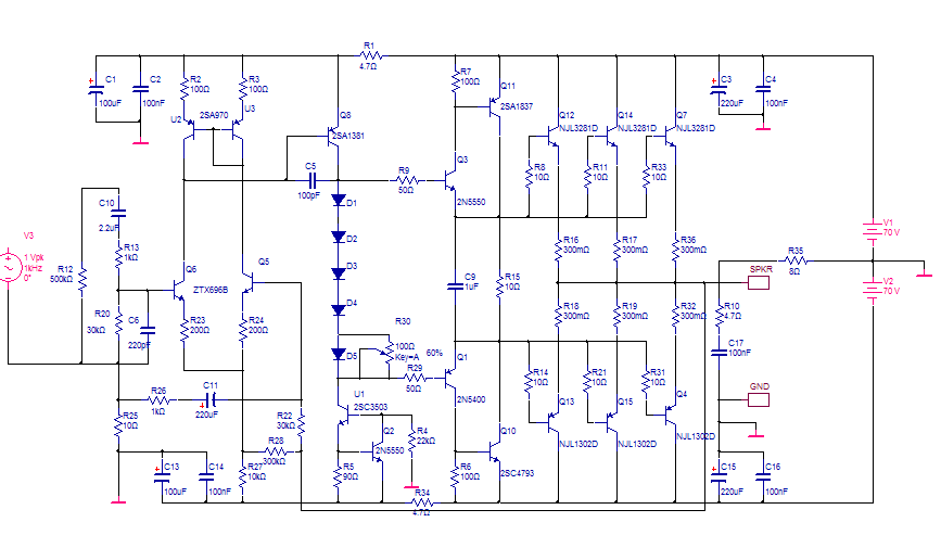

I see you are on it , MJL. The vbias circuit is the only one
that really needs a "real world" setting. When I built frugal 1
I found that my sims and calculations were somewhat off/
wrong (and the self amp handbook also)Different OP devices
have different thermal coefficients, as do different heatsink/ops
combinations, and where you put the Vbias (on the HS or
directly on the device)It has a lot to do with timing.
I debated this on the t-trak thread (over compensation
was the term), The best way If I had only T-traks to build
with would be to buffer the internal diodes with a typical
BD139 Vbias circuit (AKA prof leach) because the response
of the internal diodes are way too fast and the current from
your VAS with also pass through them, with rapid changes in
bias current.
hook 4 diodes between A/B ,leave r27 /P1, maybe change
R25 to a trimmer to adjust the coefficient.Make C big ,as
the on-die diodes are real (too)quick.
I experienced this on my amp with VBe right on the device!!
For my NJL0281's (similar to T-traks) this ratio..
r18+vr2= 875R / r17=2.7K - the roughly 1/3 ratio kept my OP's at 50ma(I get Xover distortion at under 35ma)
startup, 60ma normal use, and climbing to 70ma then compensating (backing off)at 40C+.
this is something you are going to have to play with as
the real world is much harder to sim.
OS
Hi OS,
Yes, I looked at the Leach idea early on and I can't see the advantage. More complexity when it should be less. I was following the TT thread also, and I couldn't understand the concern. I have used diodes to bias and monitor thermal condition before and didn't have a problem. These were just simple 1N4001's touching the heatsink.
See roender's RMC amp for his solution.

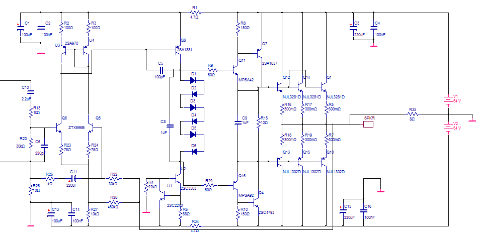

I have thrown out the design above and developed a new one. I have been working on this one (adapted from the KSA50) for about a year, off and on. Obviously, I didn't have these outputs in mind originally, but things change.
It looks good in simulation with low THD and very good stability.
