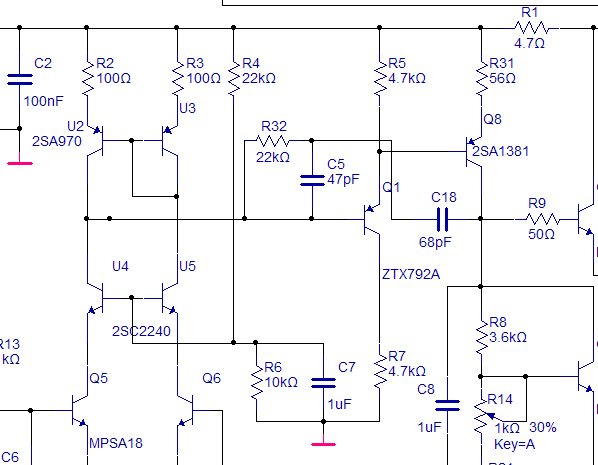

Wouldn't it figure - now that I have the board layout complete, I'd start screwing with the circuit again?
I have been experimenting with 2-pole compensation. In the simulation I have been trying different values for the before/after caps. I also thought to try to change the centre point from a pick off the rail to a few different place to see what gave the best stability.
First I went to ground - no improvement, in fact worse. Then I though to try places at random (remember, I don't know what I'm doing 😱
I tried the output from the VAS - quite a bit better than the rail
I tried the output from the LTP - better still.
Played around a bit more with the values and came up with what's below. Is this a good idea?

Close ,but no cigar.. you are shunting one of your poles.(C5)
Ratio is important ,too (C5/18 = 1/2 = 47p/100p). center of
caps (R32) should be "set" to somewhere other than
the signal path (V+).
The second question is , why is it better?? More nfb over
a band of audio (peak) resulting in lower THD for that band.
But it has a downside ,VAS is delinearized if you dont get
R32 just right (6.8k?).

It can make for a more stable amp with less HF distortion. So,
play around with it..

ostripper said:Close ,but no cigar..
Hi OS,
The point wasn't the use of 2 pole, but where I picked the centre from. The scheme above gave the best stability and I was looking for a reason why the output from the LTP would be better than the rail or ground. I didn't even consider THD for this, but did check after and it is unchanged a 1k but slightly lower at 20k.
As to the values, I used the lowest possible to get the best results ( 68p same results as 100p)

I'll try it out on one of the older modules and see how it works. If it improves the overshoot, I'll put it in the new layout. Not that big of a deal.
I had trouble with the cap in parallel with the feedback R before in the original incarnation of this amp. I haven't tried it with this one, so I may do that.
Remember, it's not instability that I'm trying to solve but the overshoot.
maybe too much OLG, when I started using the 1381's with my first amp I got 70db (versus 53db w/mje350) this gave me overshoot in sim. I later degen'ed my LTP to do 60db.Remember, it's not instability that I'm trying to solve but the overshoot
your Vas is EF'ed, must have overkill gain but that would depend
on the grade of 1381's you have (F=300 E=150 c=40-80Hfe)
I ordered 20each of the "F's" as your model seems to reflect the
higher gain group.

Yeah, I tried it without the EF - no difference. I tried a higher gain (the Zetex above) for the EF and actually saw an improvement. Could be worth doing.
I need to muck around with the actual circuit, change some things to see how it looks on a real scope.
The F version of both is what I have.
Endless tinkering and I have changed up again. Armed with better understanding (it grows daily 🙂 ) I have made some improvements:
I have ditched the EF on the VAS - various reasons.
I added an emitter resistor to the VAS and lowered it's working current.
I increased the cascode voltage in the input by changing R6 to 22k.
Otherwise, everything else is the same. I haven't tried these changes on the actual amp yet, but I can't see any problems.
I'm also thinking about lowering the gain to limit this to 100watts output at max input (1.2Vrms). This will allow the amp to use the same power supply (or lower if required), but leave some headroom for clipping. I haven't included the clamp diodes for this reason.

MJL21193 said:Endless tinkering and I have changed up again. Armed with better understanding (it grows daily 🙂 ) I have made some improvements:
Hi John, should C12 not be connected to the output, or do you have a reason for the configuration.
Nico
A final remark, I am not sure if your CCS is really up to task, it will vary with varying supply voltage, the diode is referenced to a resistor that will drop voltage depending on the supply.
I would remove the 470 Ohm resistor and use another diode or maybe two diodes.
I could interpenetrate it wrong and you intended something else with this circuit.
Nico
Nico
Hi Nico,
Connecting the bootstrap cap to the emitter of the driver was recommended by jcx earlier in this thread. It seems to be beneficial.
Nico Ras said:A final remark, I am not sure if your CCS is really up to task, it will vary with varying supply voltage,
I was confused too (as well as others).
It is, in fact, a current mirror and not a CCS. It has a huge impact on THD at high output, at least in this circuit. See some talk about it starting here.
