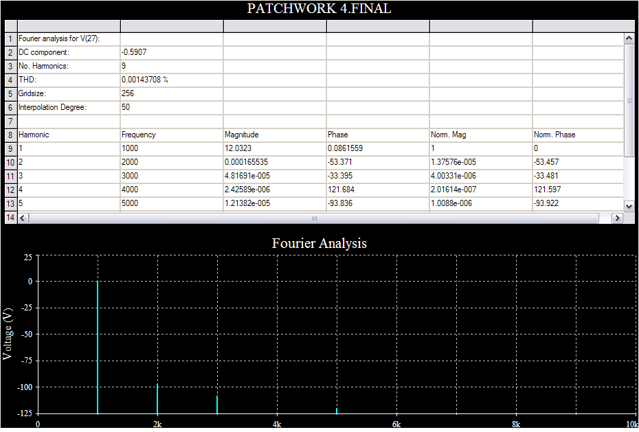

Hi Homemodder,
I'm not chasing THD anymore. I have this design low enough that any improvements in that regard will never be detected.
FFT 1k, 9 harmonics:
EDIT: Oops! Wrong chart.

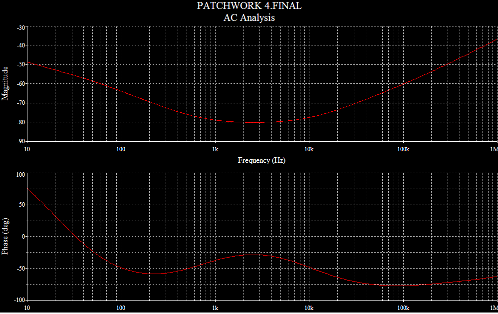

Hi Andy,
I tried this but it didn't make a difference - still showing terrible PSR down low.
It's the same result for the diode configuration as the standard Widlar mirror with the resistors mismatched.
Before someone blames my resistor current source, here is the PSRR with the balanced LTP:
When I change to an active CCS on the LTP from the resistor source, this improves the result, but still not close to where it is with a balanced LTP.
The decrease in THD at higher output levels is baffling too. Why would it do this in the first place? I wouldn't bother if the change was unremarkabe.

From your harmonic analysis graphs the offset is almost > ½V.
I took a few moments and captured your diagram into microcap. I see the same off-set and cannot cure it unless I make significant component changes.
The current mirror does not do its job since the legs if the LPT is 3.5 mA and 1.3 mA.
THD I get much higher numbers at the same 12V output. It is 0.17% at both 1 and 10 kHz @27 degrees centigrade and 0.6% @ 50 degrees centigrade.
There seems to be a thermal problems too. Current increases with temperature. Bigger problem is that it increases more in the NPN side.
My models may be very different from yours though.
