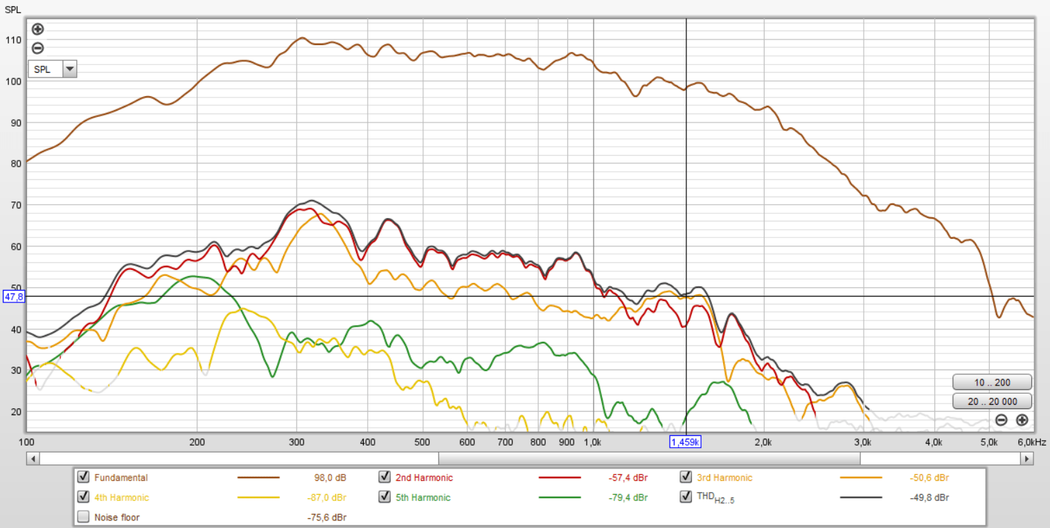

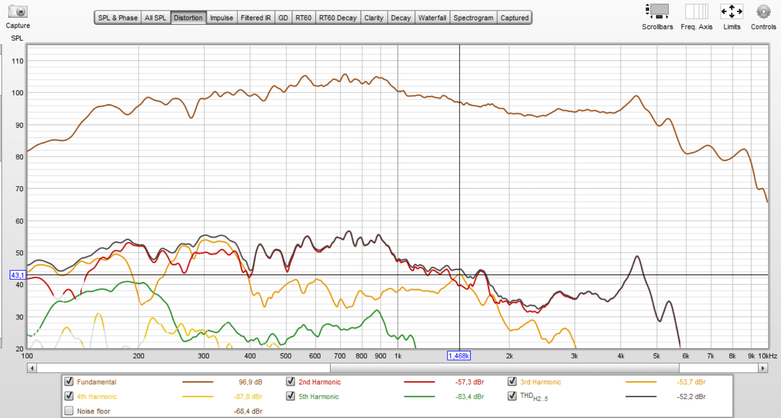

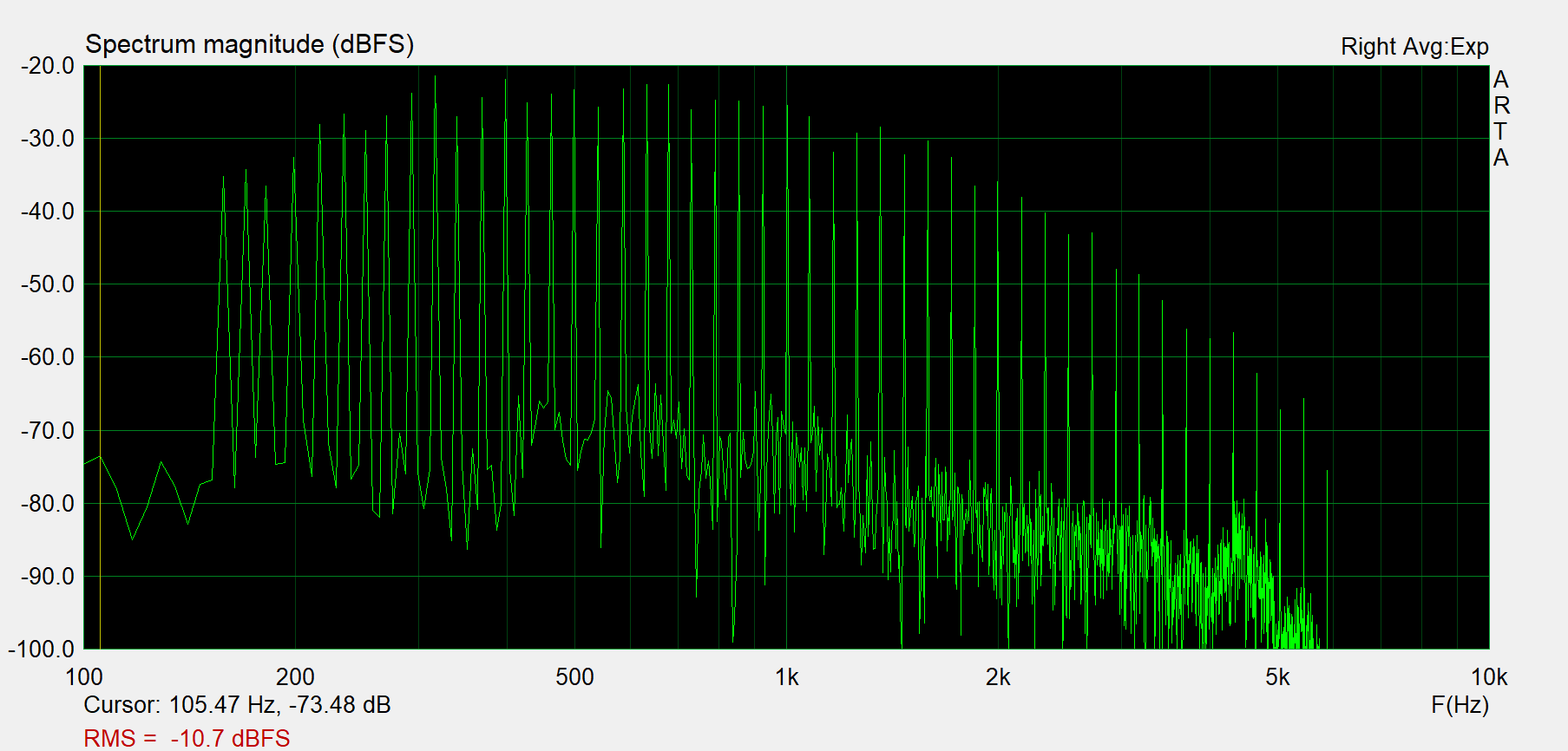

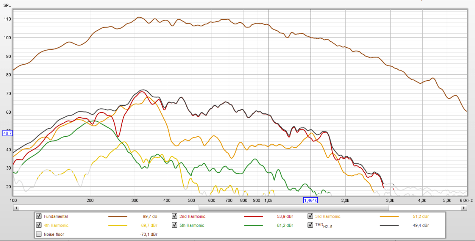

Hi all,
some data @b_force is likely interested.

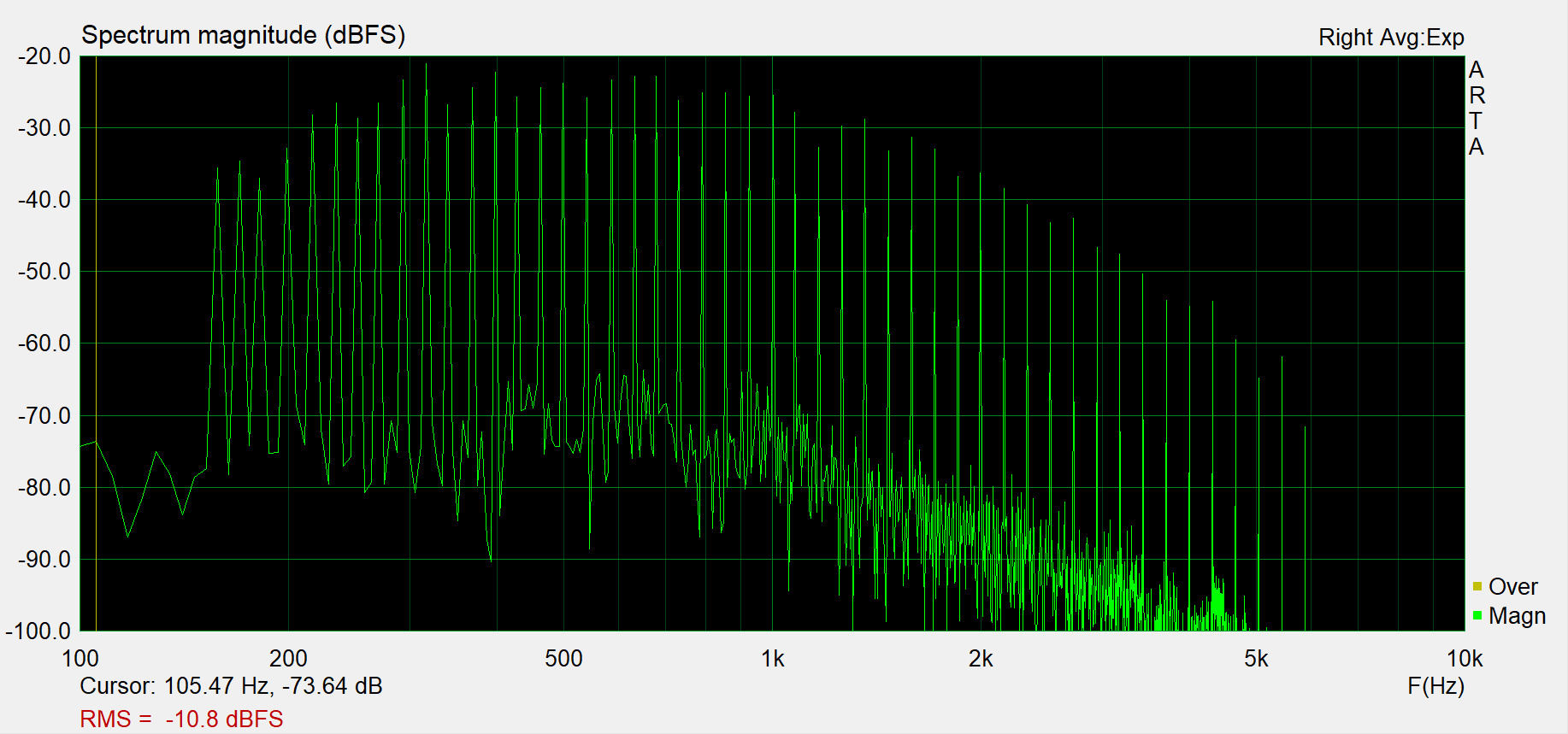

I've got Faital Pro 8pr155 midrange driver in an active speaker system and it has quite severe cone breakup peak around 4.5kHz. This makes peak in harmonic distortion measurement, because distortion from driver motor makes lot of distortion current in an active system as circuit impedance is very low due to very low impedance amplifier and no passive components to increase the impedance, further amplified by the breakup.
Adding series impedance, a notch filter or just low pass inductor increases circuit impedance reducing effect to current from Le(x), which reduces acoustic distortion as current means movement of the cone.
See third harmonic peaking at ~1.48kHz, which is root for 3rd order harmonic at cone resonance 4.5kHz. About -40db relative level.
Increaseing circuit impedance with 1mH inductor in series drops this considerably, although signal level is also dropped it can be boosted back with DSP.

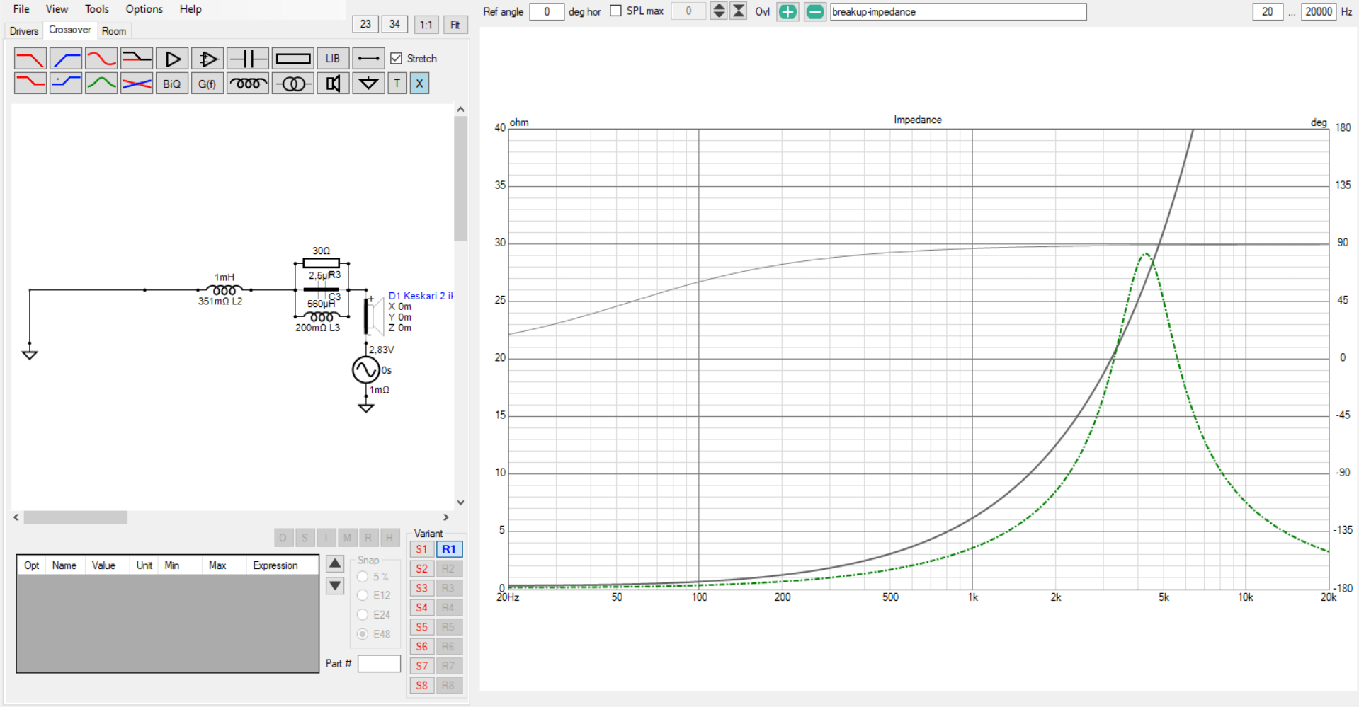

I tried series notch filter as well, but the effect is better with series coil in this use case. Here image illustrating impedance in series with the driver in case of series inductor making 1st order low pass, or just a parallel notch filter.
The series inductor increases circuit impedance from few hundred hertz up reducing current by motor distortion, which reduces distortion in acoustic domain as current is what makes the cone move 😉
This kind of crossover, where there is passive parts to manipulate circuit impedance for distortion reduction and DSP to manipulate frequency response independently, is great. Although, I'm not sure if I actually hear any difference between these in normal use.
Forgot to take audio recording of the two, have to do it some day. Also, should have taken measurement with DSP low pass for comparison. Well, can't have everything with hurry 😀
edit. Had very long post, cut most of it out.
Reactions: Hörnli
relative numbers are visible on the bottom of the screenshots at cursor frequency ~1.5kHz.
2nd and 4th order distortion drops about 6db, perhaps because excursion is less with the low pass, 3rd order drops about 13db so benefits most from the series impedance.
I'll measure with DSP filter as well some day, plan to do some multitone measurement as well. Had only short time window to do some measurements, made these at the end without planning beforehand so kind of second thought.

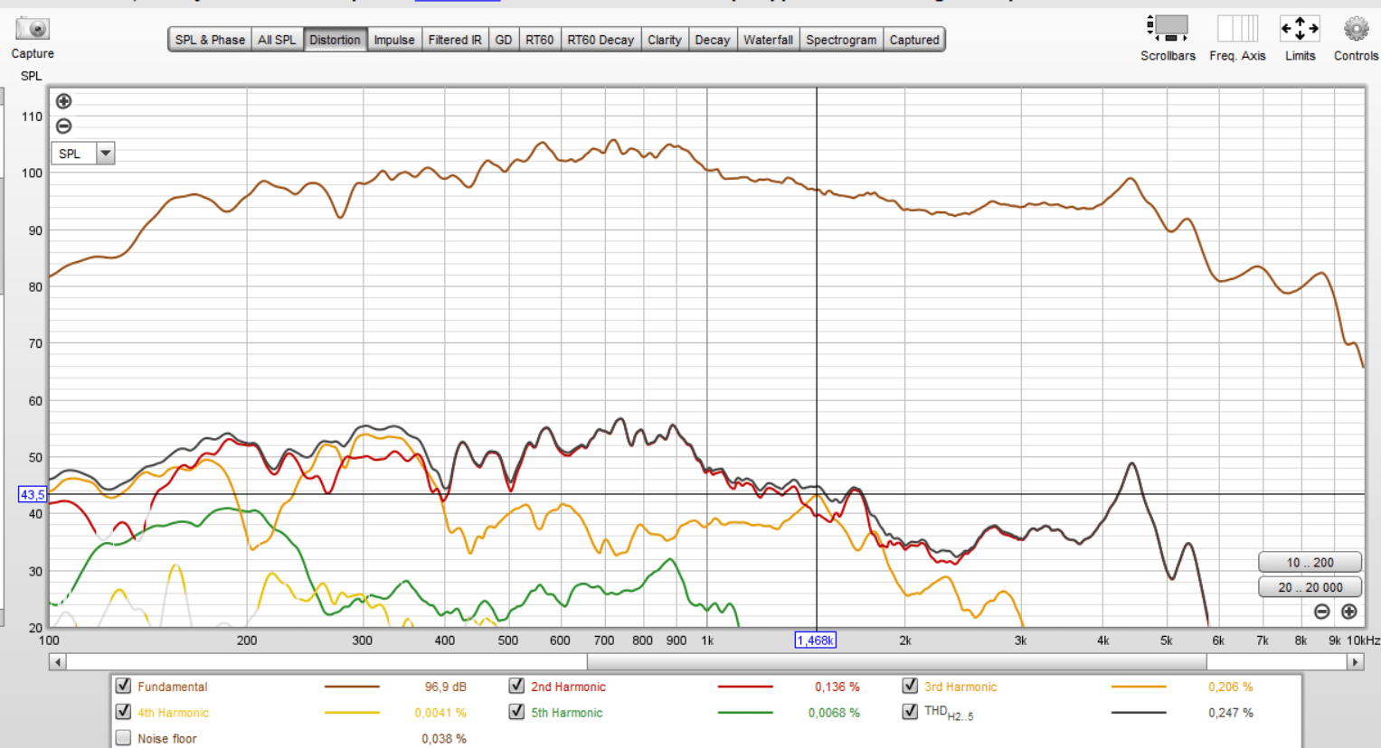

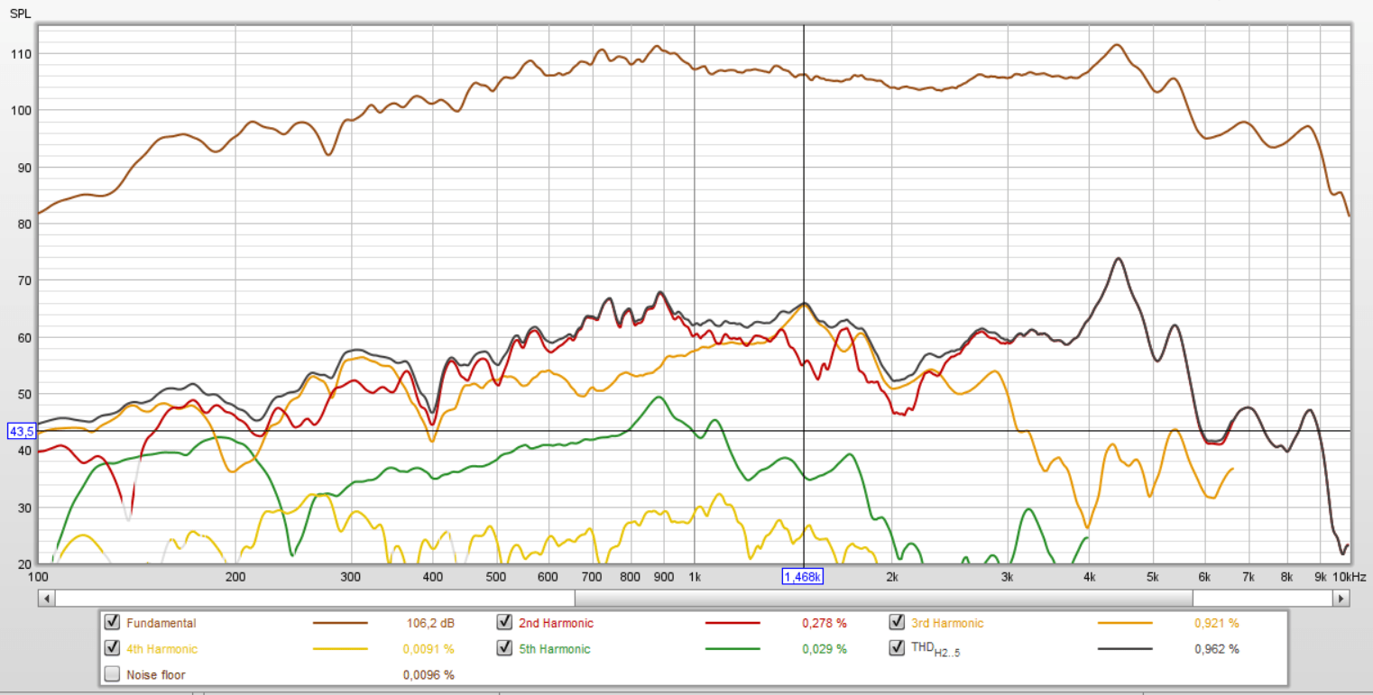

edit. I can't find how to normalize the graph to show the distortion relative to signal. Here the numbers in percent, shown bottom of the images:
Reactions: Hörnli

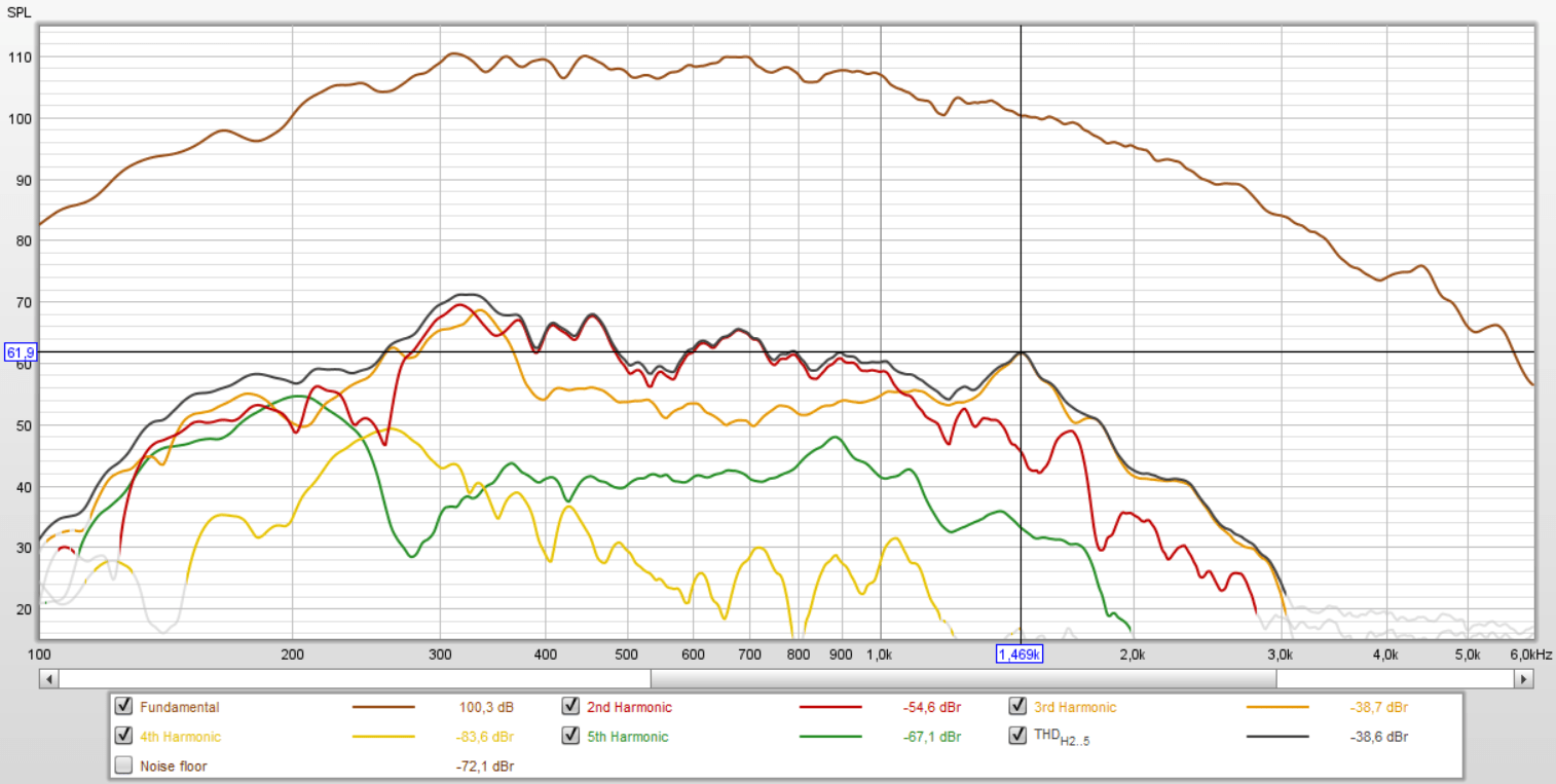

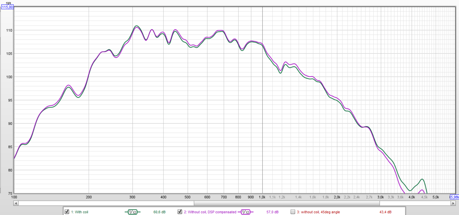

didn't have time / forgot to do it but I'll do some day 🙂 There is 10db difference in signal level, so it must contribute some to the distortion, equalizing with DSP to match the responses with or without inductor would show more accurately change in distortion.
This driver is in use in loudspeaker system with the series inductor and EQ:d with DSP for suitable system response. Bandwidth for the driver is roughly 200-1300kHz, and as you see level around 200Hz is same with or without the inductor. Inductor drops the response to the same level around 1.3kHz so there is no need to boost with DSP in real application, only cut in either case so basically the distortion reduction here is free in that sense. Or, perhaps 5€ worth of inductor to be precise 😀
Yeah I need to revisit, the driver with response like in the system, with or without inductor EQualized with DSP to very close each other.
If you compare to say 2nd order harmonic, which drops about 6db, likely due to 10db less output. Same for 4th order harmonic. 3rd order relatively more, ~13db. In general, 3rd order drops relative to 2nd order harmonic from about 400Hz and up.

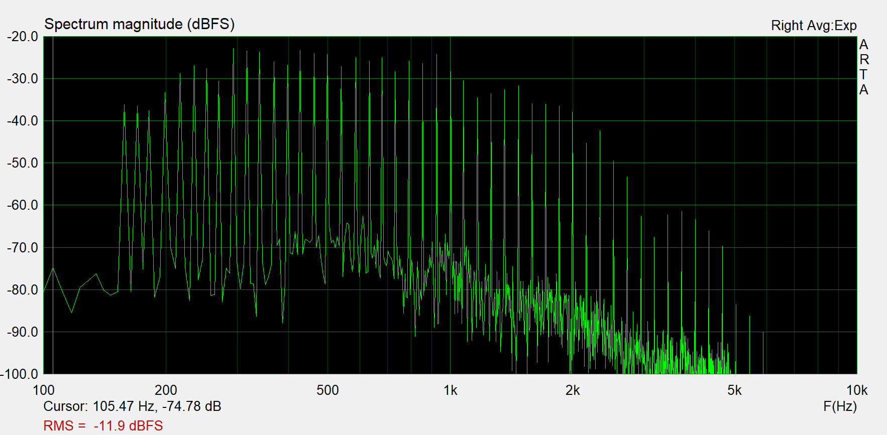

These are with in application setting to the extent speaker was where it is normally installed, just muted tweeter and woofer in DSP. This is with coil.

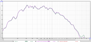

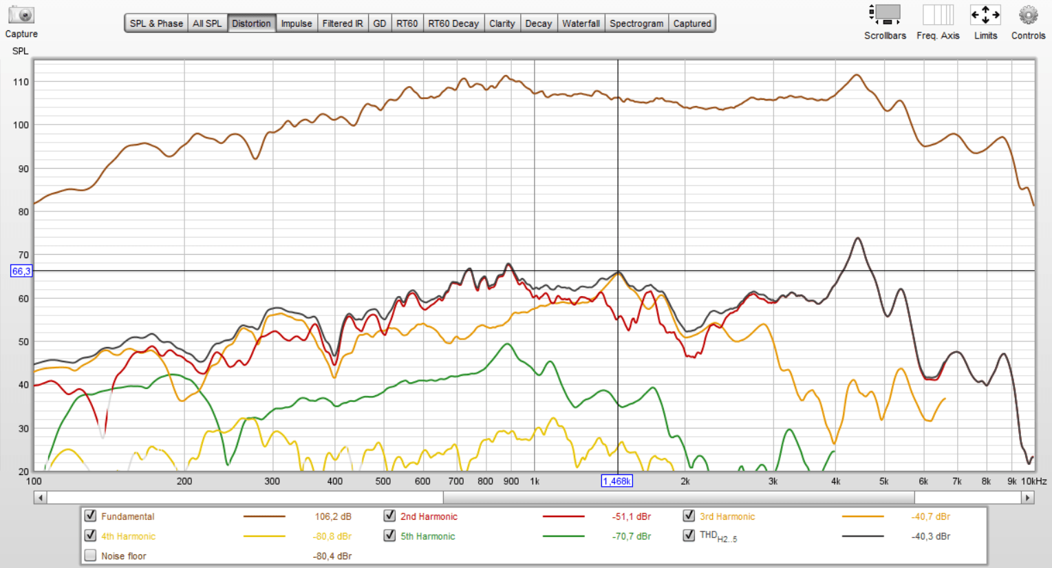

Popped it open, shorted the coil and adjusted DSP to match quite closely to the coiled response, as closely as could in few minutes, it's about within 1dB. So, this is without coil with roughly application frequency response.
Here is match, 1/6th octave smoothing:

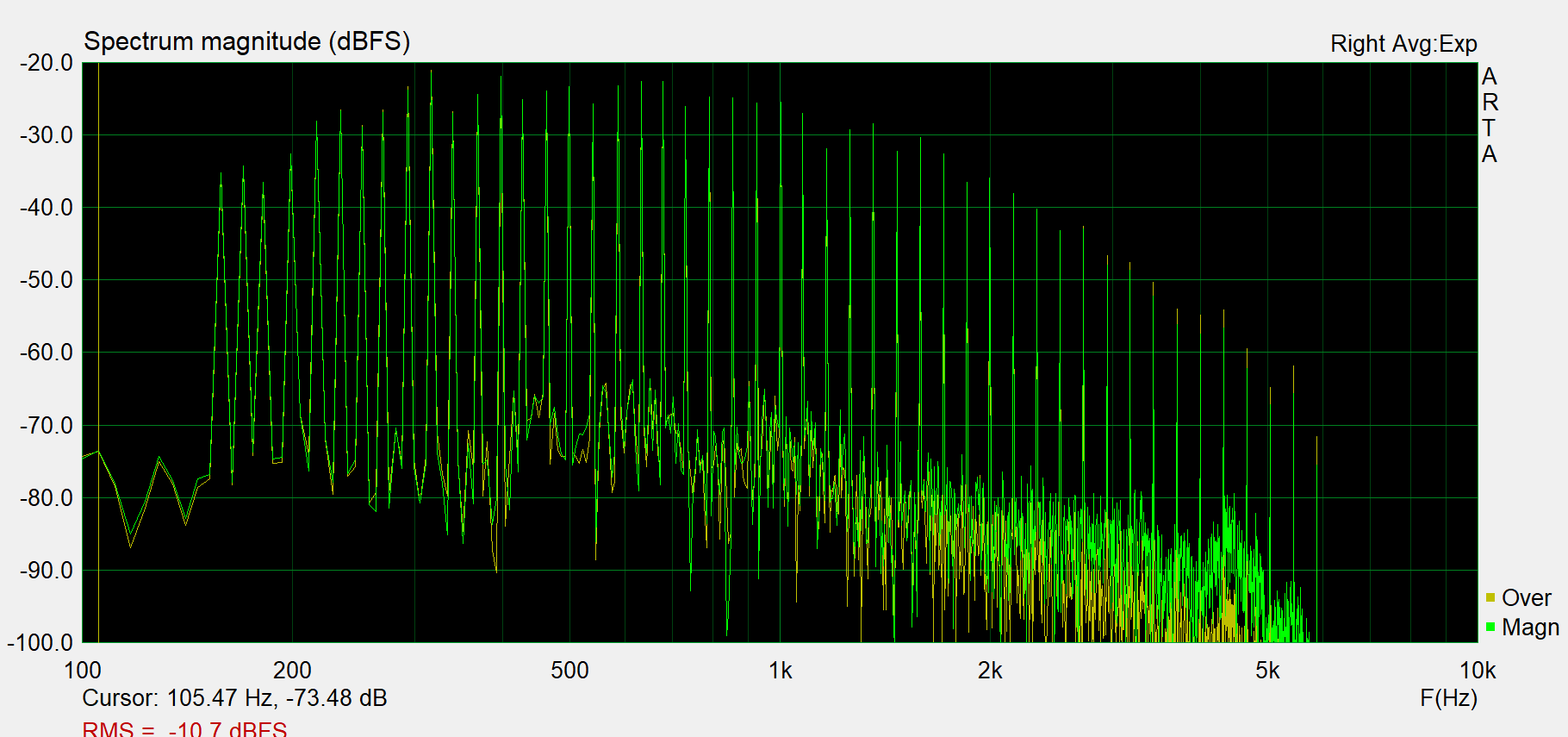

Here is multitone measurement with both as well, individually and overlaid;
And as bonus for @b_force here is mic moved to about 45deg angle, this is without coil. Notice how the breakup peaks are gone/different, also from distortion! 😉
Yeah, there is no notch filter in the setup, only series coil. That is why distortion drops everywhere where series impedance is increased, basically almost the whole bandwidth in this case.
The 45deg set is without coil as well, you can compare that to the on-axis no coil graph. Point was to illustrate that the breakup is amplifying the distortion in acoustic domain, on-axis mostly. Off axis could have reduction in distortion, what ever the erratic output due to break up is to various directions with various drivers.
