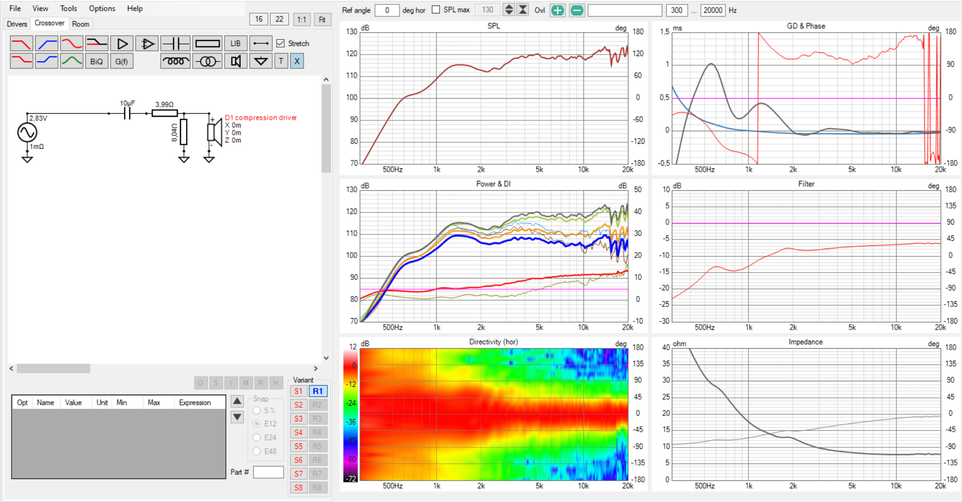

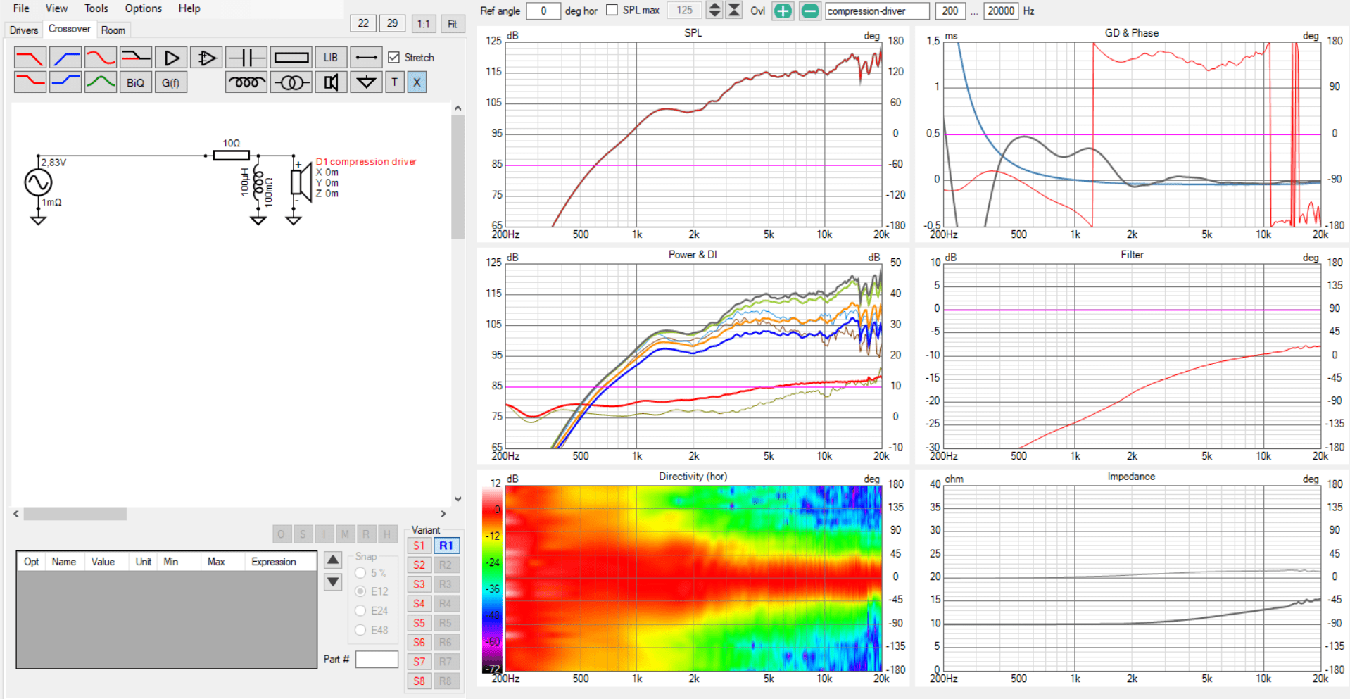

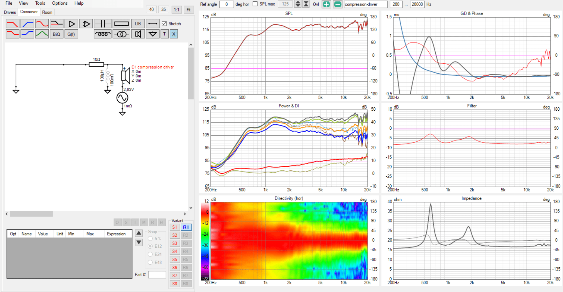

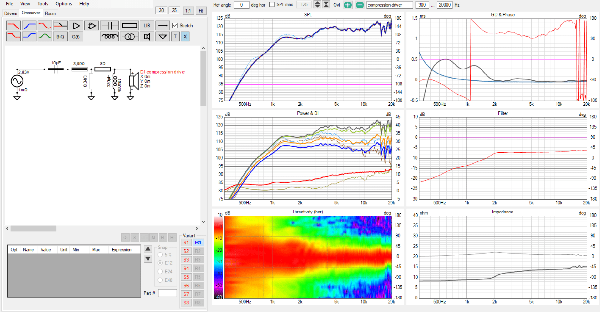

Tmuikku, just out of curiosity, try to simulate a 10 Ohm series resistor followed by a 0,1 mH (0,1 Ohm DCR) coil to ground filter with your CD+horn combo.

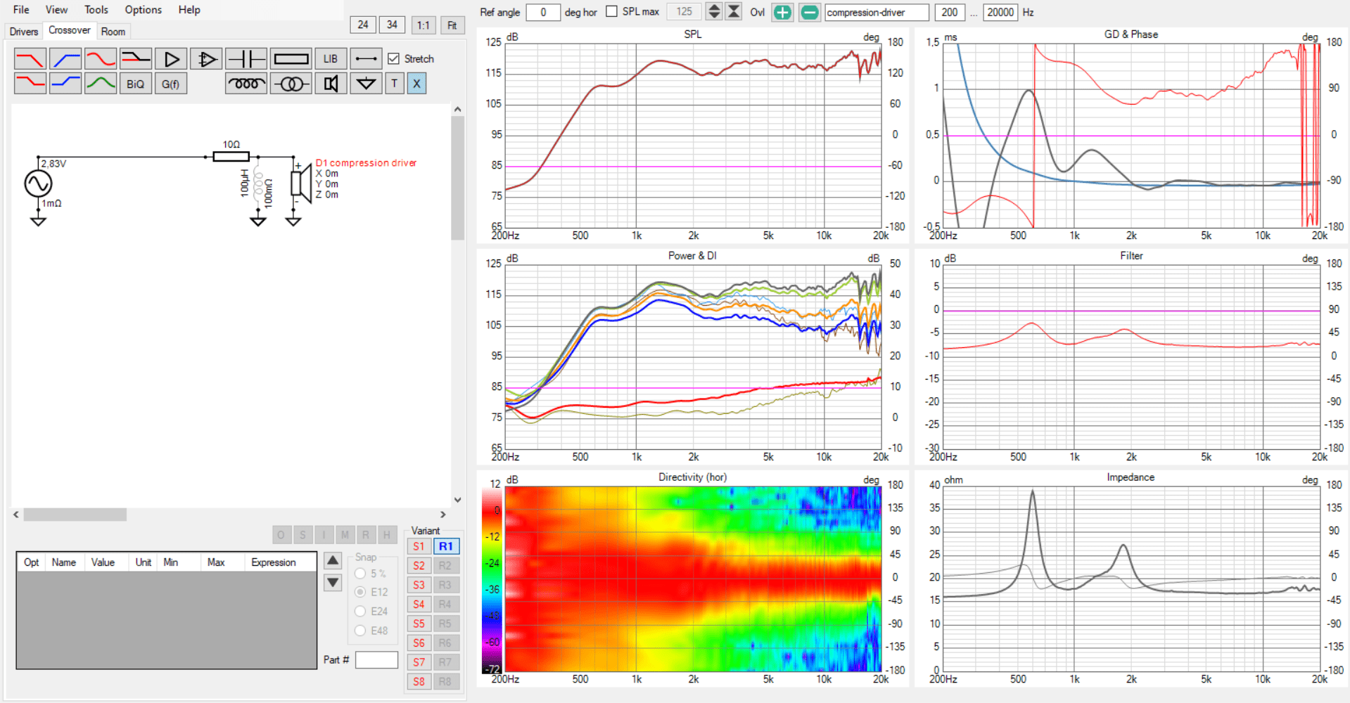

Here, source inline with driver to see impedance from driver side. Inductor lowers impedance for the driver and dampens the resonance.
Here source as usual. Inductor works as high pass of course, damped resonance.

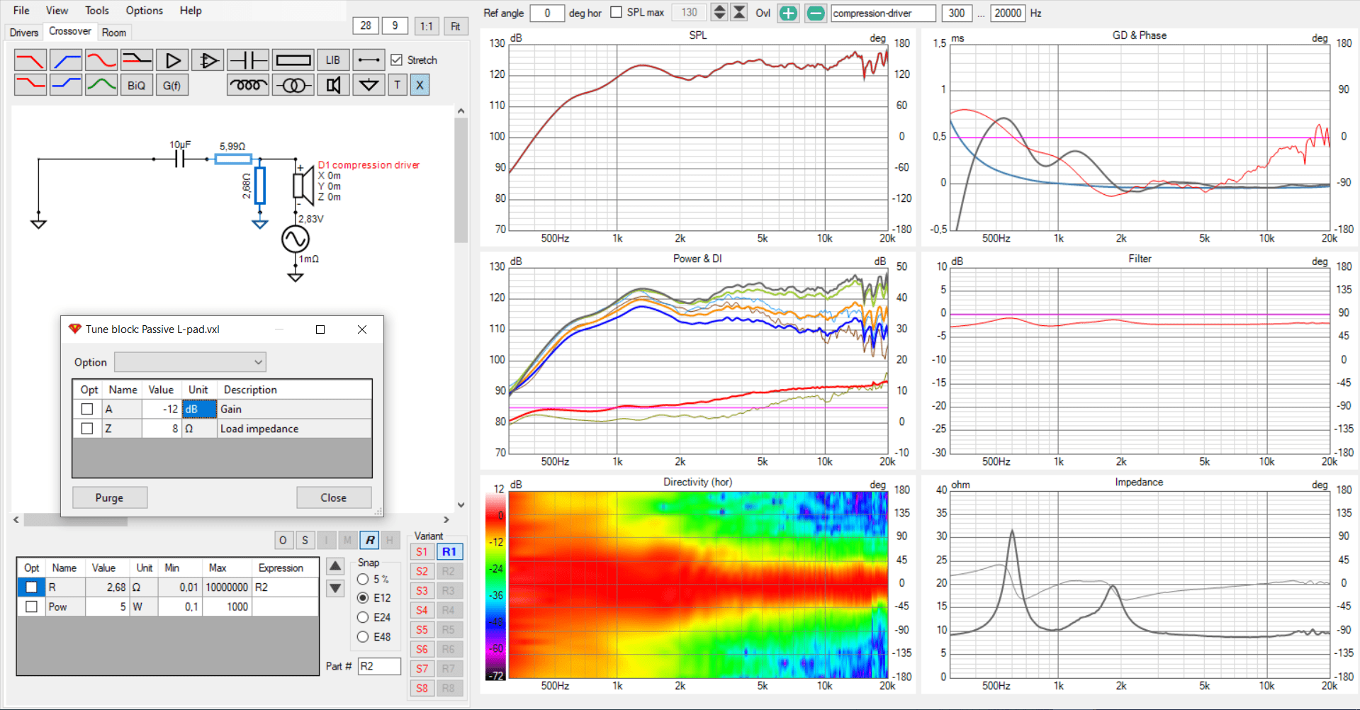

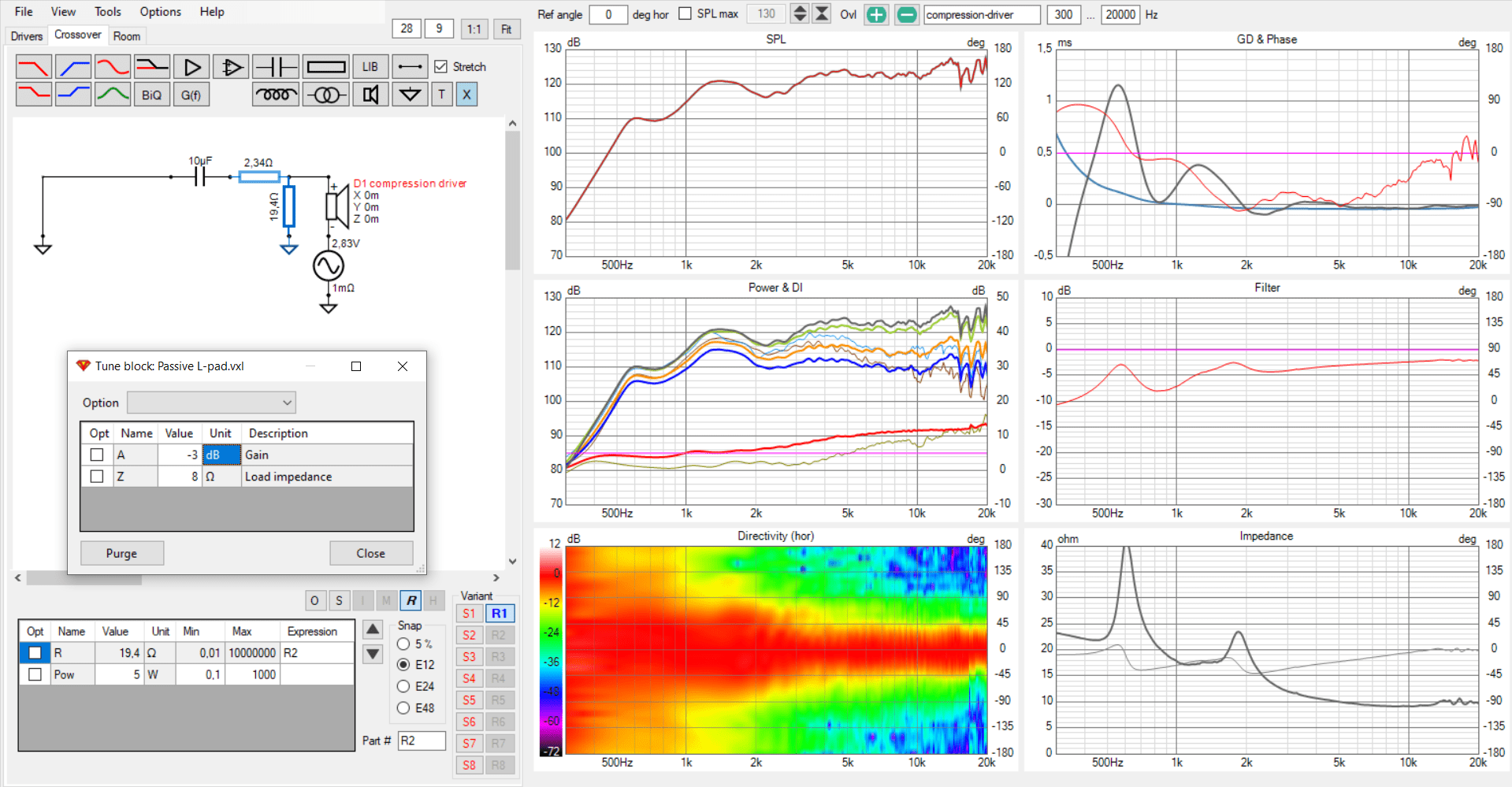

Here capacitor and L pad for comparison, levels and slopes not adjusted to match. L pad has 8ohm resistor, much higher impedance for the driver than the 0,1ohm resistance in the inductor.
To untrained eye it looks like the parallel inductor, while providing high pass, provides better damping for the driver than series capacitor high pass (with L-pad). Looking from amplifier side capacitor would make high impedance (for lows) and the other would just be about 10ohm for most part.

But that high impedance created by the capacitor reduces the damping factor (look at the humps in the filter response), that's why series capacitor is not recommended in high-SPL situations with horn loaded drivers if another high-SPL source (a midrange driver for example) is close to it. Yes, the horn start to acts as a microphone and the loaded driver starts to move. The diaphragm even can hit the phaseplug and shatter.To untrained eye it looks like the parallel inductor, while providing high pass, provides better damping for the driver than series capacitor high pass (with L-pad). Looking from amplifier side capacitor would make high impedance (for lows) and the other would just be about 10ohm for most part.
I see, on high power application there would not be a pad with the capacitor, no shunt, and no damping for the driver. Better damping on the compression driver might be audible even on low power use, if eventual crossover is low, I mean amplifier excites the driver resonance as well. With capacitor and L pad there is some damping but not as much as with the small parallel inductor.

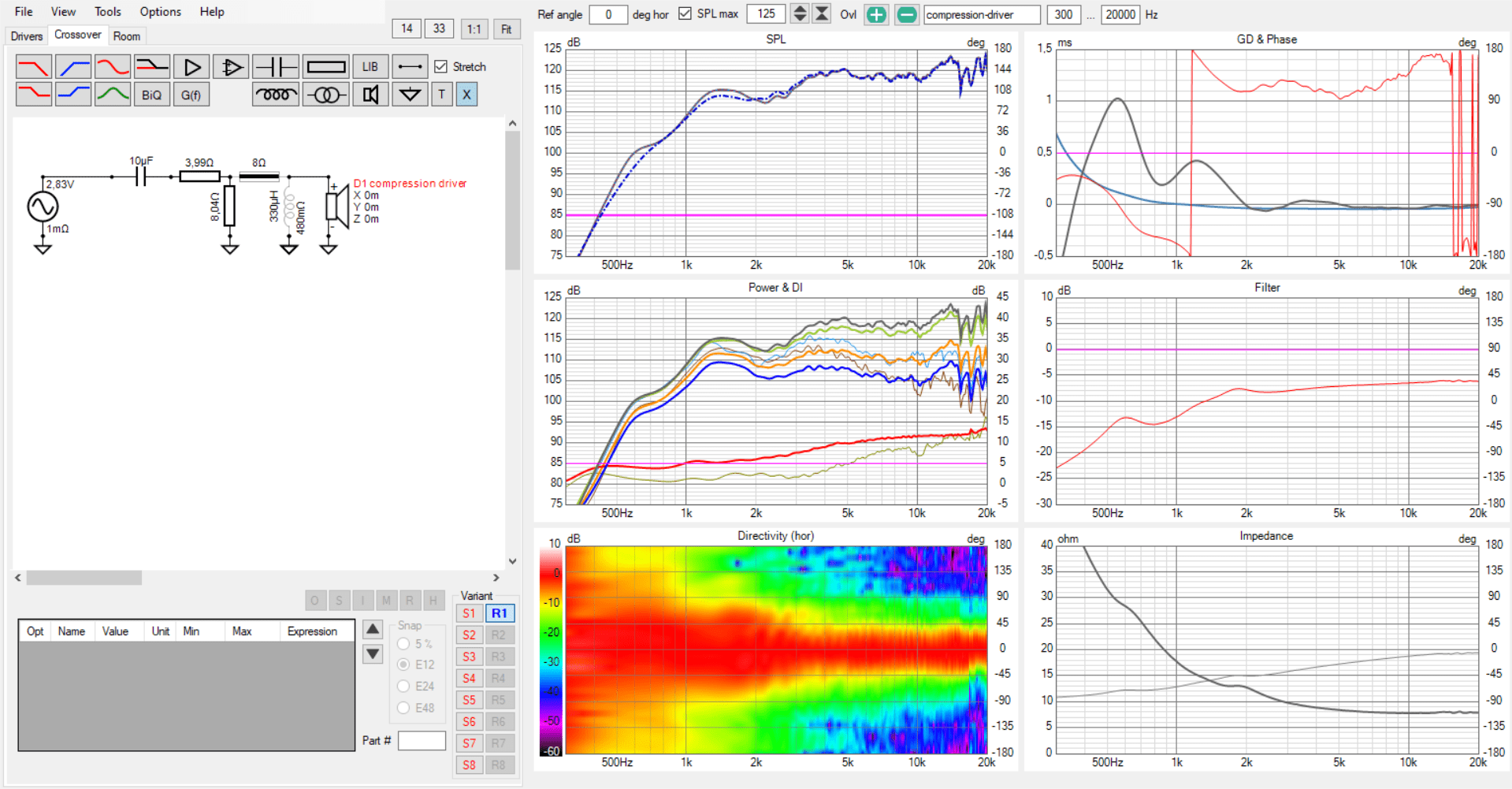

Here again, tried to match on axis response for 10uF cap with -6db L-pad and series resistor with shunt inductor. Its lots nicer response with the inductor, better damping for the driver. Need to try this one. Have to take new measurements as this is another waveguide and stuff. Thanks YSDR for this!🙂

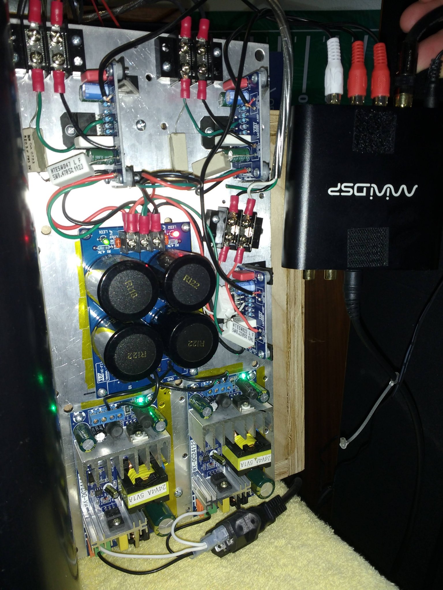

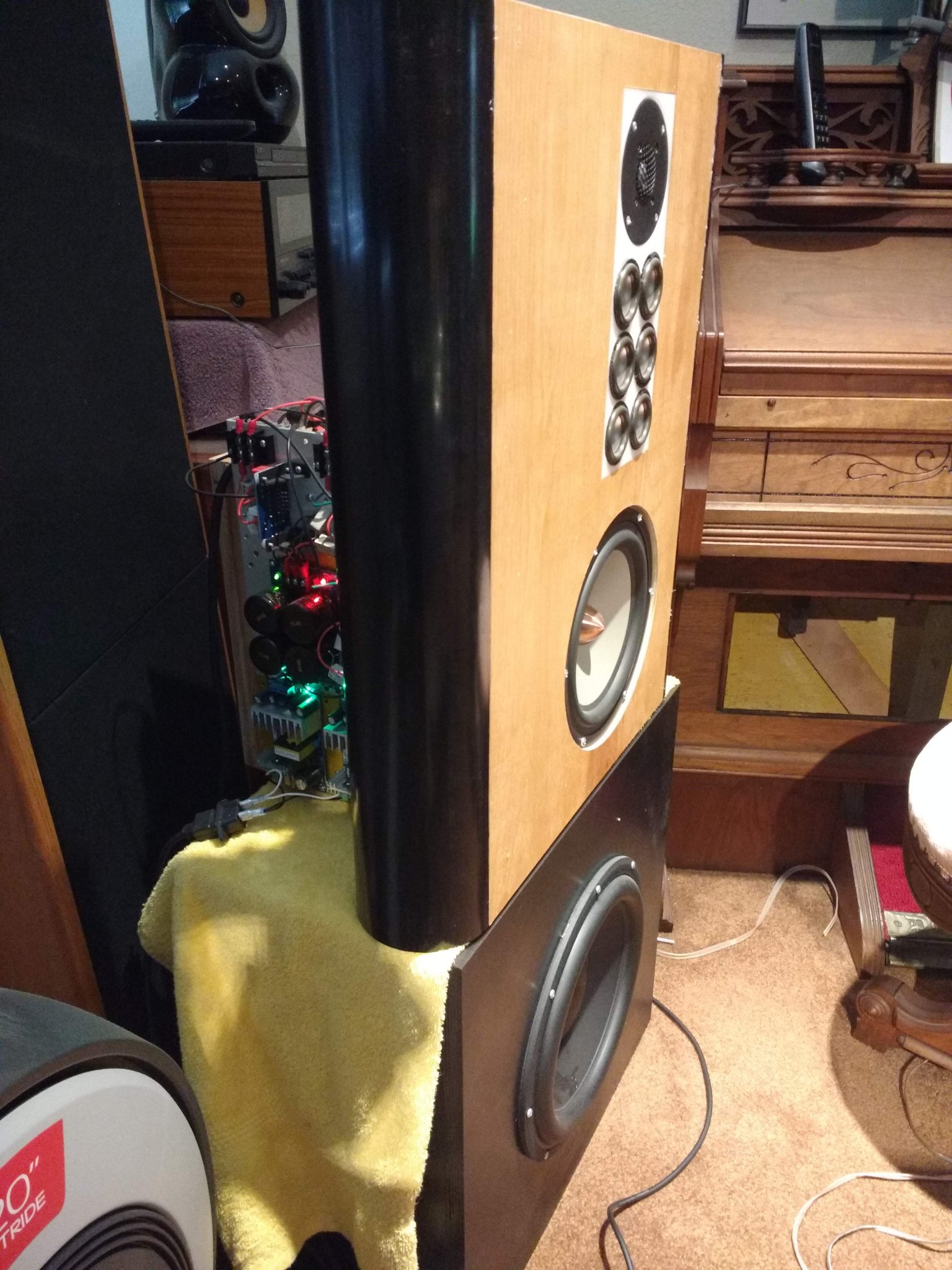

Currently assembling some icepower modules into an enclosure, finally a stereo setup after finished, at least few more evenings as I have seemed to lost half of my tools during home rebovation few years back 😀 supposedly lower noise. DSP also changes, hopefully its better in this regard as well. I've been prototyping with Sure Wondom 2.1 setup, adau1701 DSP chip, suitable for 3way mono system, but noisy. Huge amount of utility but cheap price reflects its not very good design.
