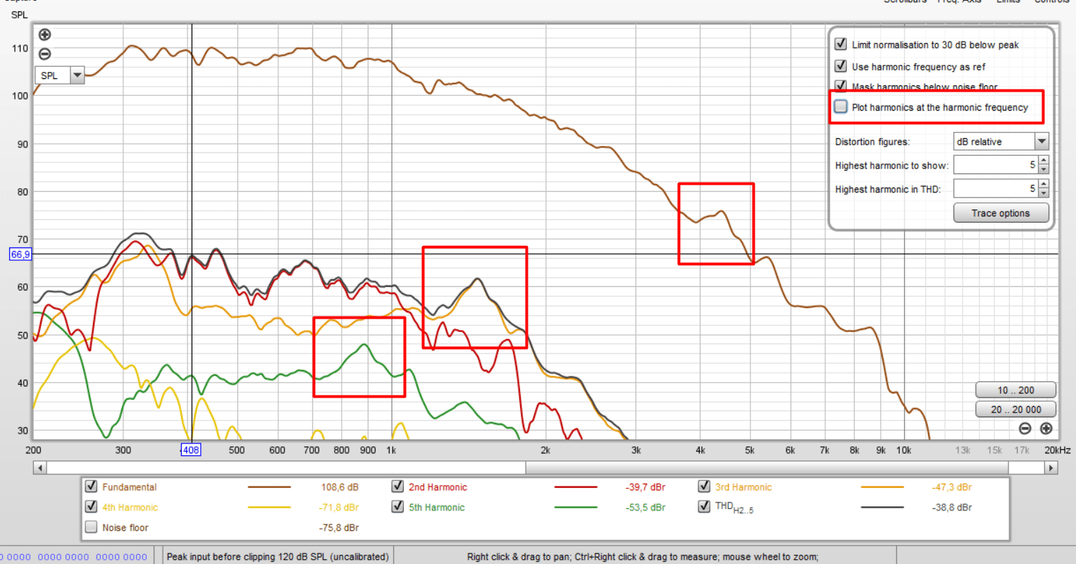

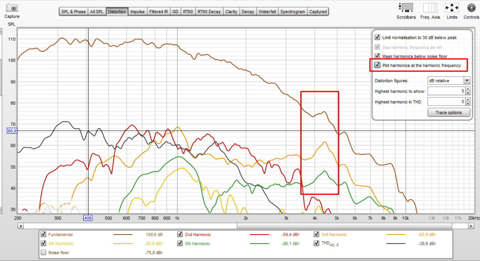

In case my posts are hard to read here is demonstration, in REW one can plot the distortion on the root frequency or at the actual frequency it is measured:

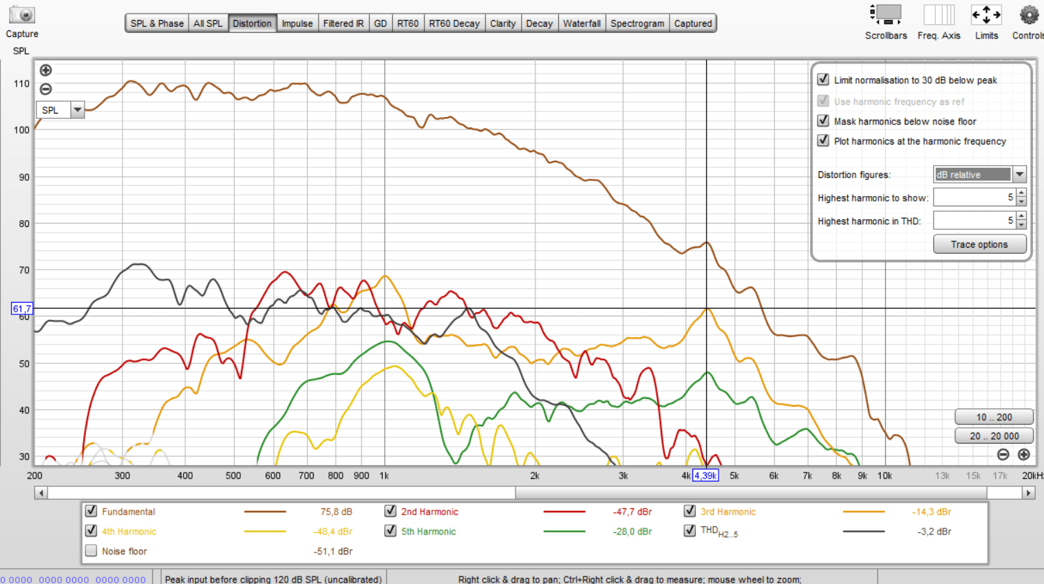

Btw. the photos are of a midrange with DSP only, these I've posted on this thread earlier already. The main output at cone resonance about 4.5kHz is dealt with DSP, but the distortion shows peaks on it as expected. If parallel notch in series with the driver was used instead, also the distortion peaks would have dropped.
And look, the third harmonic of ~1.5kHz is only about 14-15db shy of the main signal acoustic output at 4.5kHz, thats about 20% distortion!

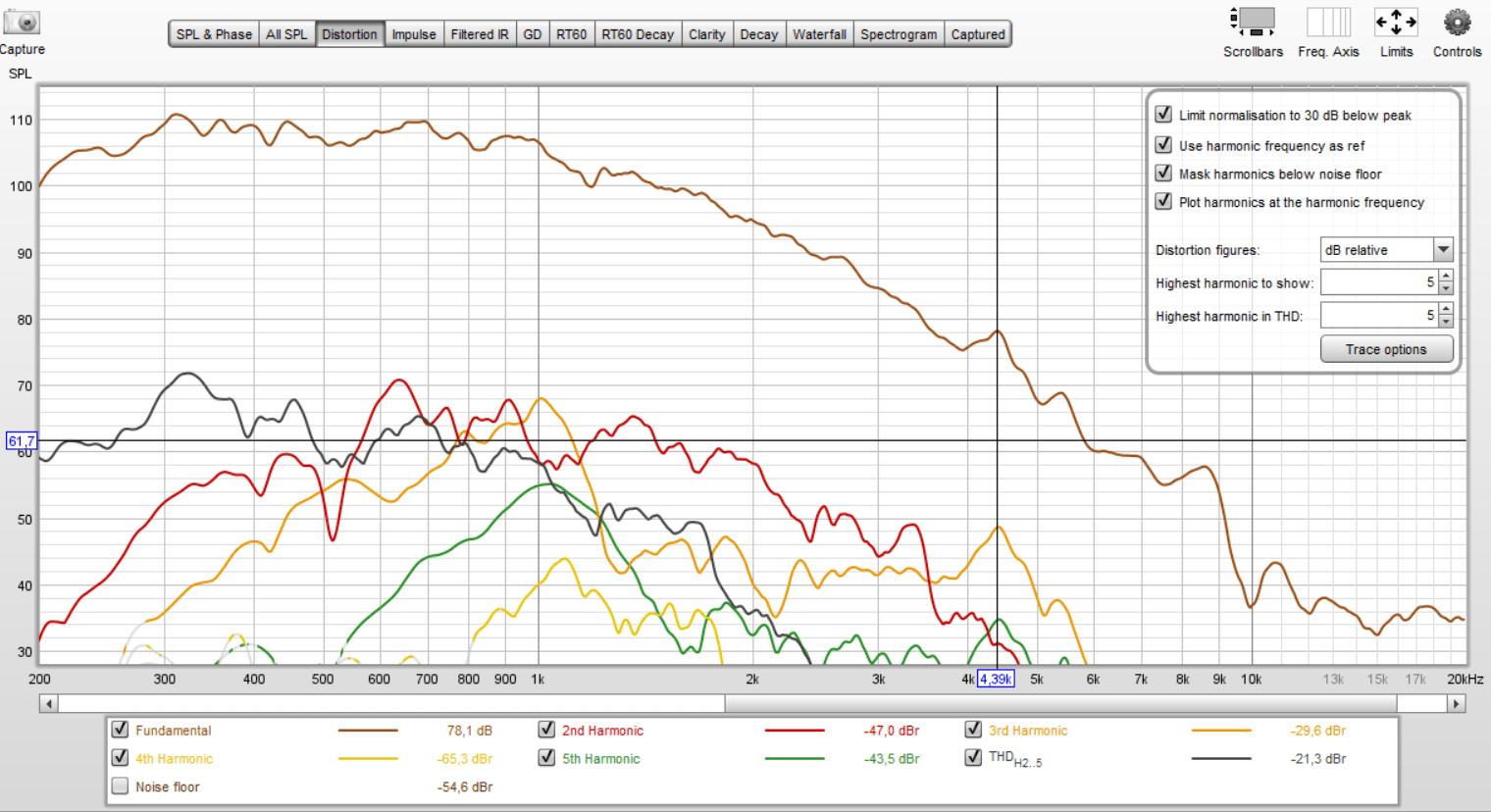

I didn't have suitable parts for the notch, but using just a series coil in combination with DSP low passes some of the distortion as well, as it should. About 3% distortion in this case. The distortion would be even lower, if there was also a notch filter.
This is one example why make a hybrid crossover. Basically, DSP low passes the main signal, while it doesn't low pass distortion generated passband within the driver itself. This makes the relative distortion huge, and perhaps audible. Series impedance low passes also (some of) the distortion, maintaining the ratio. I should have demonstrated steeper acoustic filter here, it is possible that main signal is low passed hard in DSP so that distortion could be over 100%!
