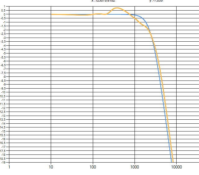

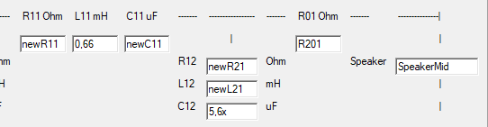

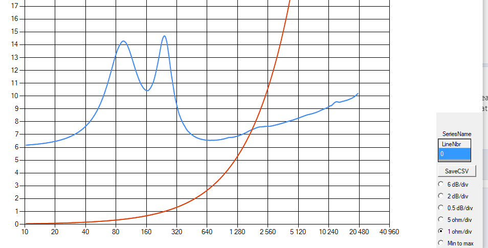

L = 0.66 mH in series with speaker.
IZI for L is red line
Falling responce early

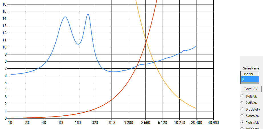

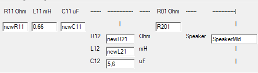

Add parallell C of 5,6 uF
We se yellow (C) and blu (speaker) Z will be in parallell so red z (L) is in series with a lower Z

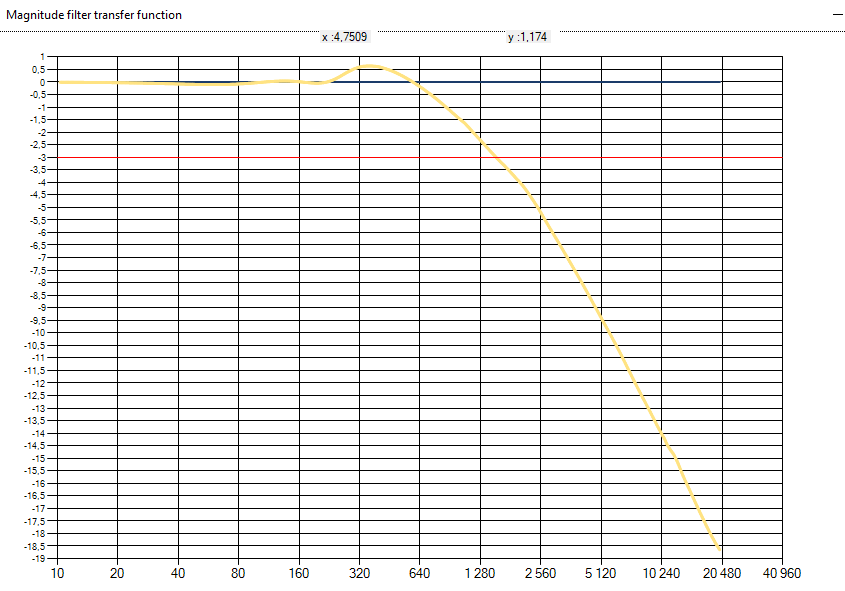

Some adjustments must be done activly to get to a 2 order butterwort filter. Also on phase, but will not go into that now
So why this ordanary 2. order passive filter example?
We see that Z for L (in series with speaker) is rising and is equal to Z speaker already under 2 K. So according to high Z source goal, the goal is achieved already from about 2k and distortion is reduced at even lover stimus frequencies.
C is used to broaden the upper part of the pass band.

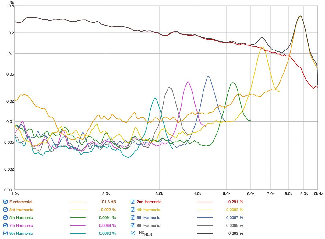

Here some preliminary results from a friend you might find very interesting! 🙂
He's currently working on a loudspeaker with a Seas DXT tweeter.
So we took the opportunity to see if the passive notches would also work for tweeters.
The Seas DXT specifically has a pretty nasty peak around 26kHz.

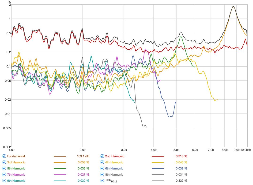

First just the DXT tweeters as is:
Only the distortion is show in the graphs btw, don't look at the distortion numbers in the legend.
Yes, that's an awful lot of higher harmonics still around 3-4kHz, ewww 🙁
(although levels are pretty low)

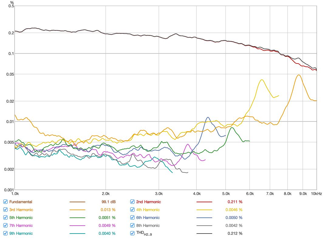

Next a parallel notch in series, as well as a -6dB resistor attenuator (L-pad, to bring down noise from the amplifier in his case) and a 12uF cap in series (to protect the tweeter).
The total response is electrically compensated for the -6dB, not for the 12uF.
Which is why distortion below 2kHz is every so slightly lower.
The total level was kept fairly even.
That mountain landscape is basically gone.
But also the 3rd and 4th harmonics have been lowered significantly!
In this case the RLC contained a 220ohm resistor, so tomorrow he's gonna measure again without one to create a deeper notch.
I will also ask him to make a schematic as well (just to make it more understandable for everyone 🙂 )
So I guess this trick even looks very promising for tweeters as well! 🙂

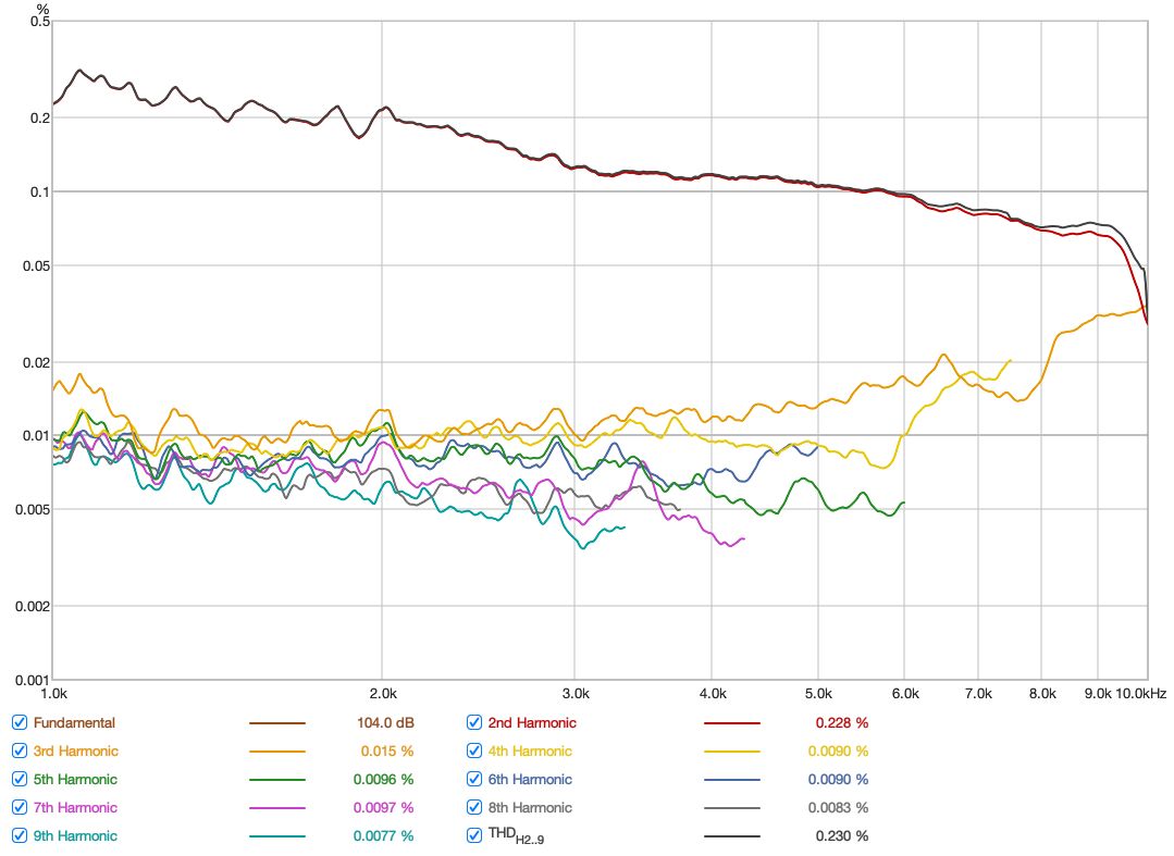

Some more preliminary data, this time with a full deep notch on the resonance frequency.
Any results of the peaks is basically just completely gone 🙂
Next week or so, he's gonna try to levels match everything with a DSP so we can actually compare results better.
Which also leaves a problem, this DSP can only go up to 48kHz sampling rate.
So we can't compare an active notch unfortunately, because that falls out of the passband (26kHz).
Although, on the other hand, that also means a (steep) lowpass filter often around 21-22kHz , which would do similar things.

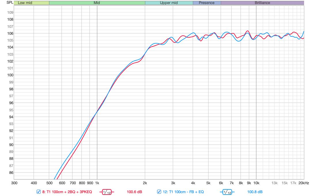

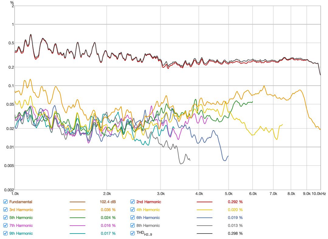

And here some results that can be compared a little better.
Unfortunately there are some reflections presents.
But that only does change the prettiness of the pictures, not the underlying fundamental results.
First both responses were equalized to the same response.
He did this with VituixCAD and optimizing with a BiQuad filter block.
DSP sampling frequency was 48kHz, therefor the big resonance peak of the Seas DXT tweeter cannot be seen.
Red = notch + L-pad + 12uF capacitor (for safety)
Blue = without anything
Distortion without filters:
Distortion with passive filters;
Question from my side;
As far as I remember correctly, most systems have a pretty steep filter inside their DAC to prevent any issues with aliasing?
If that is true (which I think it is), this also automatically shows that active filtering won't do anything with that resonance peak.

Sub-harmonic distortion would mean that lower frequency component(s) would be created (by the breakup), but it doesn't happen here, it's misunderstanding that keeps repeating.
A distortion plot can be drawn two ways: distortion is plotted to the root frequency whose harmonic it is, or at the frequency where it actually happens, at which frequency the microphone registered it.
If you plot distortion where it actually happens, all the peaks due to the breakup would all be at the break up frequency.
If you plot to the root frequency, the peaks look like they were subharmonics but they aren't, they are just reqular harmonics for what ever reason boosted by the cone resonance at the resonant frequency.
If you translate this to audio, all the distortion peaks hear at the breakup frequency, not below it. The breakup could add harmonics, but above it. The peaks we are talking about here, and in purifi paper, are not these, they are just what ever signal in electric domain amplified by the resonance in acoustic domain.
