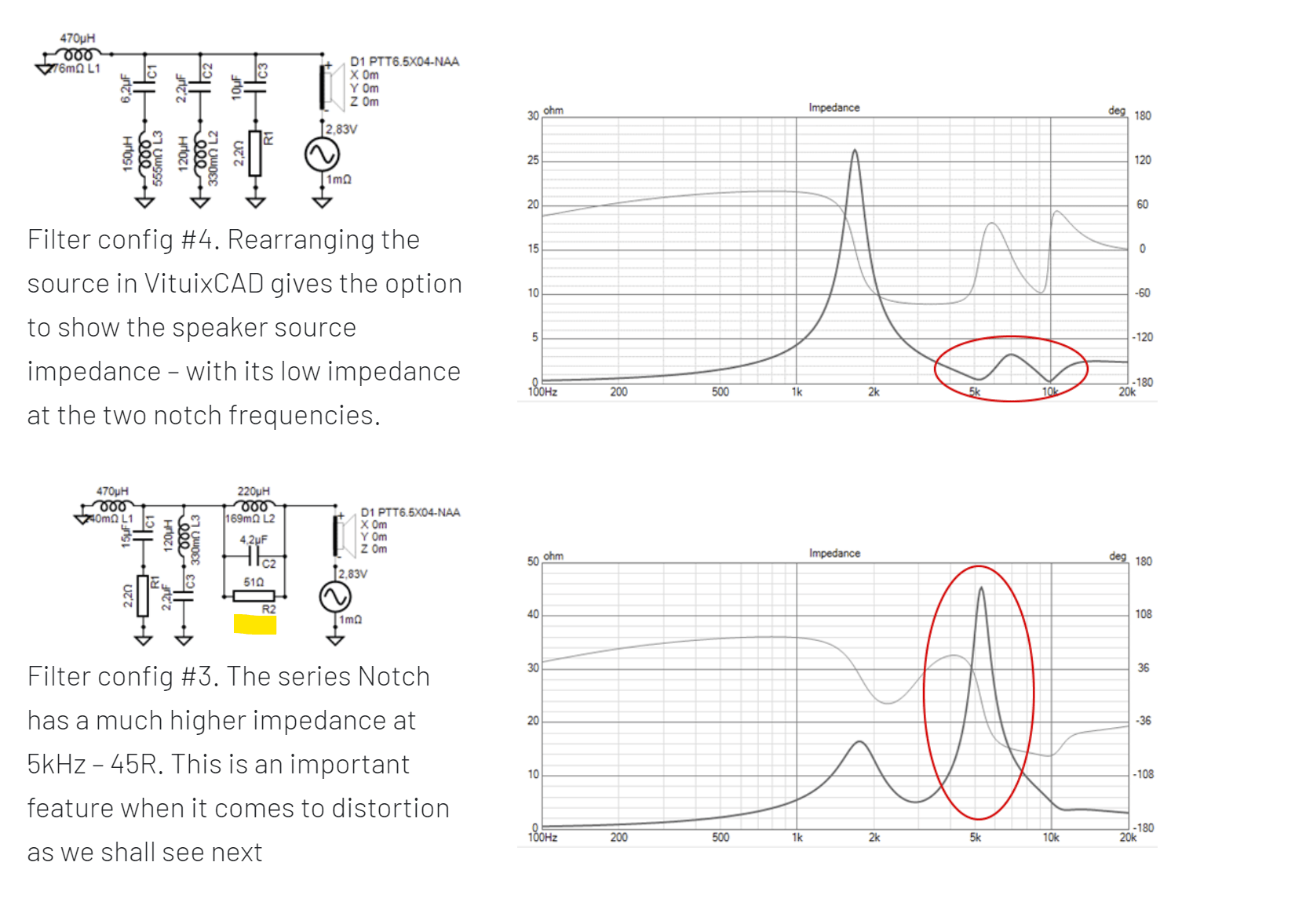

Lets take the Purifi case over. When I write the speaker sees a large Z that is the Z of the series RLC. If a Parallell RLC is used the speaker sees a small Z.Speaker sees impedance that is between it's terminals. Usually active systems have no passive components between amplifier and driver, so it's just amplifier output impedance + any cabling. This is very low with voltage amplifier
It is a jargon used for example when discussing ladder filters
Maybe a better explanation is the Z you measure at the "speaker terminals" if the speaker is removed. That is the Z that the speaker sees

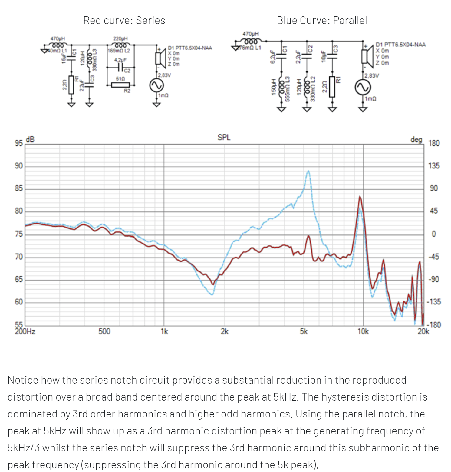

Its not clear to me that the Grimm Audio measurements relate to my own measurements. As I mentioned it is crucial when comparing High Z and Low Z drive that the end frequency responses are exactly the same. When doing so the distortion levels from most non-linearities are identical, the steel related current distortion being the one exception. I can't see how those results would be any different between any drive units available and from any era. It would be nice if someone wanted to duplicate the experiment.
Yeah, on/around that particular frequency you could say its roughly current drive. If impedance of the driver was 8ohms at that frequency, and you now had additional 32 ohms in series for easy math, you would have reduced current from back emf at that frequency five fold, you'd measure fove fold distortion reduction. Frequency response would drop five fold as well because also the input current dropped with constant voltage amp, unless you use five times voltage to maintain current and excursion and acoustic output. But in this particular case the breakup boosts it so its desirable to reduce current and acoustic output to EQ the breakup.
Is it high enough ratio to say it's current drive? depends who defines what it needs to be. But does it matter, you've just utilized same distortion reduction mechanism with voltage amplifier. Even if you had just doubled the driver impedance, (related) distortion would have slashed in half.

you are right, adding resistor doesn't make voltage amp to current amplifier, but the distortion reduction mechanism is the same for both, high impedance in series with the driver! That is why I've been writing forget about power amplifier, abstract it away with equivalent resistor to understand hownit plays out, how Le(x) shows in acoustic domain.
high circuit impedance prevents driver emitting (some of) it's own motor distortion into acoustic domain.
Think about it. If you hook up 0.01% distortion amplifier to a driver and measure 1% distortion woth mic. Add impedance with resistor and measure 0.1% distortion with mic. Do you think amplifier is responsible of the distortion reduction, or the added impedance? and why is that?

Voltage drive is useful at low frequencies because it compensates for variations in net driving force due to cone resonance(s) and variations in BL (with excursion, i.e. BL(x)). This is because of the back-emf. So, where there's a reduction in BL as the voice-coil moves away from its rest position, back-emf will be reduced and drive current increases - and vice-versa. And when resonance reduces the mechanical load on the voice-coil, the tendency for voice-coil velocity to increase is reduced by the increase in back-emf, and consequent reduction in drive current.
At higher frequencies, variations in impedance due to drive current and voice-coil position (Z(i) and Z(x)) come more into play, so swapping voltage drive for current drive would work in maintaining constant drive force.
You can get the best of both worlds in the case of (most) OB designs, as a series inductor will not only provide the requisite EQ, but allow connection to a standard voltage-output amplifier to achieve voltage drive at low frequencies, moving to an approximation to current drive at higher frequencies.

Here is some of the core of the discussion and the case that I think is dificult to embrace. From a voltage perspective and transfer function that is the result I expect:Yeah, on/around that particular frequency you could say its roughly current drive. If impedance of the driver was 8ohms at that frequency, and you now had additional 32 ohms in series for easy math, you would have reduced current from back emf at that frequency five fold, you'd measure fove fold distortion reduction. Frequency response would drop five fold as well because also the input current dropped with constant voltage amp, unless you use five times voltage to maintain current and excursion and acoustic output. But in this particular case the breakup boosts it so its desirable to reduce current and acoustic output to EQ the breakup.
If voltage at a frequency f is reduced fivefold, distortion at f is reduced fivefold. But then you could instead use a active filter with the same fivefold notch and get the same effect.
The "magic" is that the distortion is reduces for f/3 with series filter and not with equivalent parallell filter. I am sure a active notch filter would give the same result as parallell filter. (No in band reduction with out of band filtering)
I now understand that it is reduced EMF and steel related current distortion (hysteresis) that explaines the whole thing.
And shunting the EMF and drive voltage to ground with parallell filter helps at f but not at f/3

If the designer inserts a serial filter with -3dB at 1.5k (RLC or L) the noise will be decreases at 1.5 to 6 kHz, but the 3. harmonic distortion from 0.5k to 2 kHz stimuli will also be decreased the same amount as the noise at 1.5 to 6 kHz. Since it is an active filter the falling responce from 1.5 kHz can be corrected with a compensating active filter. Designer must then take a choise at what x over frequency to use based on noise + the other standard considerations.
