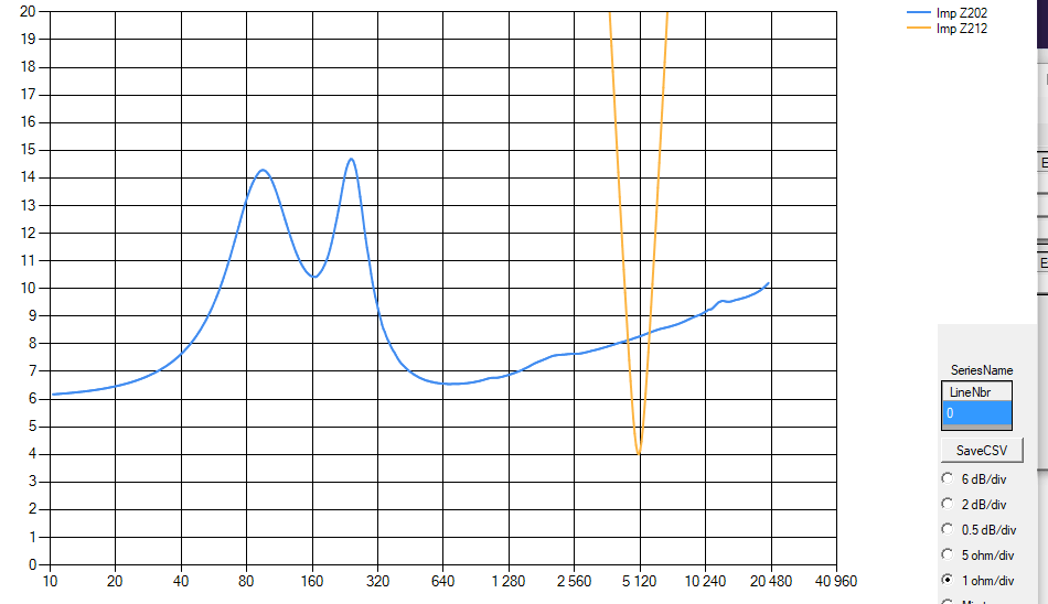

What makes me wonder is what a active notch will do with a series RLC parallel to the woofer.
The rlc will give a shorting path for the back emf. Unfortunately we have to be careful for not overloading the amplifier as well as dissipating to much power.
At the same time, the active notch takes care of the resonance.
Also, I assume that the amount of attenuation is determined by the shunt impedance as well as the speaker impedance at that specific frequency?
Like A=Zshunt / (Zshunt + Zspeaker)
Just a brainstorm what that would bring.

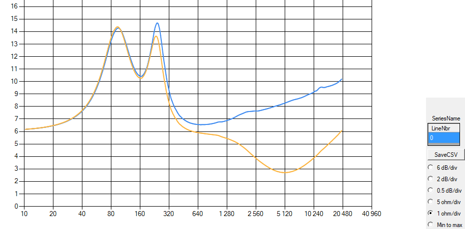

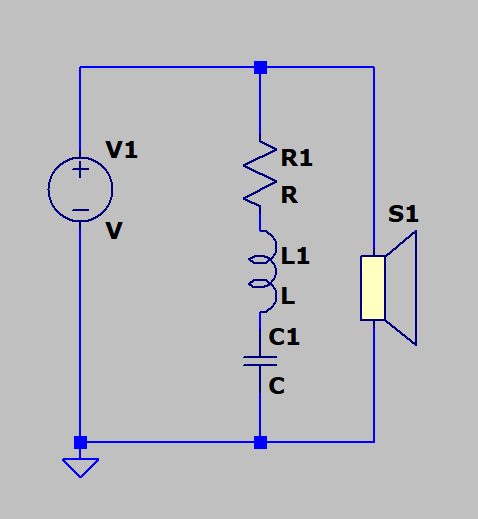

Like this. Excuse the lame grafics of the circuit:
R12, L12 and C12 in series, Z shunt. And Z shunt in parallell with speaker. Zspeaker II Zshunt are yellow. Blue is Z speaker
Frequency response is of course the same. With or without shunt. But I really don't know what would happen with distortion at 5k, Or will that be 1,7k

No that's not what I meant. 🙂Like this. Excuse the lame grafics of the circuit:
We can just have series RLC straight to ground, no series resistor needed.
Remember; just to give a termination path for the back EMF to be shunted.
C = 10, L = 0.1, R = 0.1 (R part of L)

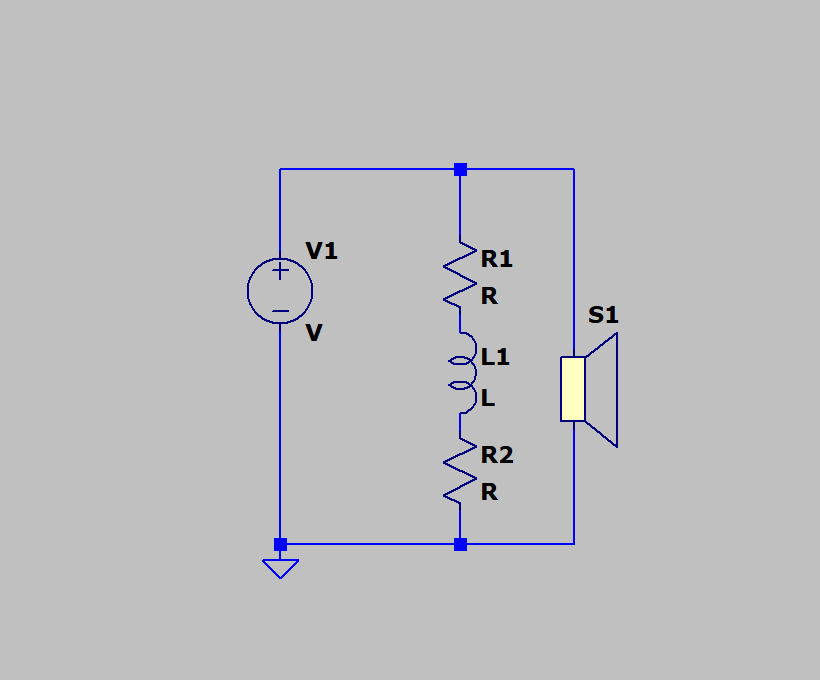

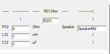

Ah, you were refering to the R201 resistor. Sorry forgot to mention it is a 0 ohm resistor in this simulation
We are miscommunicating to the max at the point, haha 😀Ah, you were refering to the R201 resistor. Sorry forgot to mention it is a 0 ohm resistor in this simulation
The lowest impedance is determined by R2.
Sorry that was a drawing mistake on my end.So no C in the RLC?
Obviously a RLC notch is with a C as well 🙂
OK, then my two first simulations should be valid.
Both R1 = 4

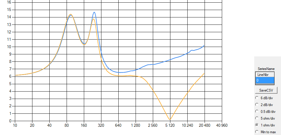

Simulation 1: L1 = 1 mH, C1 = 1uF, Narrow Z total dip
Simulation 2: L1 = 0.1 mH, C1 = 10uF, Broader Z total dip
Both R1 = 4

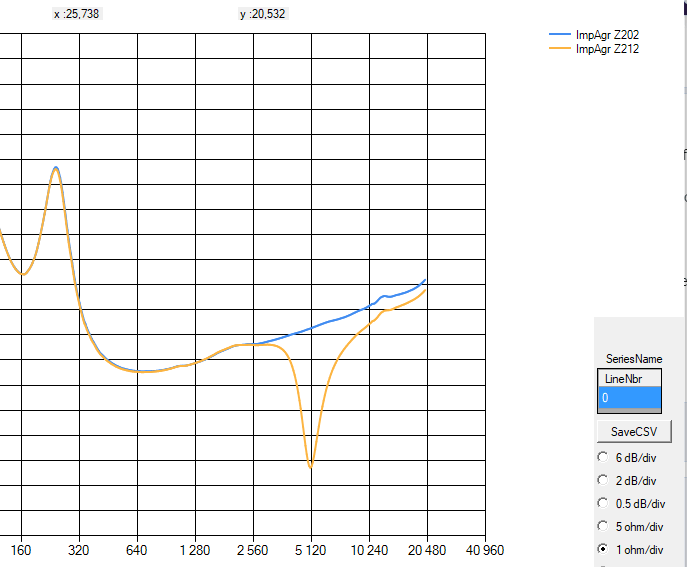

Right, which is not a very nice value, unless you want to dissipate a lot of power.Both R1 = 4
Practically speaking, you have to go to about 10-16 ohm.
So it's interesting to see how well (and if even) this combination works.
Like I said, it was just a braintstorm, see where it brings us.
Although we need measurements at this point.
As a side note se http://www.troelsgravesen.dk/Illuminator-71.htm uses RLC like that to linearize speaker impedans at upper end. So if the designer need linearized impedanse at HF part of speaker that could do the trick with the right values. That apply also to active system, but often it is not a requirement bacause of amps with low source impedance
